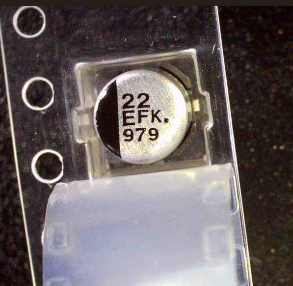

                    #69
                    Re: Post help identifying capacitors here
                    HI guys, trying to figure out the voltage of these caps I ordered a while back. Obviously 22uf but voltage is either 4 or 6.3. They are roughly 6mm tall and 5mm diameter.

                      #70
                      Are you sure it's not a 25 volt capacitor? From what I found, the capital E means 25 volts, whereas a lowercase j means 6.3 volts.

                        #71
                        You may be right, for some reason I assumed low voltage.

                          #72
                          In case you're wondering, here is the graphic I found:

                            #73
                            If you don't mention the specific company whom made those capacitors , it's worth nothing but for the same series and the same company , so only useful for those whom know which company they're .
                            Different markings by different companies are like hair on my head .. Sanyo or Panasonic for an example put only the specific voltage and capacitance directly plus a series name , while they don't put "Sanyo" or "Panasonic" .. And so on .

                                #75
                                BTW the capacitors that were asked about are Panasonic FK series. However, the letters for voltages work for Panasonic, Rubycon, and probably other brands.

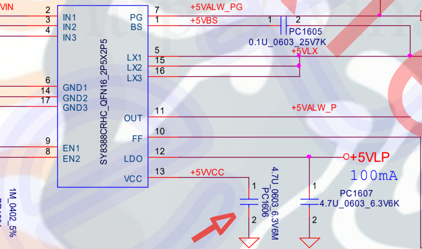

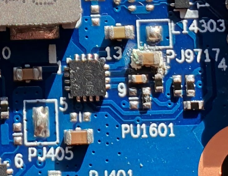

                                    #77
                                    Any ideas?
                                    Hi I've just found a "bad cap" on my Lenovo motherboard.
                                    I've located the schematic for the board and found the cap value.
                                    It's a 4.7UF 0603 6.3V 6K. I can find 4.7UF 0603 6.3V but I'm having problems finding the 6k version. Is it important?

                                      #78
                                      Is it bad or just acting bad because of the water damage/corrosion? Any 4.7uf 0603 is fine.

                                        #79
                                        I cleared the corrosion but it's still a dead short. Thanks for your help.
