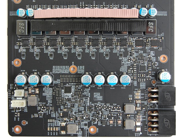

                Capacitor from a GTX 1070 Ti card.
                Elite capacitor? Maybe, but EA(X) series not shown on their website. Unless capacitor is discontinued, or maybe capacitor is custom made (by Elite)?
                • xnRS
                  • Feb 2021
                  • 85
                  • Belarus
                  • PC Hardware, cars
                  Re: Post help identifying capacitors here
                  Well, just one more thing
                  Brand and PN of card, so maybe I could find some more info on caps which this brand uses often
                  • brispuss
                    • Dec 2012
                    • 54
                    • NZ
                    #29
                    Capacitor from a MSI card I believe. Card part number unknown, although as far as I know there is only one version of this card from MSI.
                    Partly by chance by searching on the internet, I now suspect that this capacitor is customized for MSI and possibly manufactured by Apaq.
                    Apaq have an EA series of capacitors with markings similar to this capacitor in question. But the standard EA series capacitors are marked in red color, and also include Apaq "eye" logo at the beginning of the second line of text/marking. But this "customized" capacitor has blue marking instead of red marking, and the Apaq logo was not included.
                    So at this time, Apaq seems to be the more likely manufacturer of this capacitor.

                      I think you're correct !
                      There are also AV5K caps as I can see on images from google

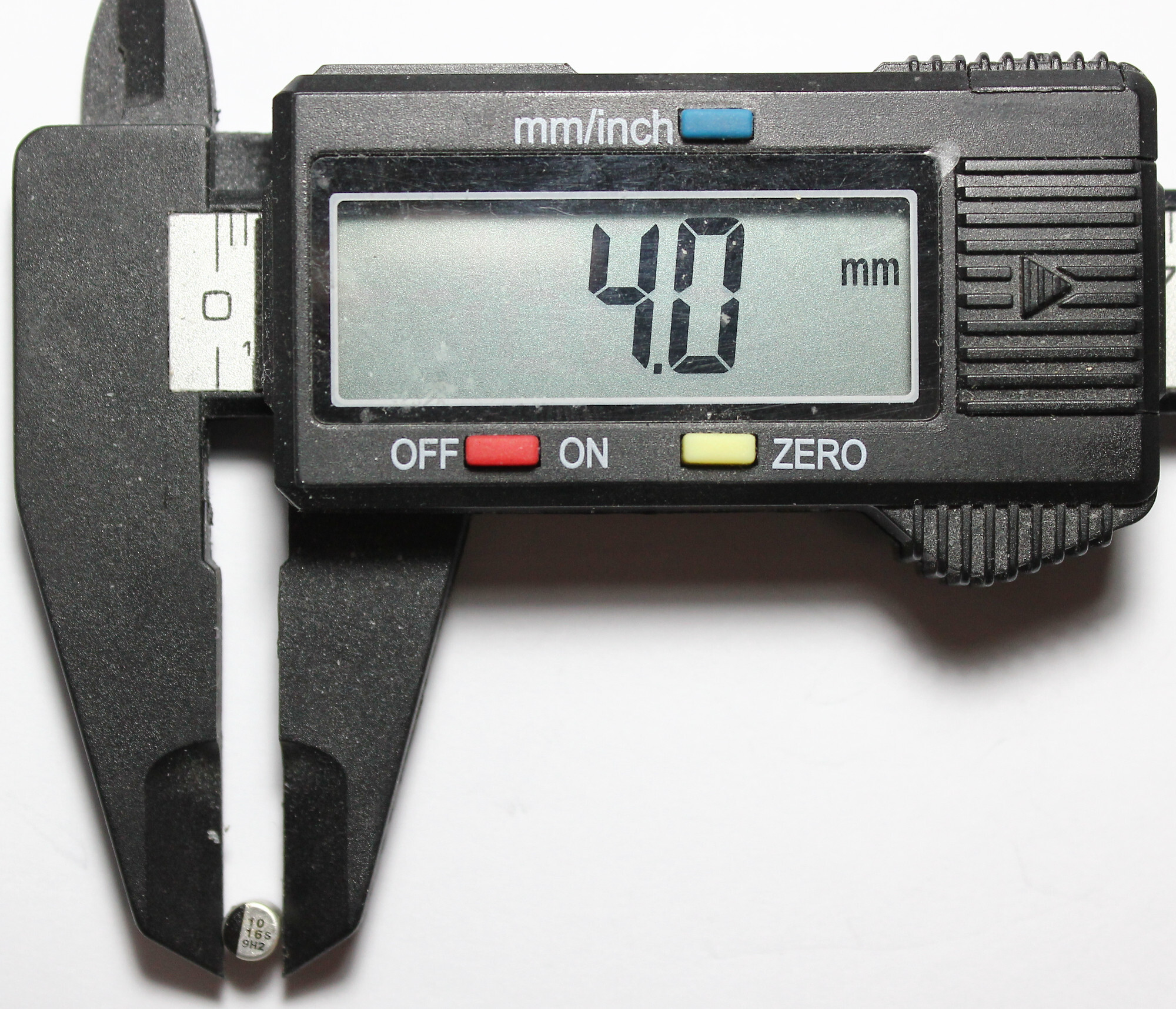

                                  Very small capacitor, is it 10v 16uF? What does the 9H2 mean?
                                  Premium supporters get full download access and other benefits.
                                  • jiroy
                                    • Jun 2016
                                    • 2416
                                    • Lebanon
                                    #37
                                    Yes . it is 10mf 16v .. 9H2 or other similar markings are specific codes for the manufacturers series , and sometimes it can be a coefficient of temperature . It depend on their companies design .

                                      Does the "s" in "16s" mean volts? otherwise how can you tell what is what? I mean could there be a 10v 16uF cap? how would you tell them apart?
                                      • jiroy
                                        • Jun 2016
                                        • 2416
                                        • Lebanon
                                        #39
                                        Thank you
                                        You always take the first value for Capacitance and the second for voltage , that's the standards .
