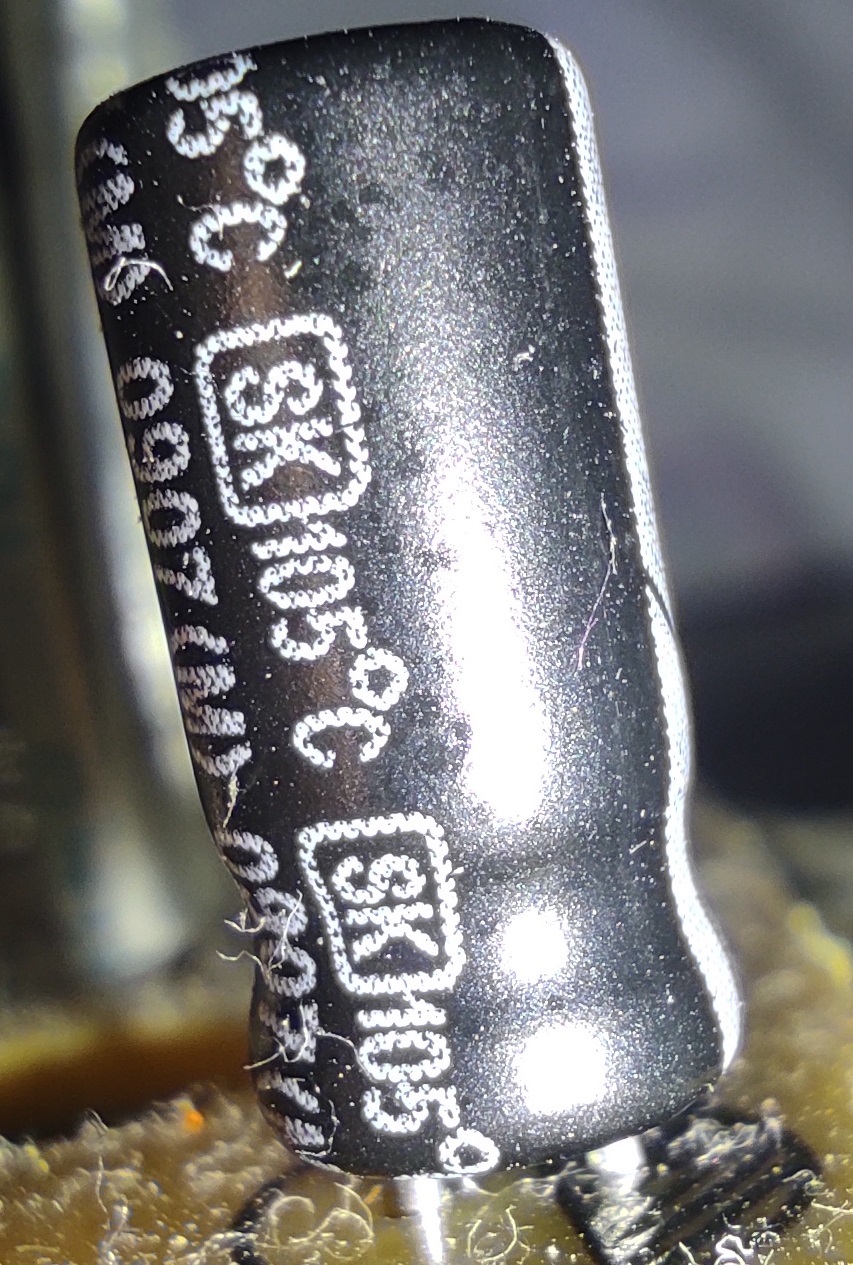

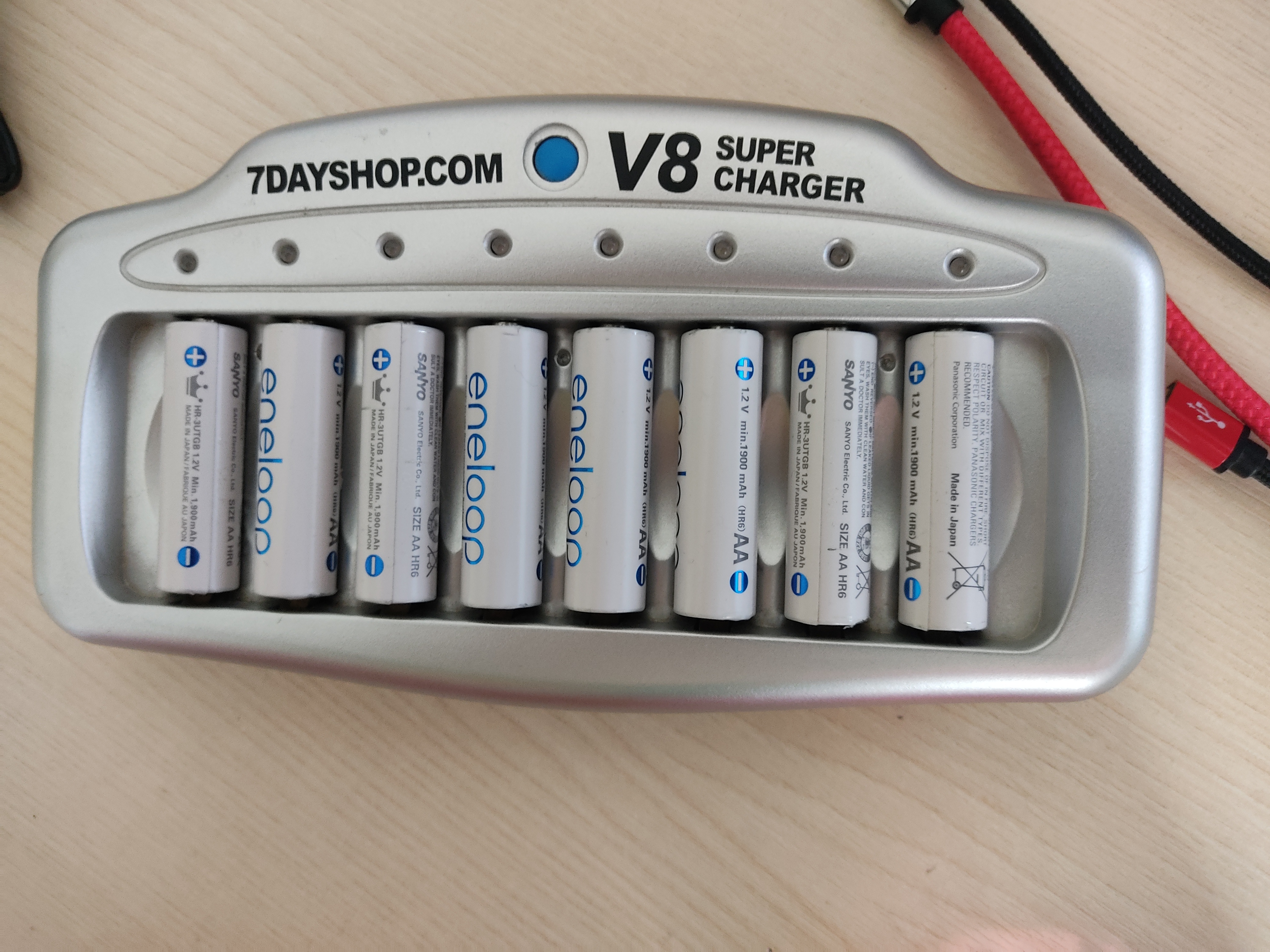

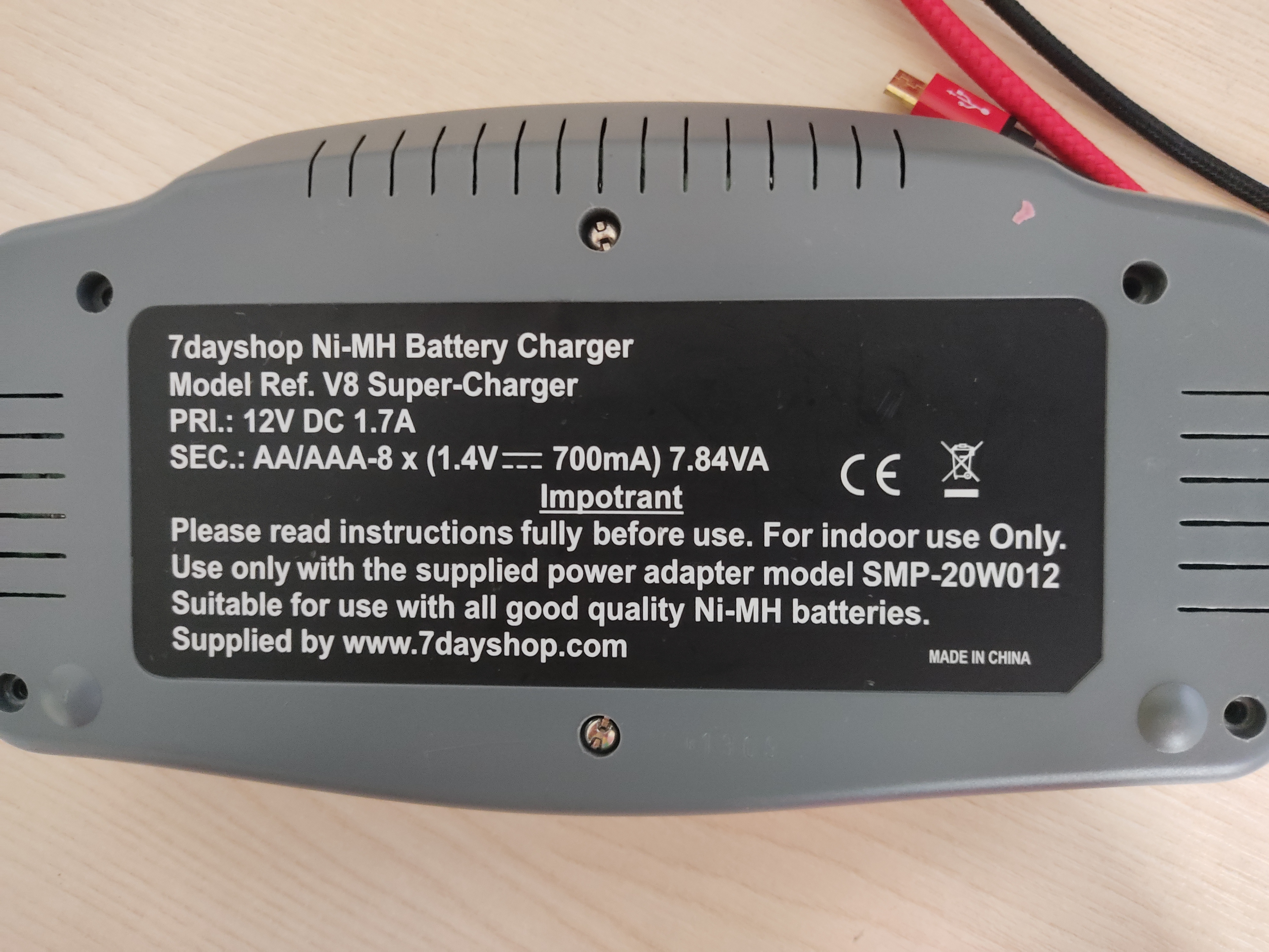

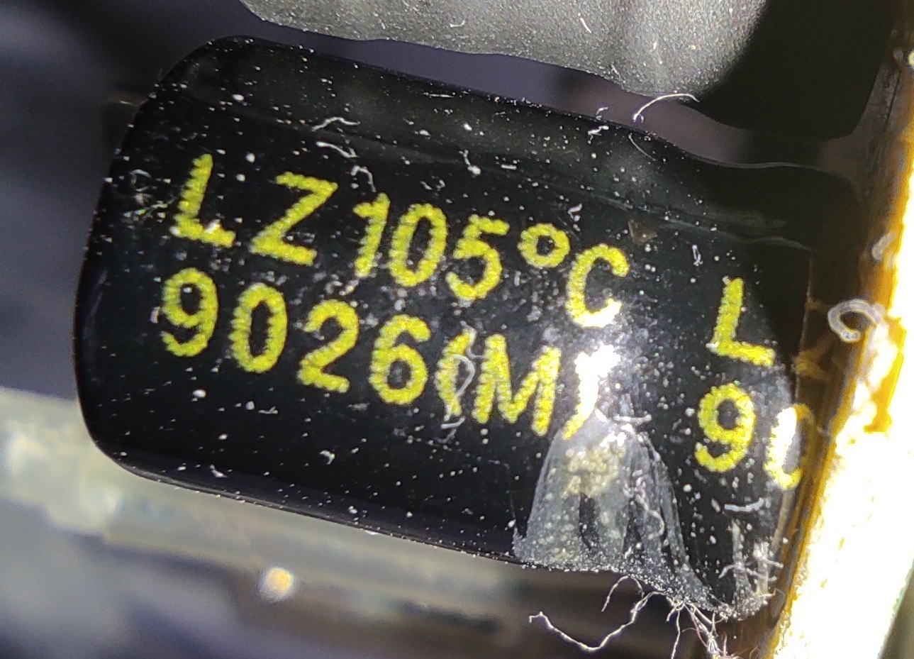

    hey all, iv got my favourite battery charger here which iv had for many years probably 15 years now or maybe even more. it still works good but thought id open it up to clean the dust out of it, lots of dust inside but now its clean and noticed 4 capacitors inside it and wondered if i should replace them.

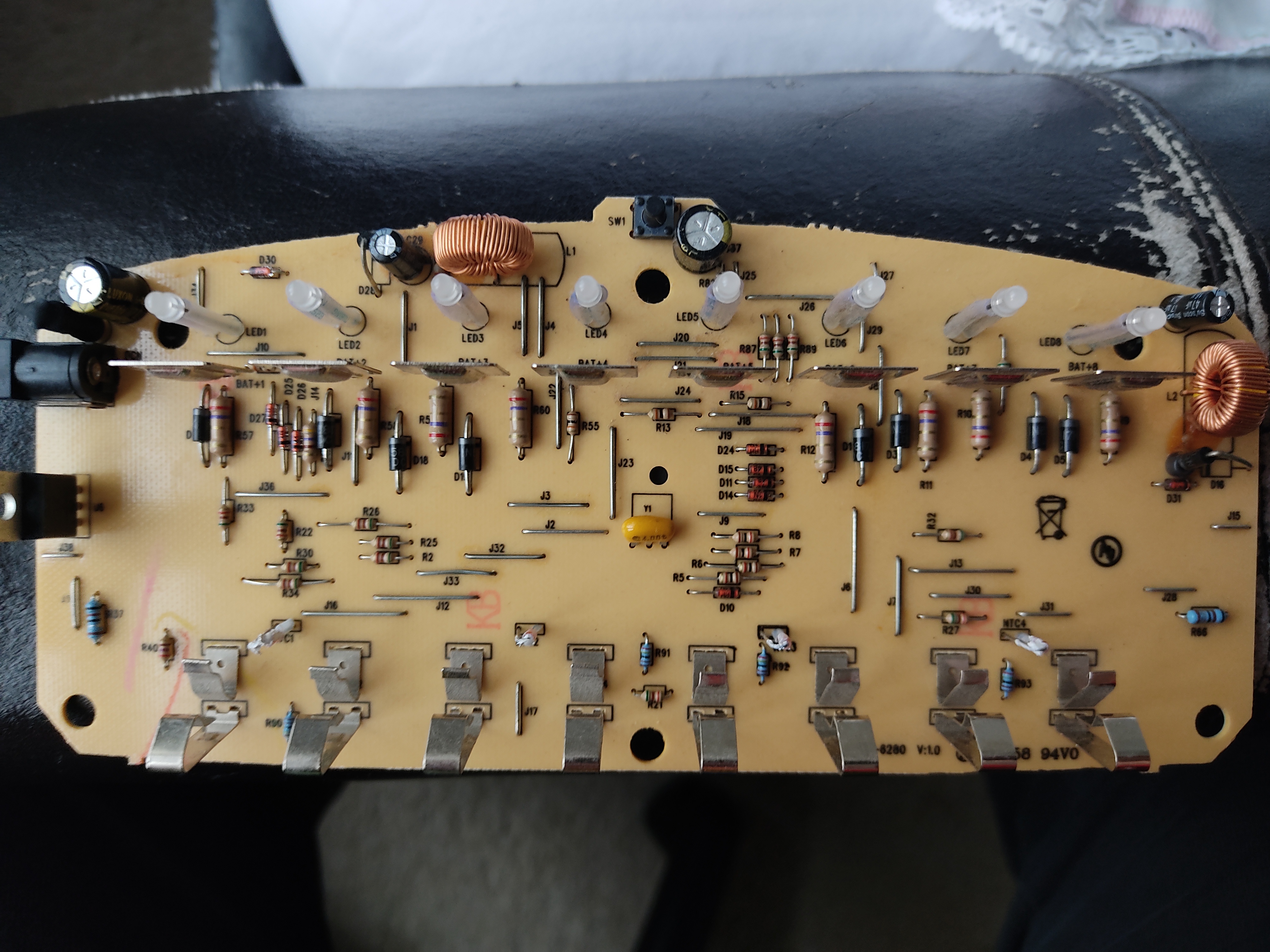

    it has inside:

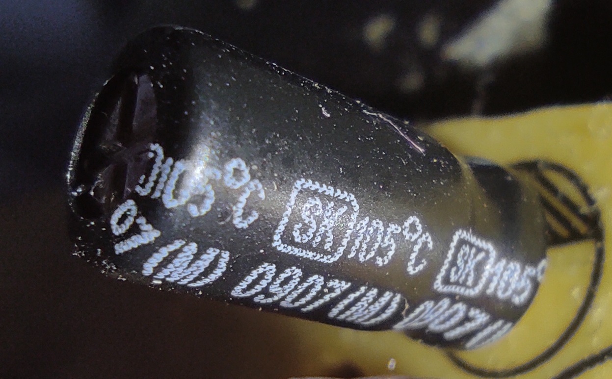

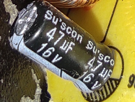

    2 x 47uf 16v caps 105c branded as Su'scon (lol sounds sus to me)

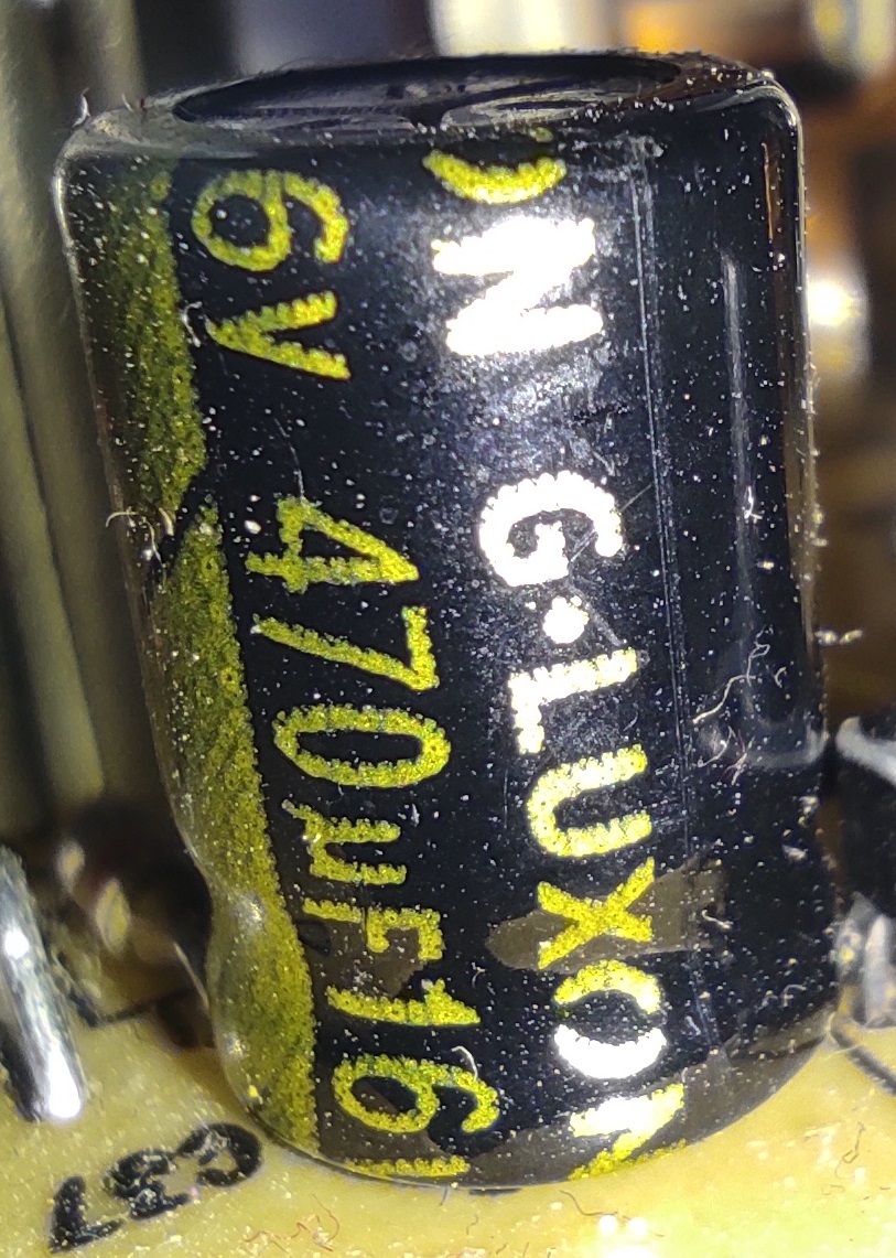

    2 x 470uf 16v LZ105c branded as G.Luxon
    not heard of these brands are they any good?

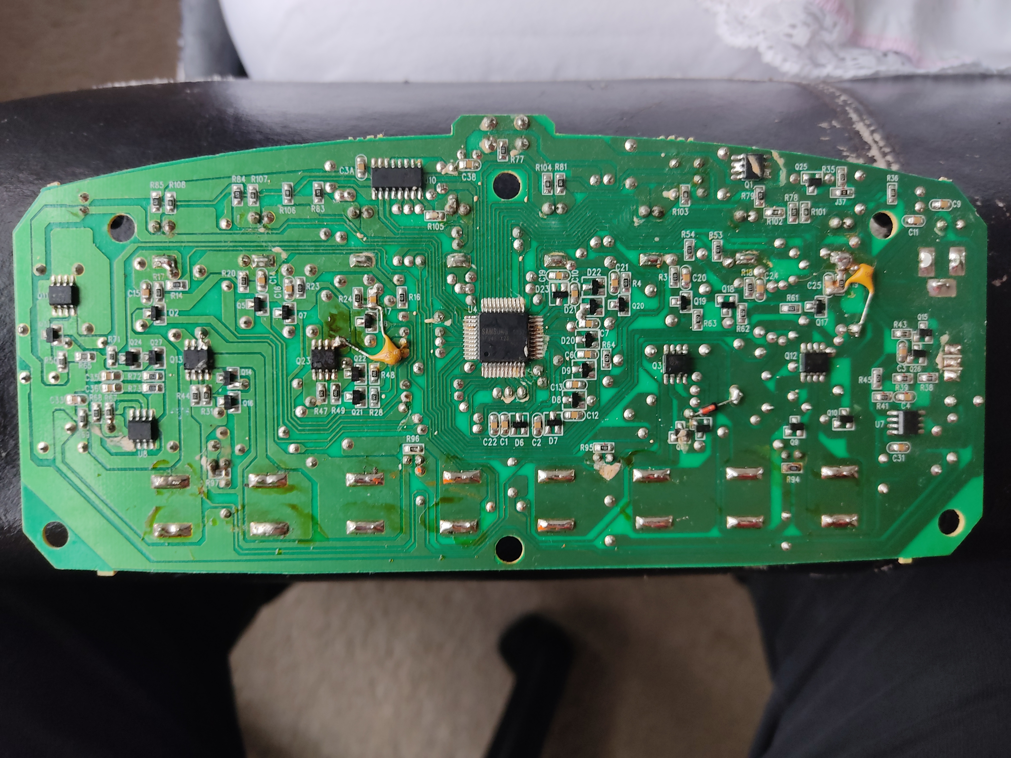

    iv attached photos of the charger and the board inside for an idea on the type of application these caps are in.
    now i do have a pack of new capacitors in stock at home here which are 470uf 16v part number: EKY-160ELL471MH15D purchased from here: https://uk.rs-online.com/web/p/alumi...citors/8118663 branded Nippon Chemi-Con. are these suitable replacements for the ones in the charger? the height of the caps i have seem to be a little taller than the originals but iv checked that there is room in there to fit them.
    as for the 47uf caps any ideas on if should replace them if so with what type? iv found a few options here but not sure if they meet specs in ripple, esr etc: https://uk.rs-online.com/web/p/alumi...citors/2244167 and https://uk.rs-online.com/web/p/alumi...citors/2286644
    thanks
    • 31182
    nice design,
    the only one that could be stressed is next to the big coil.
    if you choose to re-cap it then just use panasonic FR

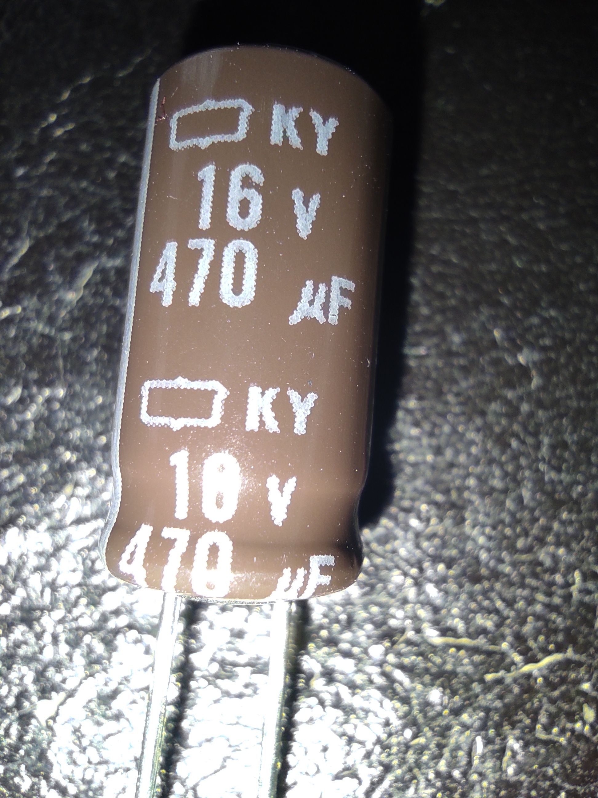

      Can i use the nippon chemicon ky cap i have for replacing the 470uf cap or it not the correct series type for this type of application?
        • 31182
        KY 0.087ohms 840mA 8mm diameter 6000hour
        FR 0.056ohms 950mA 8mm diameter 6000hour minimum life
        close - choose based on price.

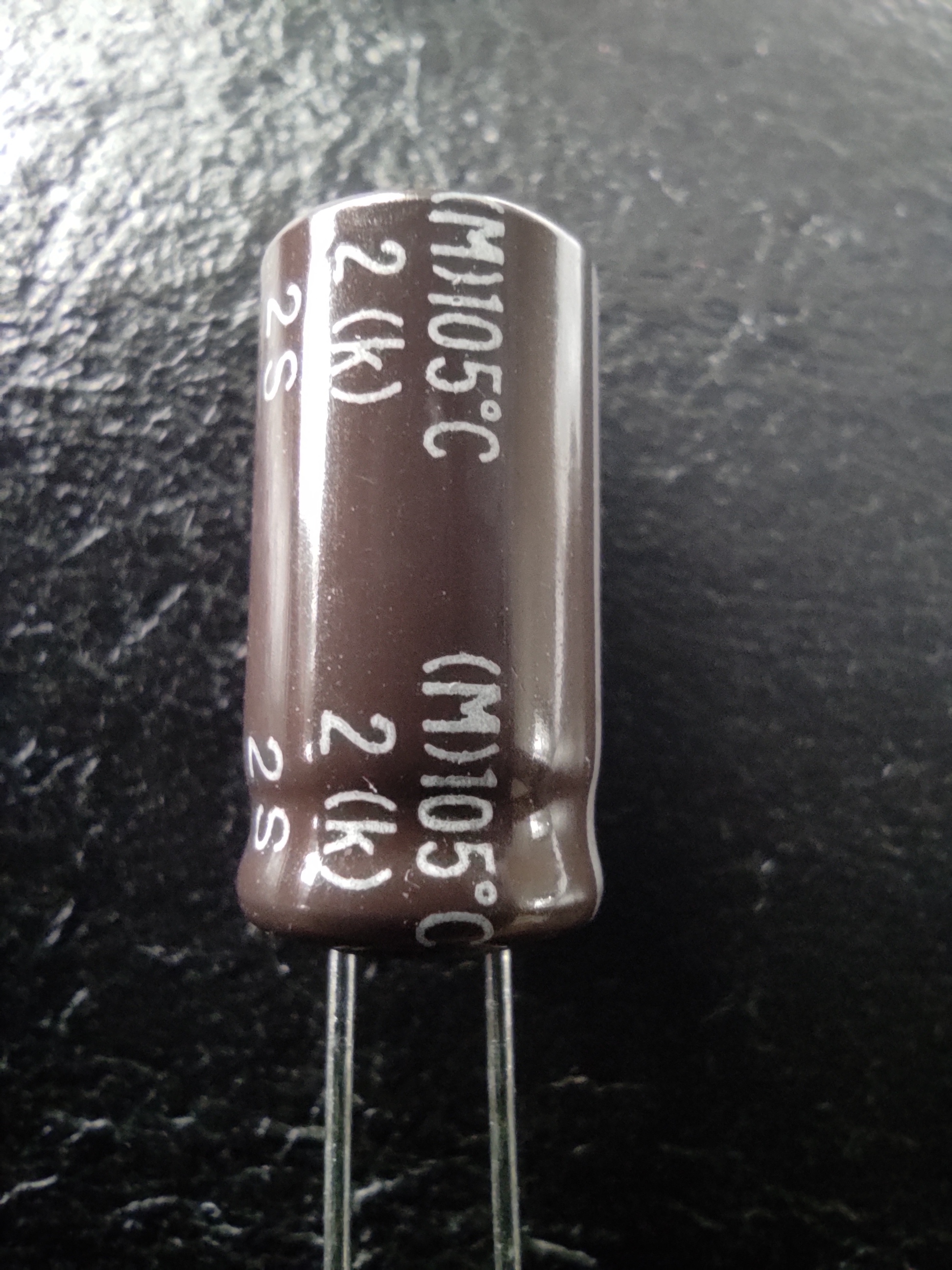

          I already have the KY caps at home here new in a pack of 20 so no need to go out and spend money if they are suitable for use in this application.
          as for the 47uf caps can i use these: https://uk.rs-online.com/web/p/alumi...citors/2244167
          They are rubycon YXF series 5000h 150ma
            • 31182
            suscon SK are standard crap other than being 105'
            so YXF is much better anyway.

              Excellent with get the rubycons yxf and use them with the ky caps i already have to recap this charger.

                          Picked the 47uf caps up today so will get recapping hopefully later on today
                          • slybunda
                            • Feb 2012
                            • 138
                            Recapping done and charger is working fine. Thanks all for helping on this one
