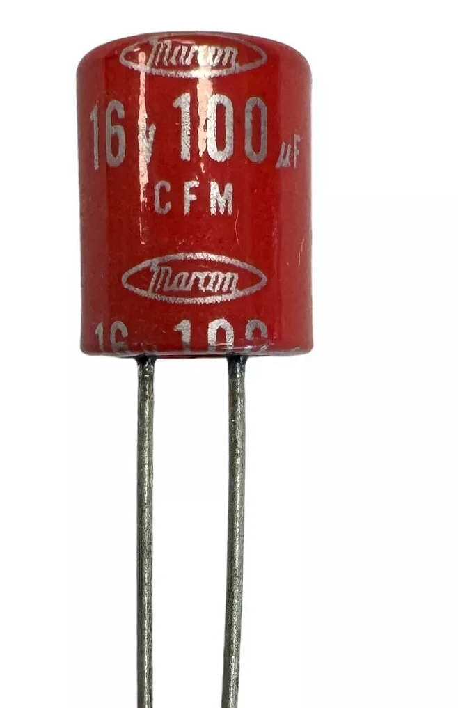

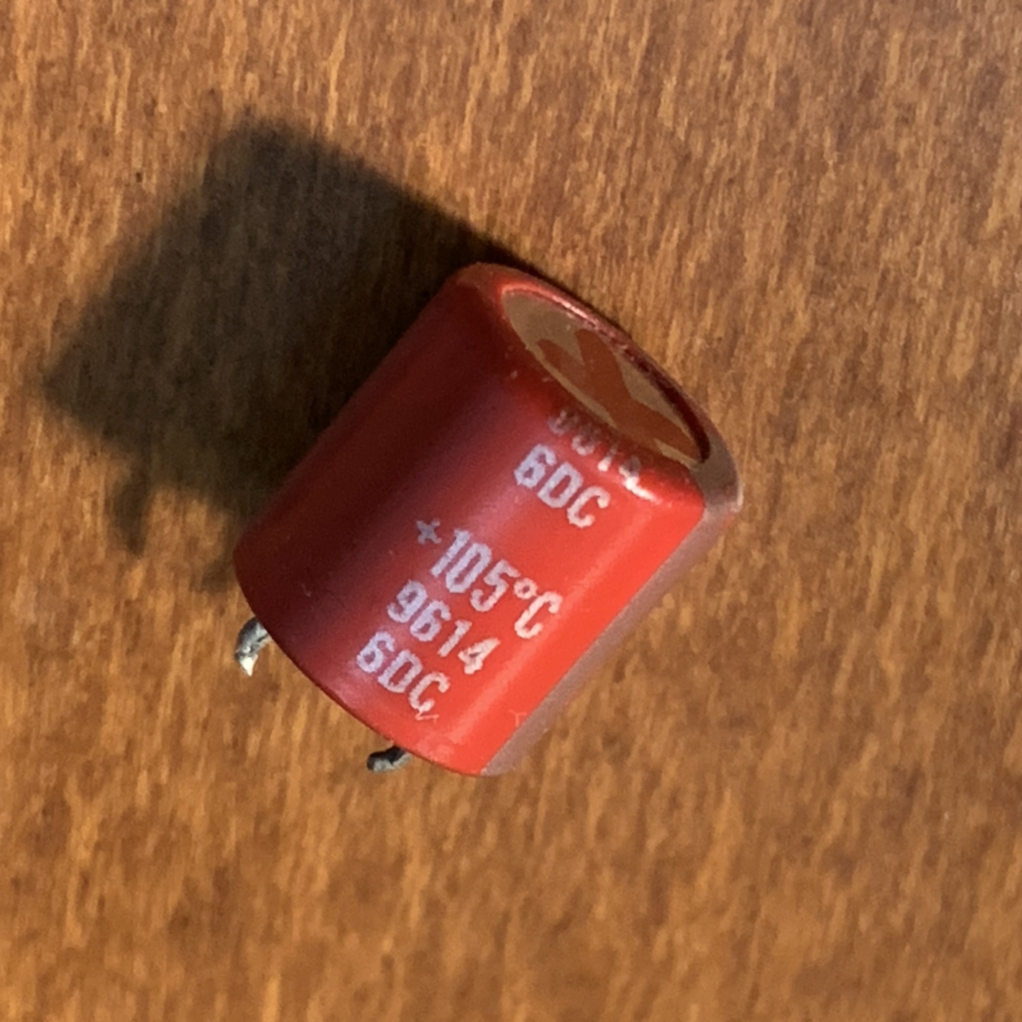

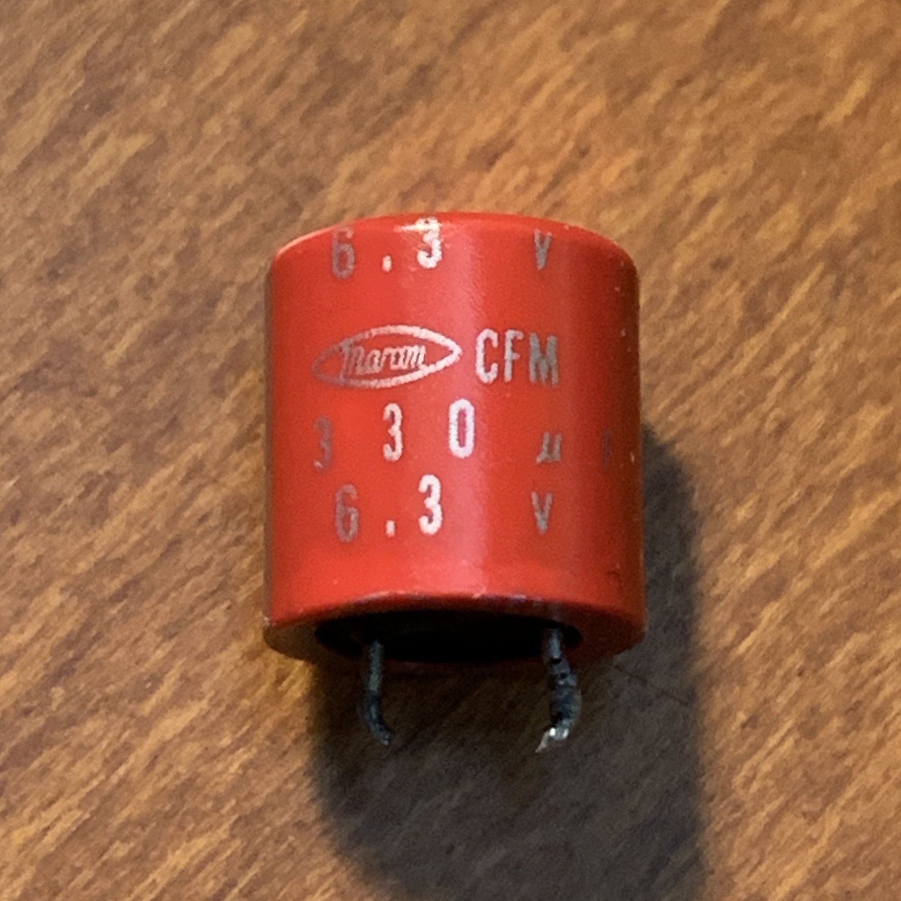

                                  #156
                                  Hey all. I'm recalpping an Artesyn P/N 22943505 PSU with SGI P/N 060-0021-002 Rev A for an Indigo2 IMPACT and have come across some bad caps that I can't identify a replacement for. They're red, very small, made by Marcom. I think they are FP-Caps (functional polymer/solid caps), but Marcom got bought up Nippon Chemi-Con a year before these caps were produced. They are 330uF, 6.3V, 105degC, red in color with a silver "-" stripe, 10x10mm and one of three on the board tested bad with an LCR meter. They are marked "CFM" (the series) and "9614" which I'm told is how Marcom prints the manuf. date of 1996 14th week.
                                  Let me know if you need a pic.
                                    SMDFlea commented
                                    Editing a comment
                                    pics would be good
                                • PeteS in CA
                                  • Aug 2005
                                  • 3581
                                  • USA, Unsure of Planet
                                  #157
                                  Given the age, if it is an electrolytic I'd suggest Nichicon PS, PM, PJ, or PW series, in that order of preference, whatever fits. I'm not sure whether polymer caps were coming into use in 1996.
                                  PeteS in CA
                                  • ghost180sx
                                    • Jun 2021
                                    • 12
                                    #158
                                    Thanks PeteS, that's what my friends in the SGI collector community have done. Then again, some have failed to repair their PSUs or had them fail after a recap. Most of us are flying "flying blind" tho as SGI never released any schematics.
                                    My PSU is working but outputting high ripple. It's very noticeable and was getting worse the more I used my machine, so I took it apart to fix the supply.
                                    This is the only one of three like it in the supply that tested bad with my LCR meter. The other caps in the PSU were getting old but in OK condition and within tolerances.
                                    Does anybody have any old Marcom data books or data sheets to confirm it's a polymer or what the CFM series was? I'd feel better replacing these three with a FP high ripple tolerant and super low ESR variant if that's what these are.

                                    • ghost180sx
                                      • Jun 2021
                                      • 12
                                      #159
ID:	3531321Click image for larger version
                                      My bad, these are made by Marcon, ending with an "n". Marcon Electronics, a former subsidiary of Toshiba Corp, then bought up by United Chemi-Con.
                                      See: https://www.procureinc.com/manufactu...ted_Chemi-Con/
                                      • Hitto
                                        • Apr 2019
                                        • 95
                                        • Italy
                                        #160
                                        Yes, Marcon (''N'') which is a diminutive of Marconi (in honor of Guglielmo Marconi, I suppose) and these are very old capacitors available in stores here in Italy in the era mentioned by PeteS in CA. They are still available as N.O.S. on some shops.
                                        I also reinforce that, given their era, this is not a polymer. I would replace it with a Panasonic FC but also Nichicon PM would be perfect (E.S.R. not too low and capable of handling high frequencies). I would derate and use a 10V replacement.
                                        EDIT: I confirm, electrolytic. As per specifictions in the inventory of a shop which sells N.O.S. parts. Picture attached.
