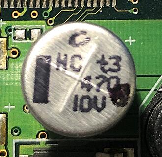

The capacitors in question are a small, yellow, ceramic capacitor located right next to the main power input pin (pin 12) and ignition (pin 13) of the main controller chip. There are no visible markings or codes on it.
I've attached a close-up photo of the capacitors (pin 12 is constant + and pin 13 is ignition + ) and an overview of the board. I've checked the resistance with a multimeter and pin 12 capacitor goes for 0.8MΩ and pin 13 capacitor goes with 2.8kΩ. The ecu was under water so from my little understanding I suspect this could be the problem for the fluctuating system voltage
Could anyone help me identify its likely value? Any help would be greatly appreciated!
Leave a comment:
