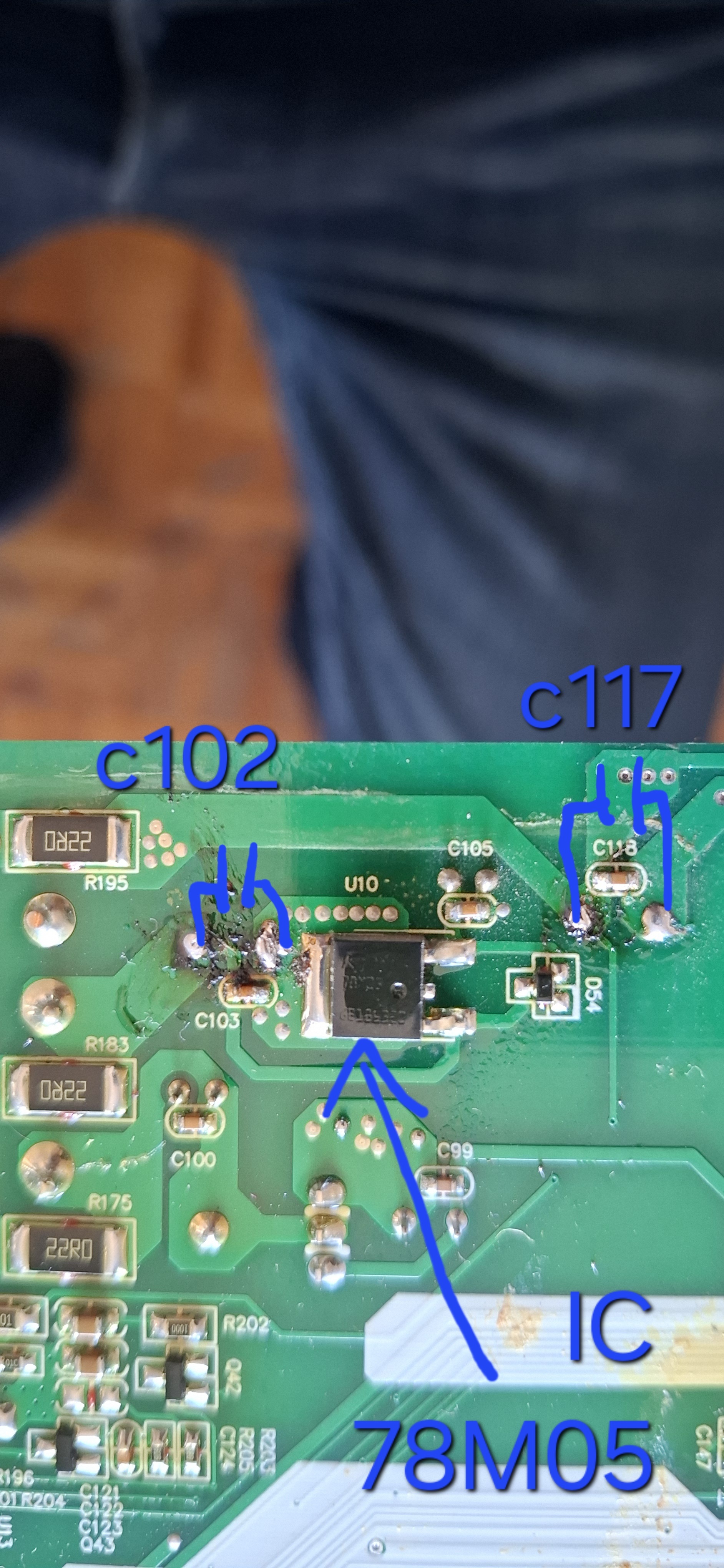

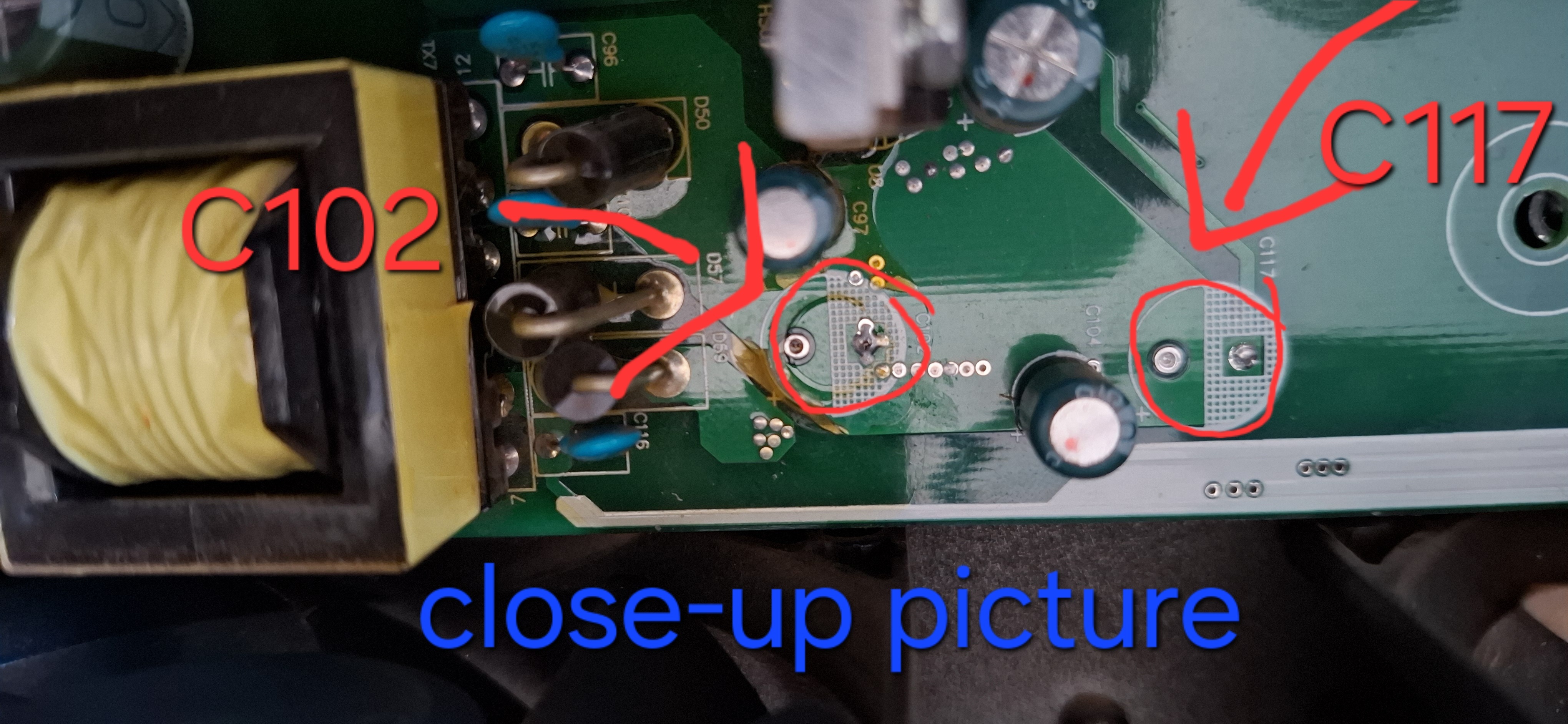

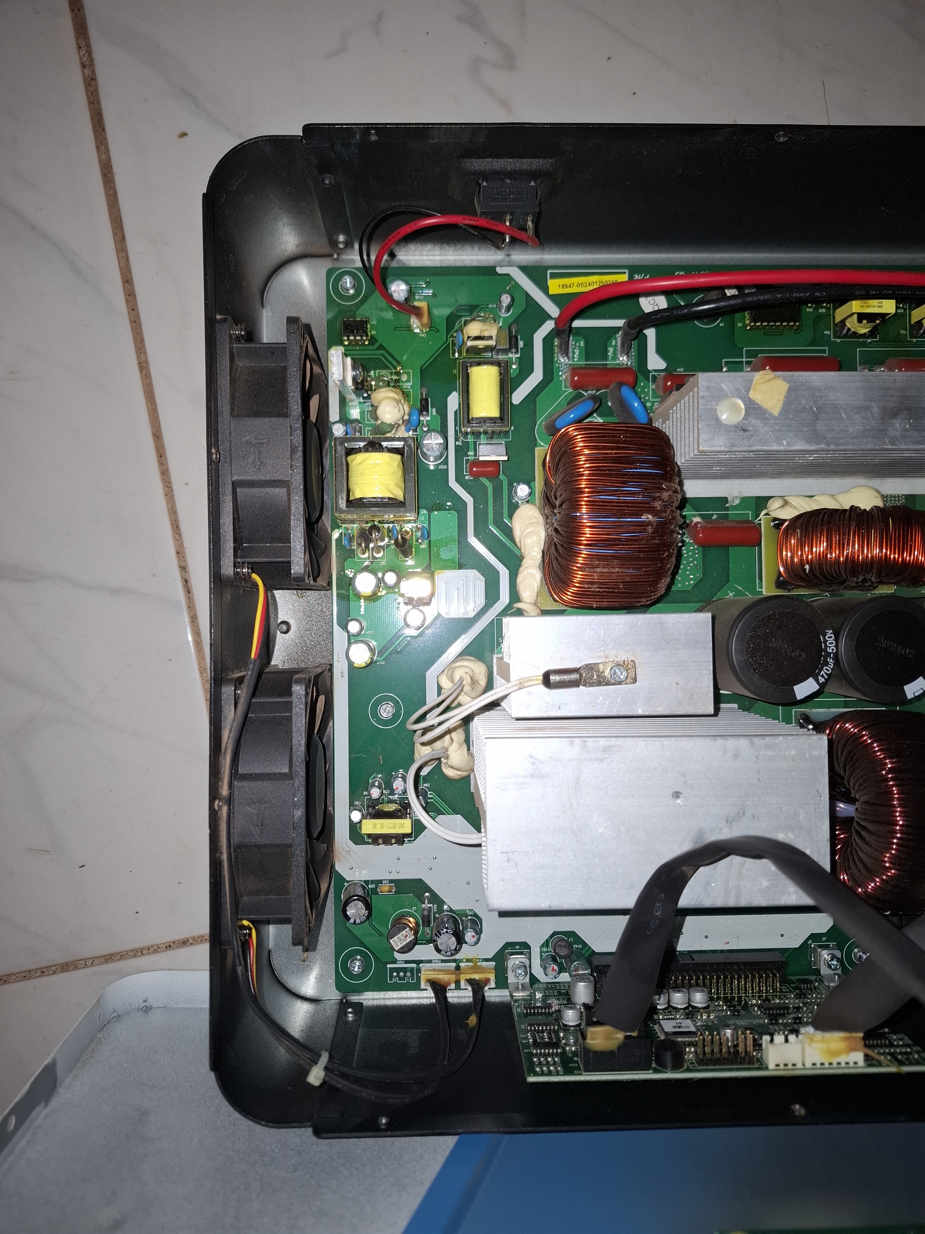

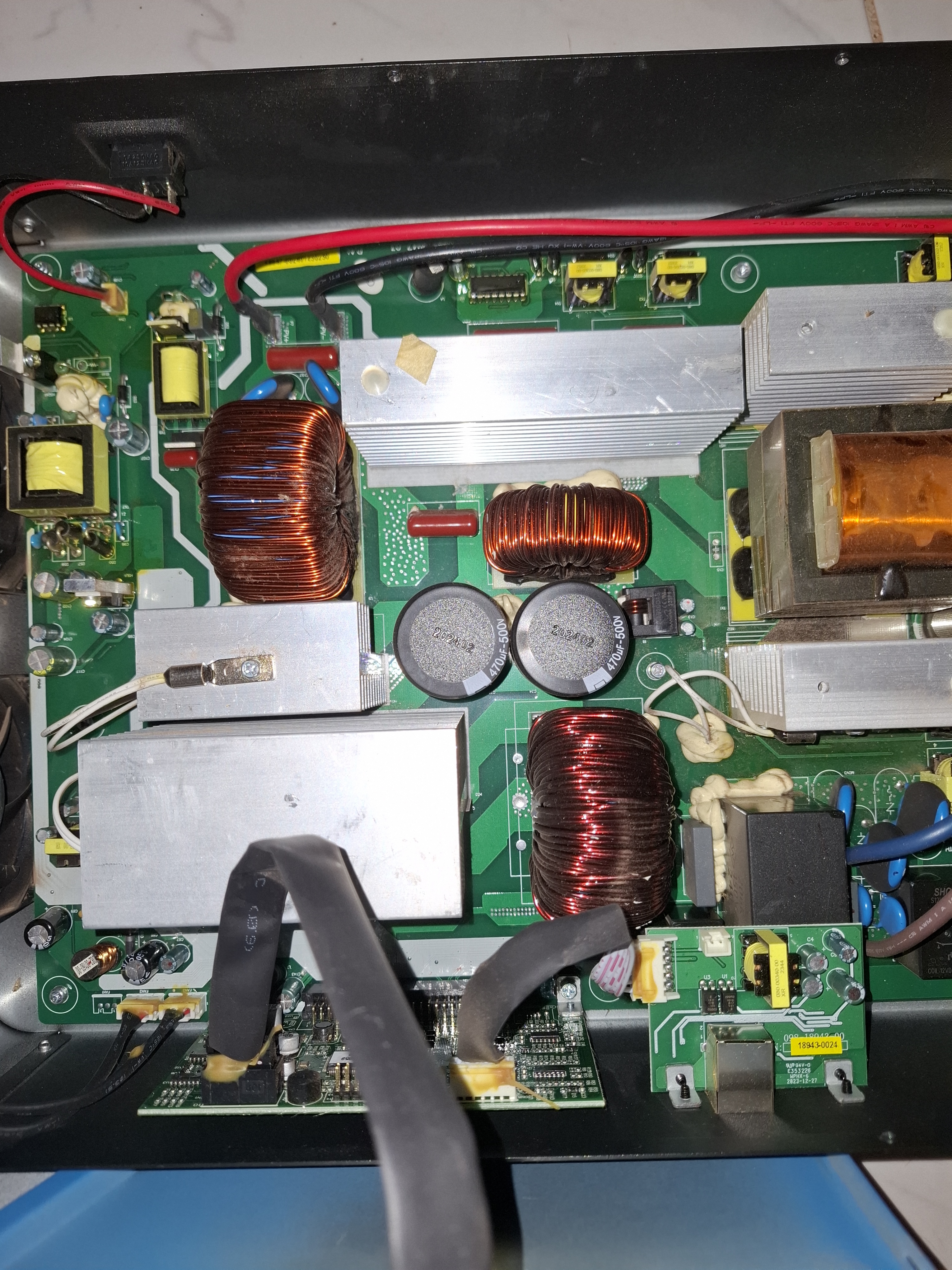

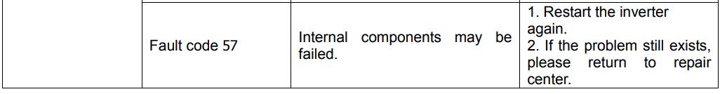

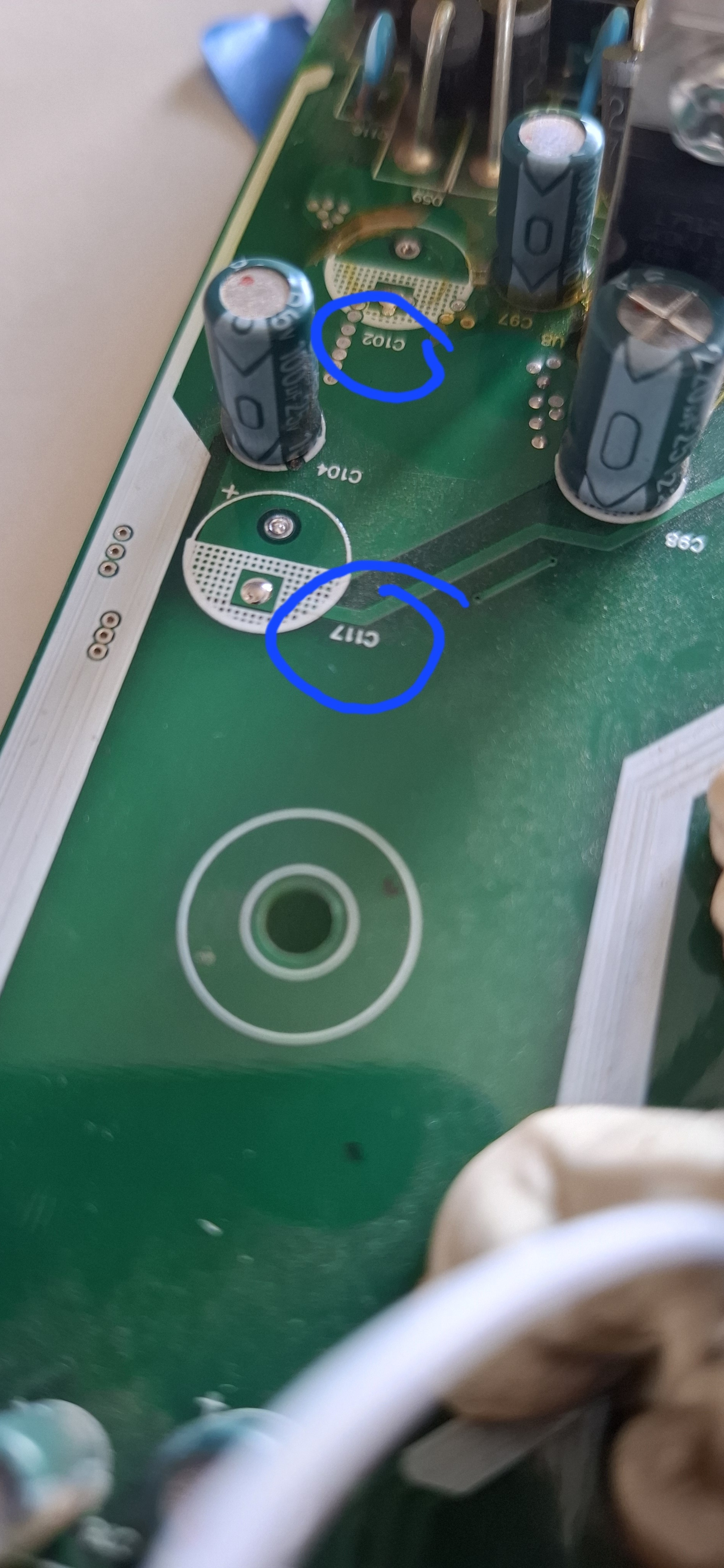

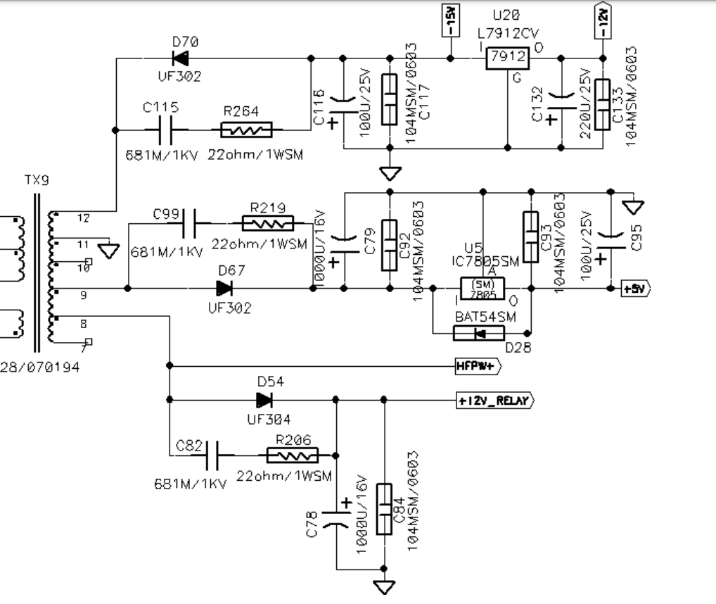

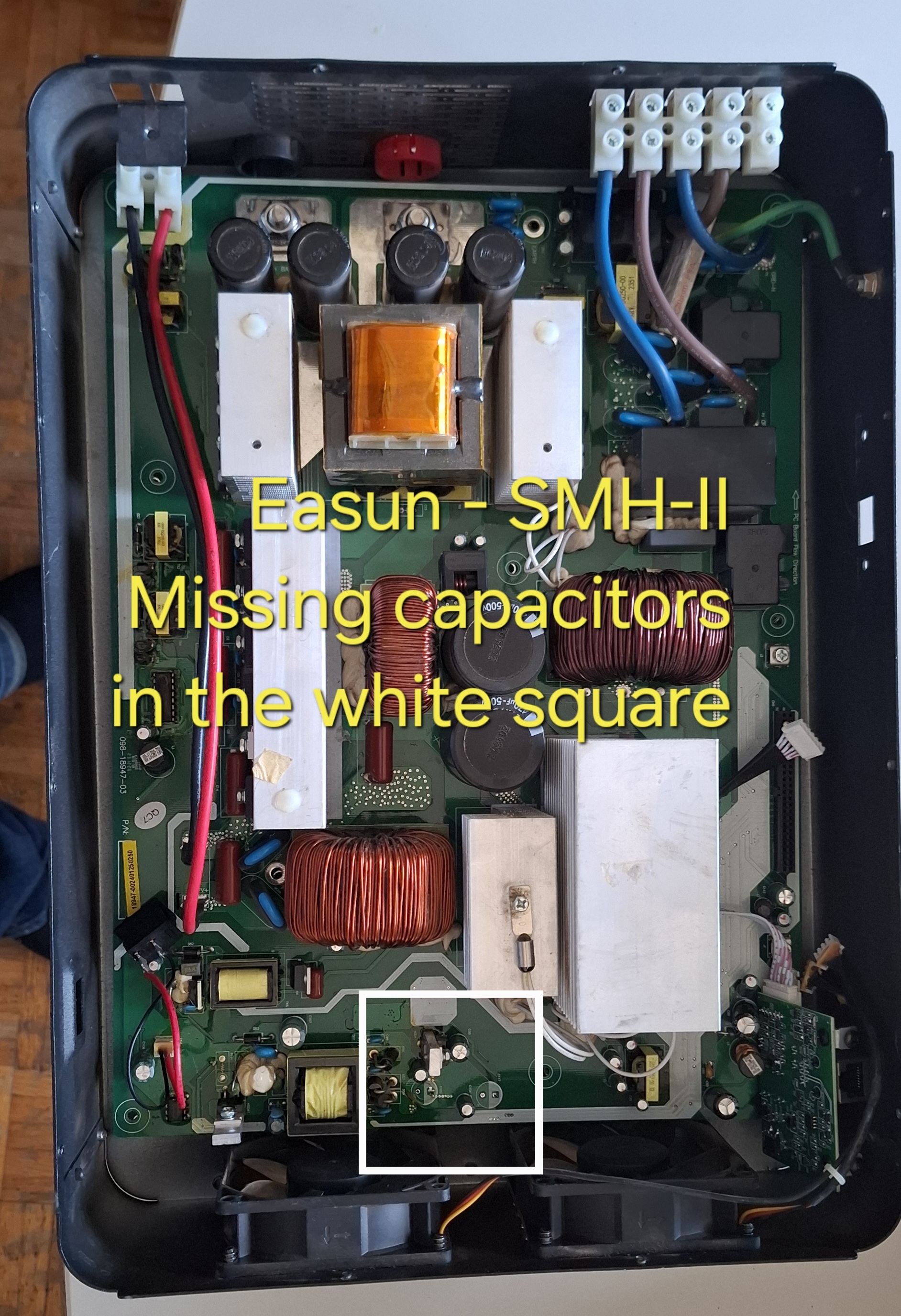

Solar Inverter - SMH-II - 2 missing capacitors
  • Cama
    • Sep 2025
    • 10
    • France
    Solar Inverter - SMH-II - 2 missing capacitors
    I need help to find the value of 2 missing capacitors ( C102 and C117) on my Easun SMH-II mainboard (solar hybrid inverter). I circled it in red on the close-up picture. The 2 old capacitors are completely missing, so I have no reference. Does anyone have this board and can tell me the value or make an educated guess based on the location ?
    My model is : EASUN SMH-II 7 KW
    Mother Board : P/N 18947-002401250250
    Maybe the EASUN SMH-II 4.2 KW have the same capacitors
    Thank you
  • CapLeaker
    Leaking Member
    • Dec 2014
    • 8340
    How would these 2 caps go fully missing? Caps don’t unsolder themselves and fall out. Does this unit work? You can do always “educated “ guesses for a cap based on the height, size, understanding what their function are and what that circuit they are in actually does.
    • Cama
      • Sep 2025
      • 10
      • France
      Dear,
      I thought the inverter had failed due to a battery issue, so I sent it to a repair shop.
      They gave me a repair quote for 50% of the inverter's value, which I refused. When they returned the unit, I didn't check it right away. A month later, I opened it and found that two capacitors were missing.
      I am certain they were removed by the repair shop since i took pictures of the motherboard before to give it.
      I finally found a issue on the battery circuit breaker in my installation, so i think the inverter was working fine
      • CapLeaker
        Leaking Member
        • Dec 2014
        • 8340
        Can you tell anything at all from the other picture that shows these 2 missing caps?
        • Cama
          • Sep 2025
          • 10
          • France
          Hello
          Here 2 pictures of my PCB, one face and the opposite face, you see the missing capacitor footprint , and the capacity of capacitor arround, a tension regulator component 78M05.
          Regards
          • R_J
            • Jun 2012
            • 9607
            I am certain they were removed by the repair shop since i took pictures of the motherboard before to give it.
            Can we see the pictures before you sent it to the so called "repair shop"? If the caps are for the 78m05 they are likely between 47µh and 100µf
            • Cama
              • Sep 2025
              • 10
              • France
              Theses pictures were taken before the shop
              thanks
              • lotas
                • Jan 2016
                • 4787
                • Russia
                Here is an approximately identical diagram, but the serial numbers of the components are different.
                Most likely 1000x16v
                Last edited by lotas; 09-13-2025, 02:51 PM.
                • CapLeaker
                  Leaking Member
                  • Dec 2014
                  • 8340
                  I wouldn’t put 16v caps there.
                  • Agent24
                    I see dead caps
                    • Oct 2007
                    • 5072
                    • New Zealand
                    What a shit repair shop, they should put things back how they found them before passing it back to the customer or to another shop.
                    -David VanHorn
                    • Cama
                      • Sep 2025
                      • 10
                      • France
                      I wouldn’t put 16v caps there.
                      Which one would you advice ?
                      Regards
                      • CapLeaker
                        Leaking Member
                        • Dec 2014
                        • 8340
                        I can read on your pic that it was a 1000uF cap. Get a couple of 25V or 35V1000uF, 105C rated caps and that should fix that. They are definitely a 1000uF these missing caps… they are too big for just let’s say 100uF.
                        • Cama
                          • Sep 2025
                          • 10
                          • France
                          I can read on your pic that it was a 1000uF cap. Get a couple of 25V or 35V1000uF, 105C rated caps and that should fix that. They are definitely a 1000uF these missing caps… they are too big for just let’s say 100uF.
                          Thanks a lot for your advice, i m going to order theses capacitors. Maybe in the delay, i will find a better picture pictures of the pcb sent by an inverter owner.
                          The inverter is able to turn on with an error (code 57), do you think, it will be useful to mesure the voltage ( voltmeter, small oscilloscope) on missing capacitors termination ?
                          thanks
                          • lotas
                            • Jan 2016
                            • 4787
                            • Russia
                            Originally posted by Cama
                            The inverter is able to turn on with an error (code 57), do you think, it will be useful to mesure the voltage ( voltmeter, small oscilloscope) on missing capacitors termination ?
                            thanks
                            Don't even think about turning it on without these capacitors until you've completely killed the inverter.
                            • CapLeaker
                              Leaking Member
                              • Dec 2014
                              • 8340
                              I suppose you could install a different capacitor in the 25 to 50V range from 680 uF fo 2200uF and measure. Iam not familiar with that inverter and error codes, but error code 57 is the battery or charging circuit or both? I think I’d go for the IGBTs with the DMM in diode mode first.
                              you have to be very careful with the oscilloscope on measuring anything on the primary, because you could short something out (BANG!), unless you do have a differential probe.
                              • Cama
                                • Sep 2025
                                • 10
                                • France
                                I suppose you could install a different capacitor in the 25 to 50V range from 680 uF fo 2200uF and measure. Iam not familiar with that inverter and error codes, but error code 57 is the battery or charging circuit or both? I think I’d go for the IGBTs with the DMM in diode mode first.
                                you have to be very careful with the oscilloscope on measuring anything on the primary, because you could short something out (BANG!), unless you do have a differential probe.
                                I will wait to install the capacitors.
                                57 means "current sensor failed" , based on that what i read, it could be a lot things link to the DC.
                                Regards
                                • lotas
                                  • Jan 2016
                                  • 4787
                                  • Russia
                                  Code error 57
                                  • CapLeaker
                                    Leaking Member
                                    • Dec 2014
                                    • 8340
                                    Like I said, I am not familiar with that unit. Can you upload a straight shot picture of the whole board(s)?
                                    • Cama
                                      • Sep 2025
                                      • 10
                                      • France
                                      I suppose you could install a different capacitor in the 25 to 50V range from 680 uF fo 2200uF and measure. Iam not familiar with that inverter and error codes, but error code 57 is the battery or charging circuit or both? I think I’d go for the IGBTs with the DMM in diode mode first.
                                      you have to be very careful with the oscilloscope on measuring anything on the primary, because you could short something out (BANG!), unless you do have a differential probe.
                                      Thanks a lot Capleaker, i have installed 35V 1000uF and it works fine !!!!
                                      Your help was fantastic !!
