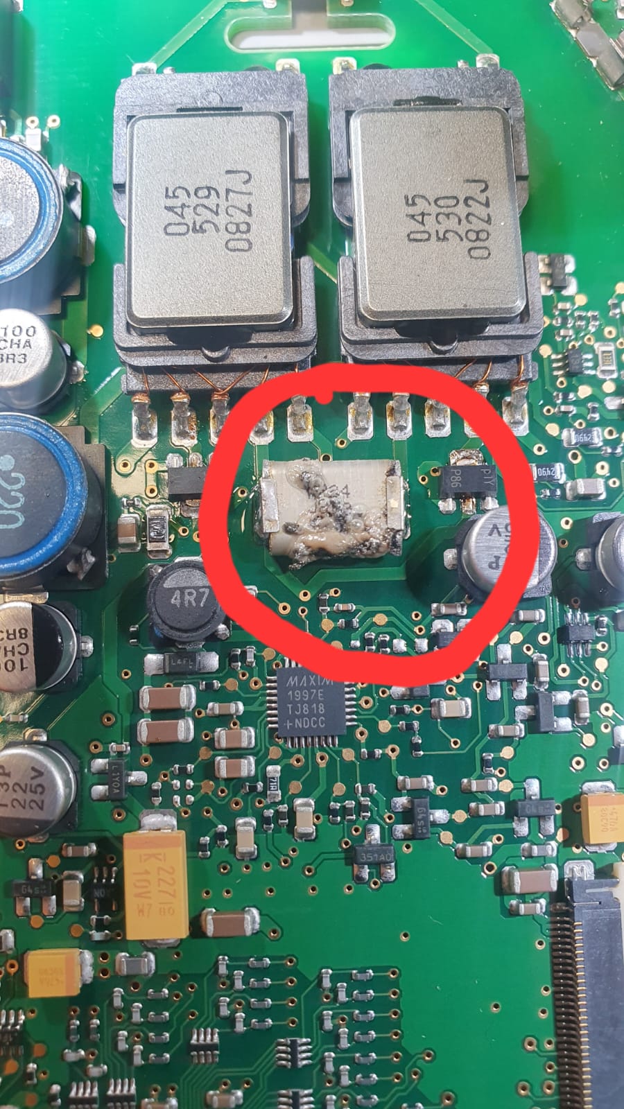

      Hello all,
      Please help to identify this component in red circle. It is a capacitor, but not sure about the type. It is polyester (PET) film? His value seems to be 220nF (224 - hard reading), but also not know the voltage
      Thank you

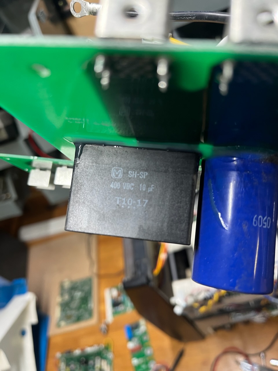

        Trying to locate information on this capacitor so I can workout how to test it.
        From a little research I did on google it was made by Matsushita that turned into Panasonic. Can't find the sh-sp or the T10-17 though. If it helps it is in a Cigweld welder.
        There appears to be 4 pins coming from the capacitor through the other side of the PCB. Did a little googling on that and the form factor might be called a radial box 4 pin but not sure on that.
        Thanks for the help.

          The pins on both sides should be connected together, so you can choose one of the leads on either side and test either using a capacitance meter or component tester. I've attached a picture so you can see how the leads are arranged.
          I'm pretty sure this is how yours is arranged, as it seems to be the standard, but it might be different.

            This is a Panasonic metallized polypropylene capacitor film 4 pins , EZPV series , sp is the type code , T10-17 for date manufacturing .

              Awesome, Thanks for the help andrewsawesomr and jiroy I really appreciate it.
