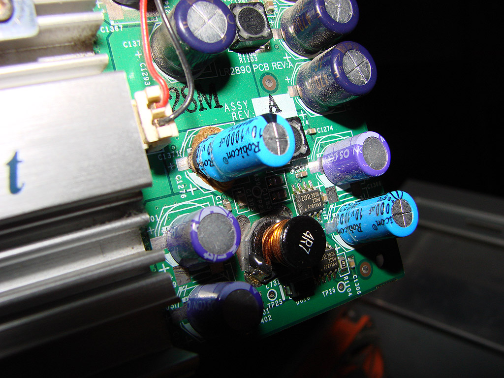

        These babies are "Robicon" (I recapped this vid card 4 months ago) yeah, they lasted a lot... when I got them, I knew these were going to be real crap.
        This is a Leadtek WinFast agp card (gf 4)
        Plagued with bad caps, 6 x "gsc", 2 x "Robicon"... at least it has 2 SANYOs
        How annoying... now I will take care on the replacement caps.

          "Robicon" - that's a good one

              Finally, someone else with light-blue fake Rubies.
              You'd think they'd at least get the name - and the vent - right.

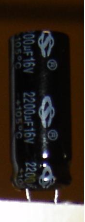

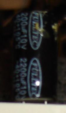

                  Opened a ATNG Power Co.LTD 300W power supply, has bad Fulltec cap and probly a piece of crap too but not sure is a CS or SC
                  look at photo
                  Fulltec one bulged but not leaking (yet) and CS or SC is fine looking but most likly crap.
                  BTW thats glue on the caps not it's inards.

                    I KNEW there was something sketchy about Fulltec. Good find!
