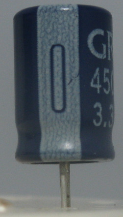

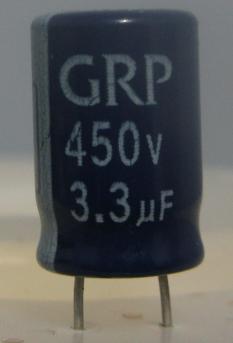

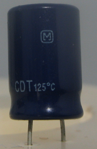

                                    Are "GRP" caps cheap Chinese junk or otherwise? They are apparently made by Zhaoqing Hongyi, but for no reason whatsoever, they put Matsushita 'M' logos on their caps.
                                    Pulled a GRP 3.3uF 450V CDT series from a smashed CFL recently. This one has a Y-shaped vent, a plain flat bung and a Nichicon style negative stripe complete with rounded negative sign, however the negative sign itself is much longer than Nichicon's version.
                                    It seems that there are a lot of Samxon failures going through this thread, are they really as good as people think? Going by the number of blown Samxon caps of varying types, including mine above, they are seemingly of the same quality as the infamous KZG.

                                      Do you have any pictures of it?
                                      • Heihachi_73
                                        • Jun 2012
                                        • 713
                                        #219
                                        Re: List of Bad Cap Manufacturers
                                        Photos as requested. McD's cups make good cap stands.

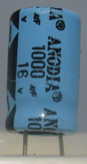

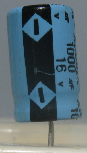

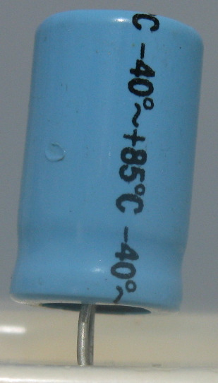

                                          I've never heard of this brand either. This Anodia 1000uF 16V cap was in a dead Telstra TT-300-6B cordless phone wall wart from 1997. Transformer was open on primary (19 ohms on secondary).
                                          The negative stripe is identical to Su'scon. Note the basketball-shaped vent...
