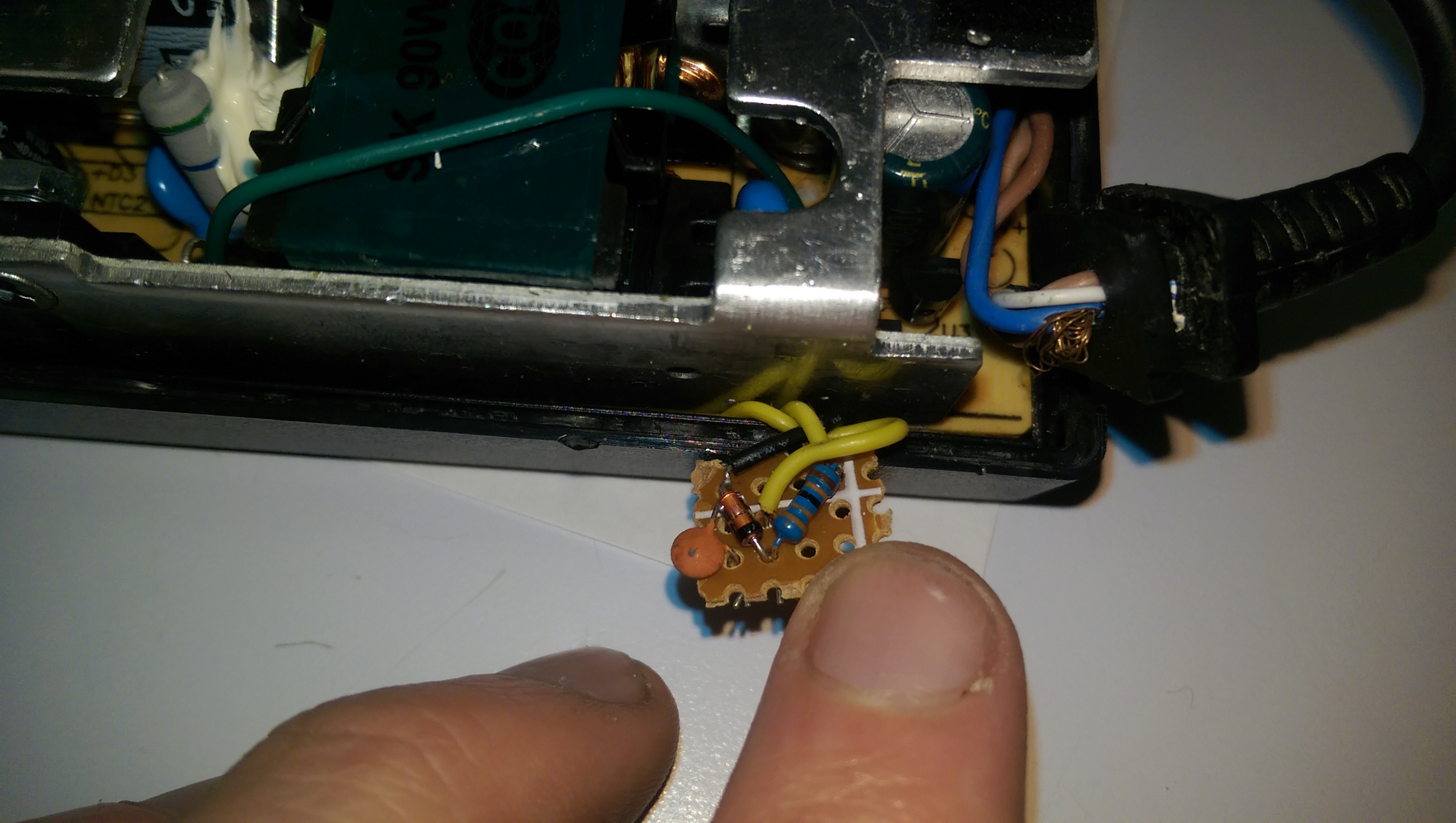

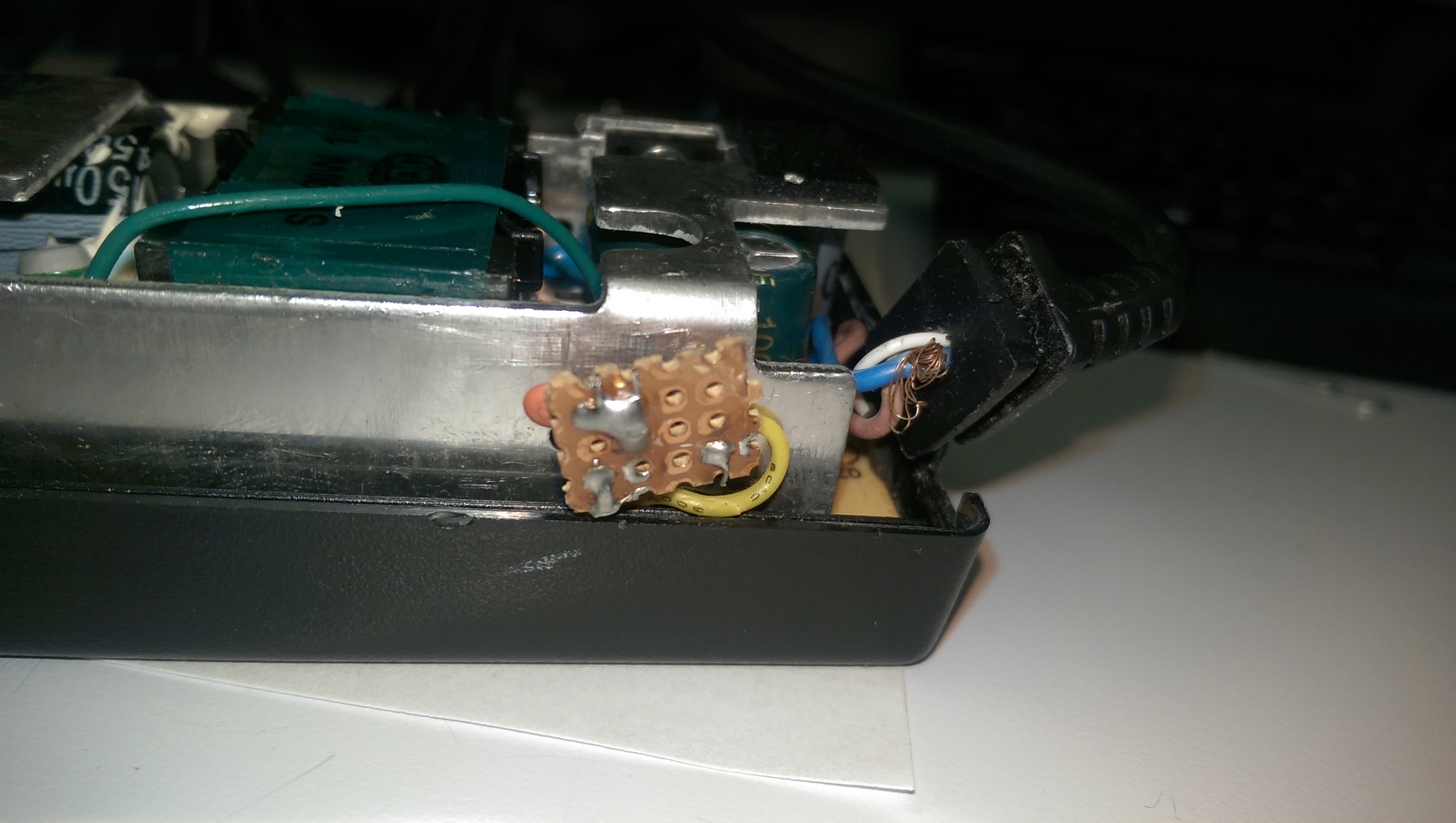

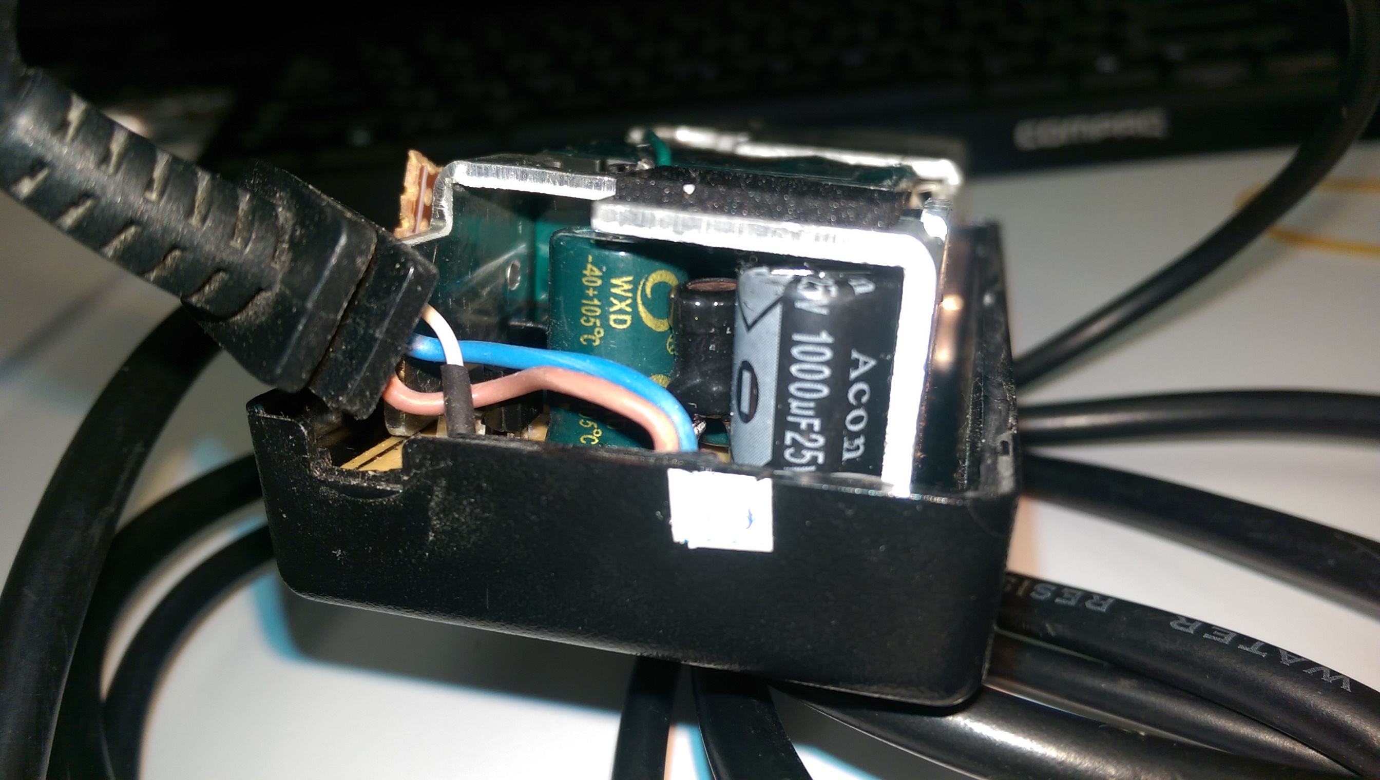

    Spotted these in a cheap 19V "3.42A"chinese laptop power brick. WXD and Acon. WXD might be the series, but that's all I could find written on them without pulling them. Look at this build quality....However, the customer brought it in looking like this, already cracked open and held together by a rubber band. Maybe he messed with it.
      master hoarder
      • May 2008
      • 12175
      • Bulgaria
      #302
      Re: List of Bad Cap Manufacturers
      ^ Yeah, I think he definitely messed with it. Small custom size PCBs are cheap in China, so if this mod/hack was to be done by the factory, they most likely would have used a small, but properly cut board for the job.

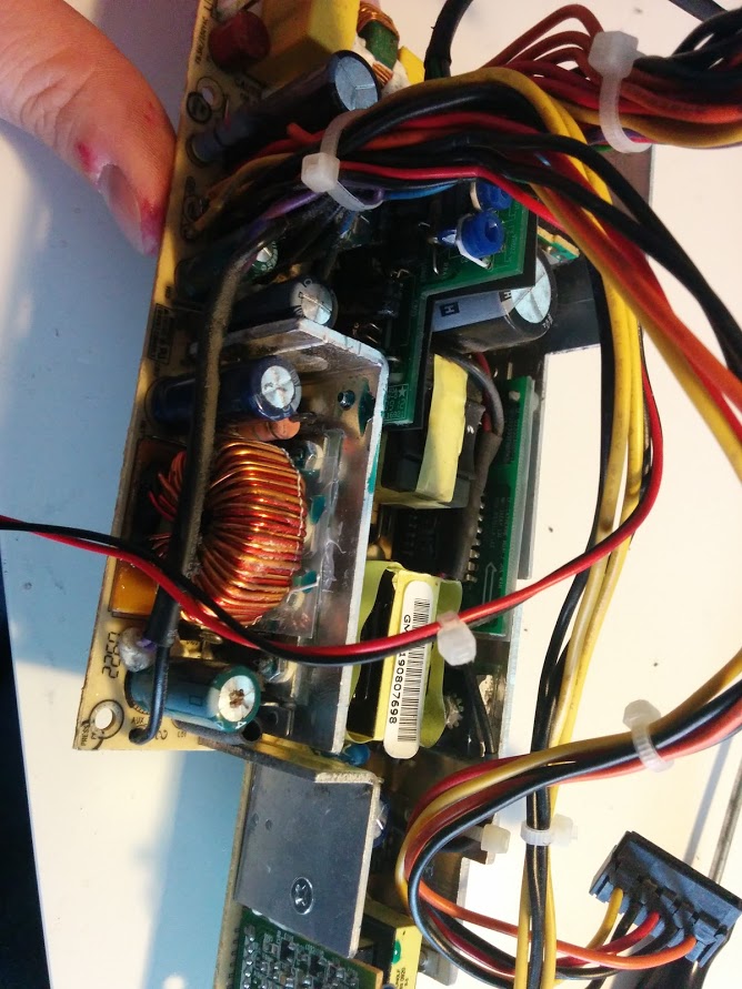

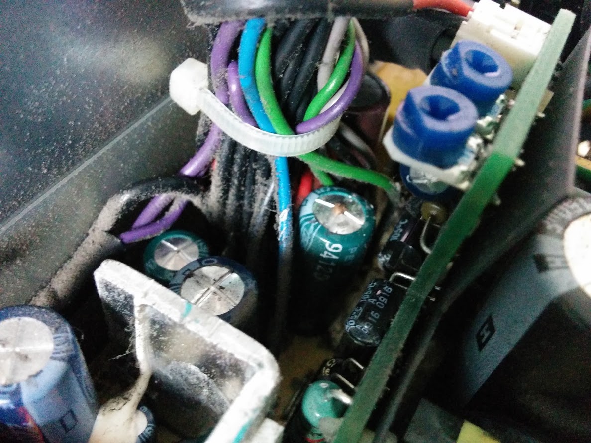

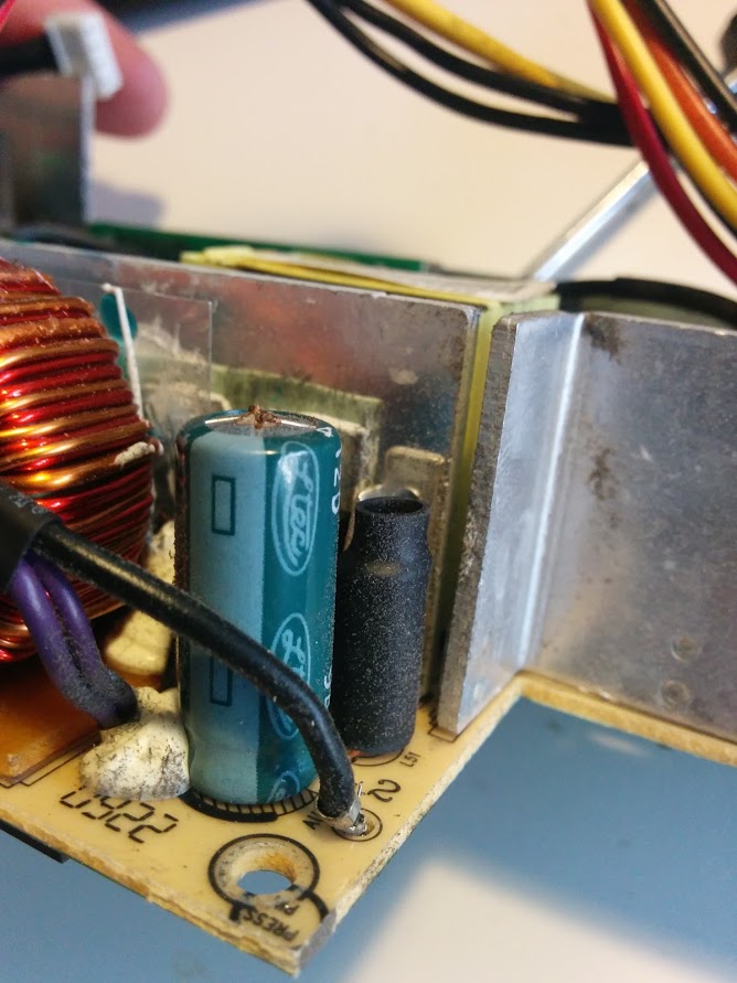

                          Had a sift through the pile of "dead bits" in the office today
                          One dead Dell 745 and one dead GX620
                          The 745 looked perfect motherboard wise, power light was on but nothing when power button pressed.
                          So in the PSU I delved, loads of crusty caps
                          - Ltech? 2200uf 10v LZP's, Ltech 1500uf 10v LXY's and a Ltech 680uf 16v LXY
                          The GX620 was easy to diagnose, all 4 caps around the 12v CPU power are mega crusty 1800uf 6.3v KZJ's
                          No real need to fix them but have ordered the caps because they will only end up on the tip otherwise and are both quite serviceable machines.

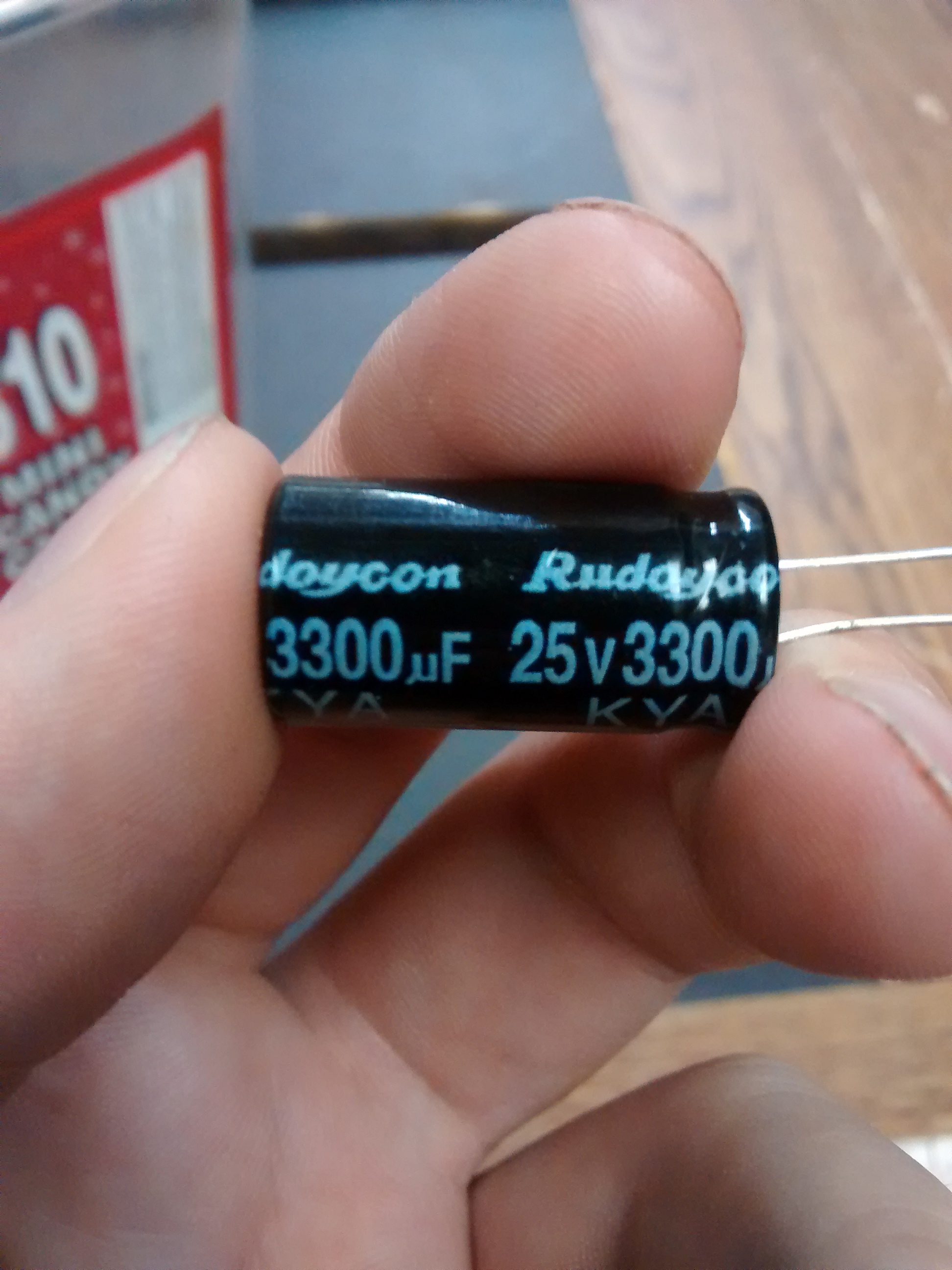

                              Got one, rudoycon. Makes a better resistror than cap. 27pF, ESR retarded high!
                              Follow the white rabbit.
                              • ben7
                                Capaholic
                                • Jan 2011
                                • 4059
                                #315
                                LOL, I've seen that brand before. I figured they were garbage XD
                                Did you take it apart? Is it really lightweight? I wonder what it's like inside. 27pF? ... That's like REALLY crap XD
                                  I don't think you should blame the caps...
                                  ltec LZP are 2000-4000h Lifetime ones, with the 10mm diametre ones with just 3000h lifetime.
                                  That LXY is a tad better than LZP with 2000-5000h Lifetime, but the cap you mentioned is also smaller, so nothing won, also 3000h Lifetime...
                                  Here their datasheets with specs...
                                  http://www.ltec.com.tw/product_e.html
                                  So you can't blame the cap for failing at all...
                                  Because it lasted according to their specifications.
                                  If you want to blame someone, pls blame DELL (or whoever made that PSU) for using cheapish caps instead of more reliable ones...
                                  Using 10mm or more caps on the secondary side helps a lot...
                                  Also using better series like LZF (5-8kh) or LXU...
                                  With using something specified for 2000 or 3000h failing after a couple of years is something you'd expect...
