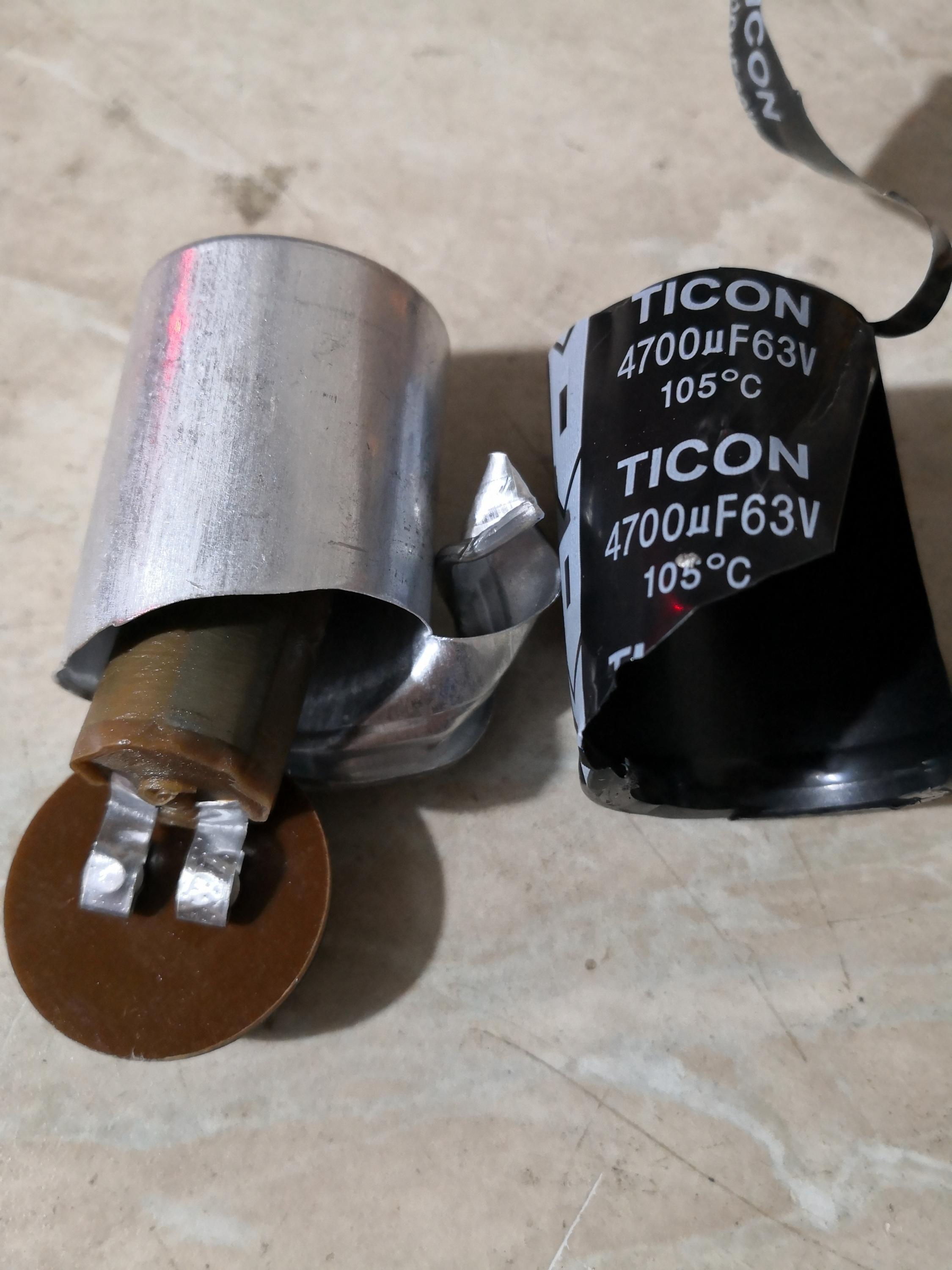

                    inside on a brand new https://www.badcaps.net/forum/attach...=1607258169amp

                      Wow! ^
                      Talk about small caps hidden in big cans.
                      What capacitance did it measure?
                      If it measured 4700 uF, I bet it probably was a lower voltage cap then (like maybe 25V or 35V?)
                      On the plus side, all of that empty space inside the can could allow a lot of gas to build up when the cap starts failing.
                      If you have more of these caps, it would certainly be interesting to subject them to more tests to see how/what they do over time (like maybe install in some inexpensive equipment and abuse the crap out of them, if that's possible.)

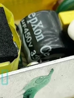

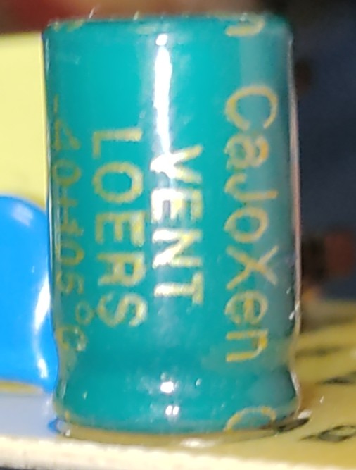

                                        Came across these two recently, CepXon, and CajoXen, both sound like CapXon knockoffs. It's hard to imagine these being any worse than the brand they're knocking off.

                                          "Low ERS"
