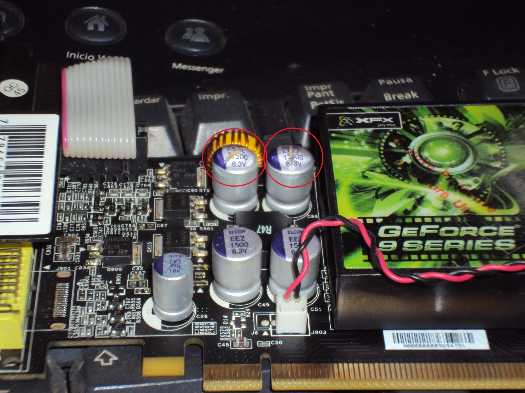

                                      #298
                                      Re: List of Bad Cap Manufacturers
                                      Add Elcon and Samcon on the list! It appears these are the new names for Sacon/Evercon/GSC. The Samcon/Elcon EEZ series is what used to be Sacon FZ. No, I kid you not.
                                      How I came up with all of that?
                                      https://www.badcaps.net/forum/showth...889#post521889
                                      https://www.badcaps.net/forum/showth...600#post521600
                                      ^ The discussions in these two threads made me go around eBay and search for GeForce 7, 8, and 9 series with Sacon FZ caps (and I've done this many times before). However, this time I found a 512 MB XFX NVIDIA GeForce 8500 GT (PV-T86J-YAH7) with some shady-looking Elcon EEZ caps. I then googled Elcon EEZ and found very few, but useful results.
                                      First, a 9-seires video card with popped and oozing Elcon EEZ caps:
                                      http://www.taringa.net/pachenco/mi/ZY2g3
                                      Quote from the person in that post (via Google translate):
                                      "Hello ... I burn the video card ... those things exploded and I have no idea if it is fixable! If anyone ever hear sound explocion equal to that chasquiboom do I keep it in consideration!"
                                      Also, those popped Elcon EEZ look similar to how Sacon FZ pop and die. The only difference being that the Elcon EEZ have purple text and marks and a slightly different X-like-looking vent. I attached a picture off of that link above so that we have it here for future reference:
                                      I then found these two posts:
                                      http://www.rom.by/comment/316643&usg...dBgrYxz6RgMwaw
                                      http://www.rom.by/comment/316152&usg...ChAyMHXxEO3UeA
                                      If you Google-translate them, you will find in the first one, someone says that Elcon EEZ are standard eletrolytic caps and not polymers, and they even dissasemble one (picture attached below). In the next link, the person gives a datasheet to Samcon EEL. This made me search Samcon EEL. Found their website here:
                                      www.samcon-hk.com
                                      If you click on "Company" once you enter their website, it shows a picture of both the Samcon and Elcon offices/factories/HQs. Again, I am attaching a picture of that as well, since the comapny that makes these crappy caps tends to change its name quite often and then make its website go down.
                                      Actually, with that said, the Elcon site was almost fully down (sans some jiberish Chinese characters), but with a bit of Google translate, the same capacitor series names appeared as on the Samcon website.
                                      So, with that in mind, this proves the link between Samcon and Elcon. And the way those caps appear to fail, it seems that we found the same company that makes (or used to) Sacon/Evercon/GSC caps. What do you all think?

                                        #299
                                        Really excellent work, thanks for sharing!
