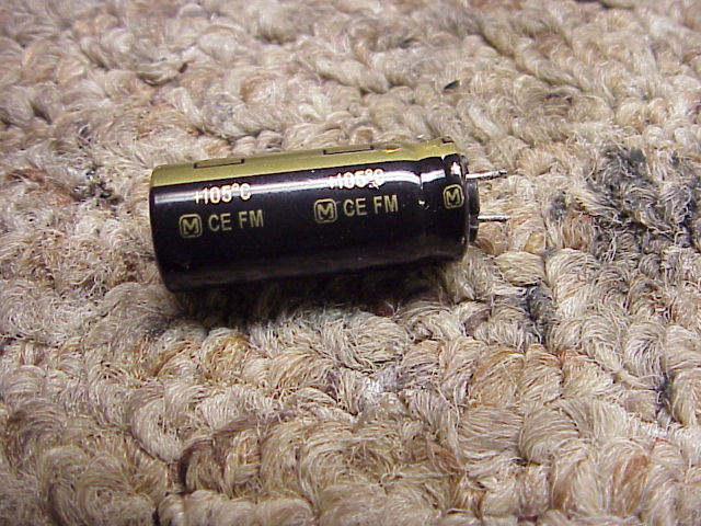

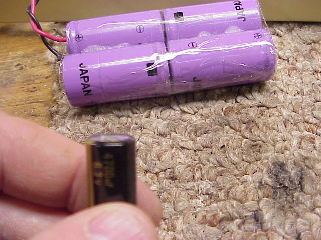

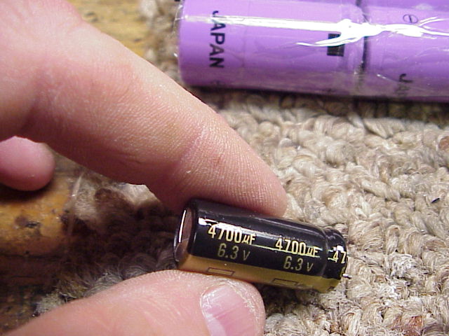

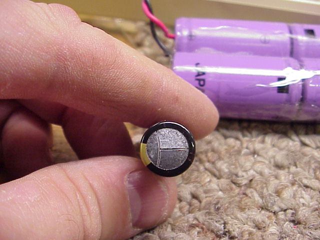

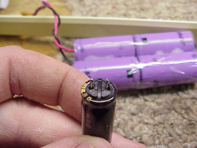

panasonic fm failure in 5 minutes!
  • kc8adu
    • Nov 2003
    • 8832
    • U.S.A!
    it was NOT installed backwards!
    a replacement did not fail again.

    Re: panasonic fm failure in 5 minutes!
    looks genuine also
        too bad, maybe just a bad one of what.. a thousand, ten thousand... bound to happen, though not as frequently as the "other" guys cap I guess.
          I agree - the presence a single defective unit among thousands (which this clearly was) is not surprising in any mass-produced product. The only way to avoid this would be for companies to test each unit before shipping it, which would raise the cost very considerably.
          On the theme of Low-ESR capacitor reliability though - I must confess I've never seen, or heard of, a failed Sanyo WG. Had my personality been different (and were I 10 years younger), I would be a Sanyo fanboy.
            now that i think about it the sleeve might have been on backwards from the factory.
            of 5-6 hundred of these i have used in the compaq psu with the 4700 suscon i have yet to have a comeback.
            you can bet i will look at the lead length on each as i install now!
                  That is amazing - 5 minutes to failure. I tend to suspect either a sleeve issue or a manufacturing defect. Even if you subject the parts to 3 or more times their rated ripple current, it can be several hours (or several hundred hours) to catastrophic failure.
