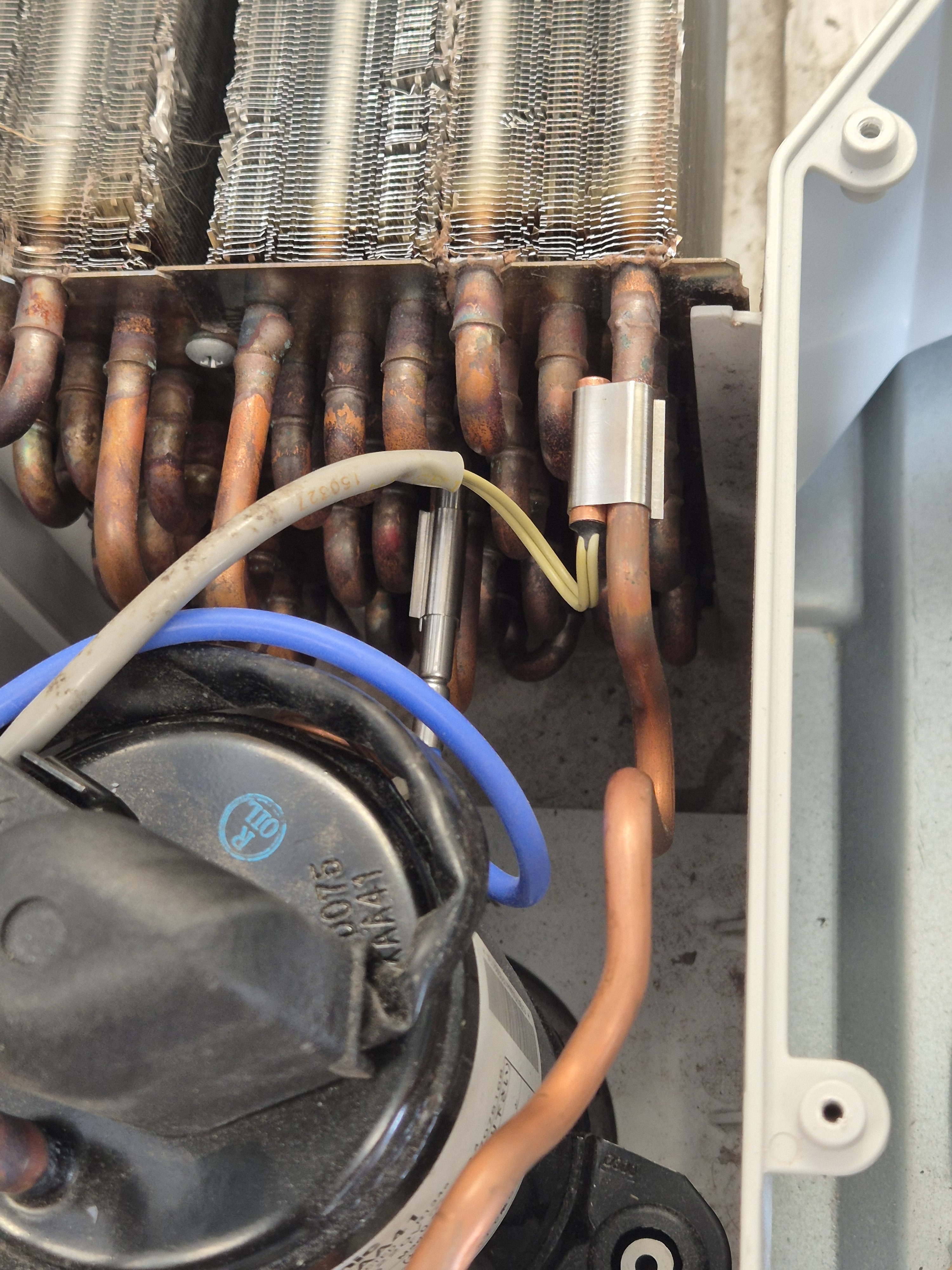

    I picked up a Panasonic NH-P70G2, though it would apply to the NH-P80G2, NH-P70G1 and NH-P80G1 models as well, as maybe some other models. This one was coming up with a H86 error. After lots of testing and googling it was an error with one of the thermistors in the condenser area.
    The attached French service manuals is incorrect, TH11 is gray and is a 95k thermistor and TH12 is black and is a 35k thermistor.
    In my case TH12 was bad. I was able to get a 35k thermistor on AliExpress. It's 6mm in diameter.
    Unfortunately the whole machine has to come apart to fix it.
    I have attached some files to help other people in the same situation.
