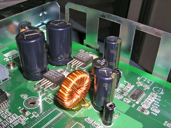

    (Photo from recapping of a 3com officeconnect 8 port hub)
    Panasonic FC. Note the T vent marking which is exclusive to panasonic. Note the M character in a box which indicates Matsushita the parent company of the panasonic brand. Note the navy colour, they also come in black, note the gold negative stripe which is on both colours. Note the FC after the +105oC which indicates they are FC range. There is also FA series which is better but FC series is excellent for motherboard applications and general availability is good.

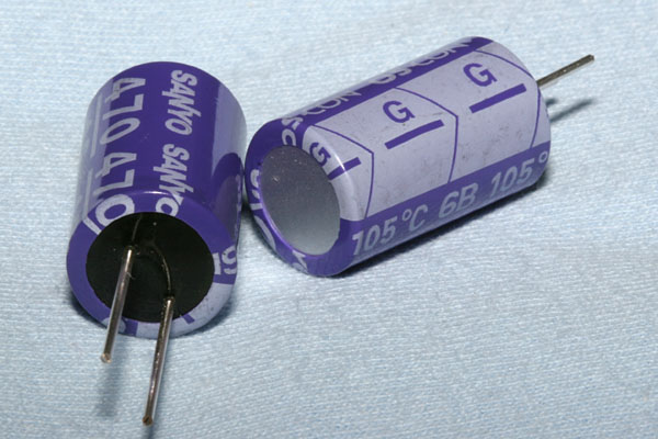

    Polymer Capacitors - Radial Lead
    Sanyo OS-CON Polymer capacitors : These do not have electrolyte they have polymerised organic semiconductor instead, so do not have the same failure problem. Therefore they do not have a vent on the top even though they are Low ESR. They are much more effective than electrolytic caps so you need lower values than before. Expensive caps.

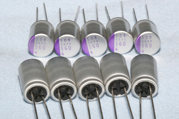

    Sanyo OS-CON SEPC Series. Sanyo's top polymer series typically found on vcore of high end boards or on graphics cards.
    (Photo of HP serverboard from DL380G4 server, original caps)
    Sanyo OS-CON SP Series. Note that they clearly say OSCON on them and the SP series is clearly indicated. The strange purple colour is exclusive to most of the series of OSCON caps. These are available in larger capacitance than SEPC but the ESR is higher though. The leads can be too big for the holes on some boards or graphics cards though.

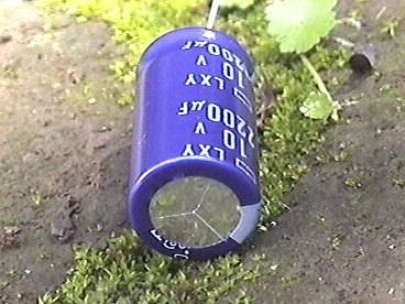

          United Chemicon LXY
          They are not the lowest ESR on Chemicon Series caps, but suitable for PSU or VRM input. They have long endurance. For smaller size and almost same spec (almost same shiny color too), use Chemicon LXZ.

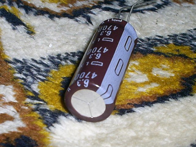

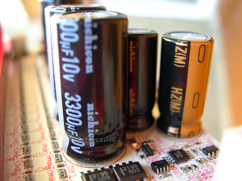

            Re: The Good Capacitors Photo Thread
            Nichicon HZ (top Nichicon model and by specs, far superior electrolyte cap ever) in my Sapphire "Grouper" A9RX480 mainboard
            (the 3300uF 10V one is Nichicon HD one - still very good cap, yet HZ is the king of caps )
            Nichicon HZ 1800uF 16V - impedance 0.006.5 - ripple current 4140 (2000 hours) 10x25
            Nichicon HD 2200uF 16V - impedance 0.018 - ripple current 2770 (5000 hours) 12.5x25

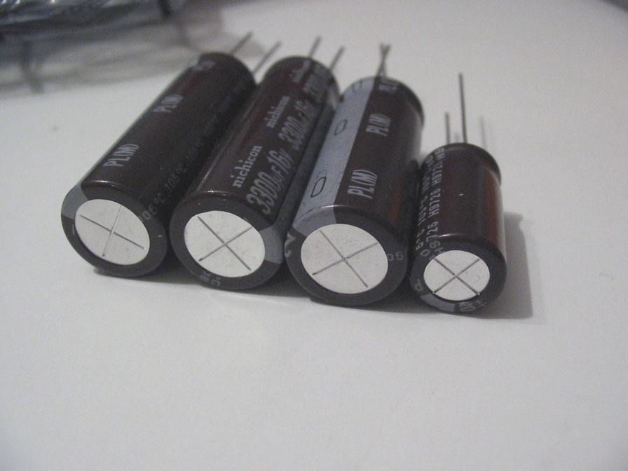

                Nichicon PL and PM (1st pic)
                Dark brown jacket with grey text, white datecode. Normal X-shaped vent.

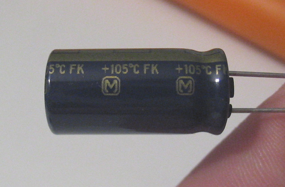

                Panasonic FK (2nd and 3rd pic)
                Dark blue jacket with gold text, red datecode. T-shaped vent.
                I use mostly Nichicon PL/PM but just got some Panasonic FKs for places requiring smaller can sizes.
                Has anybody got a datasheet for leaded type Panasonic FK?

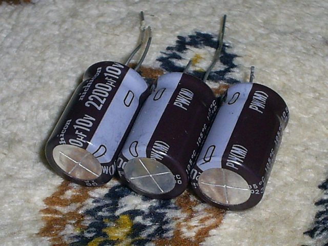

                    Nichicon PW
                    Nichicon PW is smaller than PL. In this picture, PW cap is in the middle.
                    Nichicon PW Capacitor Datasheet
