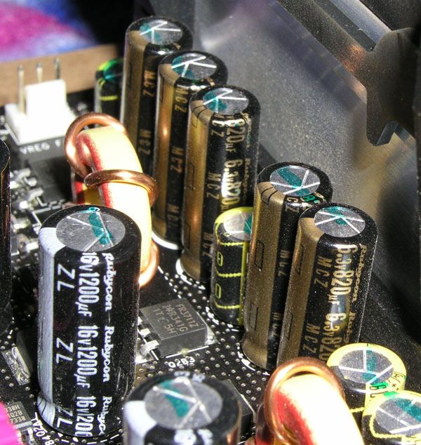

(Photo from Intel D875PBZLK motherboard, original caps)
Rubycon MCZ. A row of black with gold stripe Rubycon MCZ. Rubycon's top series

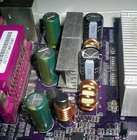

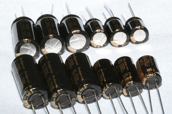

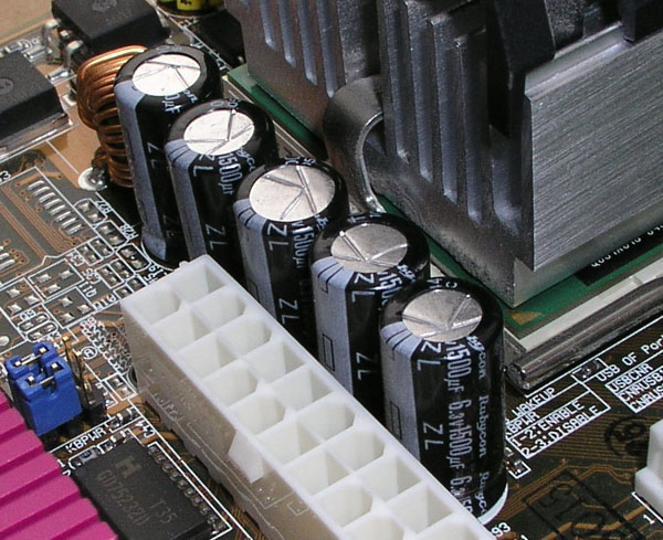

(Photo from an Asus CUSL2-M motherboard, original caps)
Rubycon ZL. A very popular series for motherboard applications. Note the Black colour, The Rubycon K vent marking (many other companies use K markings though, note the style of the Rubycon K marking and that it is quite a deep thick cut unlike the counterfeit ones) also note the Rubycon logo and the cap range namely ZL is clearly noted. Along with Panasonic FC series, general availability is good. ZLH has longer life than ZL series though at the same ESR rating. ZA/ZLG series are the next step up in lower ESR than ZL/ZLH with ZLG having longer life than ZA.
