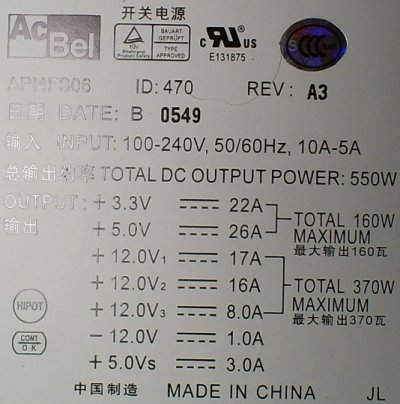

                        Thanks to the person who posted pics.. I have never gotten around to it, and i had resized them before i attempted to post them here. Just timed out everytime.. Anyway, it's quite an impressive PSU, caps nonwithstanding.. Even so, i've been running it for over 6 months with no nastiness.. You'll also notice, it has independant regulation on +3.3, +5, and +12V.. Just look at the 24 pin ATX connector, and you'll see an extra "sense" wire in place on one of each of them, sensing the voltage at the motherboard level.. Don't see that very often either...

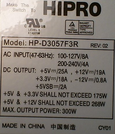

                                        I now have 2 of these Acbel power supplies, and they are indeed impressive.
                                        The issue of the 4-pin motherboard connector was resolved by building an adapter. I just desoldered the P4 connector from a dead board, and snipped the plug from a junk Powmax. Soldered them together to make a short P4 extension cord, which solves the problem of the 8-pin plug bumping into components on the 4-pin board.
                                        Unfortunately, I don't think it's working out with my motherboard.
                                        Here's the hardware it's been hooked up to:
                                        ABit AN7 (late nForce2 socket-A)
                                        Barton mobile at 2100/200mhz (1.65V I think)
                                        ti4200 128MB video
                                        2x 512MB ddr400 (each double banked)
                                        1x hdd, 1 cdrom drive.
                                        I was previously using a HiPro 300W. It worked with voltages in tolerance for about a week, then I had a spontaneous reset. I checked the voltages again and found that my 3.3V line had dropped to about 3.08V. So apparently it was overloaded and got ruined.
                                        I switched to a Sparkle/FSP 300W, voltages were within tolerance but on the low side. It seemed to work fine for a few days but I wanted something with more guts.
                                        Finally got my Acbel 550W, and voltages were very good. All rails were on the high side of tolerance, except the 3.3V line which was 3.28V.
                                        It's been running for a few days, now I see my 3.3V reading has dropped to between 3.20-3.22V. The "3VDual" voltage is worse, at about 3.17V. All other rails are still as strong as ever.
                                        I compared the labels on the AcBel and the HiPro, and I guess I can see why I'm still having a problem:
                                        HiPro 300W:
                                        3.3V 18A
                                        5V 25A
                                        3.3+5V max 175W
                                        AcBel 550W:
                                        3.3V 22A
                                        5V 26A
                                        3.3+5V max 160W (I knew it was optimized for 12V... but damn)
                                        So as great as this 550W psu is at the 12V side, it could be disappointing for older boards.
                                        I guess I need to unplug this tank before I ruin it, and go back to that old Sparkle. I'm disgusted.
                                        Is there any simple improvement that would beef up the 3.3V line on this thing? I could probably turn up a pot, but I don't think that's going to keep it from dying.

                                          Build a 12v to 5v regulator IC into the 4 pin lines to your drives. (1 amp at 5v per drive.)
                                          Clip the 5v wire to that bundle coming from the PSU and power both the 5v and 12v at the drive end with the 12v from the PSU.
                                          This way you power both the +5v and +12v to the drives off the 12v rail and unload some work from the 5v line in the PSU.
                                          You take about 4 watts/drive off the 5v rail that way and you are still pulling less than 2 amps/drive off the 12v wire.
