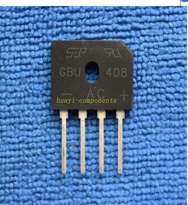

    Today I started to test the power board by checking the voltage coming form the power board to the main board. The voltages (+12 and +5) checked out correctly from the power board connector to the main board. I decided to see if there was any continuity at the GBU408 bridge rectifier. The odd thing is that there is brief continuity between the (-) and (+) legs for about one second, then it stops. I don't know if this is normal or not since I'm still learning the basics of electronics.
    Below is an image for a GBU408 bridge rectifier for reference:
    Does anyone have a recommendation as to what to check next? I know the TV has low value, but I like how it has so many video connection options since the computers I tend to work on have a wide array of video connection requirements. I actually did buy an identical replacement from ebay that works, but I'm not fond of swapping boards in the event that a problem on one board has killed the other. Plus, I like to learn things.

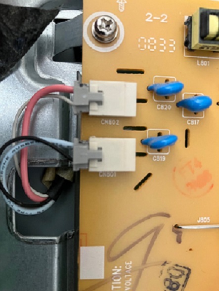

        Now, since I'm still learning, please see the attached photo and let me know which pin inside the connector on the top should I connect to with the positive probe. The pink wire pin on top, or the white one below it? I tried to see if either was ground via continuity test, but got nothing.

          That's the wrong one, it's CN902, the same connector you would be testing for your 5 and 12 volt, which you already tested for 5 and 12, now just test the on/off pin as described.

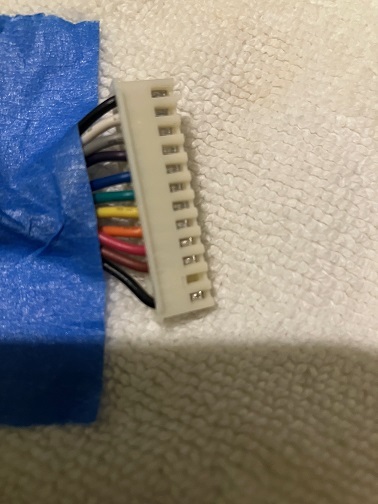

            Below is a photo of the connector I did the testing on directly with the other end connected to the power board. The top two wires are +12v (black & white), the next two are GND (gray & purple), the next three are +5 (blue, green, yellow), the next two are GND (orange.& red), the next one is NF (brown), the next one after that is not connected, and the last wire is on/off (black).
            During the testing of the on/off, I got no reading with the TV in standby mode, and no reading for when the power button was pressed as well. I did this multiple times, and even tested the +12 & +5 lines as well (they are good). I got nothing each time I tested\ the on/off.

              Not the correct method, do it like he does in the video in post #3, everything connected and probe on the connector contacting the metal part.
              • nomoresonys
                • Jan 2013
                • 12157
                • U.S.
                We are trying to see if the mainboard is sending on off signal to powerboard, can't do that with mainboard unhooked.

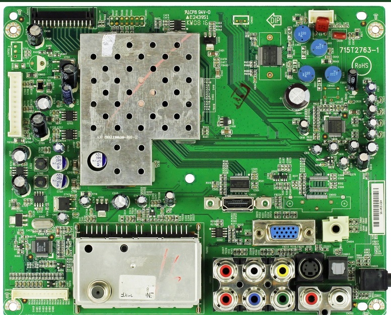

                                Is that the model with a bunch of electroltics on the mainboard? This is where that testing with 20k ohm setting could come in useful, easy method to test many caps quickly. The thing about buying replacement boards is most of them are just yanked out of similar aged tvs with the same old caps in them, unless someone recapped it.
                                • cajoeg
                                  TV_Newbie
                                  • Feb 2025
                                  • 22
                                  Yes. Below is a image of the mainboard. I agree that the so-called "working" mainboard likely has the same age components.The seller stated that it came from a working unit with a broken screen, and that their technicians tested it. For $25 plus shipping, I had to take a chance.
                                  I just now tested a few capacitors on the extra mainboard using that method, and they show that they are good. Interesting method! Unfortunately, I put the TV back together in anticipation of waiting for the new capacitors to arrive, I also am cleaning up my den from the recently acquired TRS-80 computers, and the anticipation of 3 Timex Sinclair 1000's I got for a great price, and one TRS-80 Model 100. So I'll have to wait before I open up the TV again to work on it.

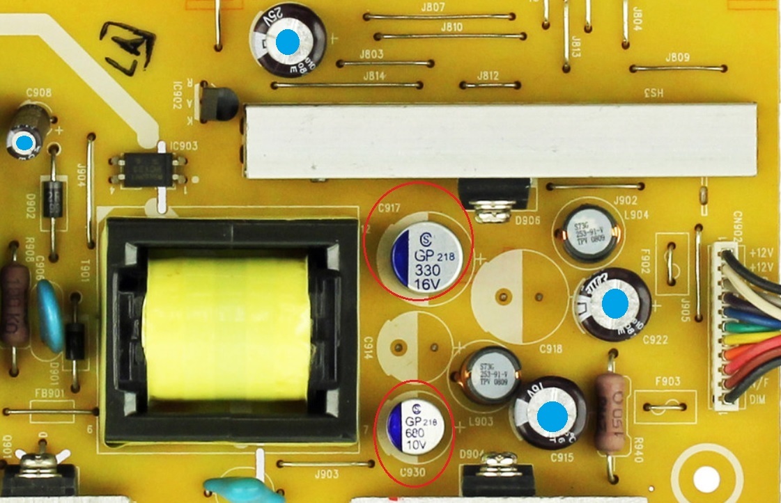

                                    Okay, back at it while the wife took the grandchildren to a park for a a few hours.
                                    I replaced four capacitors on the power board. I attached a photo showing the four I replaced that have a blue dot on them (used MS Paint to apply dots in photo). Even though they tested good, I replaced them. There's a very large capacitor that tested good while still on the board. I reinstalled the board and tried to power up again. I didn't expect any change, and there isn't any. Still flashes the LED.
                                    There's also two components that I don't know what they are. I circled them with a red circle. Are these some type of capacitors that I'm not used to seeing (in computers)?
                                    I'll watch more of the aforementioned basic diagnostics video to learn how to test the bridge rectifiers properly. After that, I might even swap the power board from the good TV and see what happens. At least then I might be able to identify if the problem is on the power board or not. I still don't like that idea given the potential risk.

                                      Yes those are caps. I think I would test all those caps on the mainboard, go ahead and test them on both mainboards see if you find any differences.

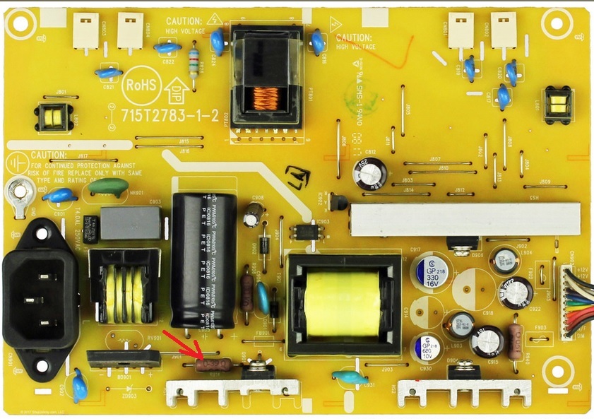

                                        I found a short at a resistor near the bridge rectifier. I got continuity on the resistor each time I checked it. Today, I removed the resistor and checked it again. It still has continuity. It's a 39 Ohm Resistor, 2W 5%. Of course I didn't have one in stock, so I ordered one. Here's a photo of the power board and the associated resistor:
                                        I also removed the bridge rectifier for more accurate test results. It appears to be good. But I'll be replacing it as well just to give it a new part.
                                        When I get the parts in, and soldered in place, I'll test the board again.
                                        Joe
