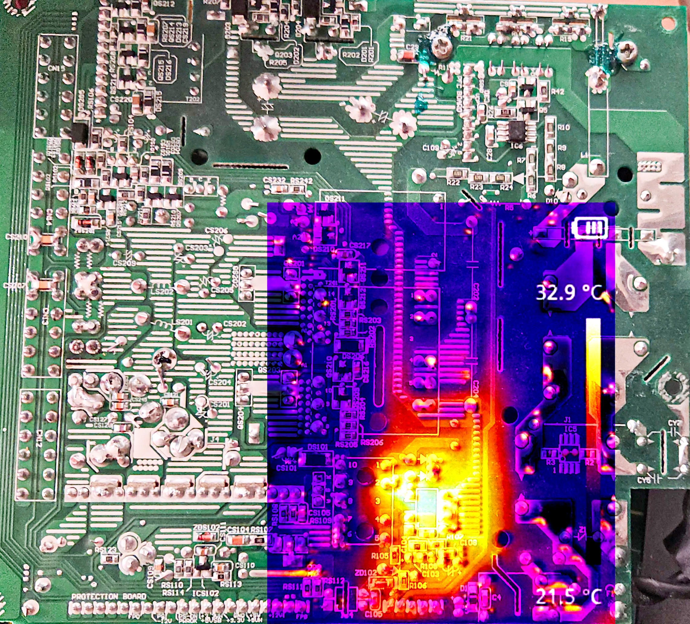

    Hi there,
    a friend of mine gave me a BeQuiet Dark Power Pro P10 550W PSU.
    The problem: The PSU simply switched off during operation and never came back on.
    My observations / measurements:
    I opened the housing and checked for obvious damage -> negative. Visually, everything seems fine.
    Lowcost power supply tester (China):
    No result. The power supply does not turn on and the tester keeps off
    Next, I measured the 5V standby line (pin 4) on the ATX connector.
    Result: Not present (!).
    Obviously this seems to be the problem why the power supply no longer comes on.

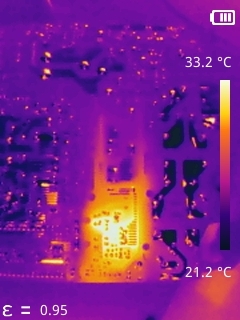

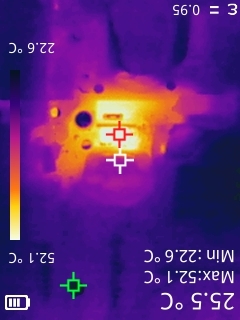

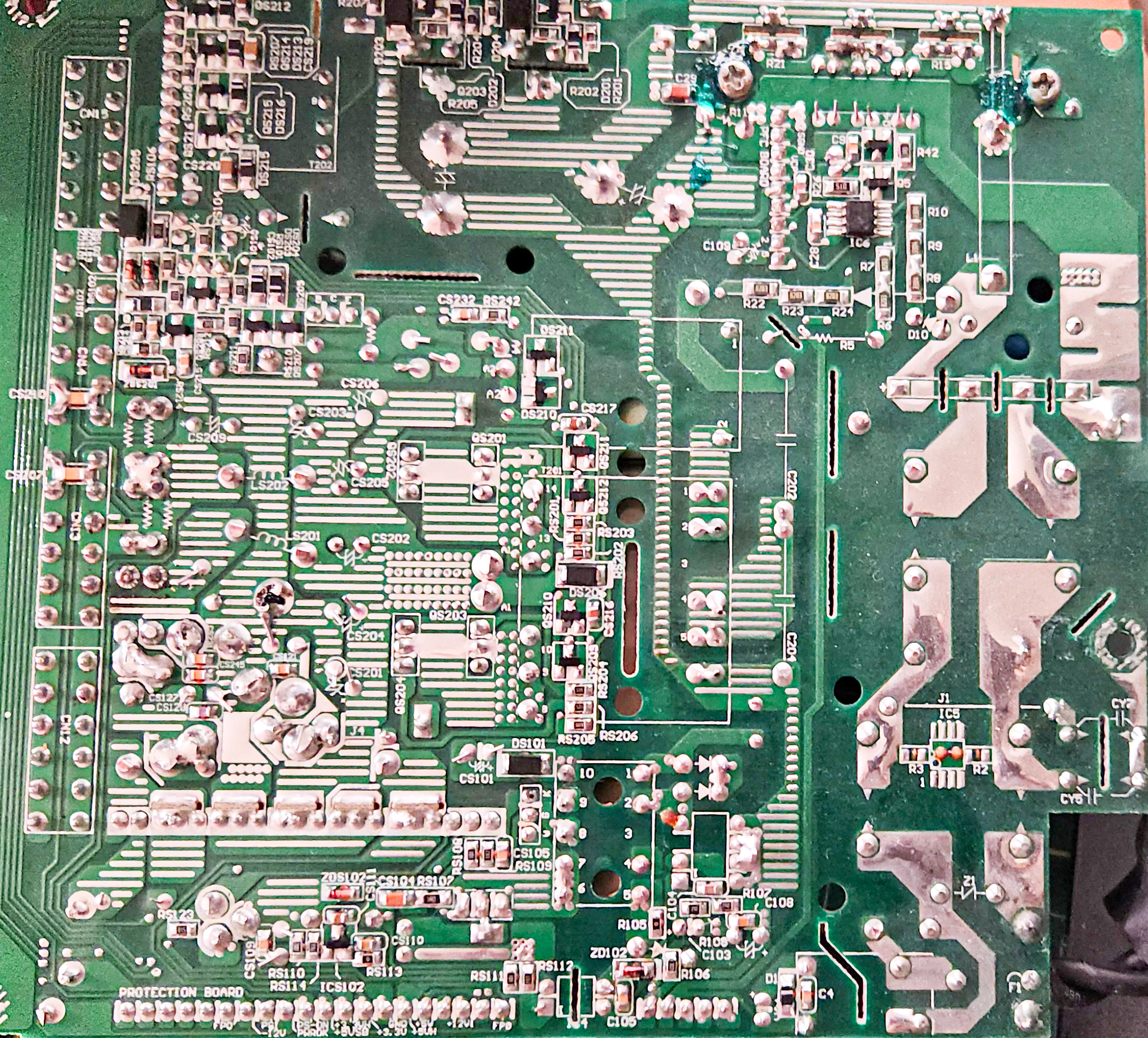

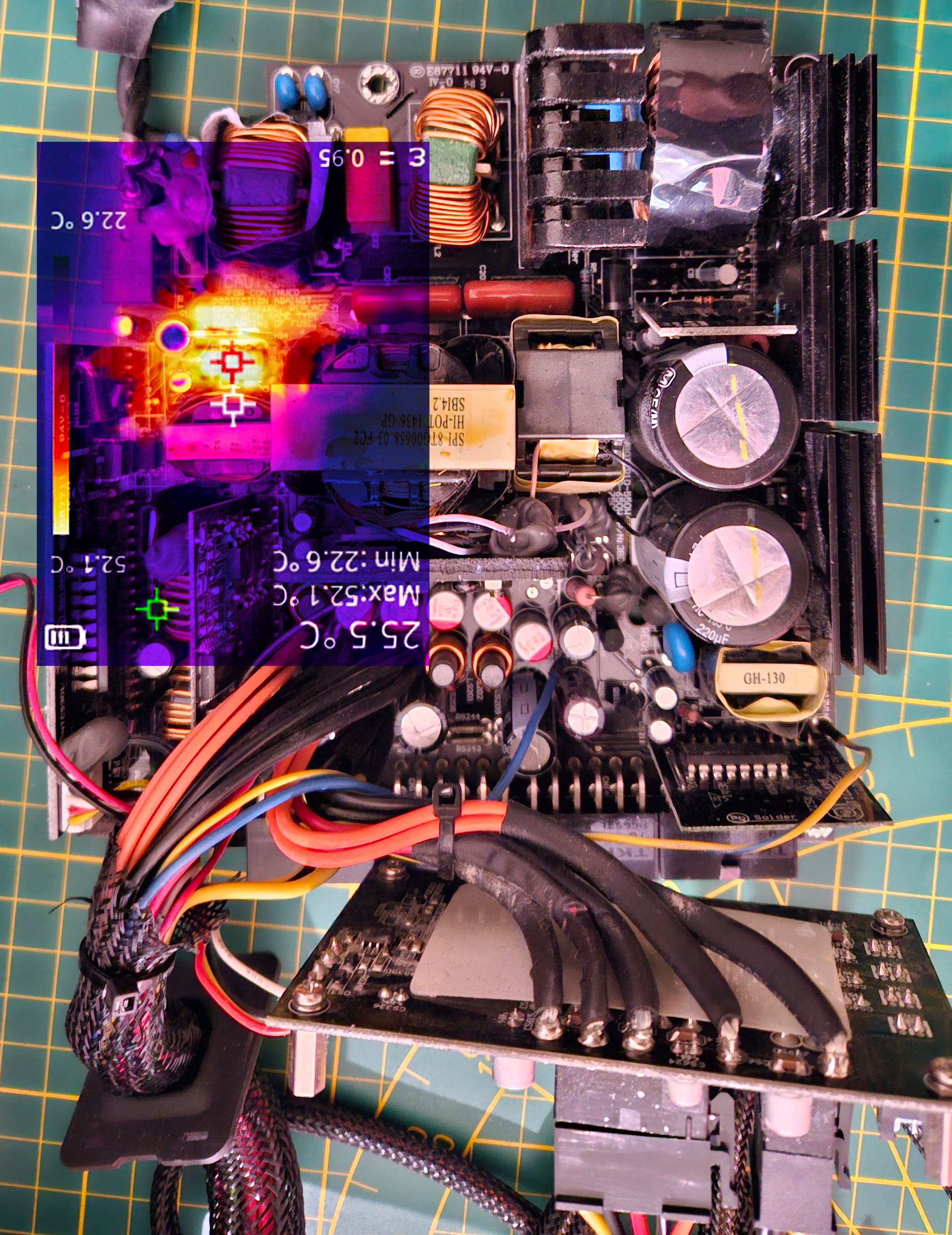

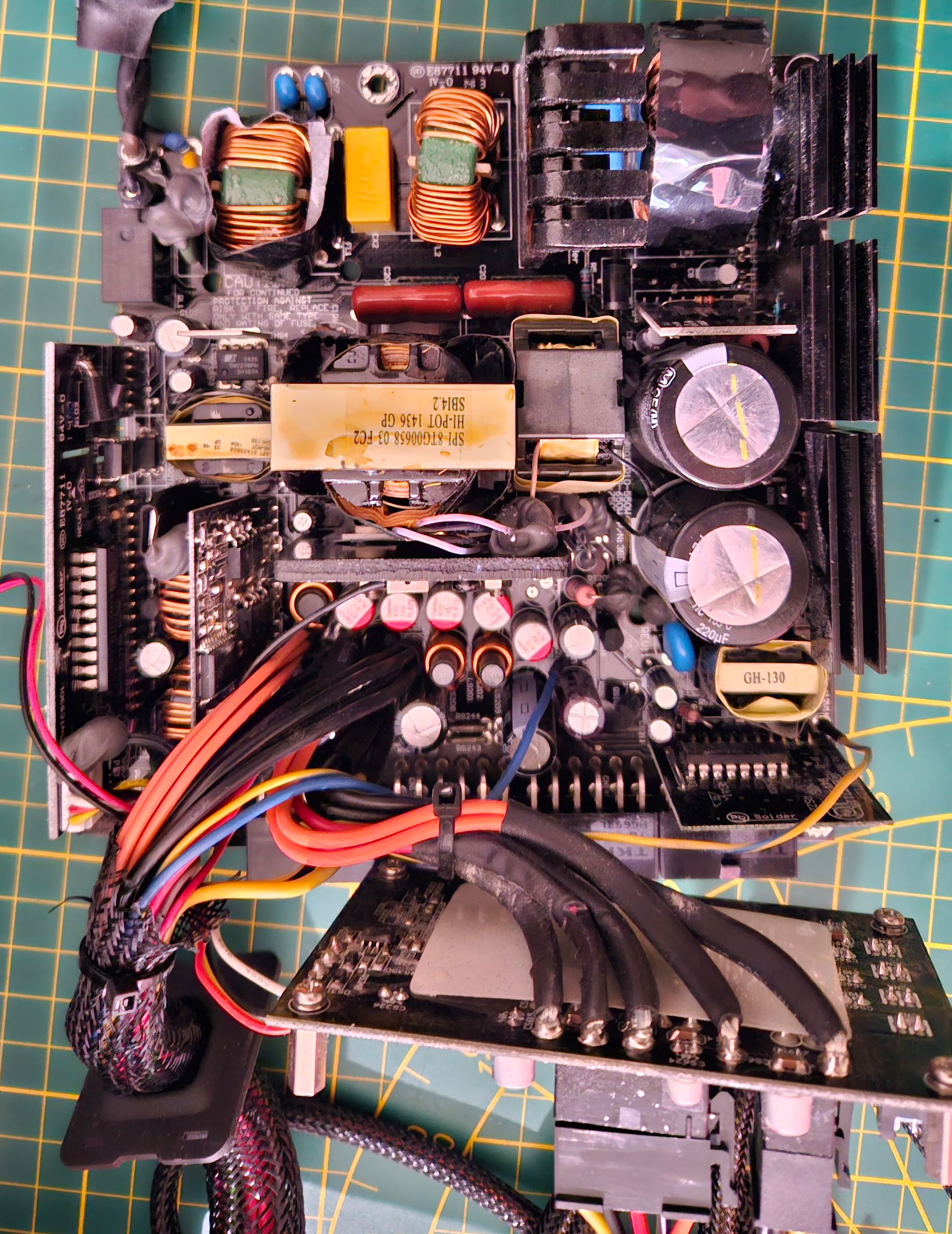

    Following some pictures...
    Top view

    Bottom view

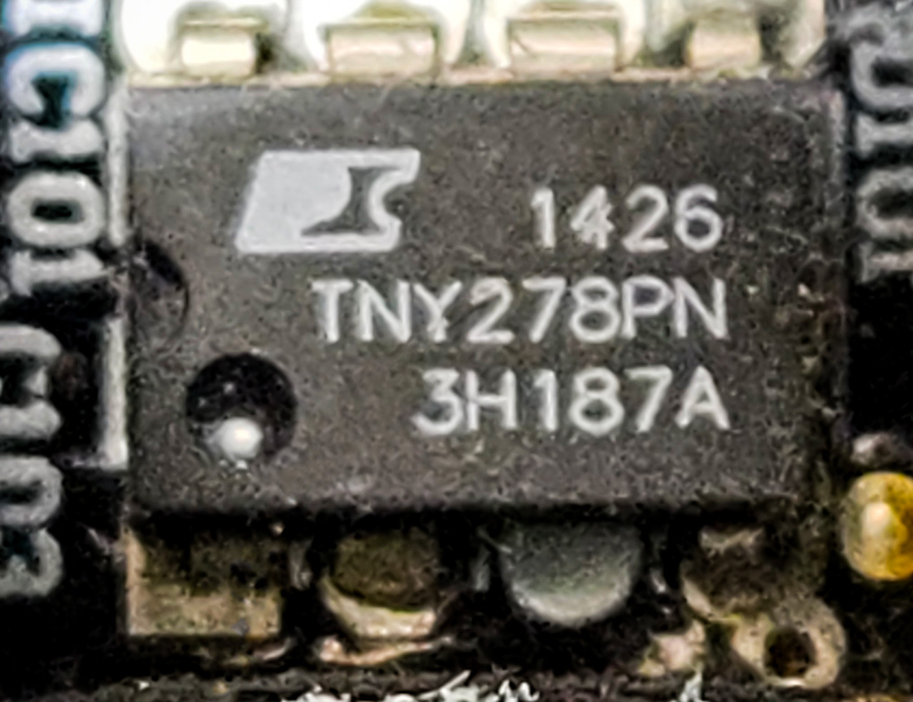

    The hotspot seems to be coming from this candidate:
    TNY274280
    Datasheet: http://bg-electronics.de/datenblaett...TNY274-280.pdf
    Pin 5, 6, 7 and 8 are connected - as per datasheet
    What I noticed is a connection between Pin 1 [EN/UV] and Pin (5, 6, 7, 8) [Source].
    Could this be the problem? I carried out the check in the built-in state.
    Can anyone give me a tip on how I can further investigate the error?
    If needed: Here are some HQ photos of this PSU from a review site: https://www.techpowerup.com/review/b...10-550w/4.html
    Many thanks in advance
    Peter
    Result: Not present (!).​
    Disconect from power mains, wait to discarge, and do resistance measurement on purple wire (+5vsb), if is shorted the most likely is shorted diode.
