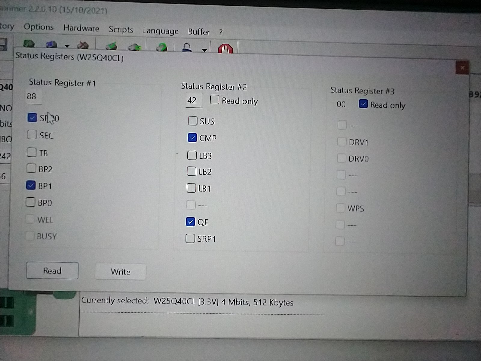

                            I followed the instructions you gave in previous posts, that is:
                            1. Click "Detect Chip" and select W25Q40CL and "Select IC".
                            2. Click "Unprotect".
                            3. Click "Erase IC" and "Yes".
                            4. Click "Open File" and select your corrected Dump.
                            5. Press "Program IC" and "Yes".
                            6. Click "Verify IC".
                            7. Press the down arrow to the right of "Unprotect" and select "Edition SREG", put a check mark on SRP0+BP1 and CMP+QE and press "Write" and "Yes"

                                Yes, everything here is done correctly.

                                        I corrected both dumps and they are fully working, or I wrote it down incorrectly (didn't install status registers), or there is another problem somewhere..
                                          OK. I used same procedure for programming, verify was OK, so there is possible, that board has a different failure. But voltages are OK and there is no short at board.
                                          Thank You very much for Your time. Martin
