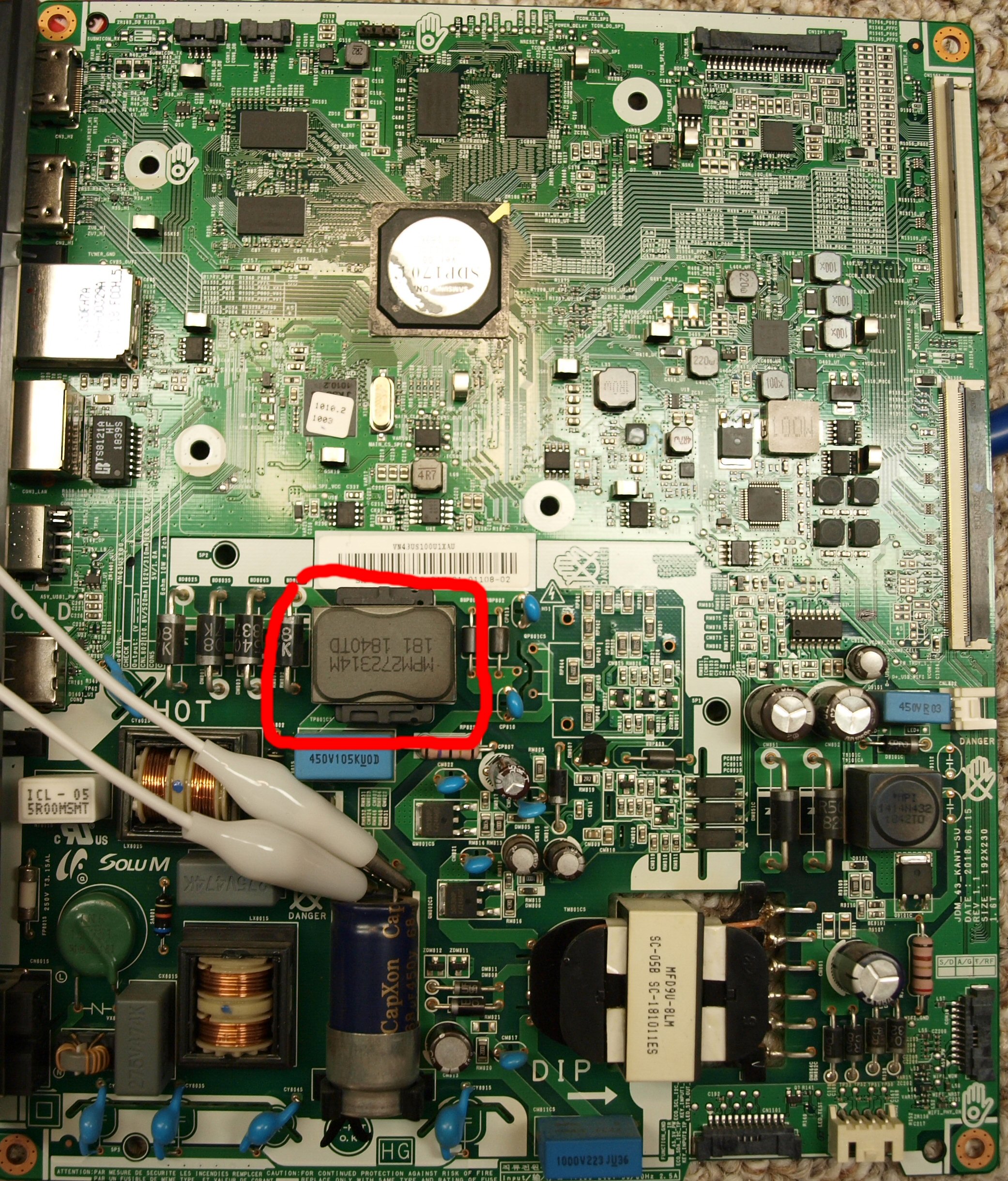

    BTW, when you removed that MOSFET on the heatsink, that MOSFET is for PFC Voltage booster, when you put it back are you getting 380 ~ 400VDC Voltage (measure between the legs of the cap) on the main 450VDC filter cap legs?

      Re: Samsung UN43NU6900FXZA 43" 4K - Power Supply Issue
      I did not do any voltage measurements with that mosfet removed, I just checked it for shorts and removed it to identify it....it was mounted funny; face down. The only way to identify it was to desolder it. If you want measurements with it removed, I surely can.
        What I mean is that after you solder it back into the board, is the PFC Boost Voltage still present or not.
        BTW, I also forget to ask if the 3.3V is going up and down when you run the power supply board by itself or not without anything connected it but just AC cord.
          Yes, it does... in sync with the faint 'chirp' I hear that's also in time with the blinking STBY/Power LED...
            can you pin point where the chirp is from?
            Since the 14V standby power supply is stable, there must be the problem some where in the step down power supplies/loads that is going on and off.
              What are the numbers on IC9101, I see voltage test points around it, like A_12v (always 12 volts) Is the A12V stable? I suspect the A_12V supplies other ldo's. I see what look like many ldo regulators in the picture with the heat sink removed.
                Sorry for the delay, fellas.....I had to slide this aside to work on some other stuff....but I've got this one back on the bench.

                With the naked ear, no....it's very faint. I need to find my old stethoscope....it got lost in the garage (also good for finding boost leaks and vacuum hissing in cars).
                It's marked:
                Line 1: SLM4281A
                Line 2: 1833
                  IC9101 has no datasheet, so I don't know if it has anything to do with the voltages in that area. You said the 14 volts is stable, did you check if any of the other sub voltages are also stable ie: A_12V
                    There is 12.5~12.9v there, drops/fluctuates ~.5v with the 'chirp'. With the aid of a stethoscope, the 'chirp' seems to be coming from TP801CS....but it's very faint, so I can't guarantee that....but that's where it was the loudest.

                      How many pins are there on that IC ?
                        Originally posted by smdflea
                        how many pins are there on that ic ?
                        16.
                          Originally posted by Topcat
                          16.
                          Samsung use renamed Magnachip parts afaik, it could be a MAP3249 ,its the only 4-channel LED 16 pin IC listed on their site: https://cdn.badcaps-static.com/pdfs/...74f7b75b74.pdf
