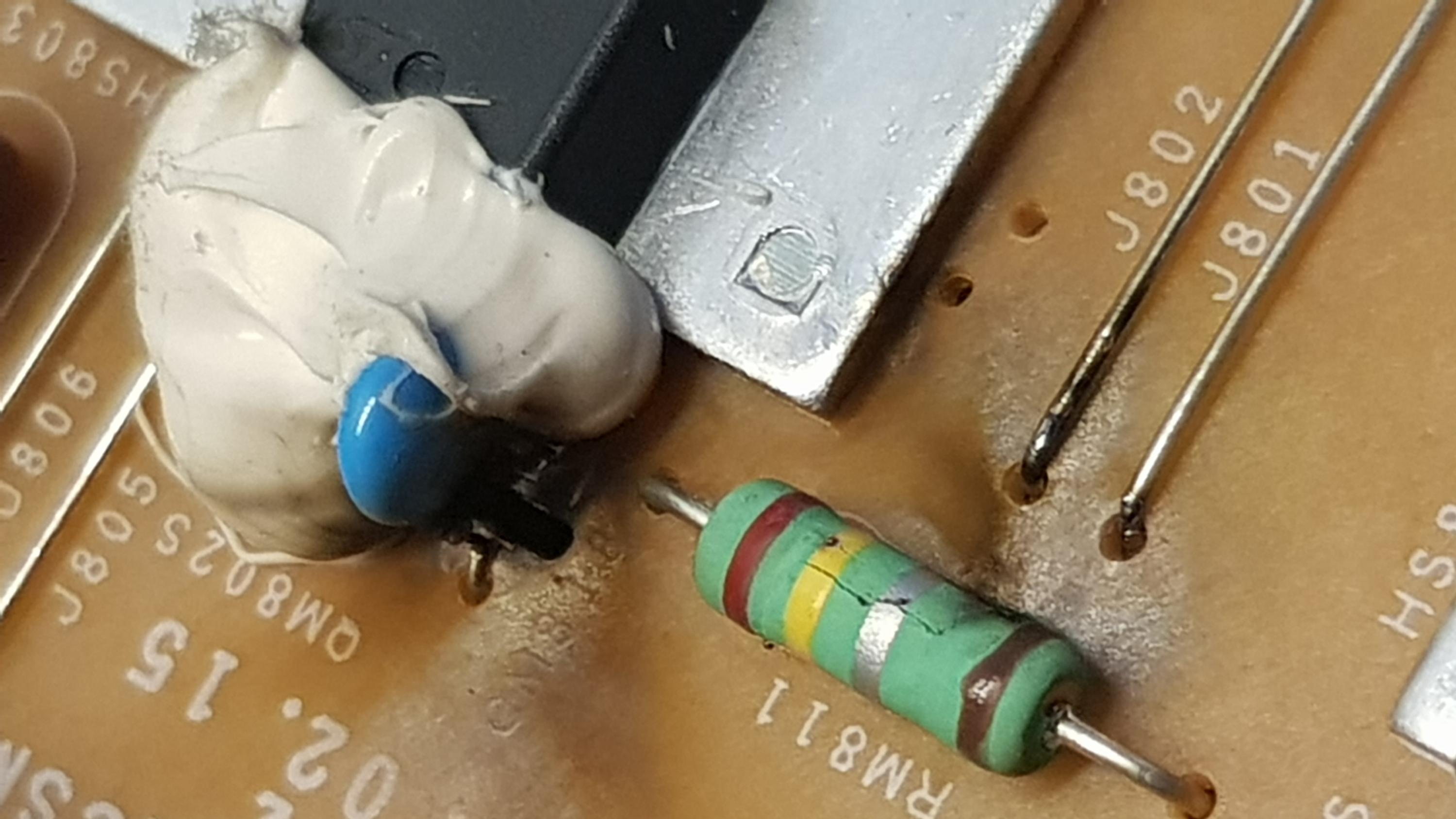

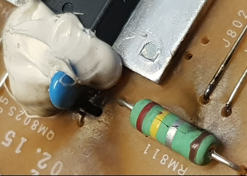

    Hi All,
    I have a UE32ES6540 which is dead, customer reported a pop and a puff of smoke. PSU is BN44-00517C and has blown 221k 1KV cap, next to this a blown resistor RM811. Board mains fuse is blown.
    Has anyone seen this problem and will changing the cap, resistor and fuse likely fix it? One more ask, can anyone give me a 2nd opinion of this resistor rating of RM811? I think it's 0.24 Ohms but would like a 2nd opinion! See attached pic.
    Thanks!
    Bob
    Re: BN44-00517C dead - blown cap, resistor and fuse

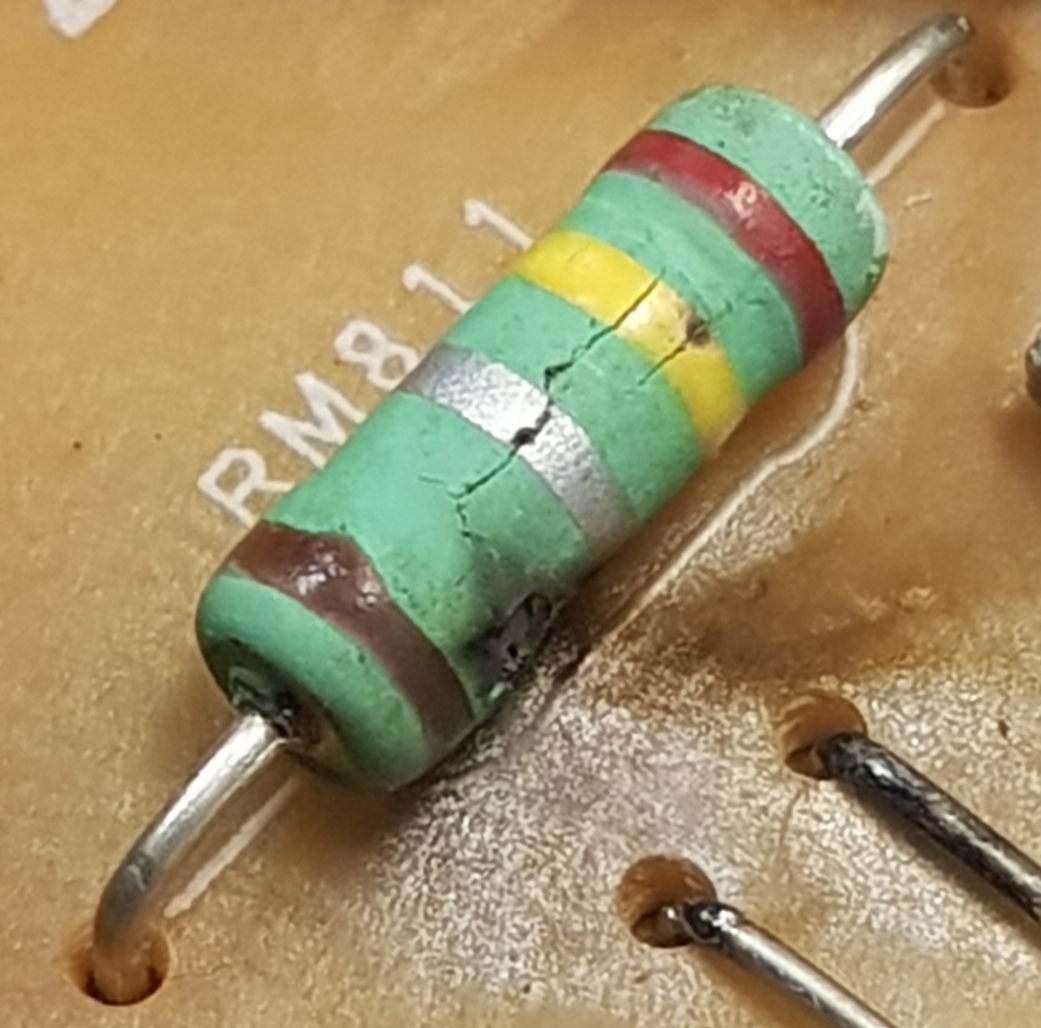

    Very common problem for those snubber ceramic cap to short out like that, it is connected in parallel with Source and Drain pin of that MOSFET, so when the cap shorted out it will usually take out that Source resistor with it, you still should check the MOSFET to make sure it is also not shorted out either, you also need to check the bridge rectifier to make sure it is also still OK.
    That flame proof resistor is 0.24 Ohms.
    The cap should be replaced with 2KV rating instead of 1KV as original is rated at.
      Hi budm,
      Thanks for your message, i will check for shorts on the fet, yes i have some 2kv caps as change these quite often on sone of the older 32" boards that come in to me. Thanks for confirmation on the resistor, i will order sooner if those in. Will confirm if the repair works! Thanks Bob

        Hi, do you reckon that will be a 2w or 3w resistor? Cheers! Bob

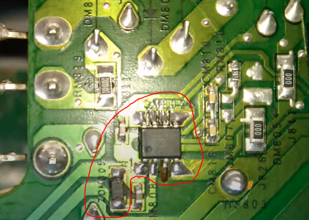

          I know this is an old thread but I'm hoping someone can help. I'm also having the same problem with my BN44-00517C board. The cap and resistor I have ordered but I have no clue what the MOSFET model is. Can anyone help?
          Cheers
          Daz
          • diif
            • Feb 2014
            • 6978
            • England
            Cheers
            Daz
            The MOSFET should have some markings on it.
            • dazzystar
              • Dec 2023
              • 25
              Thanks so much for the reply. The MOSFET is completely blank. I've looked at a YouTube video of a similar Samsung TV PSU board and the MOSFET there is a 10NM60N so I've ordered one from ebay. Let's hope with that, a new cap and resistor it'll work!
              • lotas
                • Jan 2016
                • 4649
                • Russia
                Don’t forget to replace the SSC2S110 PWM and check its wiring (smd resistors, stabilizer bars, diodes...)

                                    If you do not replace the SSC2S110 PWM, then the first time you turn it on, the mosfet and fuse will burn out again...
                                    • dazzystar
                                      • Dec 2023
                                      • 25
                                      well then it will definately go in the bin after that!
                                      • diif
                                        • Feb 2014
                                        • 6978
                                        • England
                                        Why not replace the SSC2S110 whilst you're replacing the other components ?
