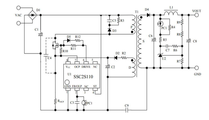

BN44-00517C dead - blown cap, resistor and fuse

      so I have scraped around the area and the readings from all 4 diodes are the same as before. Is it worth repairing or should I give up?

              Originally posted by dazzystar
              Thanks but not sure which one(s) you mean. Here's a pic of the new PWM chip.
              Click image for larger version  Name:	IMG_6078.jpg Views:	25 Size:	4.42 MB ID:	3173857
              Your pin 5 doesn't appear to be connected up to anything! Did you take a picture of your pcb before you did the soldering? Also your pin 4 looks like the track could be broken as well where the masking is removed and the copper is exposed.
              • dazzystar
                • Dec 2023
                • 25
                #47
                Pin 5 doesn't connect to anything. I didn't take a pic beforehand.

                      #50
                      For this SSC2S110 PWM, pins 3 and 5 are not used.

                                        • dinkodinko
                                          • Apr 2022
                                          • 4
                                          • Croatia
                                          #60
                                          I had few blown components on the LED power supply on BN44-00517C board, including 1kv capacitor, MOSFET, power resistor, and some SMD resistors for which I cannot find values, so maybe someone can help me.
                                          I've tried to recreate resistor combination using a datasheet for the SSC2S110 pwm controller, but the LED backlight still won't turn on.
                                          I can confirm that the LED backlight is working, pwm controller is working because I've soldered it instead of the same controller for logic power supply and that is working fine.
                                          I've even changed the optocoupler.
                                          The only thing that could have some influence is 0.22 ohm resistor RM811 i've put in instead of blown 0.24 ohm one, but it should at least start for a second, even if the resistor blows again.
                                          Any suggestion is welcome.
                                          Thank you in advance,
                                          Regards,
                                          Dinko
