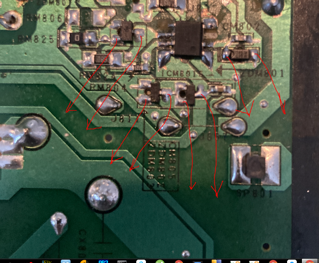

                You also need to check the components next to this smd chip (low-resistance resistors, diodes....).
                • Davi.p
                  Hobbist Tech
                  • Sep 2009
                  • 4465
                  • Italy - Milan
                  Must to use the lamp in series to input.. to keep safe the new conponents.. you have to check if mosfet is shorted D-G, if yes the oscillating IC is 100% dead..

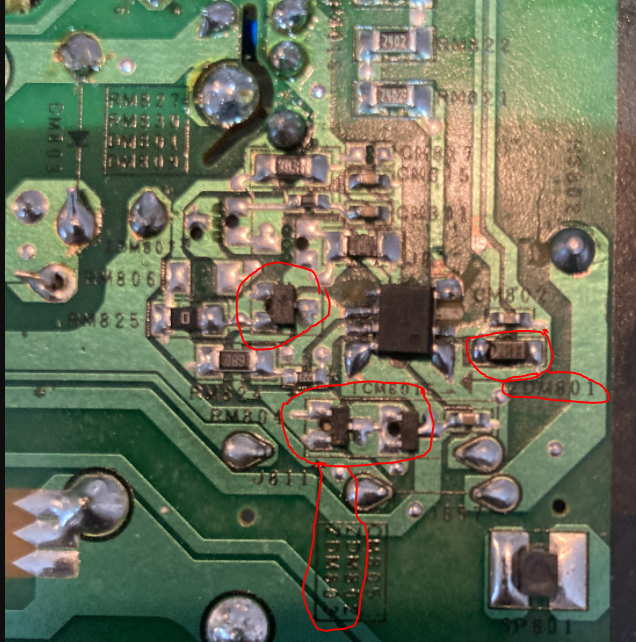

                            Have you checked these zener diodes?
                            • dazzystar
                              • Dec 2023
                              • 25
                              #34
                              No. I haven't. They seem to have 3 legs on them. How do I test with my multimeter?
                              • lotas
                                • Jan 2016
                                • 4754
                                • Russia
                                #35
                                They have two legs (1, 3) connected together, so that they have two, like a regular diode (zener diode).

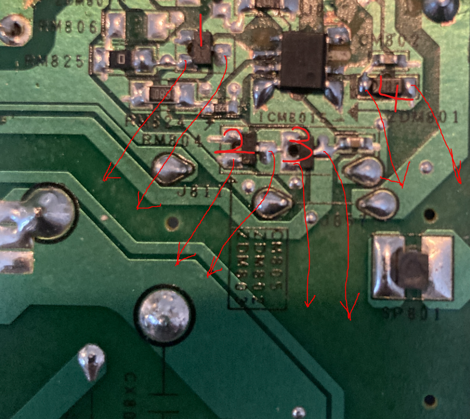

                                • dazzystar
                                  • Dec 2023
                                  • 25
                                  #36
                                  From 1 I get a beep in both directions with my DMM and a reading of around 70 ohms. From 2, 3 and 4 I get nothing in either direction from the DMM
                                  • lotas
                                    • Jan 2016
                                    • 4754
                                    • Russia
                                    #37
                                    At 1 you get a sound signal because there is a 68 Ohm resistor (680) in parallel with it.
                                    • dazzystar
                                      • Dec 2023
                                      • 25
                                      #38
                                      Thanks again. Does that mean the other 3 diodes are faulty?
                                      • lotas
                                        • Jan 2016
                                        • 4754
                                        • Russia
                                        #39
                                        When checking in the "Diode" mode, they should show only in one direction, this is when the red probe is on the anode, and the black one is on the cathode, scrape off the varnish on the terminals and check again, maybe there is a bad contact with the probe, if nothing happens, then you need their replacement.
