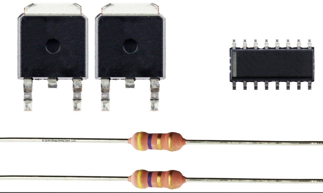

    Hello all and thanks in advance for helping me with this.
    I am a novice TV repair hobbyist and just picked up this Samsung UN65MU6290 / PS board # BN44-00873C with no backlight but otherwise seemingly fully functional. My initial assumption was the LED strips were bad but upon further research apparently the Power Supply board can also be at fault for "over driving" the LED strips. On ShopJimmy they are recommending to replace some resistors and other components (transistors?) in conjunction with the LED strips (although their referenced Youtube link only demonstrates replacing the resistors):
    Originally posted by SJ
    "--PLEASE NOTE: This repair is recommended only for experienced technicians. After installing these LED bars, we strongly encourage you to perform the modification on the power supply board in your TV (BN44-00873C) that can be seen here: https://youtu.be/R_KuCkW1SO4
    Replace resistors R9111 & R9211 as shown in the video with the included resistors from ShopJimmy.
    After this modification is done, the LED bars will run much cooler than the stock ones and will prolong their lifespan significantly."

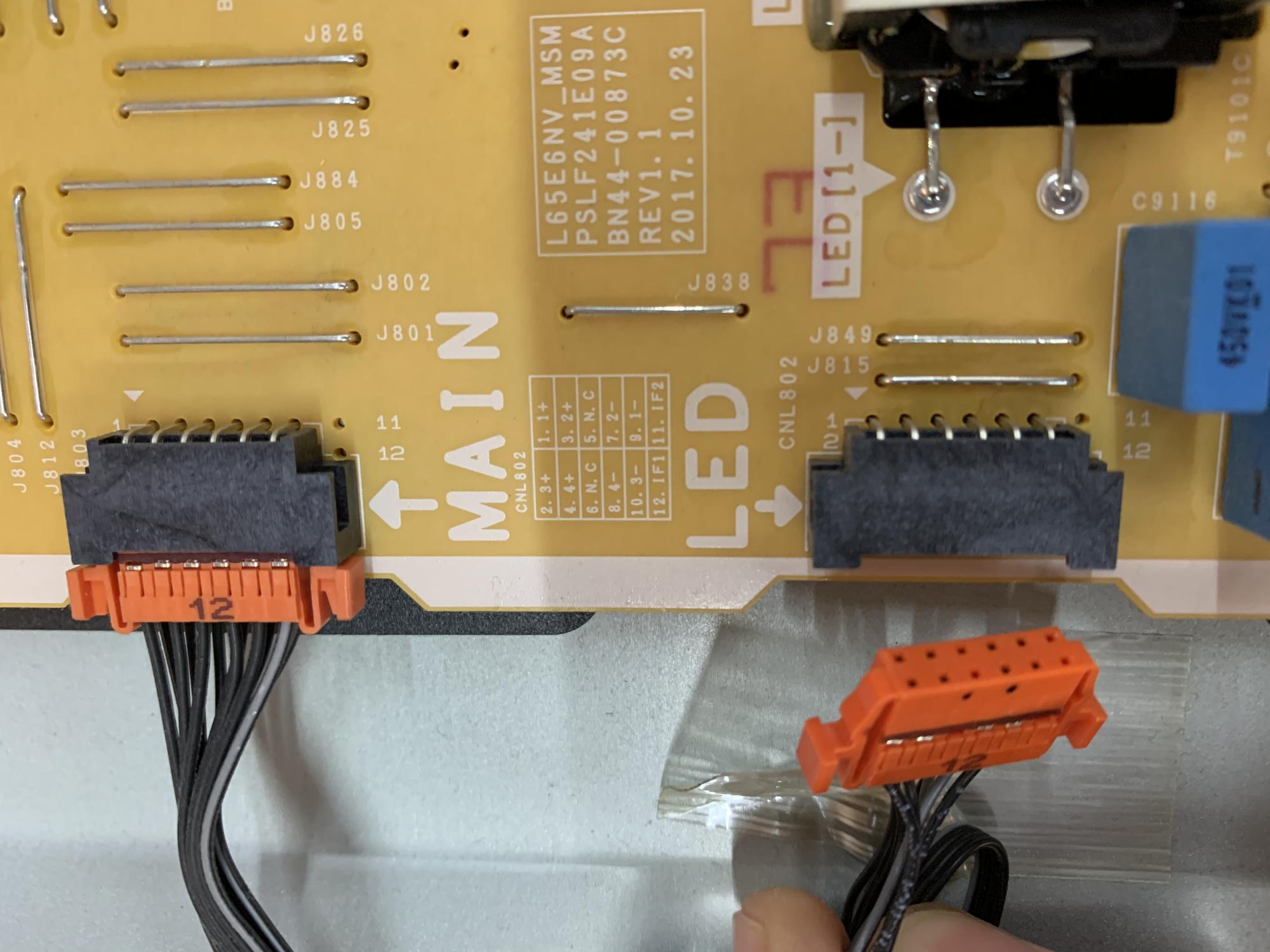

      Anyway, I couldn't get any of the LED strips to power up using my tester at the harness but I'm not really sure I was making all the correct connections either.
      I guess I should have posted the board # in the initial post if I expect any diagnostic help ( BN44-00873C)

          CNL802 is the connector/plug for the LED and I can't make sense of the listed voltages in the diagram. I get about 317 volts on terminals 1, 2, 3 and 4. Terminals 5 and 6 which I believe are supposed to be ground I do not get a continuity reading. Terminal 7 I get minimal voltage: 0.12V and Terminal 8 : 0.02V.

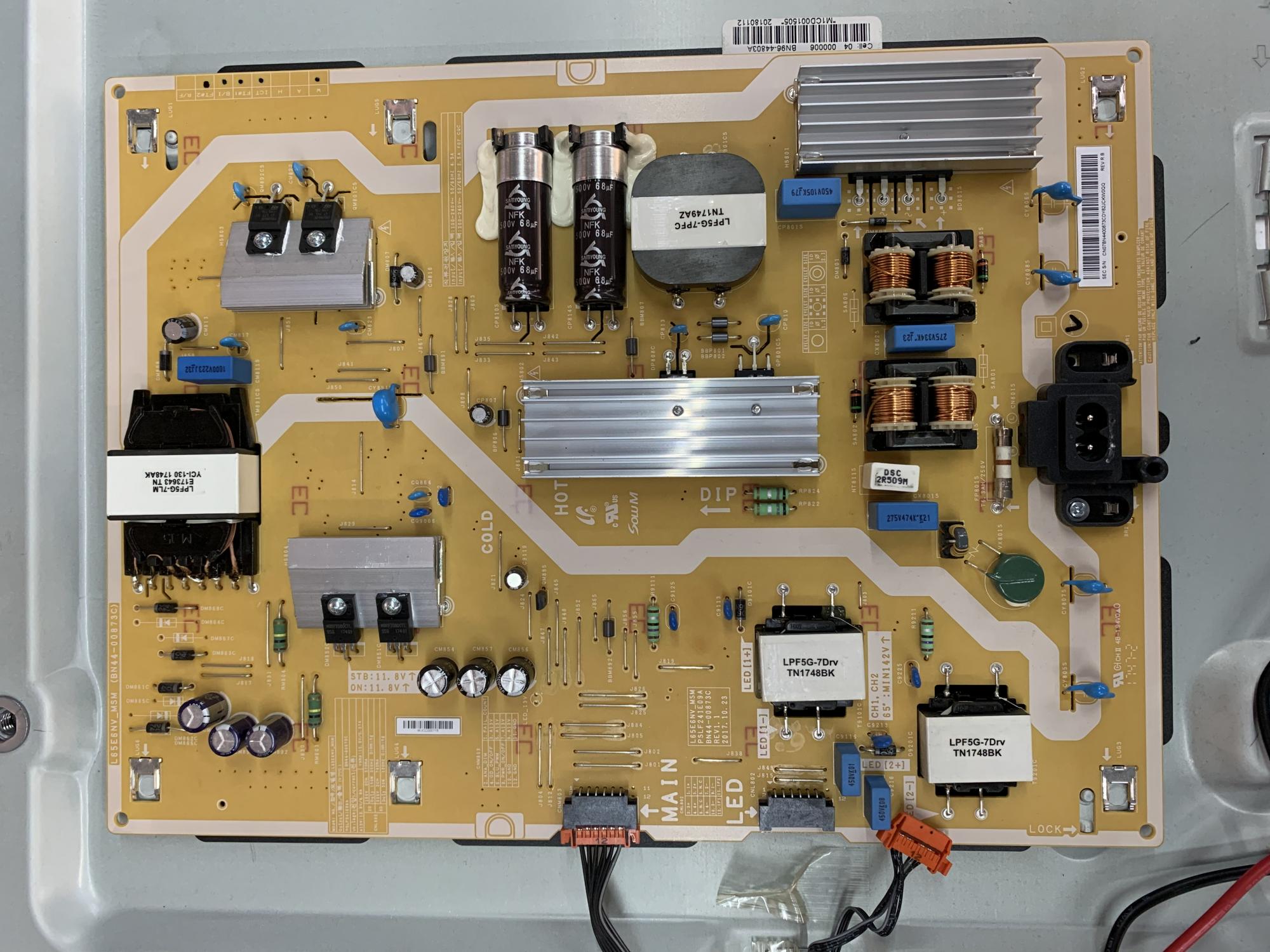

            Some photos of the board
            • R_J
              • Jun 2012
              • 9535
              Re: No back light on Samsung UN65MU6290, Need help modifying Power Supply Board.
              The two transistors are mounted on the trace side of the board, the two resistors are likely R9111 & R9211 and it looks like shopjimmy replaces them with 4.7Ω

                If you get the strip kit from shopjimmy also get the repair kit for the power supply. You will get the IC9101, the two switching transistors Q9101C and Q6201C, and the two resistors R9111 and R9211. Change them all. Do the repair first on the power supply and then replace the led's. It's such a pain in the ass to do the backlight repair on this model we turn them down now. I don't have time for this nonsense. Samsung you suck.

                  Thanks for the reply. SJ sells the kit but only has a video showing, and only makes mention of, replacement of the resistors. I'd like to test the transistors which would prove too risky for a novice to replace and see if I can "get away with" leaving them in place.

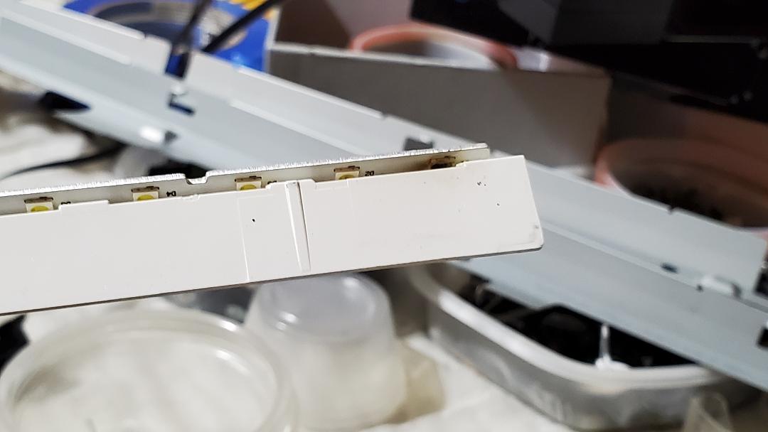

                  I lost my patience and disassembled the TV down to the LED strips, sure enough many of them were burnt. Some were essentially charred. I went ahead and ordered new strips from China so now I have about a month to figure out how I'm going to upgrade the board. Disassembly was about 5 steps more complicated than other TV's I've taken apart. Lot's of plastic snap points that likely won't withstand another disassembly.

                                Well I sure appreciate the reassurance. After receiving my kit yesterday and seeing how tiny the transistors,etc are...I'm most likely going to put those on the back burner and hope for the best.
                                I have also confirmed the resistors I received, (which are also tiny compared to the ones I'm replacing), are 4.7Ohms resistors. I'm removing 1.7Ohms resistors. I will put my faith in the circuitboard gods and proceed.

                                  Update : I replaced the resistors, no problem. All went smoothly in that regard. I plugged everything back in and the LEDs immediately began buzzing again. I decided to wait a moment longer and the LEDs continuously flashed on and off with a lot of buzzing. I actually think the buzzing might be one of the LED's arcing as I could see light shining through the holes in the back casing and in one particular area there was a more yellow colored light that seemed to flicker in sync with the buzzing.
                                  This would re-affirm my concern about damaging the LED during installation. I guess I'll be taking it all apart again and maybe I can salvage an LED from my old strip and rework it.
