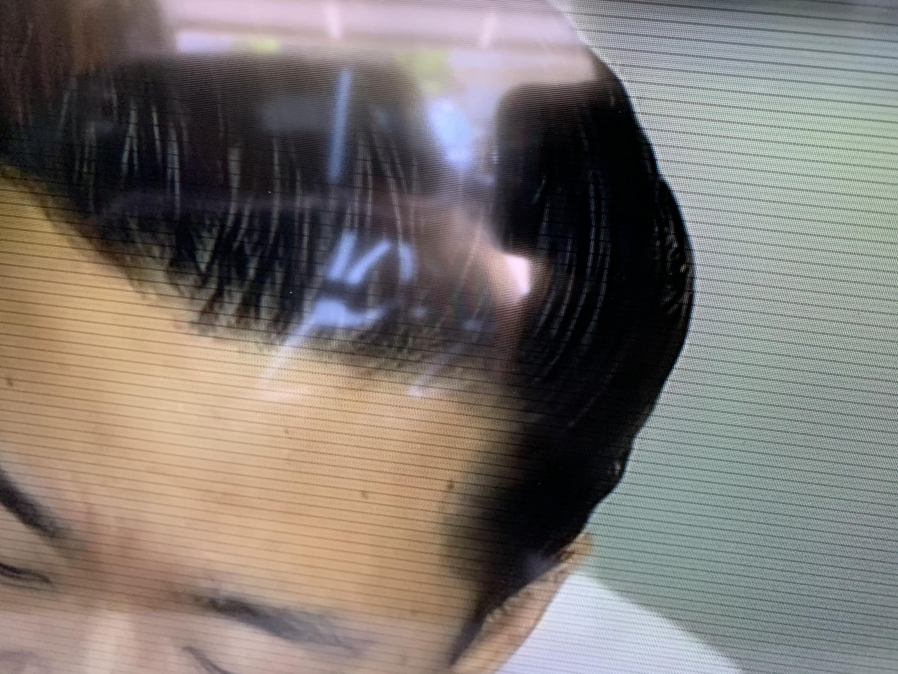

        A somewhat good update: I went ahead and replaced the MOSFET transistors (or whatever they are). This was unchartered territory for me and I ripped off part of the trace on one of them but I think I cobbled it back together alright. I did one at a time, and tested the TV after each. It wasn't until I replaced the second one that the flickering stopped and the TV began to function normally. I now have a steady backlight and a picture.
        My excitement was quickly squashed once I noticed very thin horizontal lines across the entire screen. I'm thinking this is unrelated to the repair and replacements I performed and possibly something wrong with the LCD panel.... I really don't know what to do at this point. Maybe I damaged it during removal. I think I'm going to slap it back together and just use it or sell it to someone who wants a nice garage TV.

          Okay this saga has finally come to an end. I fiddled with the ribbon cables and the lines on the screen disappeared. That was all I needed to claim a victory and start putting it back together. Well I guess I manhandled it or maybe I wasn't gentle enough snapping the back case on. I turned the TV around to appreciate the fruits of my labor only to reveal a F!#king black spot where the screen had cracked in the corner.
          I guess I'll be breaking it down and selling the parts.
