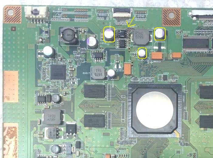

                      • Davi.p
                        Hobbist Tech
                        • Sep 2009
                        • 4463
                        • Italy - Milan
                        Re: Philips 37PFL8605 not booting
                        The main problem with these sets is a failing power mosfet on the tcon, then i guess, due to sudden overloads there are data loss in the flash, so maybe starting to not boot..
                        • Modelvincent
                          • Jun 2015
                          • 10
                          • France
                          Interesting, this can be repaired or it's better to directly change the TCON?

                            Now i'm on tablet, when i will be on PC i will post the picture to localize the mosfet and the replacement part number compatible , so wait this afternoon..
                            • Davi.p
                              Hobbist Tech
                              • Sep 2009
                              • 4463
                              • Italy - Milan
                              the mos is labeled FDS8880 and i have swapped to a IRF8734PBF
                              • Modelvincent
                                • Jun 2015
                                • 10
                                • France
                                Thanks, I've just remove the cover and yes this is the same board with same transistor reference so I will replace it, it's not the price...
                                However, if the transitor was blown, I suppose that the problem will be present every time, not some time to time as actually?
                                • Davi.p
                                  Hobbist Tech
                                  • Sep 2009
                                  • 4463
                                  • Italy - Milan
                                  No, i was giving you a sure repair testimonial, i'm not play around.. ok?
                                  • Modelvincent
                                    • Jun 2015
                                    • 10
                                    • France
                                    I'm really sorry, i didn't want to upset you.
                                    As the initial post was about a TV not starting at all i was not sure if your solution was for my specific problem.
                                    In all case, as mentionned above I will change the transistor and keep you informed of the result.
                                    And regarding the strange date in the log file, is there a problem hidden behind or is that a normal behaviour?
                                    Best regards
                                    Vincent
                                    • Modelvincent
                                      • Jun 2015
                                      • 10
                                      • France
                                      I've changed the mos as suggested by Davi.p but it changed absolutely nothing, the result is still the same, the TV restart from time to time...
                                      What can I check to debug this behaviour?
                                      Best regards
                                      Vincent
