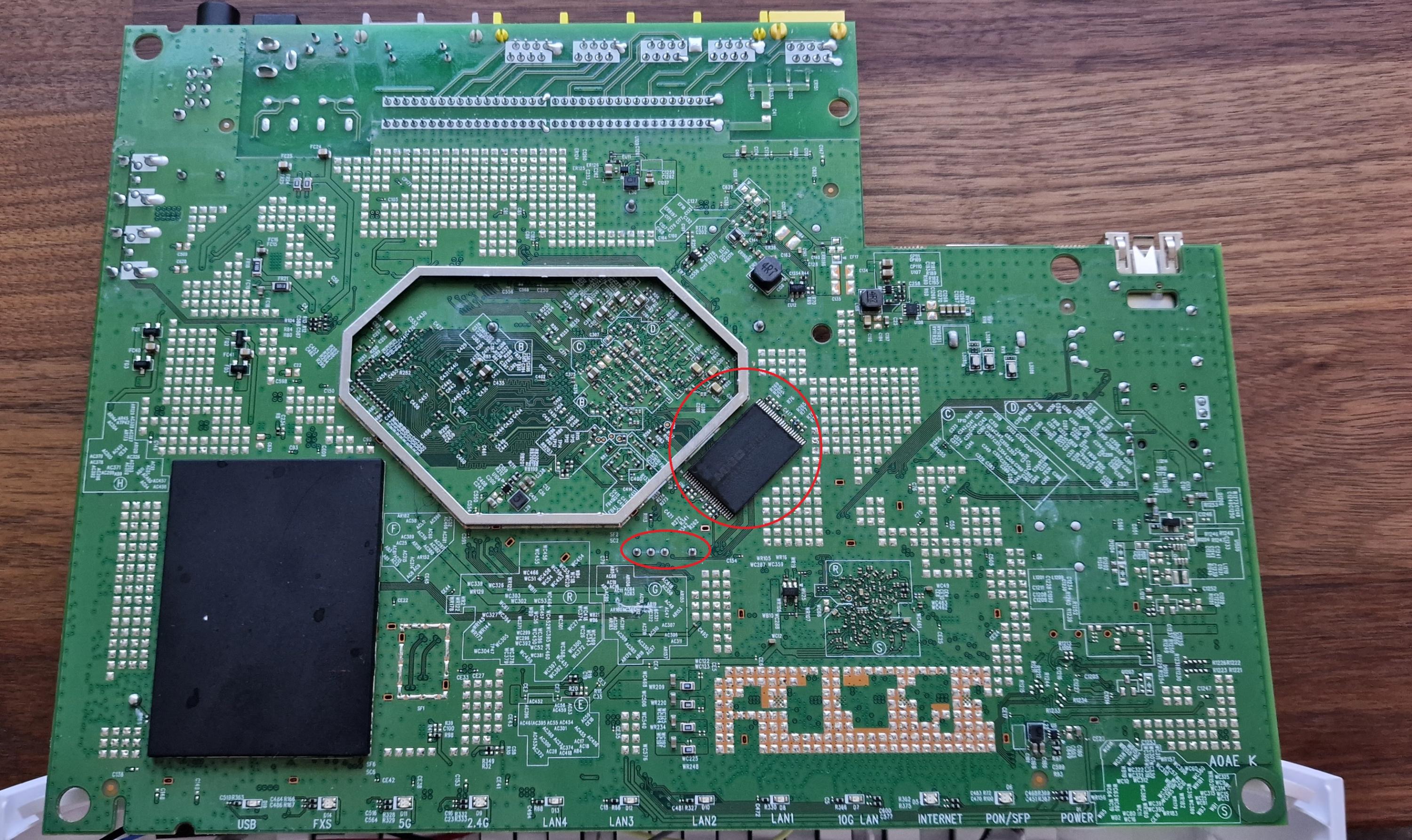

    Hello guys

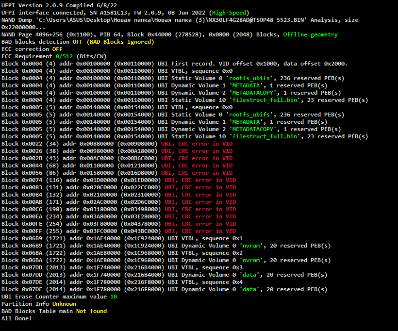

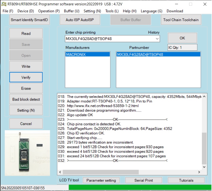

    I did a dump from a MX30LF4G28AD@TSOP48 nand with an RT809H. If I flash back the firmware, the auto verify show everithing ok, but if click on Verify button there is a lot of inconsistence bytes.
    I did a bad block check and found it few. However I use any bad block management algorithm, after flashing the verify show the same inconsistences.
    The device didn't boot up. What I did wrong? Thank's in advance!

    Re: nand bad block with an RT809H, didn't boot
    RT809H - does not know how to work correctly with Bad Block and Error Correction Codes (ECC).

          It is a Zyxel ax7501-b0 router, with custom ISP firmware on it. I wanted replace to the original firmware, but it is also not as easy as thought. (drive link, while too big to attach)
              Errors in the middle of the dump, the programmer does not know this ECC algorithm.

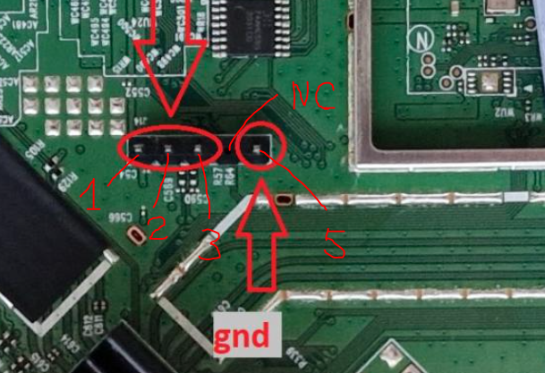

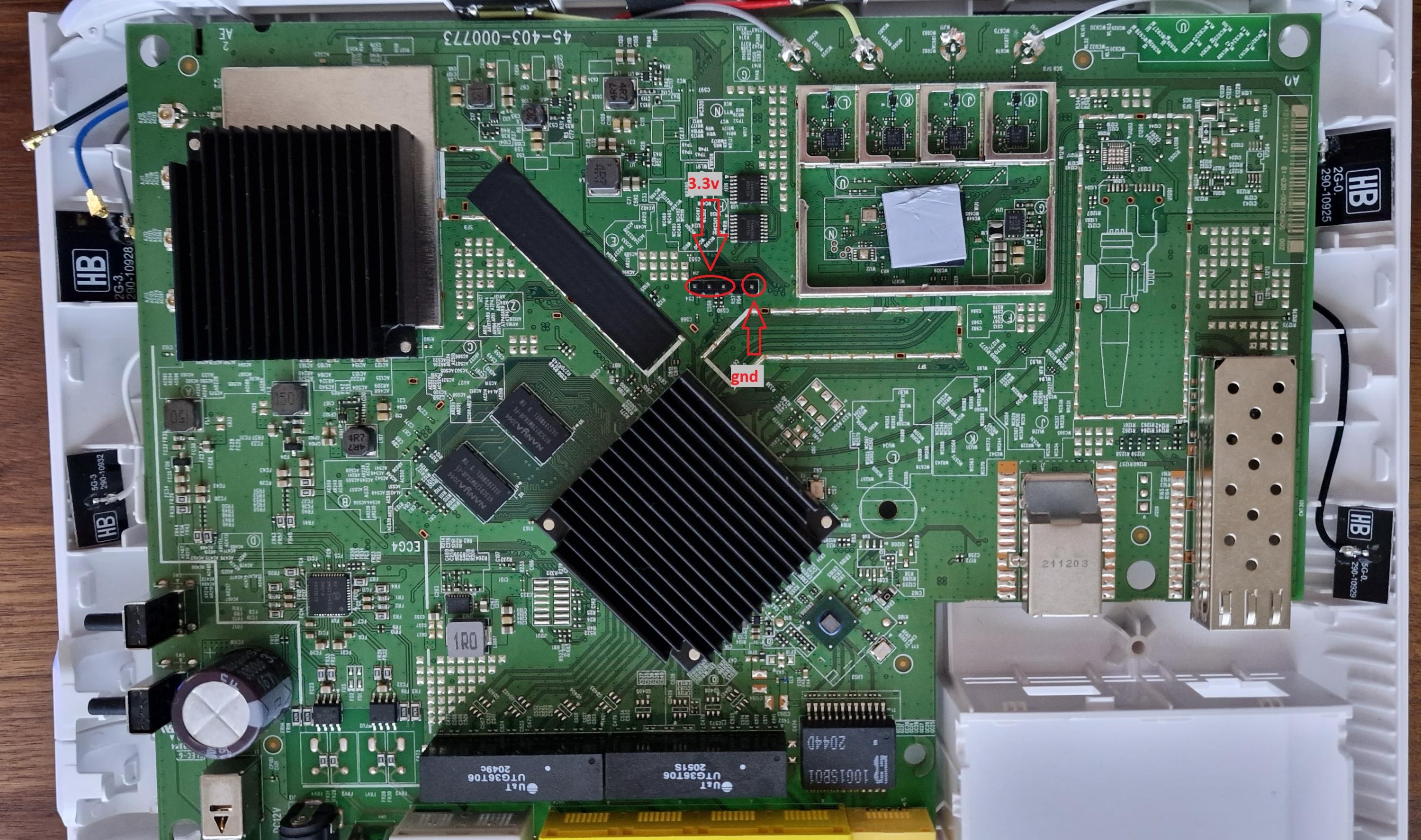

                    What kind of interface could be here? SPI? 3 pins are 3.3v, one gnd.
                    Is there a little chance to revive if the uboot not damaged?
                      Most likely UART interface (RX, TX, 3.3v, GND).
                        Is it normal than 3 pins are 3.3v?
                          According to your pinout: 1 - 3.3v, 2 - RX or TX, 3 - TX or RX, 5 - GND.
                            Yes

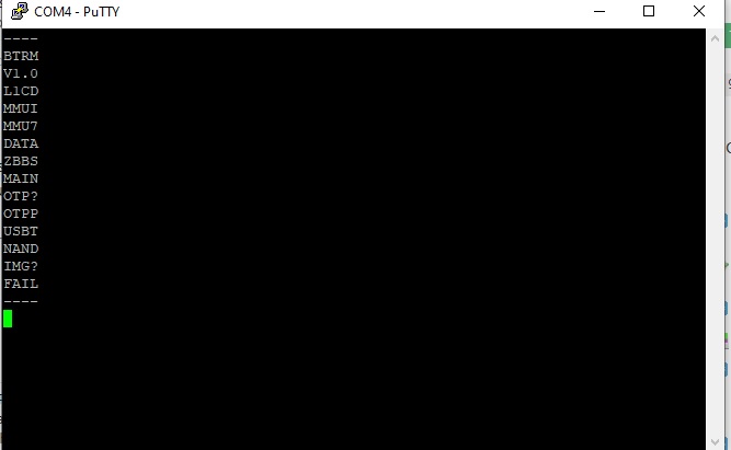

                              thank you, the connection is up, but signs bad. I so stupid, why not beginned on uart.
                                There should be a boot log when the router is turned on.
                                  It won't boot up correctly, because the damaged firmware. All the led's lights. Is any chance to get back in the life?
                                  The official update bin I have, but is not the full dump of the nand.

                                        • Switzerland
                                        Which ECC algorithm need? Only found on MX datasheet 8 bit. Think to buy a Flashcat Mach1, which designed for SLC, MLC and TLC NAND.
                                        It can handle ECC's as Hamming, RS and BHC.
                                        If its a recommended programmer, i take a same router to dump the nand correctly and flash it to my device. But not sure about the MAC and SerialNr. change
                                        (on device list there is only MX30LF4G28AB, but compared the datasheet not much difference between MX30LF4G28AD.)
