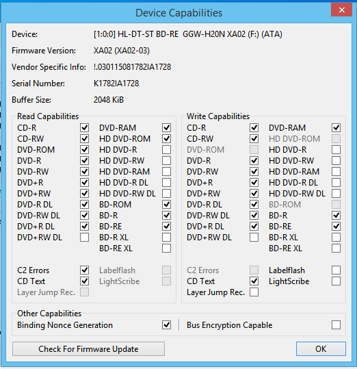

    I have an HL-DT-ST BD-RE GGW-H20N with ROM version: XA02.
    Click image for larger version  Name:	Capture.png Views:	0 Size:	29.0 KB ID:	3713121

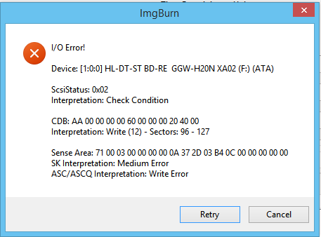

    When I tried to burn a 25GB Blu-ray disc using ImgBurn, I got an error.
    I will share all the details with you, including the disc information.
    Click image for larger version  Name:	Capture1.png Views:	0 Size:	14.2 KB ID:	3713122

    E 12:43:10 Failed to Write Sectors 96 - 127 - Reason: Write Error
    E 12:43:10 Next Writable Address: 0
    I 12:43:10 Synchronising Cache...
    W 12:43:11 Potential 'WaitImmediateIO' Deferred Error - (0/3) - Write Error
    W 12:43:11 Synchronise Cache Failed! - Reason: Write Error
    E 12:43:13 Synchronise Cache Failed! - Reason: Write Error
    I 12:43:15 Closing Track...
    W 12:43:15 Close Track Failed! - Reason: Cannot Write Medium - Incompatible Format
    E 12:43:16 Close Track Failed! - Reason: Cannot Write Medium - Incompatible Format
    I 12:43:16 Finalising Disc...
    W 12:43:16 Finalise Disc Failed! - Reason: Cannot Write Medium - Incompatible Format
    E 12:43:17 Finalise Disc Failed! - Reason: Cannot Write Medium - Incompatible Format
    E 12:43:17 Failed to Write Image!
    E 12:43:17 Operation Failed! - Duration: 00:00:51

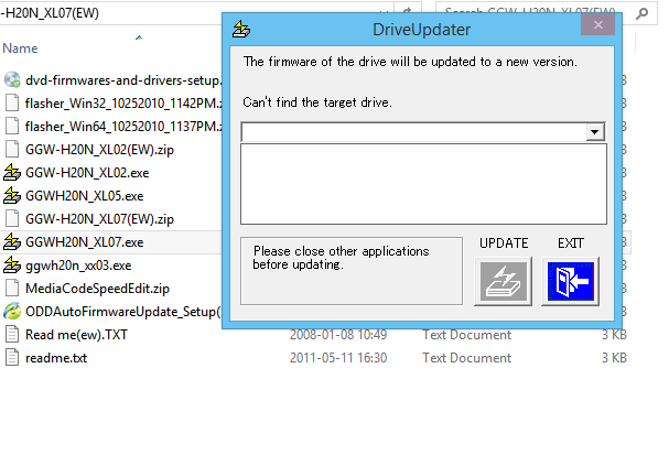

    I have searched extensively for firmware updates that could help, but to no avail. All the updates I found did not recognize my drive in order to proceed with the update.
    Click image for larger version  Name:	Untitled.png Views:	0 Size:	28.1 KB ID:	3713123
    Most recently, I managed to dump the drive’s firmware and analyzed it using the MediaCodeSpeedEdit tool.
    Upon inspection, I discovered that the types of discs "RITEK-BR3-000 "I’m trying to burn are not listed in the supported media list, which explains why burning fails when using ImgBurn.​

    -My questions are:
    1-How can I update this type of drive?
    2-Is it possible to modify or patch the current firmware file?
    3-Can the drive be flashed with a different firmware, such as XL07 instead of XA02?
    4- Where can I find the dump file for version XL07?
    If anyone has experience with this or has attempted something similar, I would really appreciate your input.​

    https://www.hd-dvd.org/firmware.html#ggw-h20n
    • ahmedtou
      • Aug 2025
      • 5
      • ALGERIA
      the same drive not detected by driveUpdate tool
        • 32069
        running as admin?
        • Ahmedtoufik
          • Aug 2025
          • 2
          • Algeria
          Originally posted by stj
          running as admin?
          Yes, I tried all the methods, but after you gave me the link, I noticed that it’s possible to cross-flash it, so I thought, why not try converting it and then converting it back to XL07? I downloaded another firmware and faced the same issue, so I considered putting it into flash mode or safe mode—I’m not sure what it’s called. The method is to turn off the computer, then hold the eject button and power on the computer for about ten seconds.
          After the computer booted up, I was able to flash it normally with the XL07 firmware without converting it first.
          The strange thing is, I had tried this before and it didn’t work—I don’t know why it worked this time.
          Thank you, you help me 🙏 ❤️

              Yes, I dumped the new XL07 firmware from my drive and checked it again using Media Code Tool. It supports a wide range of disc types, including the one I have: RITEK-BR3-000. I also successfully burned a disc with it 🙏❤️
              Thanks again my brother 😊
