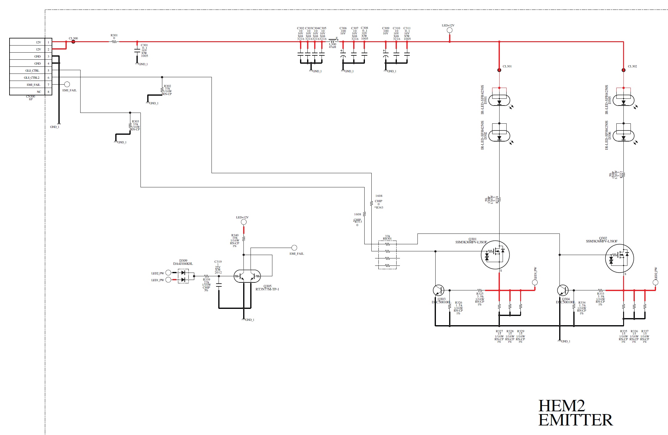

                        I found a reasonably priced main board for a 55EX720. From the service manual, it uses the same panel as 55EX620 but is 3D and has a higher refresh rate. But the service manual is totally different for this model and has an entry for a 10 blink code - emitter error. Flowchart says to replace the HEM2 board and possibly the tcon.
                        Installed the main board and it flashes on and gives a 10 blink code without a firmware update. Guess I need to try a new HEM2 board.
                        Update: I think I solved the mystery. My model does not have a HEM2 board which connects to the tcon board. It is an emitter board for a 3D TV, probably to connect to active sync glasses. If the firmware is configured for 3D, then it probably checks for it and gives the 10 blink error if not found.

                          I found a HEM2 board with a cable for a different model on ebay and ordered it. Looking at the schematic, it is just IR emitters for syncing the glasses. There is an EMI_FAIL (emitter fail) pin that is probably triggering the 10 blink code. Looks like I can just ground it to disable the error?? I'm assuming the pin has an active high pull up. Can check it tomorrow.

                            I confirmed grounding pin 7 EMI_FAIL on the tcon board will get rid of the 10 blink error. It needs to be grounded before the set is plugged in and needs to be grounded at all times. Since I ordered the HEM2 board, I will wait for it since I don't want to mess around with the service menu unless absolutely necessary.
                            Odd Sony created a non-3D model using the same panel and removed the small emitter board and also had a different bezel since the emitters need a window and lens to shine out of.

                              It's absolutely fool, not only the 3D panels are different and maybe more espensive in the matrix, but it needs a special powerful tcon, or pre-tcon board that elaborates the 3D, how can a tv maker give them for free? After this the original symptom was 10 blinks, but how can a tv complaint about a missing module when that module doesn't exists in that model?
