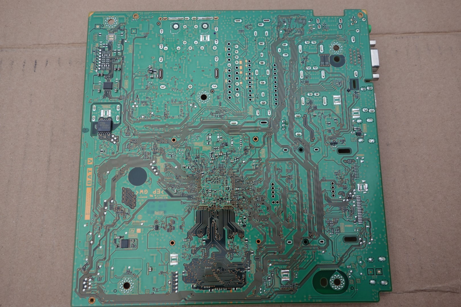

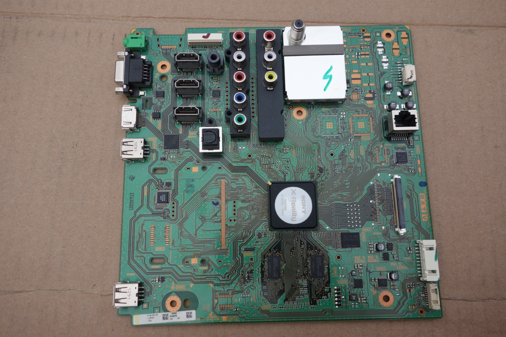

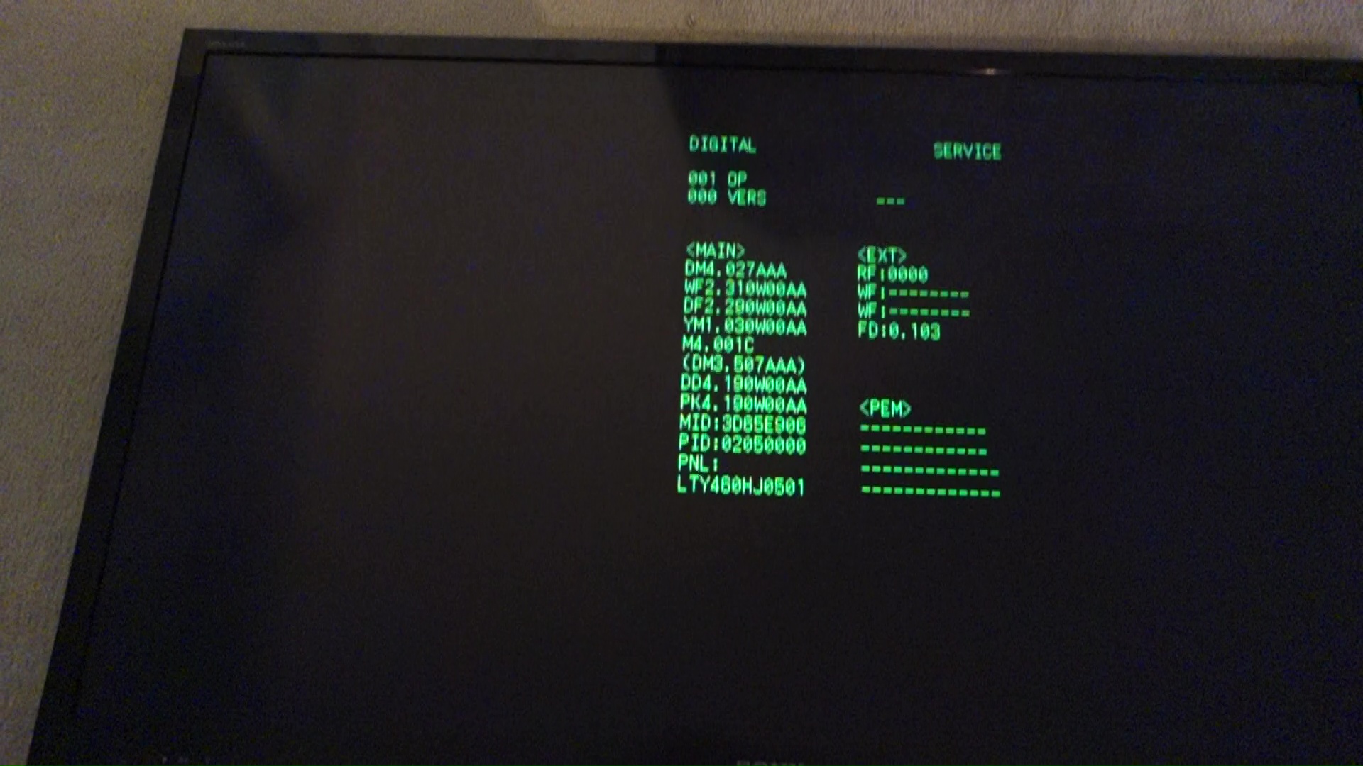

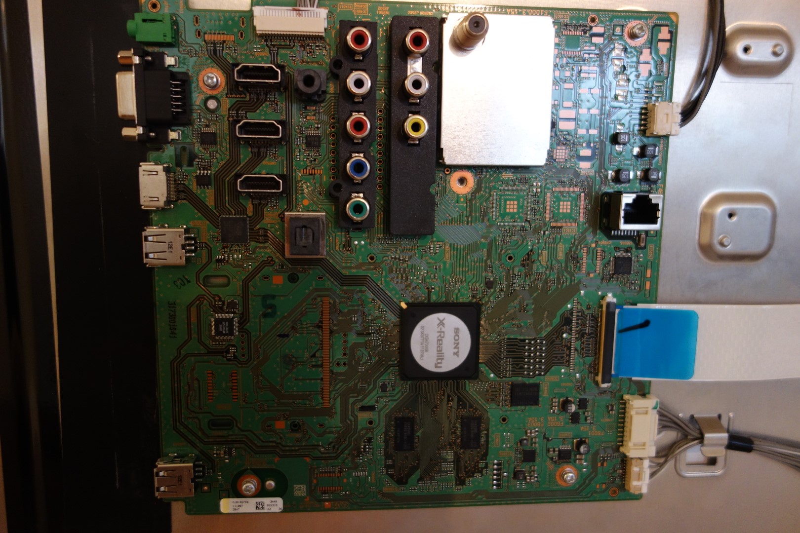

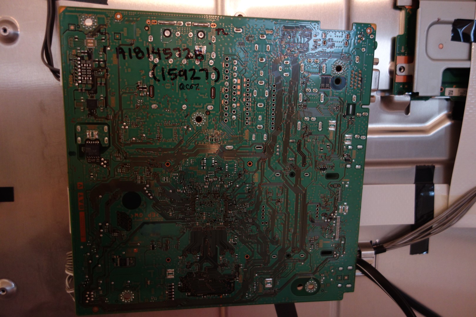

                      Pics of the mainboards. Original on the cardboard. Replacement in the tv. Snapshot of flash of service menu.

                      • Diah
                        • Feb 2013
                        • 6558
                        Re: Sony KDL-55EX620 10 blinks
                        disconnect the panel total from T-CON then turn on... report if the set stay on

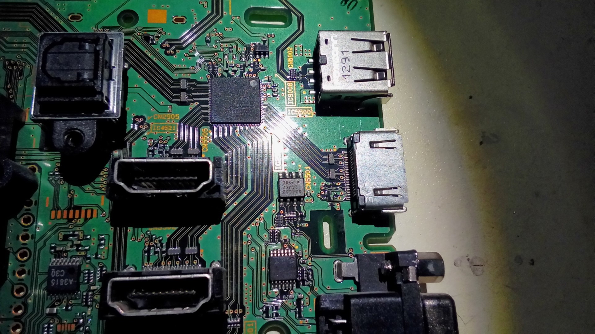

                              could you write here the ic 8 pin at he left side of HDMI 3 down on PC VGA socket

                                      S24cs0?
