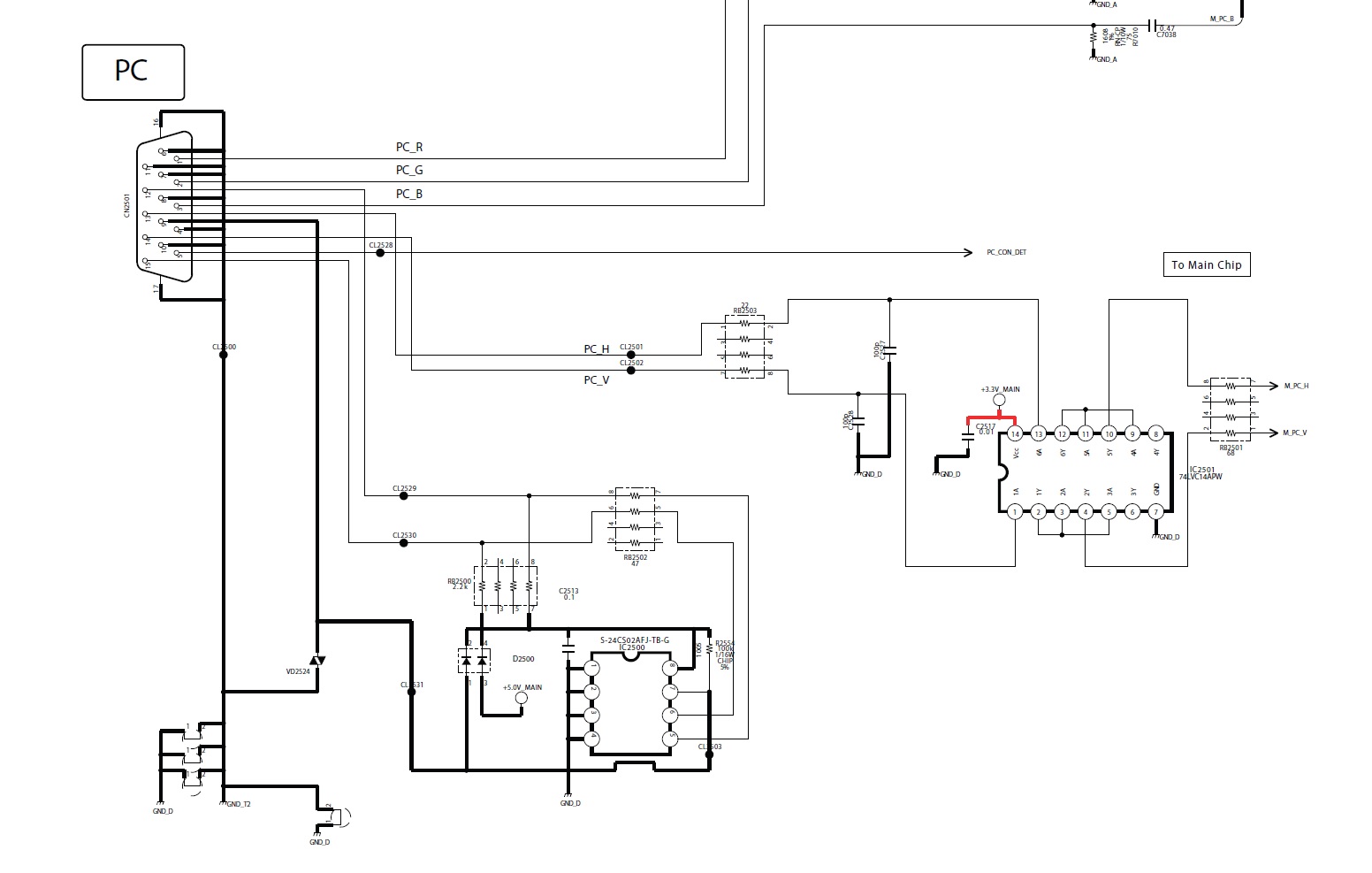

              I have a CH341A programmer with clips but there is no profile for IC2500 S-24CS02AFJ-TB-G listed in the service manual. Tried something close but couldn't read anything off the old board.
              The schematic shows this chip interfacing only to the VGA connector. Little hesitant on swapping this IC since I may want to return the replacement board.

                  It is for the EDID info so the source can tell what the capability of the TV is.
                  https://www.extron.com/article/uedid

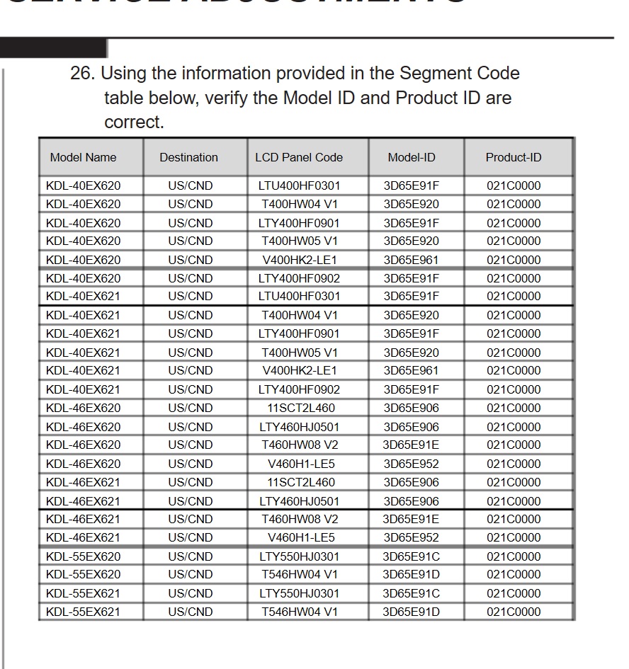

                    I strongly suspect you need to match the model/panel type since this board is used in multiple models. The supplier I bought this from (they had 5 in stock) just groups them together since they have the same part number. It's a crap shoot if you get a compatible one.

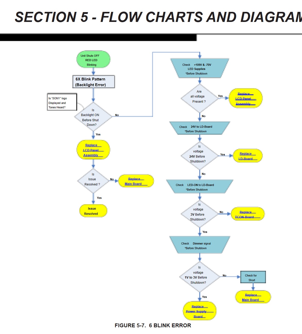

                    From the service/training manual, 6 blinks is backlight error and there are 24 different panel options in the service menu. For my model, there are still two different panels.

                      So what P/N number did you go by, the P/N PCB assembly as printed on the sticker?

                        Part number on sticker is A184571B.
                        Didn't order from shopjimmy but they only show one main board part number.
                        https://www.shopjimmy.com/sony-a-181...e-required.htm

                          Your panel number matches one of the two in your sj link?

                            I still cannot find error code for 10-blink in the service manual or the training manual for this chassis.

                                Panel is LTY550HJ0301. The shopjimmy link has 46" panels.

                                Yeah, the service manual only goes up to 8 blinks.

                                      I don't know where Diah wants to go, how can a VGA edid eprom to block the picture from appearing and end in protection? Don't seems logical, the screen config can't be bad as you have seen a picture for short. With the help of connector's markings or srv man. force the backlight on so we see if i' m wrong. And members please use commas, the reading is too difficult whithout...
