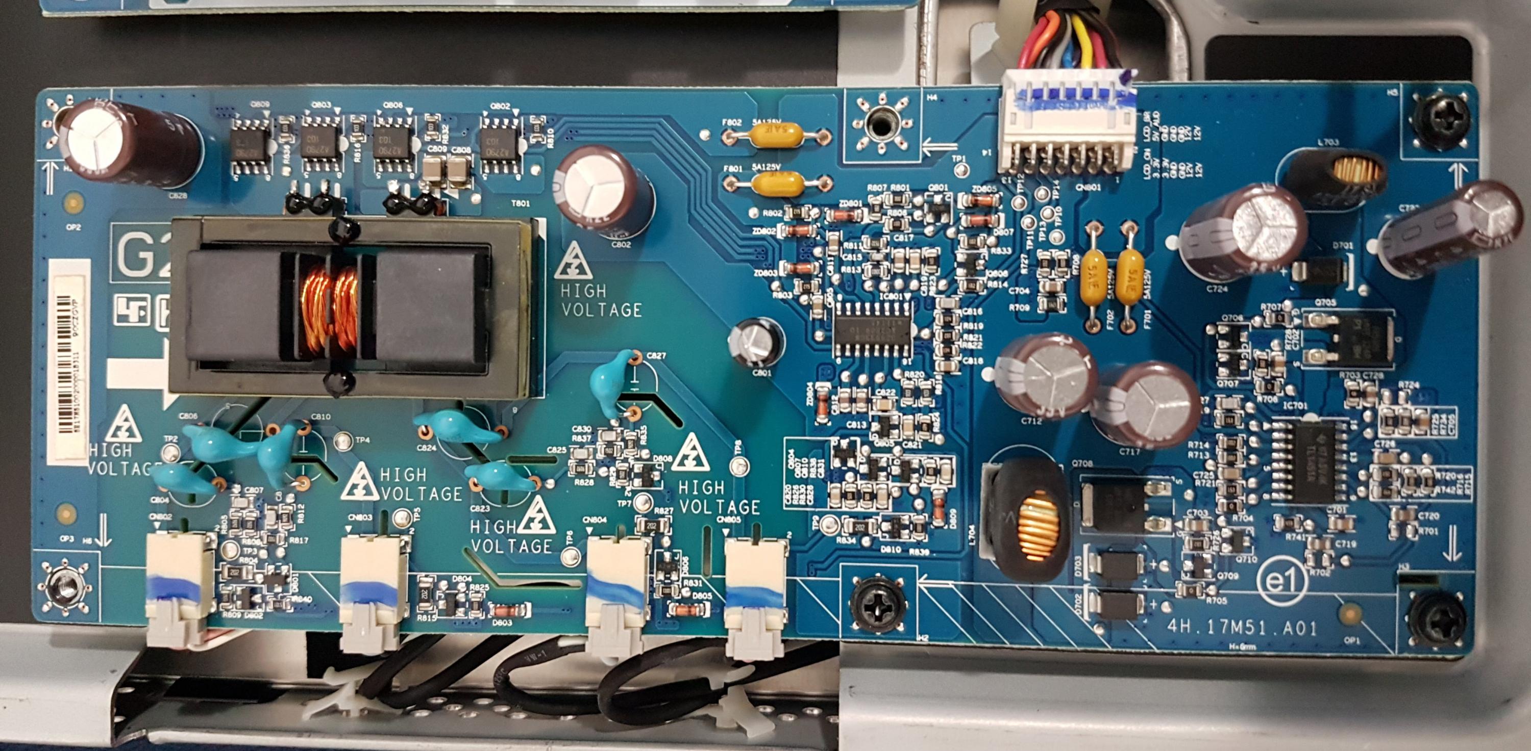

    I would very much appreciate any help or guidance with attempting to repair this Sony LMD-2110W LCD broadcast monitor.
    It shuts down when warm after running around 20min or so. I can only get it to turn back on by physically removing the power cable for around 1 minute. It will then run for around 10min and powers down again.
    Sometimes on a cold start, I can see a little flicker in the backlight in the bottom quarter of the screen.

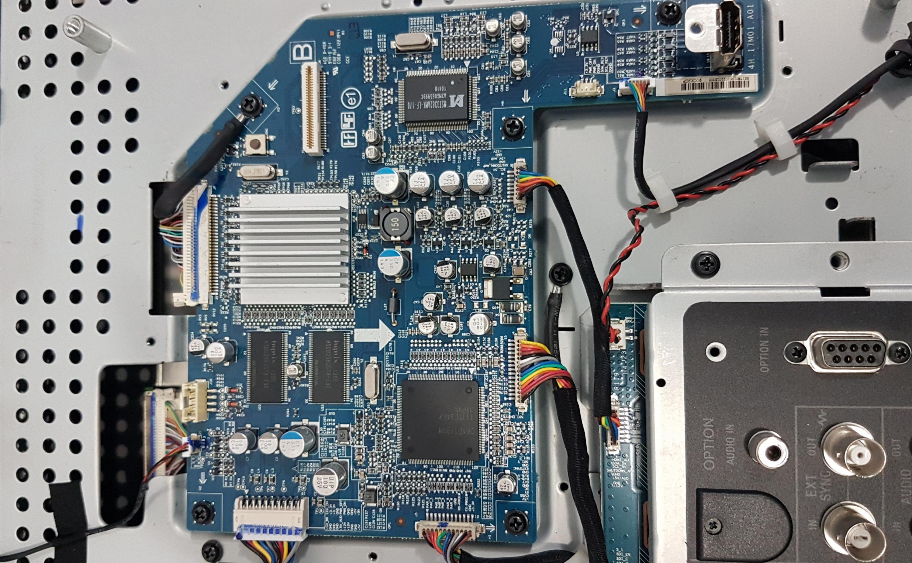

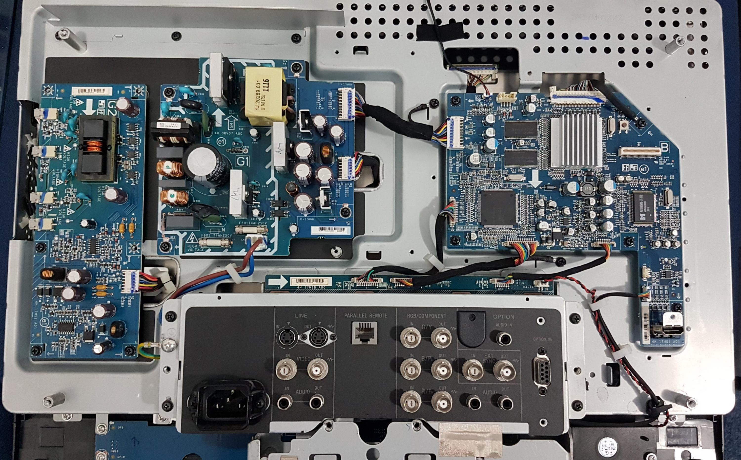

    If required I can remove individual boards to take pictures of the back of each board.
    pics attached.

    Re: Sony LMD-2110W LCD monitor shuts down when warm
    Flickering and shutting down to heat sounds like a failing ccfl or failing connection where the wire joins the end of the ccfl.

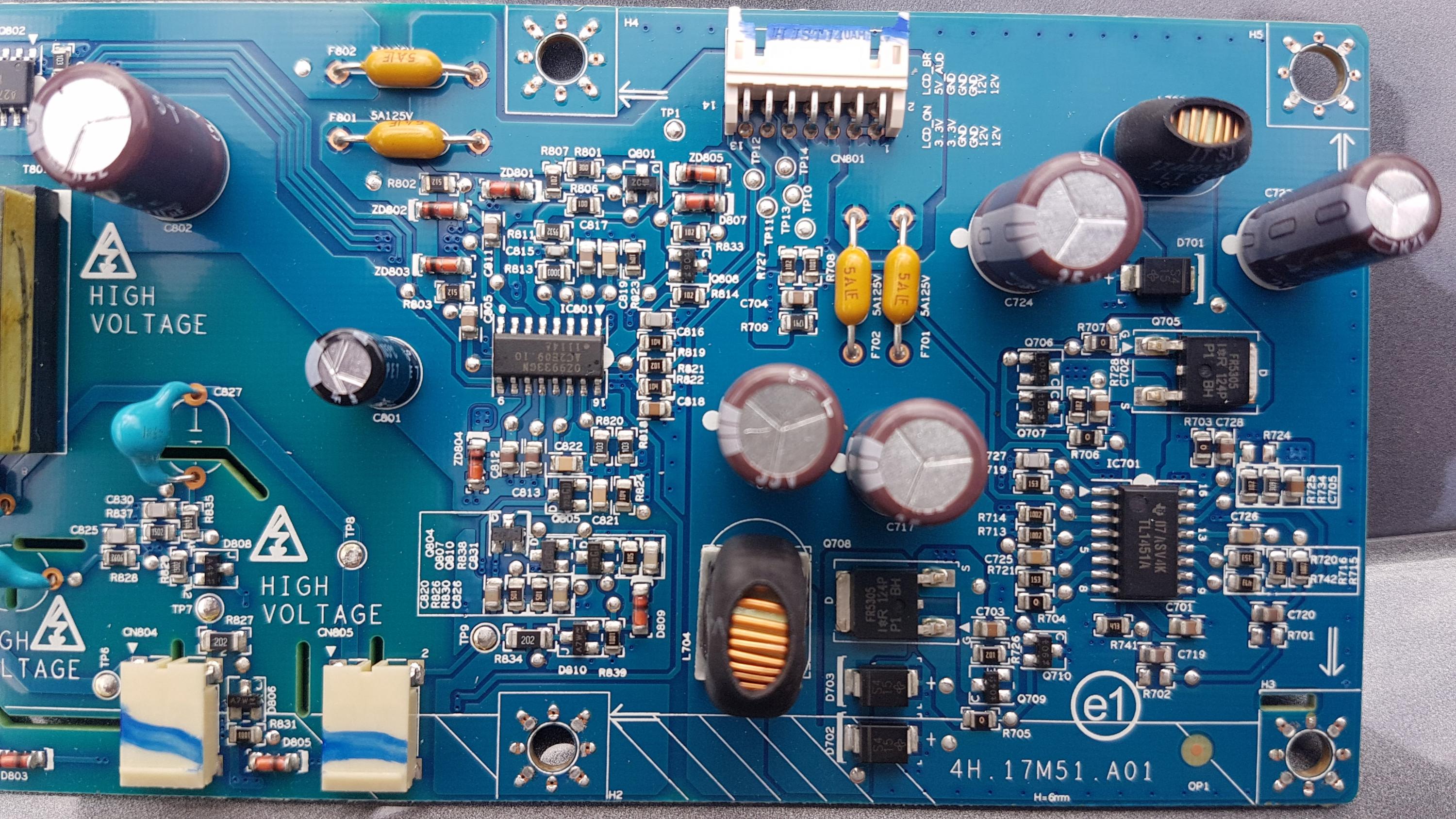

                          "Complete shutdown. No backlight and front green status light turns off. Can only cycle power back on by removing mains cable."
                          https://www.badcaps.net/forum/attach...1&d=1565715023

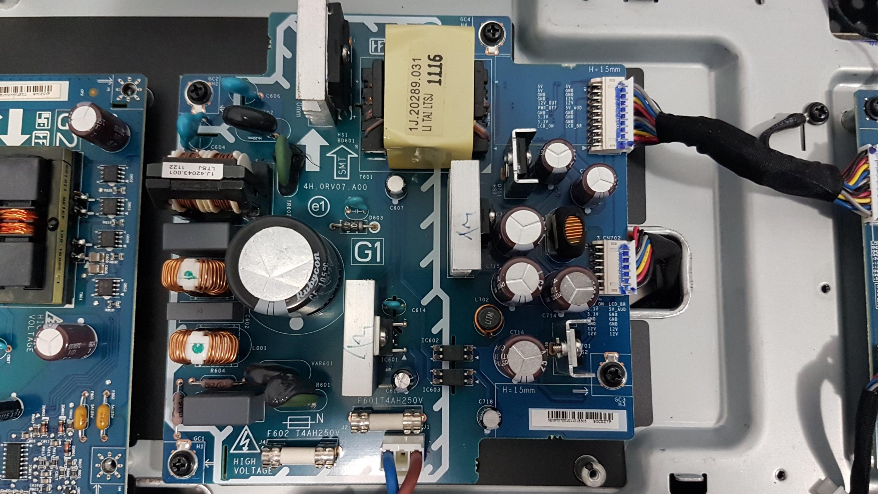

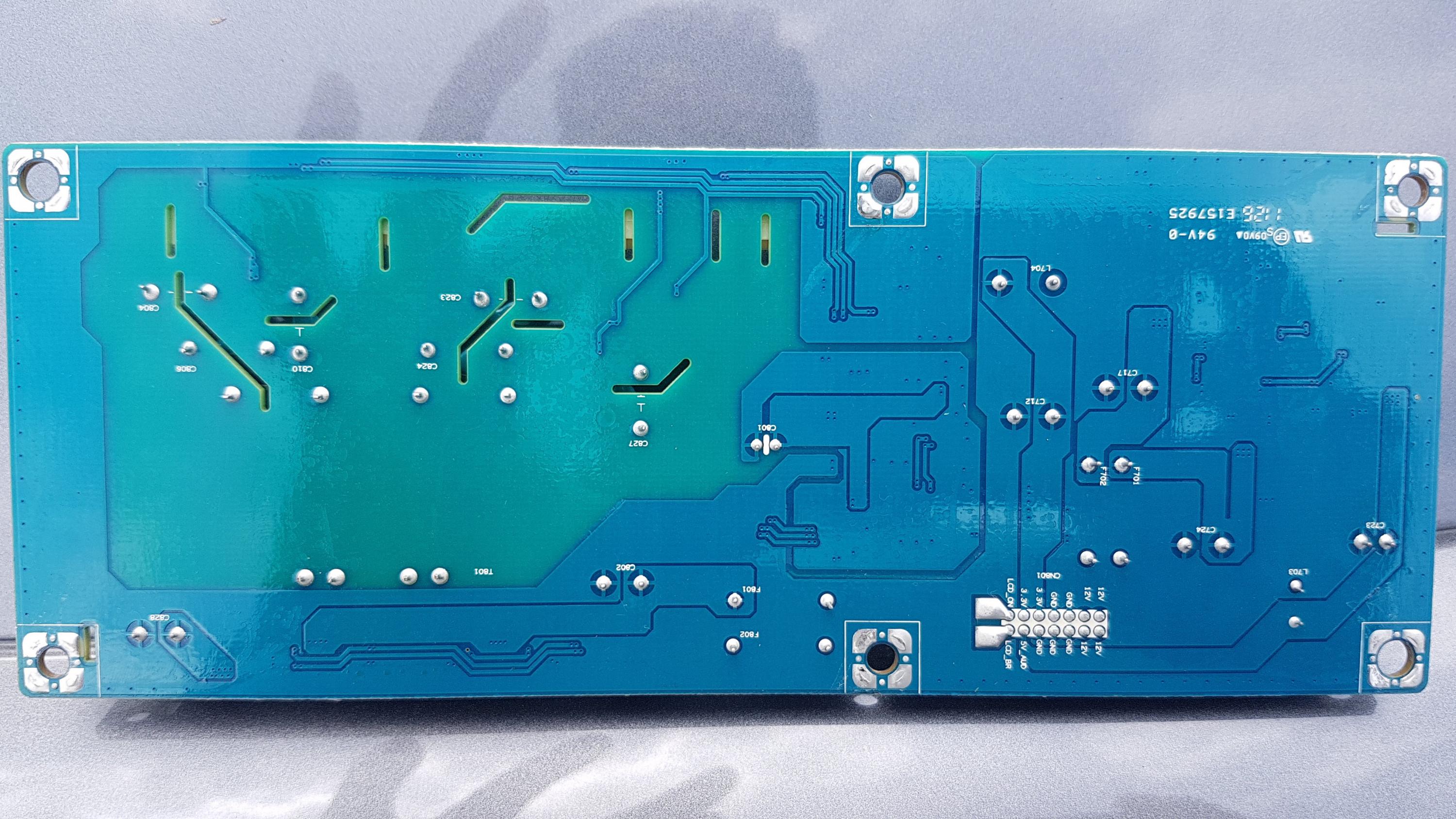

                          After close inspection of the inverter board, I do not see any error feedback pin on the inverter board to tell the monitor to go into shutdown due to error on the inverter board.
                          Please check the Voltages on that CN801 connector when it is working and when it goes into shutdown.
                          Also look at the bottom side of the inverter board around the inverter transformer to see if it has any sign of over heating.

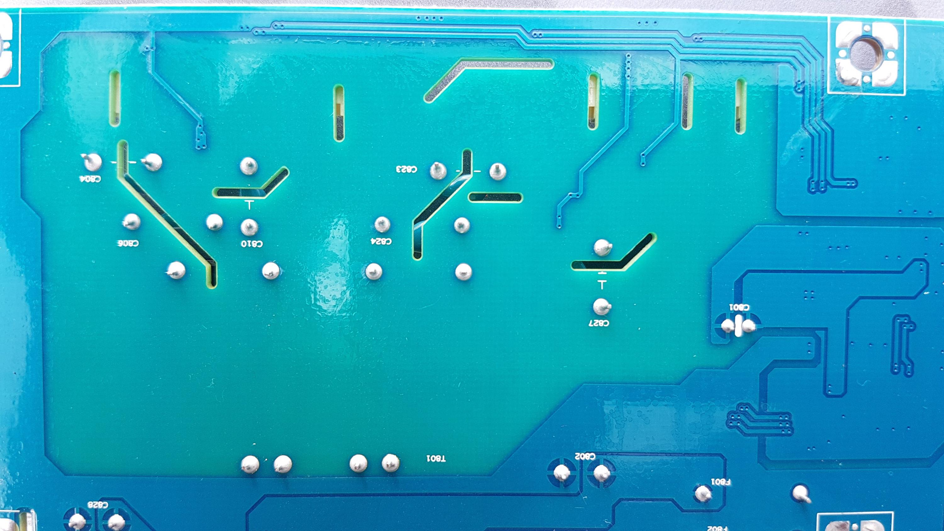

                            Maybe check the underside of the boards for any cold/bad solder joints. Do the voltage checking first.

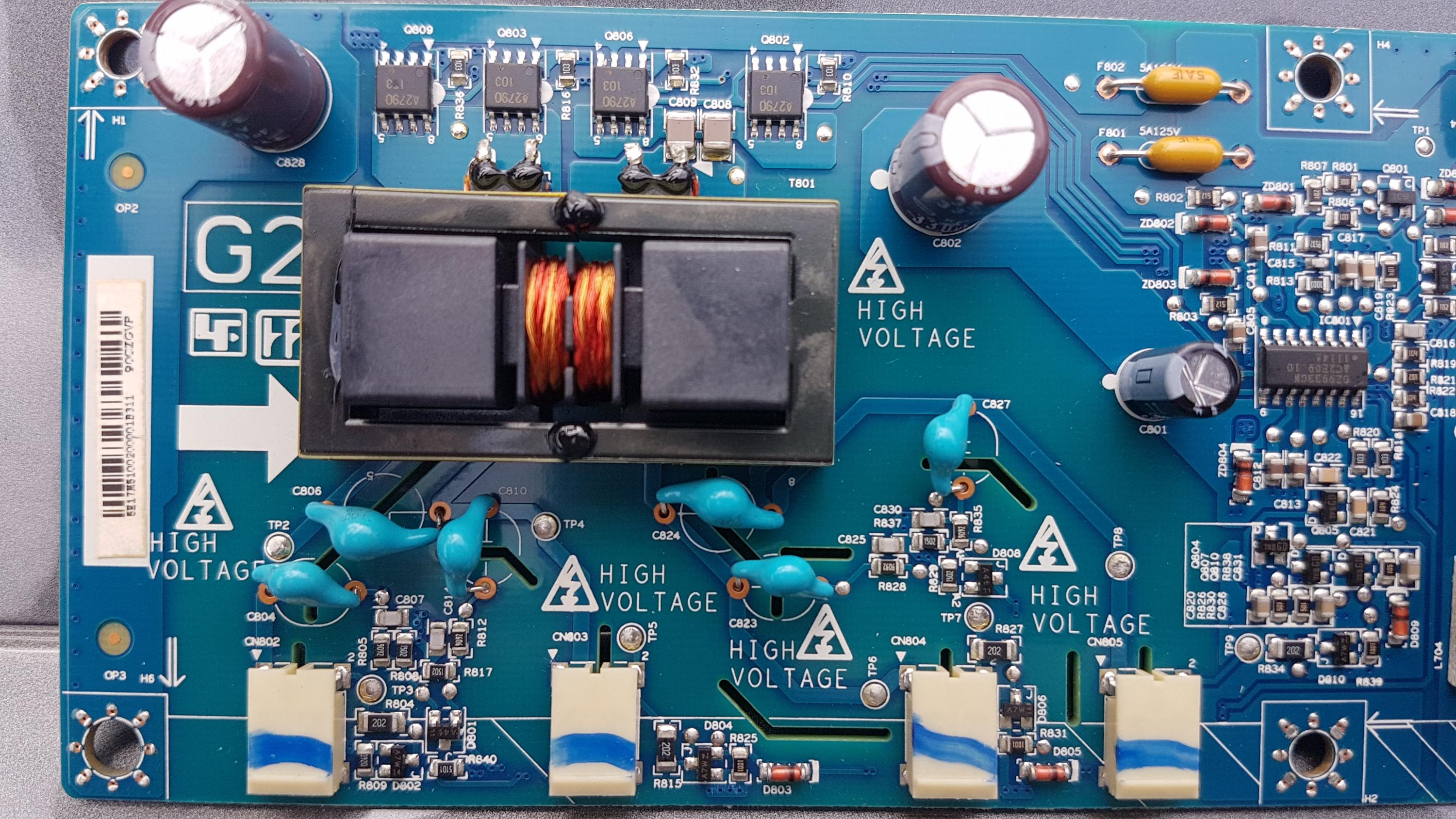

                              Can you put up a better/more focused picture of the inverter board?
                                      Uploaded higher-res pics of inverter board front and back as requested
