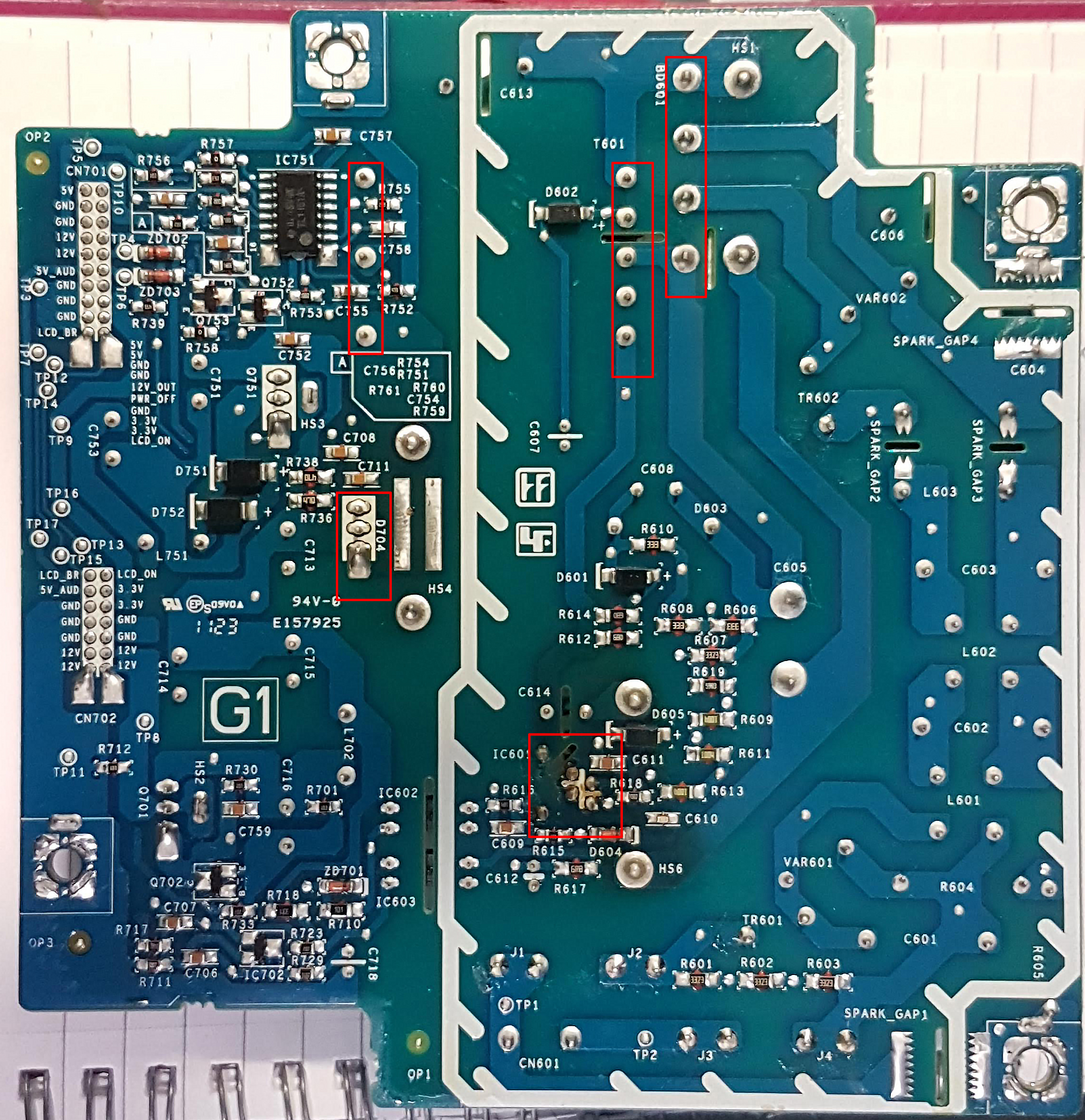

        Update :
        While I was waiting for a new set of thinner probes for my DM I decided to look at the back of the power supply board (see pic attached). As suggested by some of you guys earlier on I resoldered all the areas outlined in red. So far the monitor has been running for 4 hours without going into shutdown. Will run a longer test tomorrow and update if this has indeed solved the issue.
        zx81.

          #44
          Re: Sony LMD-2110W LCD monitor shuts down when warm
          Nice work, I think you fixed it.

            #45
            There's a whole bunch there that look like they need touched up.

              #46
              This was only possible because of you guys contributing to the thread with your wealth of experience.
              I'd like to thank every single one of you guys who chimed in. This is a truly awesome forum and community. I'm amazed how some of you guys can look at some lowish resolution JPEG pics of the boards and diagnose whats going on.
              Thank you guys.
              zx81.

                #47
                I get lucky sometimes, fortunately you didn't have a complicated fault just bad joints.
