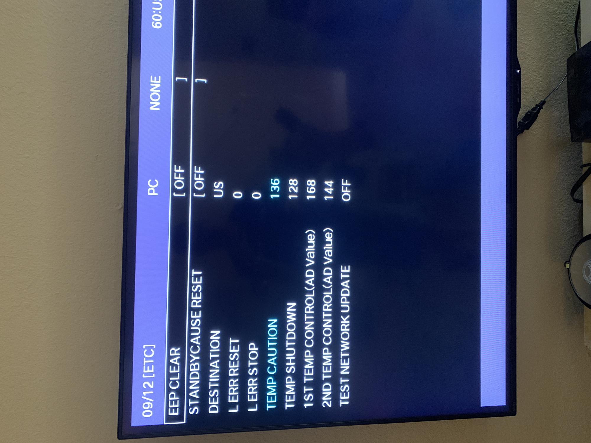

              Re: Sharp LC-70LE660U stuck at logo...kinda
              Could be you need to go into service menu, if you have lamp errors you need to clear them. Have to be very careful in service menu, adjusting something wrong can brick the tv.

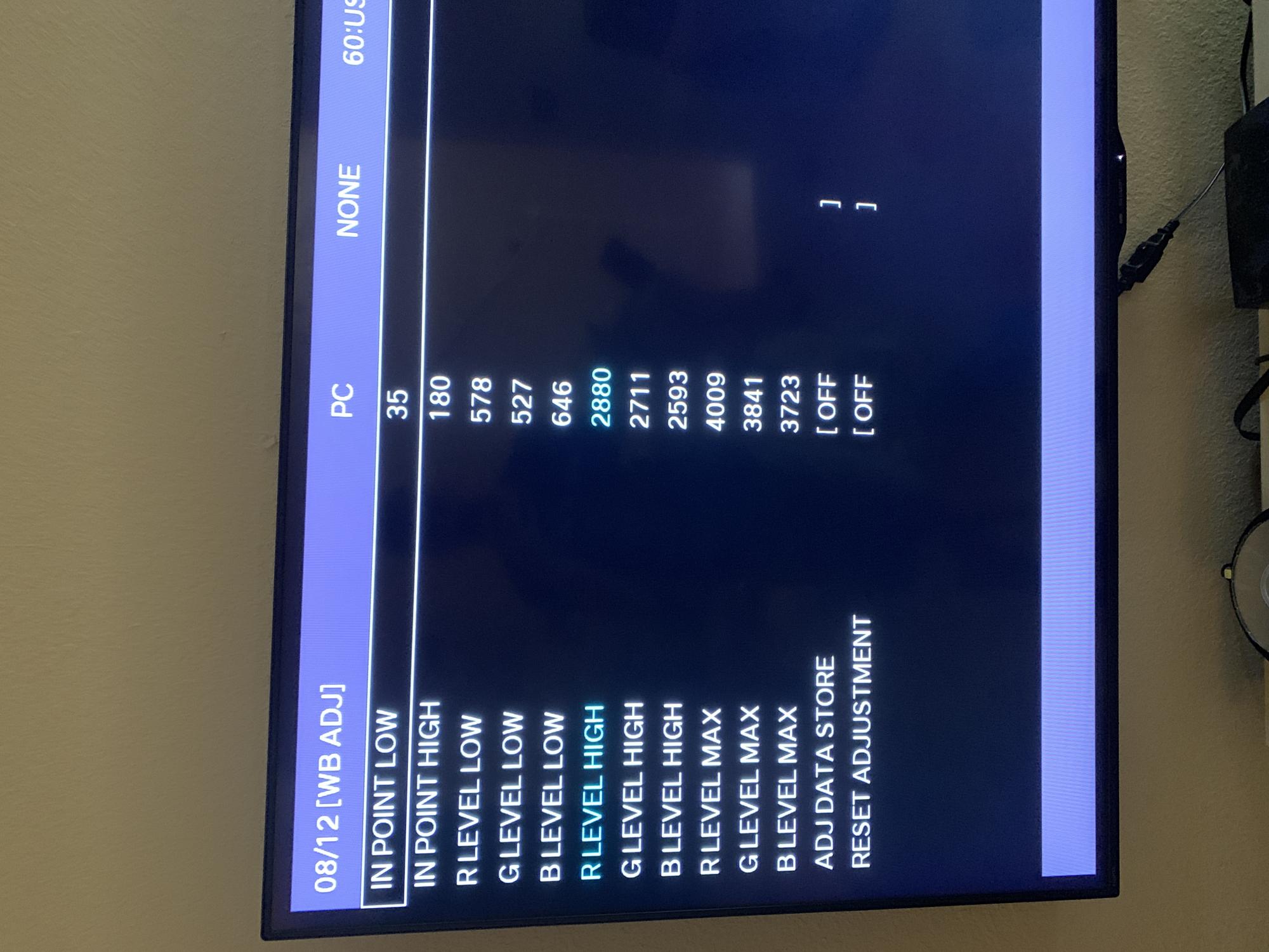

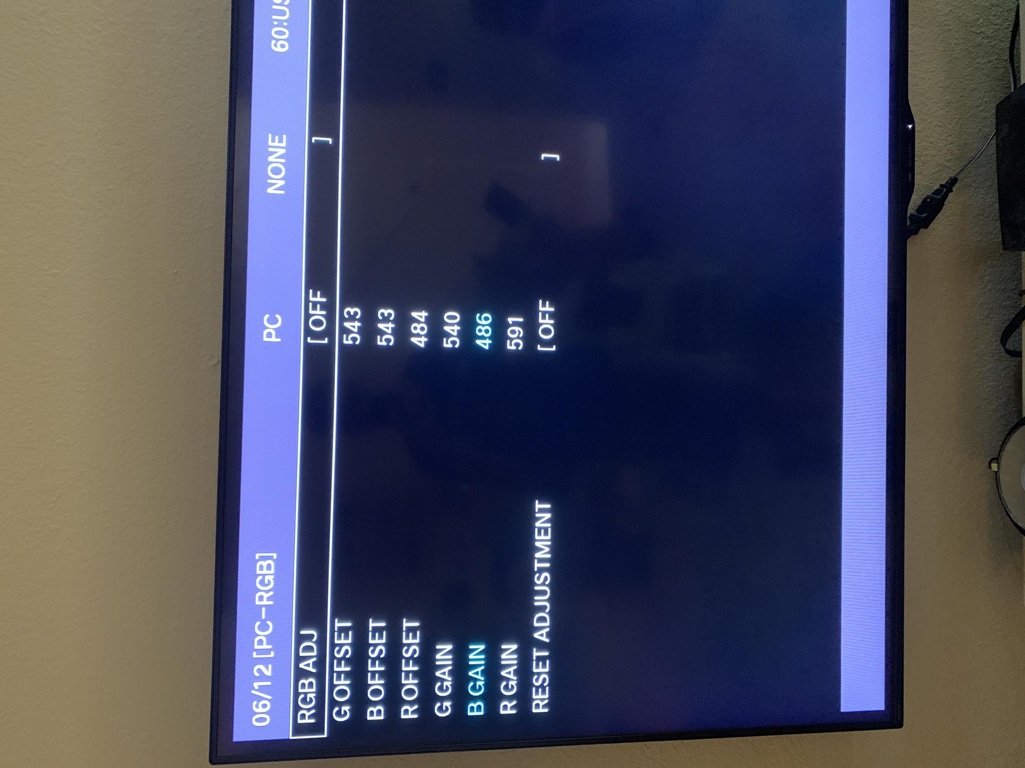

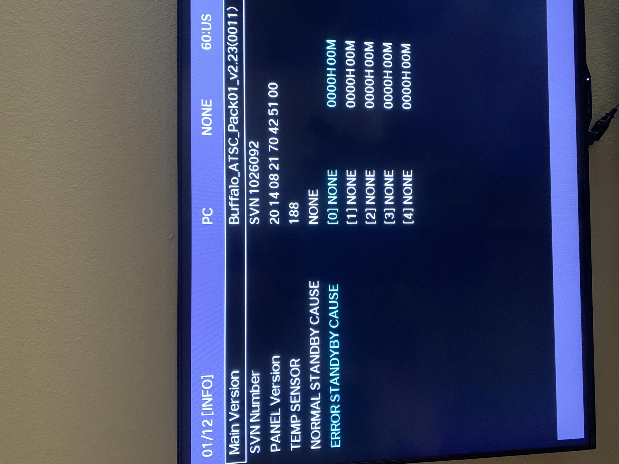

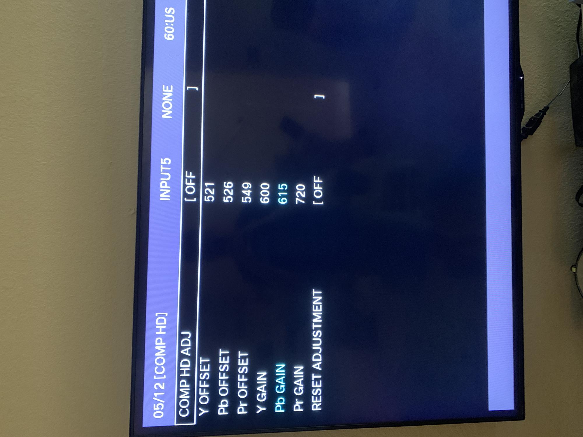

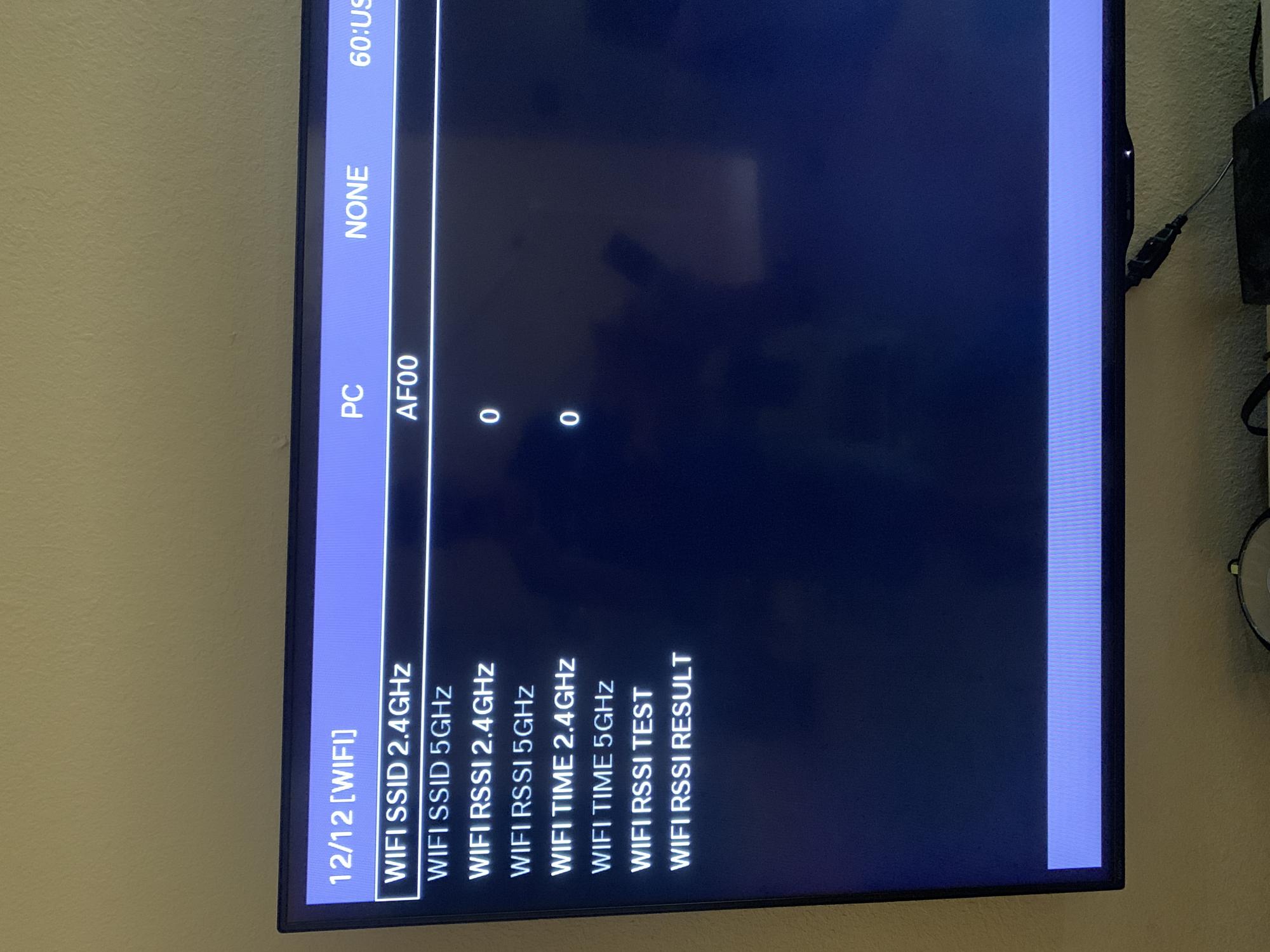

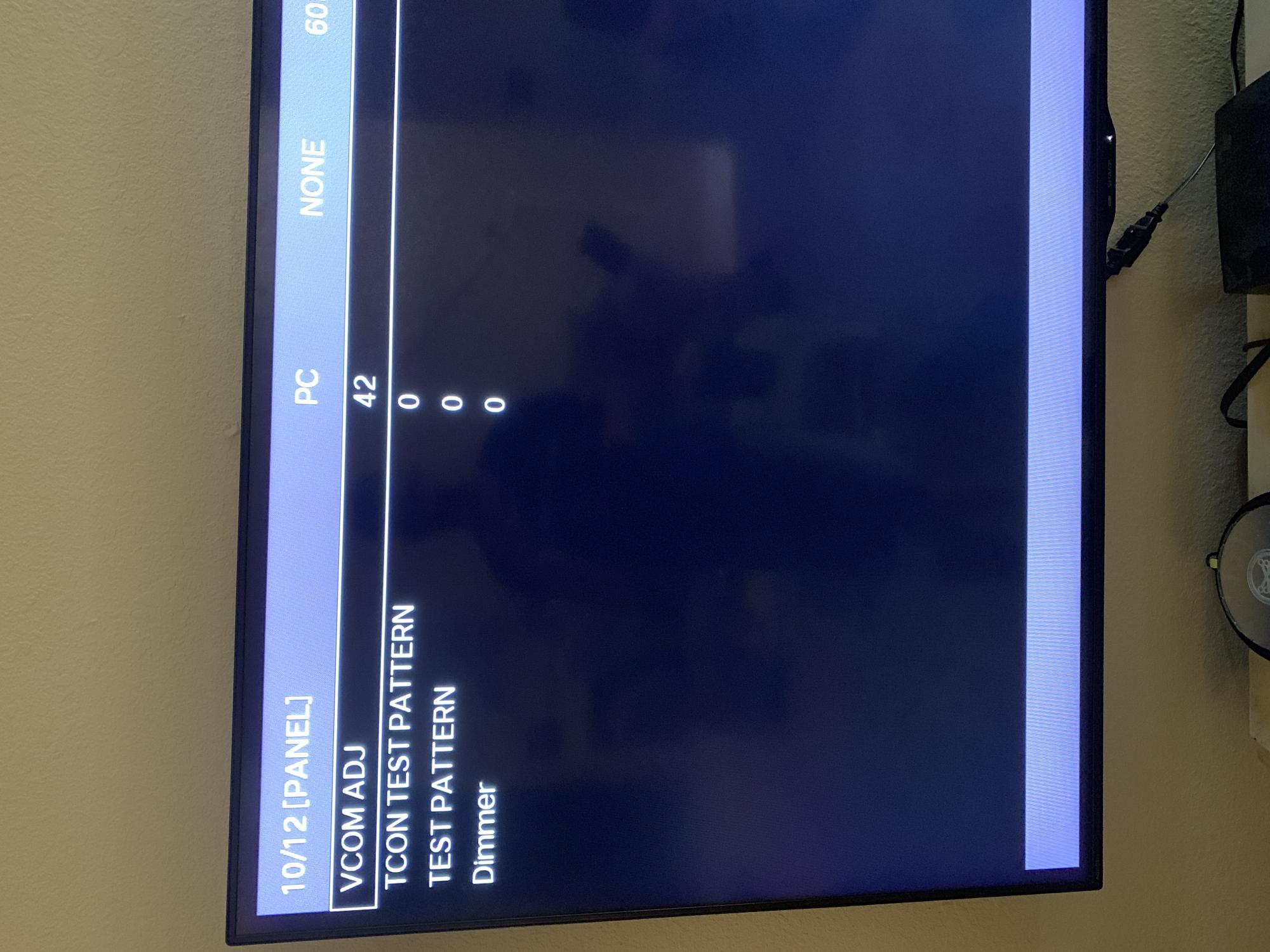

              • showngo2000
                • Jun 2018
                • 15

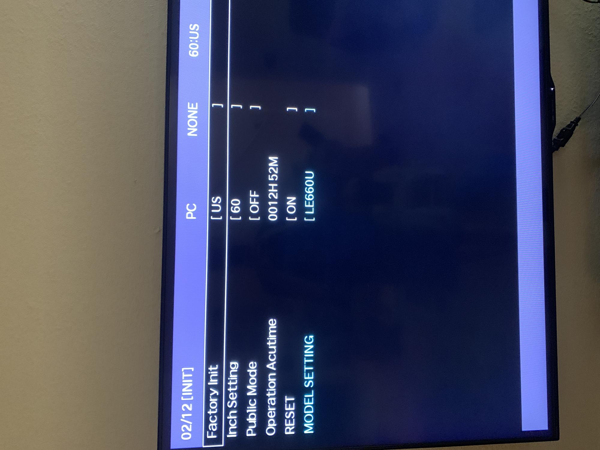

                Thanks for the help. I went into the service menu and didn't see any errors anywhere. It says there's 12 pages, but not all 12 are accessible. I've attached photos of every page I can get to.
                Also it's setup for a 60” panel, is that right?
                  This is from the service manual
                  • nomoresonys
                    • Jan 2013
                    • 12307
                    • U.S.
                    You could toggle the screen size setting there see if it has a 70, maybe do a lamp error reset, shouldn't hurt any but I don't see a lamp error on that screen??
