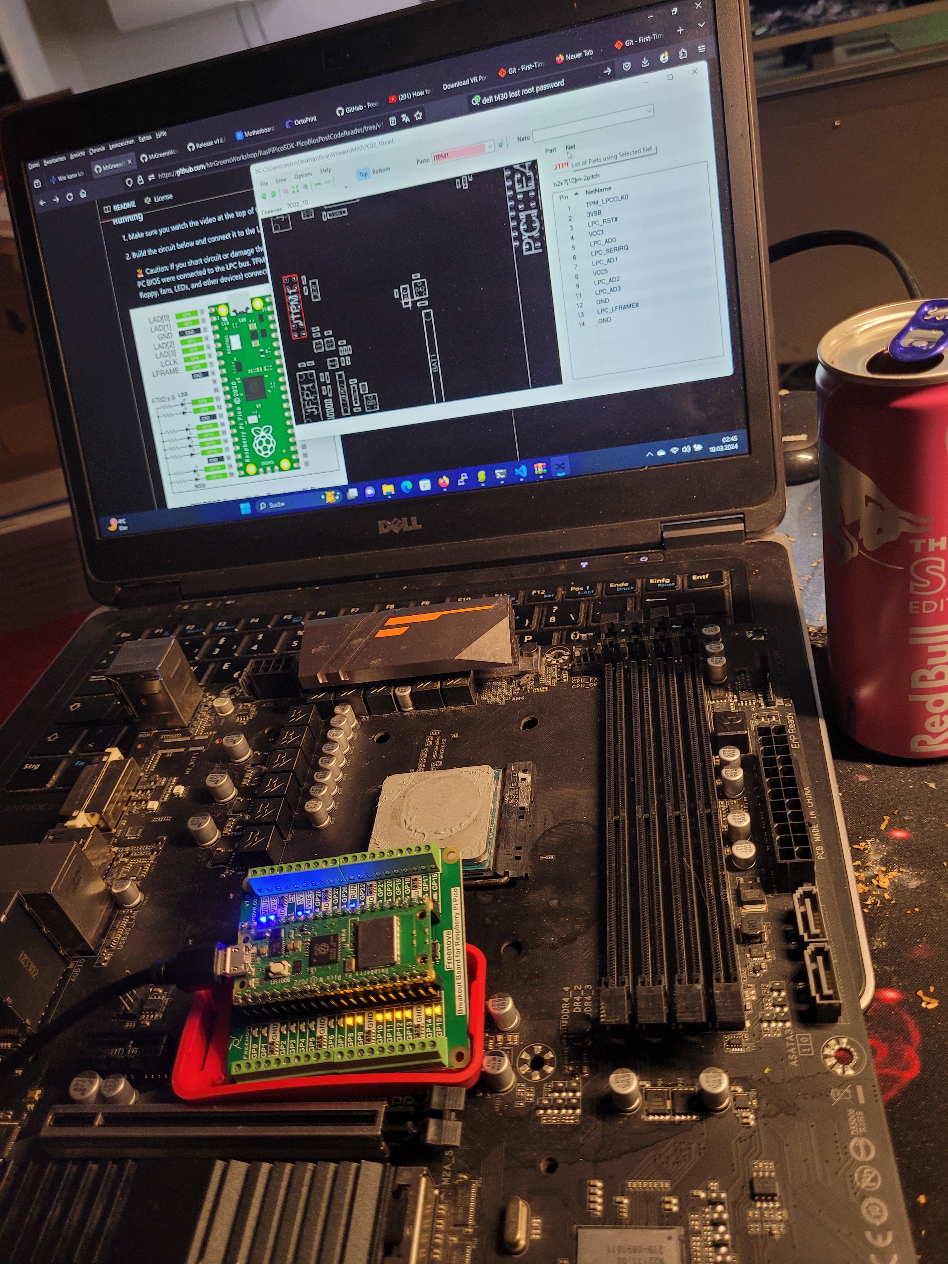

                  I got myself a raspberry pi pico w for postcode readings. Better that buying some more expensive ready to use debug card for more money... Ist working perfekt at TPM Header... Board is stuck at postcode "90" in the meaning of (Boot Device Selection (BDS) phase is started) but still showing VGA debug LED
                  Found a breakout board with LEDs already installed so could safe some time for soldering led´s and resistors. it´s usable right out of the box after programming an put the pico and the breadboard together. its better to read the Codes via serial connection with putty rather than looking at the LED´s... I did that.... nice Job from some guy on github...
                  https://github.com/MrGreensWorkshop/RasPiPicoSDK-PicoBiosPostCodeReader
                  needed: Ras
                  pberryPi Pico and freenove breakout board for about 25 euro´s
                  Click image for larger version  Name:	20240310_024529.jpg Views:	0 Size:	3.20 MB ID:	3232055
                  Video of Putty reading out via serial console...
                  https://youtube.com/shorts/DXi8TP8cu...x_eMRk4zhzpYhe
                  i hope this will bring a solution in future....

                    i forgot the logfile from putty with codes:
