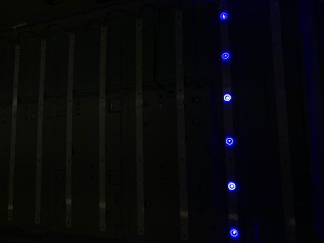

    Hi Everyone,
    Hot on the repair of my plasma I found a 55" 4K LED backlit hisense tv for £40 on facebook that would be great for a garage TV if I can get it working correctly. The listing said it had a purple tint (and it does indeed).
    When I've powered it up and looked through the vents in the rear the backlight can indeed be seen to be purple rather than the usual crisp white I'm used to seeing. Is this a thing? Can all the LEDs change colour like that? I use high power LEDs where I work and am used to seeing a few nm drift in colour when they get hot but to go from white to purple? I Imagine that if I replace the backlights it would give me a nice picture as this is it's only problem but is it something that's seen often?
    Thanks in advance once again.

      there are threads here about "purple leds" problem... basically, you need to replace them.

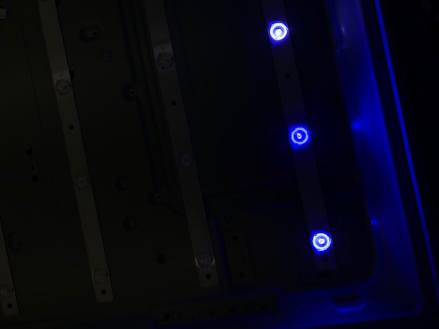

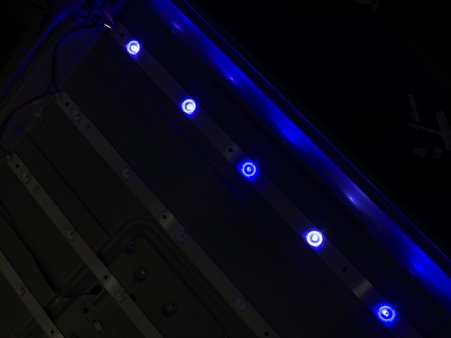

        So indeed the back light had turned blue/purple. It seems that there's no real thermal junction between the LED boards and the back panel other than periodic screws to hold them in place. Something I'll remedy if I replace the LEDs.
        While the swap out would normally be a cut and dry affair during disassembly I found that there was a strip of adhesive connecting a small part of the front bezel to the LCD panel itself. Had it been all around I'd have been fine as I'd know to expect it but it wasn't and I didn't.
        I managed to damage the very bottom right corner of the panel as a result. While the panel is still working there's a small amount of bleed through in this location. I was hoping to give my mother in law the screen to replace her aged 32" Polaroid but I imagine it will be a screen for the kids to use instead. It may be that if I made a frame I could lose the bottom inch of the TV in the frame to hide it.
        So note of caution, beware the odd piece of randomly placed tape.
        Also the screen on this TV is sooo thin. I assume to minimise loss through the glass but the amount of flex was unreal. I had to remove the panel by turning the TV up on it's side and carrying vertically.

            this is not as you thought Purple LED. you have one shorted or open LED which cause the PSU drop down the current to the LED strips so some of them lid in this way. i didn't find you were measure the current out of he LED from PSU Socket. just the eyes judgments

                      Over time, the yellow phosphor will degrade and all you have left is blue light, which can look purple too. THAT is the science of it, those that think otherwise need to look it up.

                        sorry... what are you talking about ? yes Hisense LED wasn't pure white since beginning , they draw black circle over the strips to enhance black level only , also the black some time look little to blue. but this not the case over all links provided over here.(2018-2019 ). in 2017 i had Hisense under my hand and i was very deep searched ( https://www.badcaps.net/forum/showthread.php?t=62117 ) till the LED back light. .. let us talk sense.. not stories of fiction

                                Its the Leds no the board. I have encountered this problem a dozen times.

                                  https://www.badcaps.net/forum/showthread.php?t=80139
                                  Yellow filter crumbles away causing blue/purple color.
