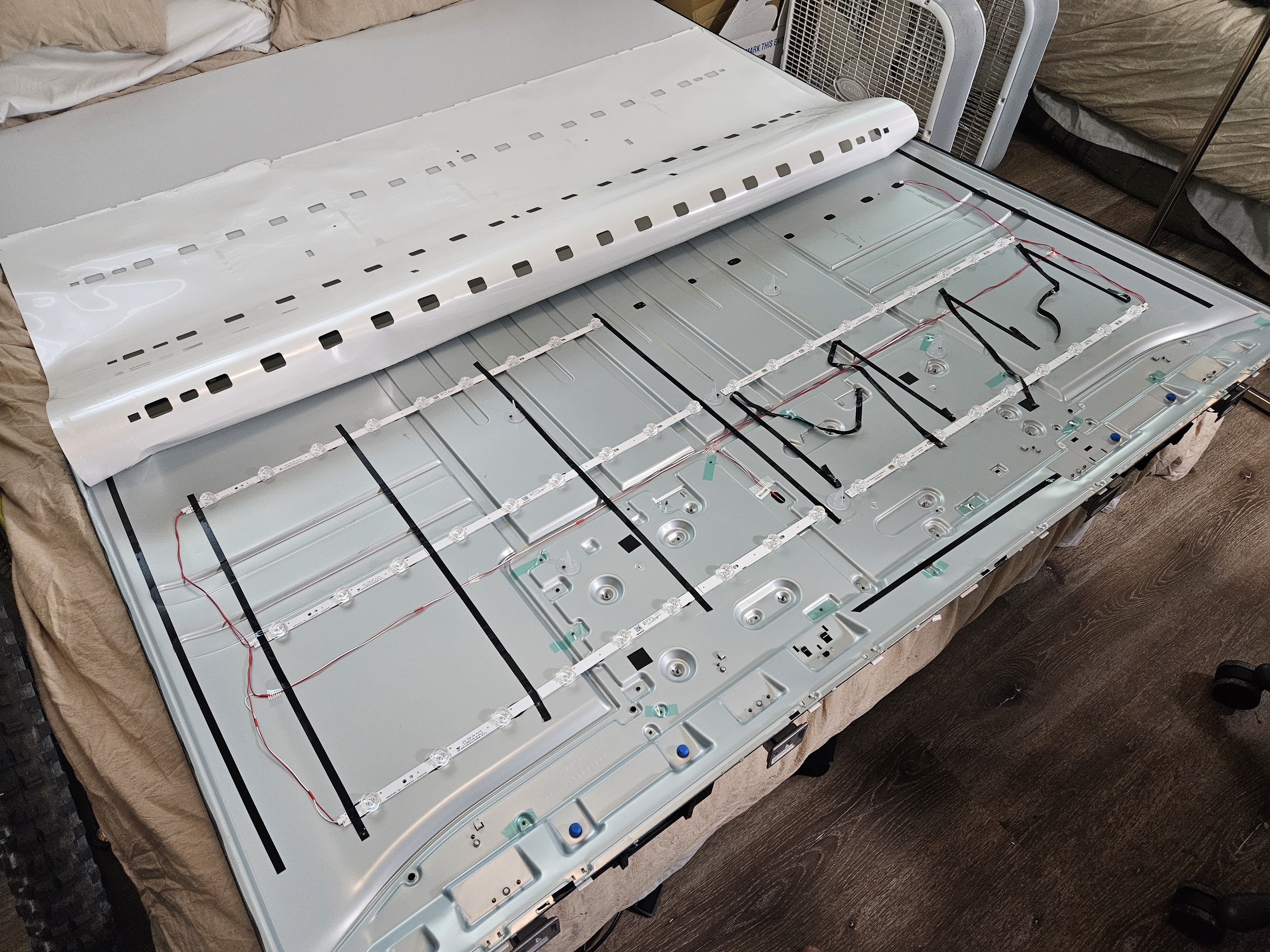

    Background:
    • Hisense 65H6570G stopped working and I root caused to a burnt out LED in the backlight. (For anyone interested the power light pattern when the backlight has gone is 1) two long flashes, 2) a very short third flash, then 3) back to solid red https://photos.app.goo.gl/VWve47GqPxLdApJ48 ) Click image for larger version  Name:	20240916_202822.jpg Views:	0 Size:	2.72 MB ID:	3486172
    • I replaced all 6 of the backlight LED strips with these replacements: amazon
    • The TV worked again perfectly for ~2 weeks.

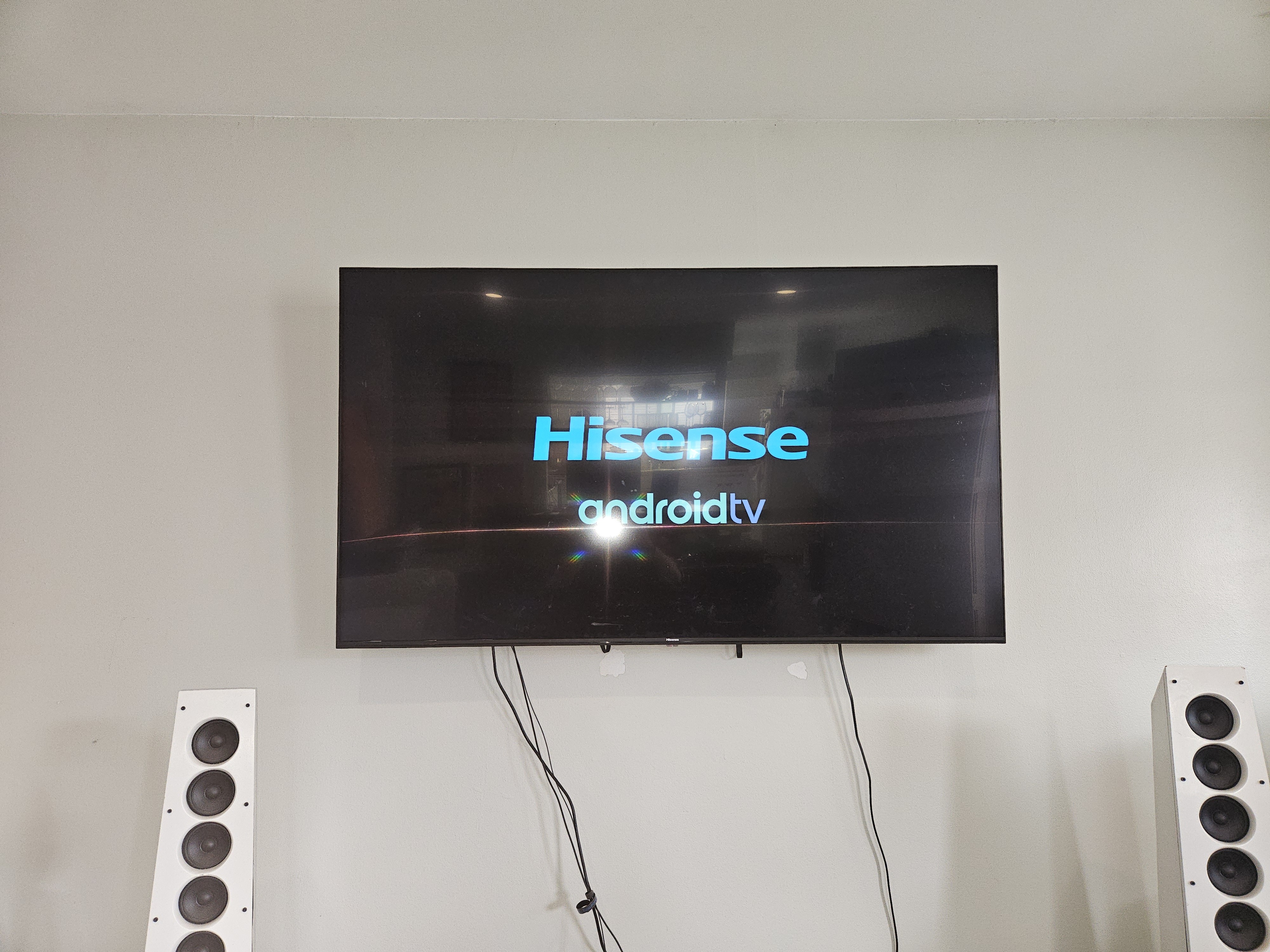

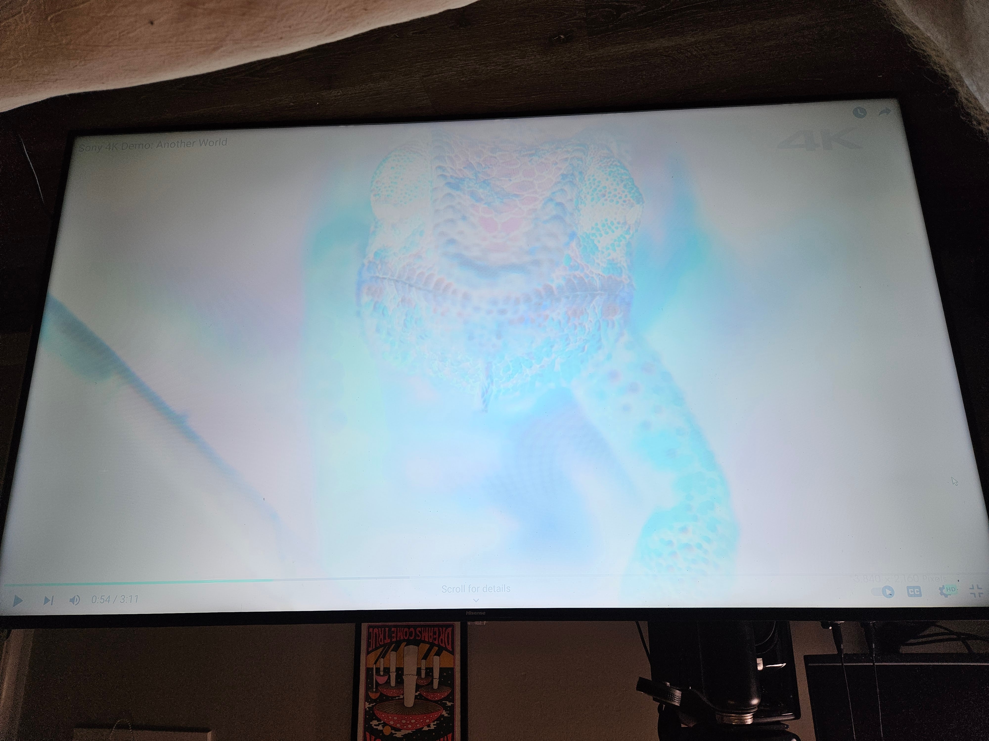

    • After that 2 weeks the colors became "inverted". The TV powers on and shows the boot screen in correct colors initially (aqua hisense logo on black background, pic on the left) but a few seconds after boot the colors invert where black becomes white, red becomes green etc.Click image for larger version  Name:	20240929_154006.jpg Views:	0 Size:	2.47 MB ID:	3486170Click image for larger version  Name:	20240929_154011.jpg Views:	0 Size:	1.75 MB ID:	3486169Click image for larger version  Name:	20240929_154043.jpg Views:	0 Size:	1.64 MB ID:	3486171

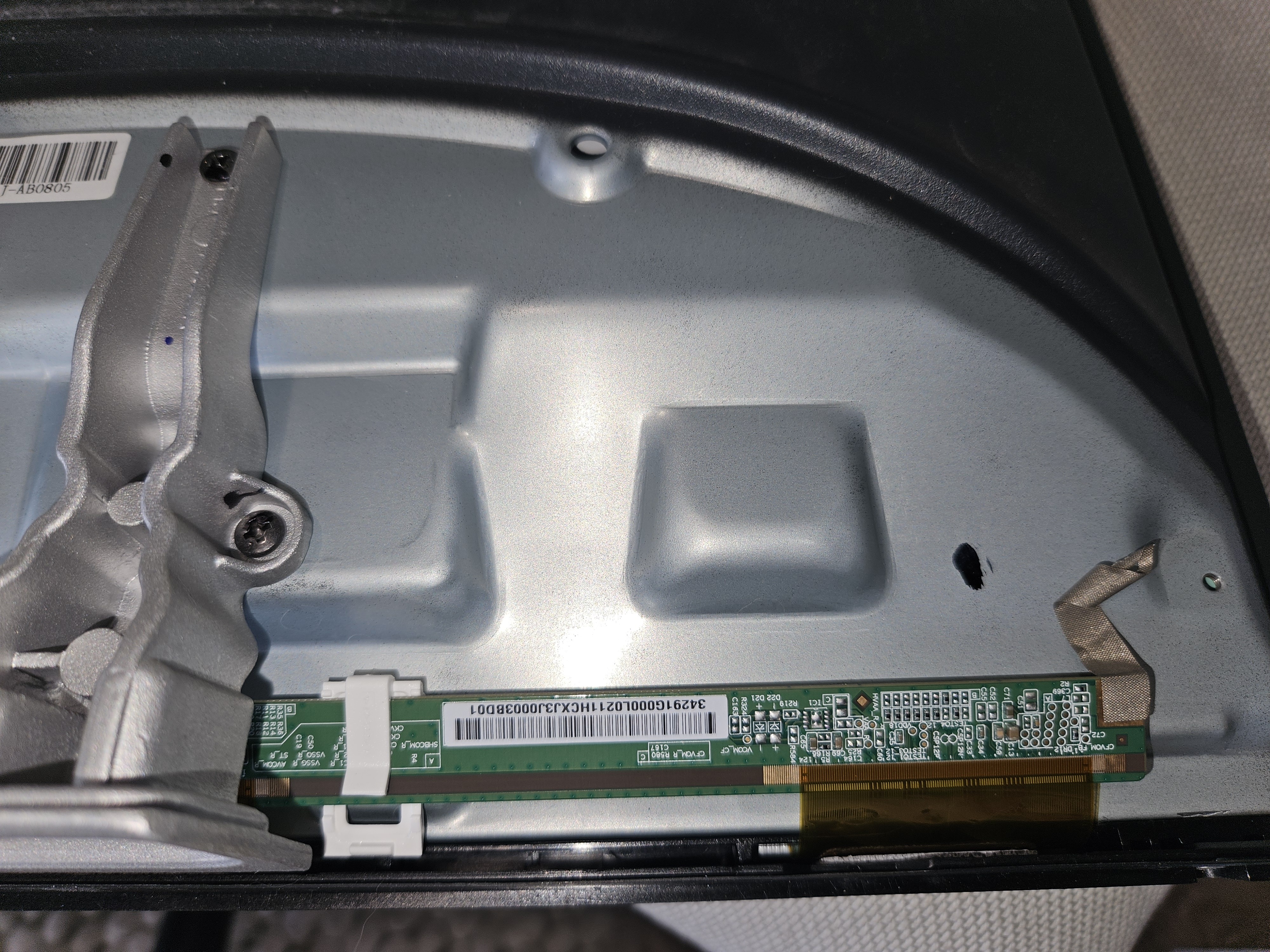

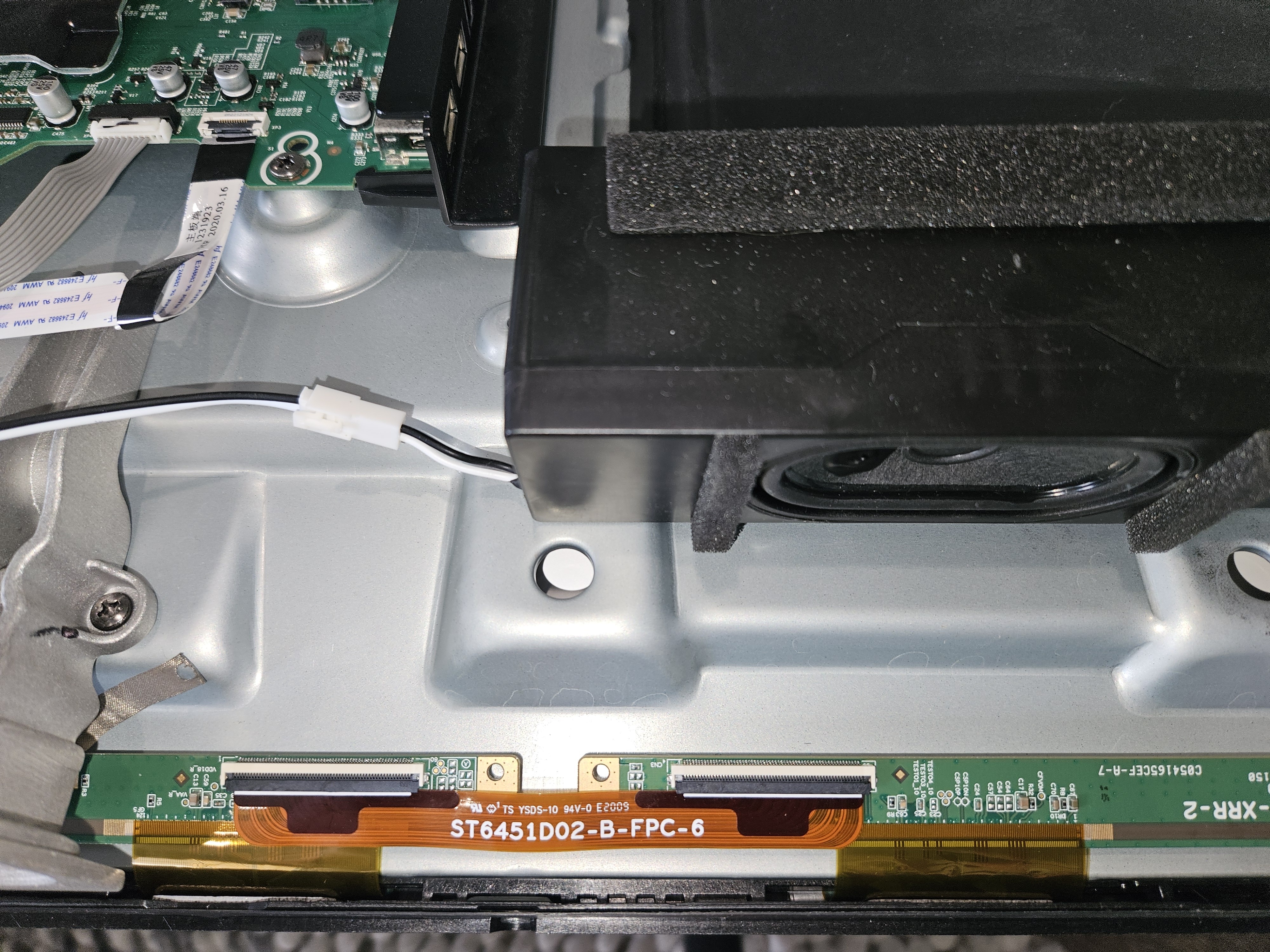

    I have tried re-seating various connectors and found that if the left quarter of the panel is disconnected then the remaining 3/4 of the screen shows correct colors. I tried applying pressure and re-seating all the ribbon cables for this left quarter but that did not improve anything.
    Is there any chance of saving this or does this color inversion suggest that I damaged the panel during the backlight replacement?

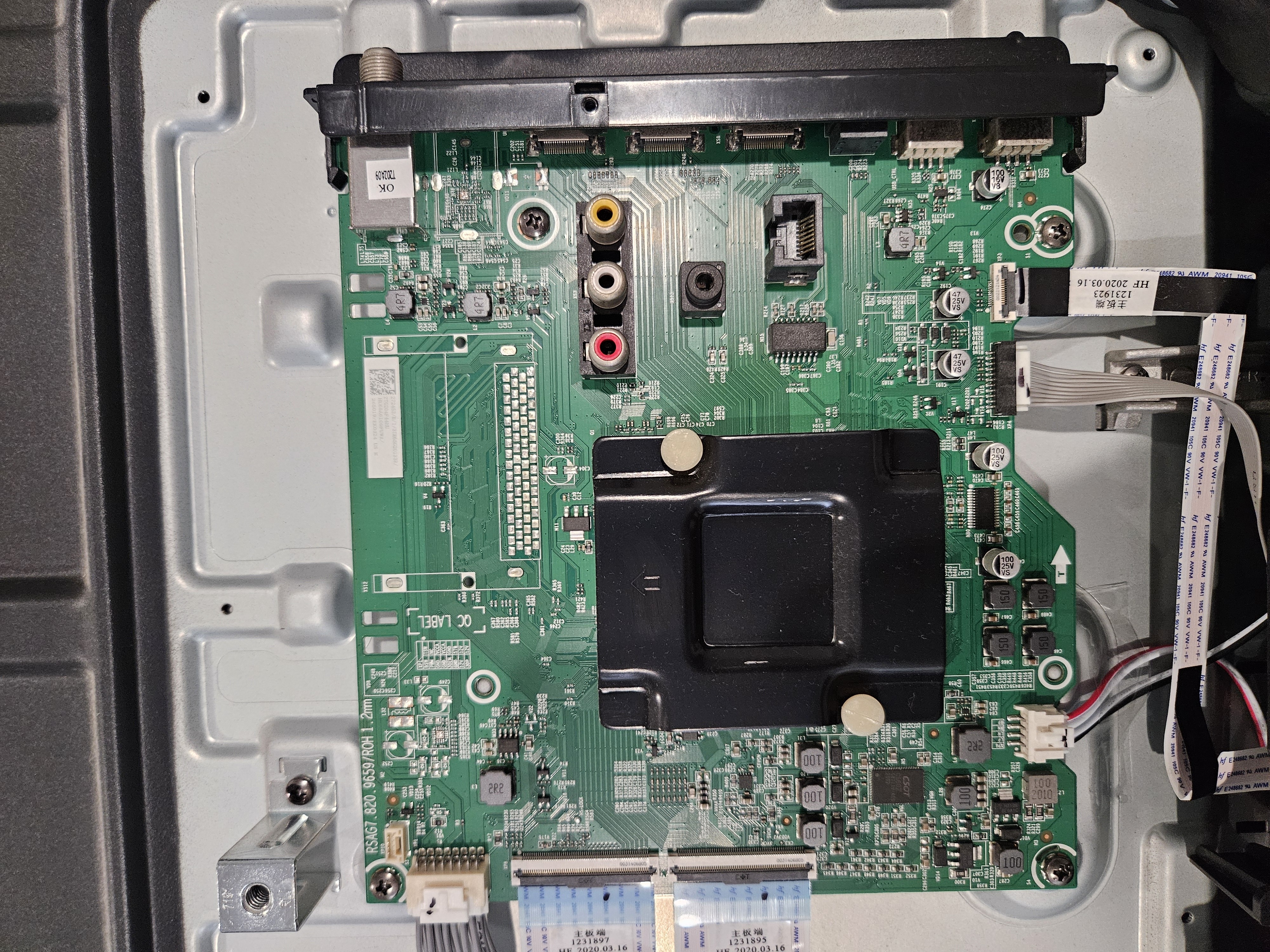

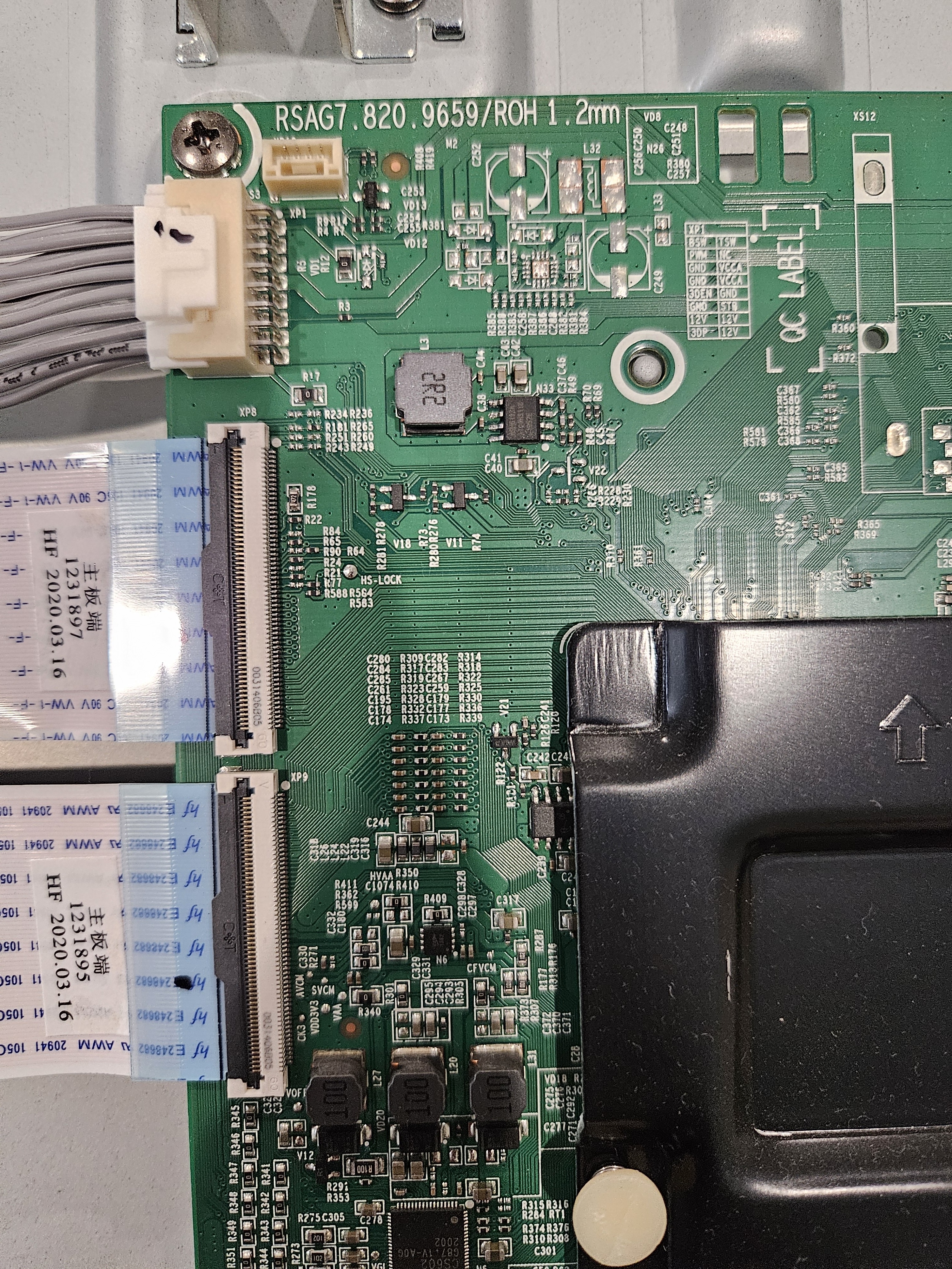

      Hi, my suspect the panel is ok, but you have processor to be reballed, i wanna you make this experiment (never tried) , remove heatsink, check in volts every choke inductor, when you find the one for the vcore around 1v, connect in parallel an electrolytic cap low esr of around 470uF 6,3v or more to the caps connected to that inductor, then try the tv..

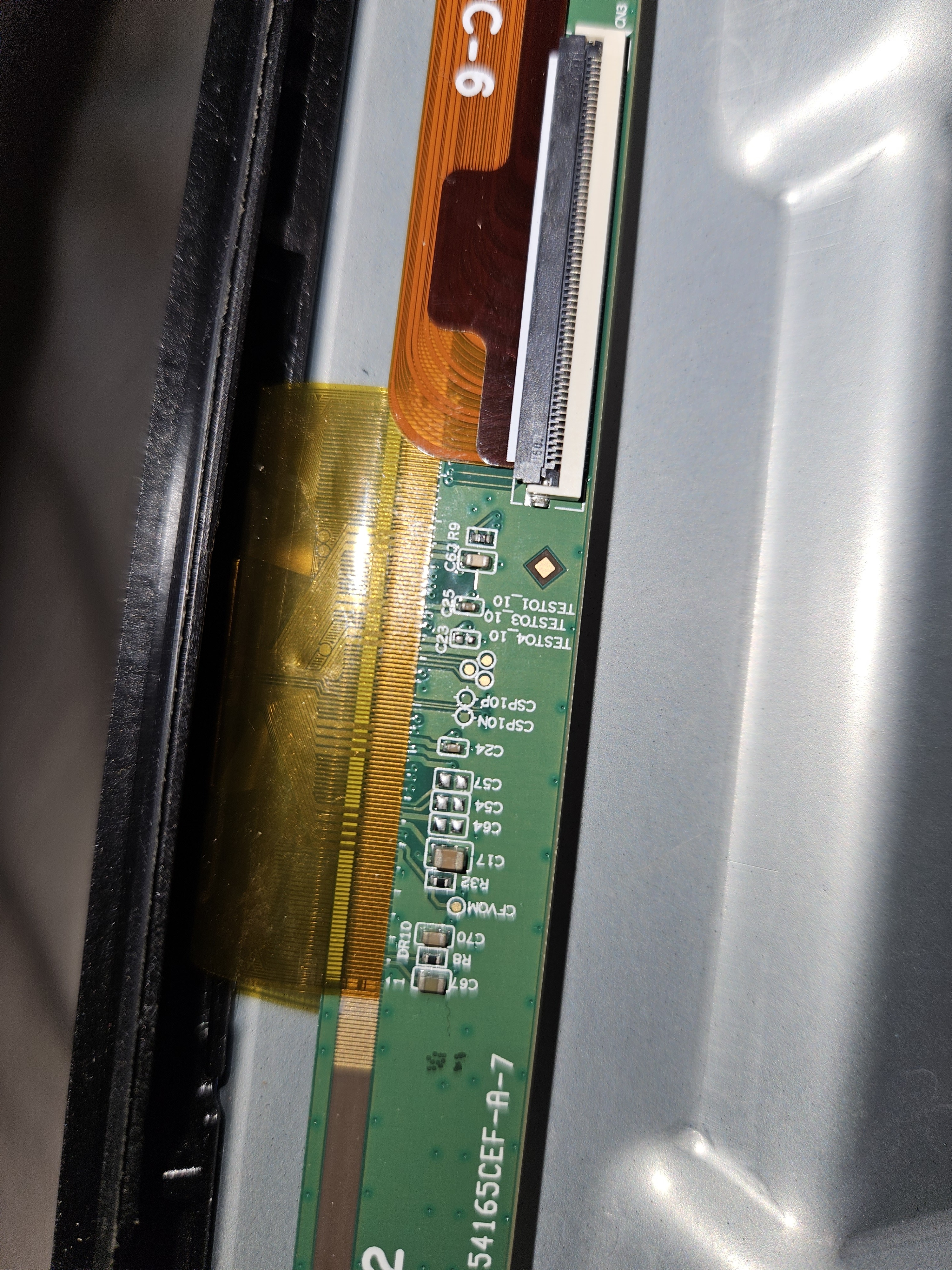

            • Checking grounding tape - the tape on the far left (on the quarter that causes the color inversion) was semi-peeled off although I think still in contact. I applied clear tape to firmly affix but that didn't change anything (I am reusing the grounding tape). After seeing this I am slightly worried that lack of grounding may have cooked some component?

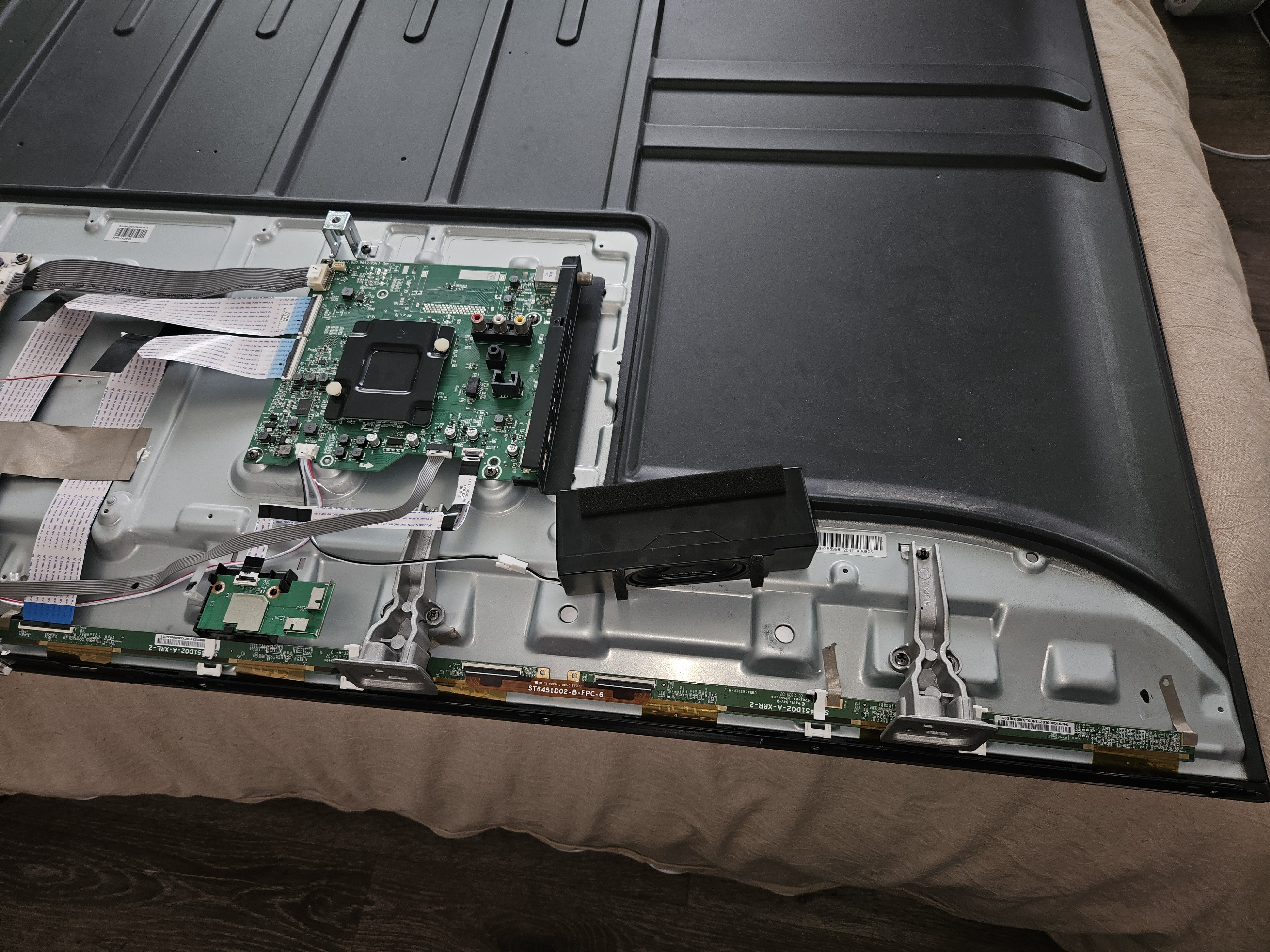

            • Covering ribbon pins/checking ribbon cables -
              • The only way to remove the color inversion is to completely disconnect the left quarter of the panel by either a) disconnecting the white ribbon cable (E248682 AWM 20941) for the left half of the panel from the main board, or b) disconnecting the brown ribbon cable (ST6451D02-B-FPC-6) that connects the left most quarter with the inner left quarter.
              • Isolating either half of the pins on either the white or brown ribbon cable results in some part of the image not working but the colors stay inverted in the rest of the panel.
              • The same brown ribbon cable is used on both sides to connect quarters together -- I tried swapping the left and right cables and nothing changed (disconnecting the left quarter still fixes colors even with newly switched brown ribbon cables)
              • I can't see anything suspicious with a magnifying glass. Can't see any breaks in the traces and the pins on the cable and socket look normal.

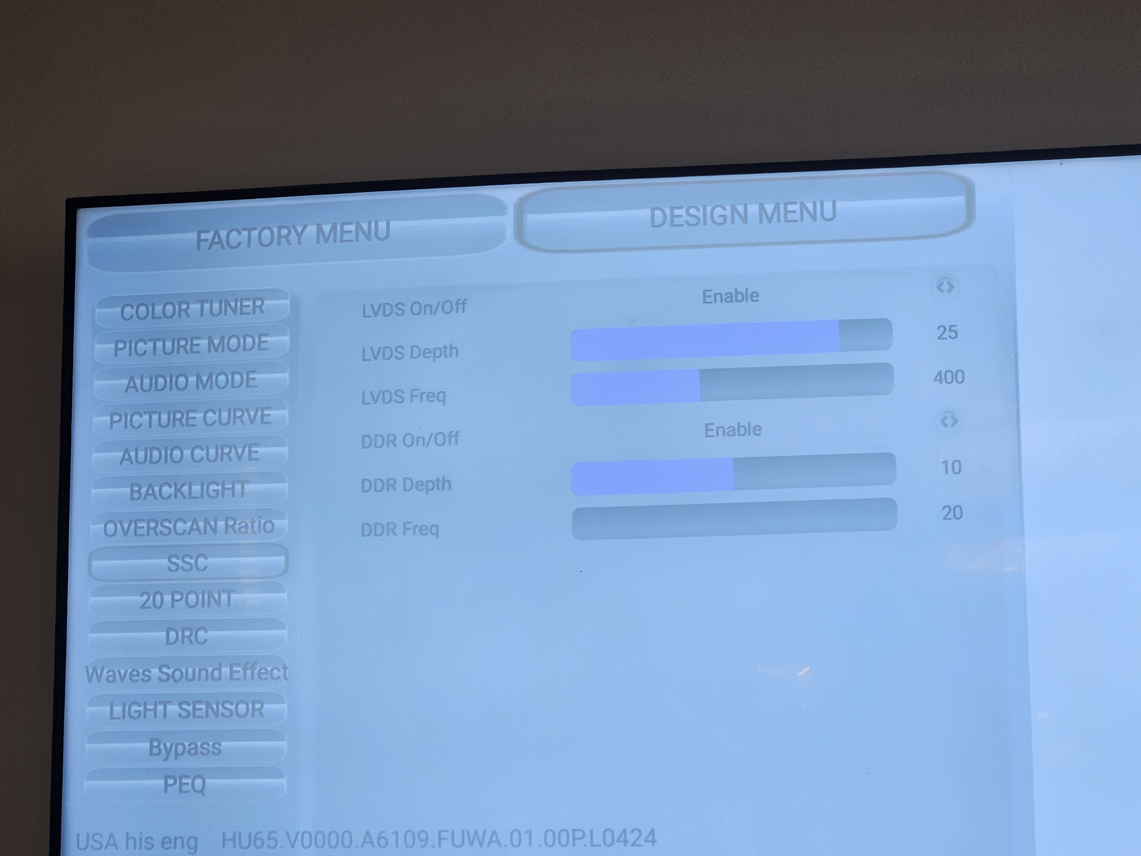

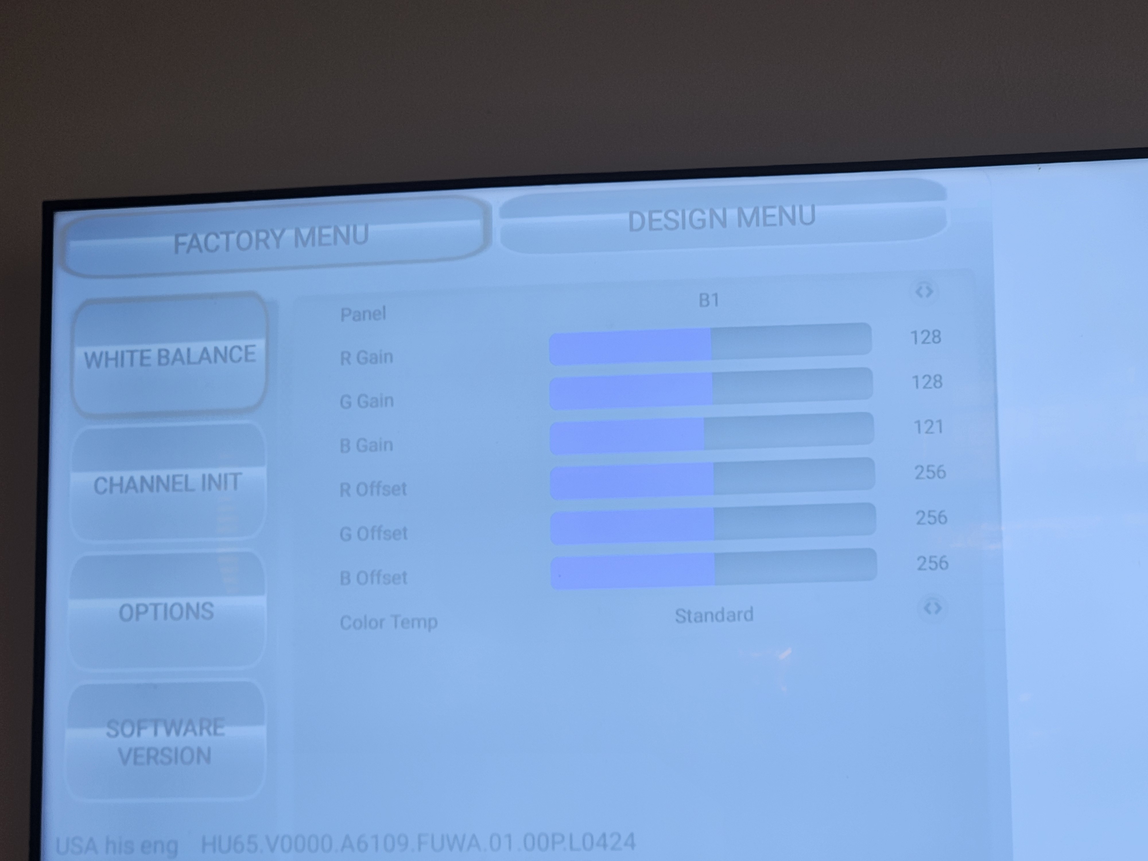

            • "clear chip" in service menu - I couldn't find anything resembling that in service menu, am I looking in the right place?
ID:	3490351 Click image for larger version

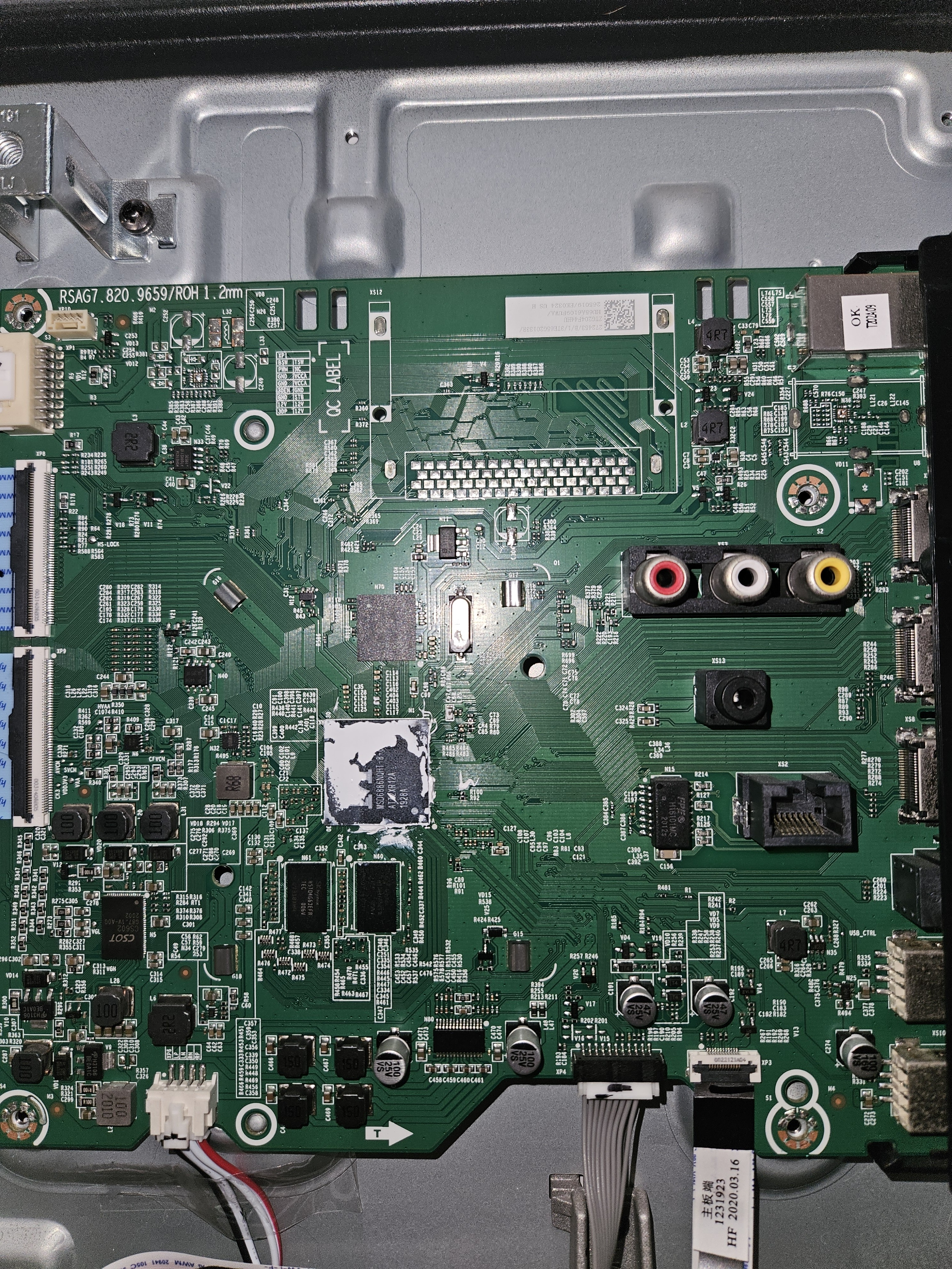

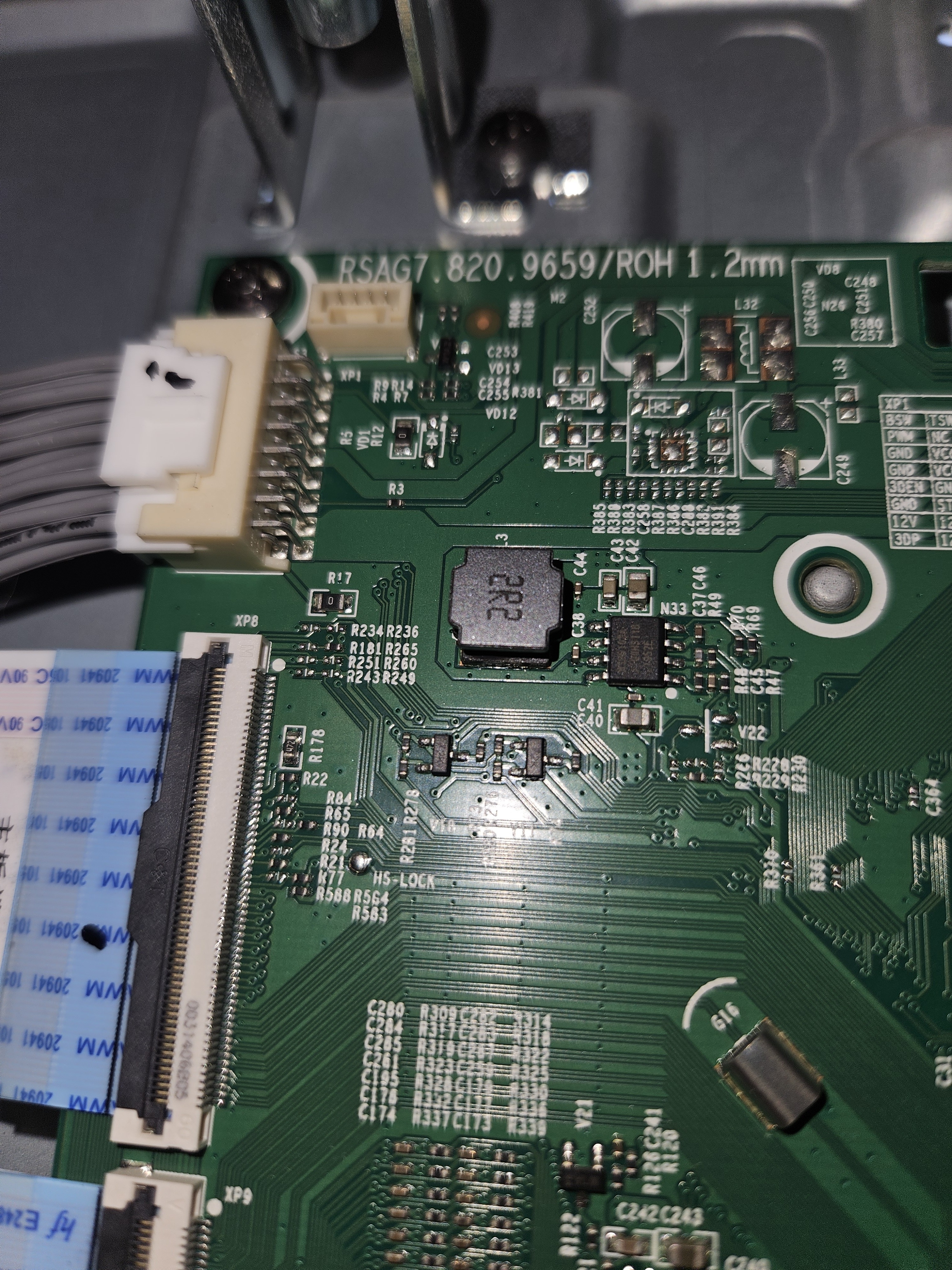

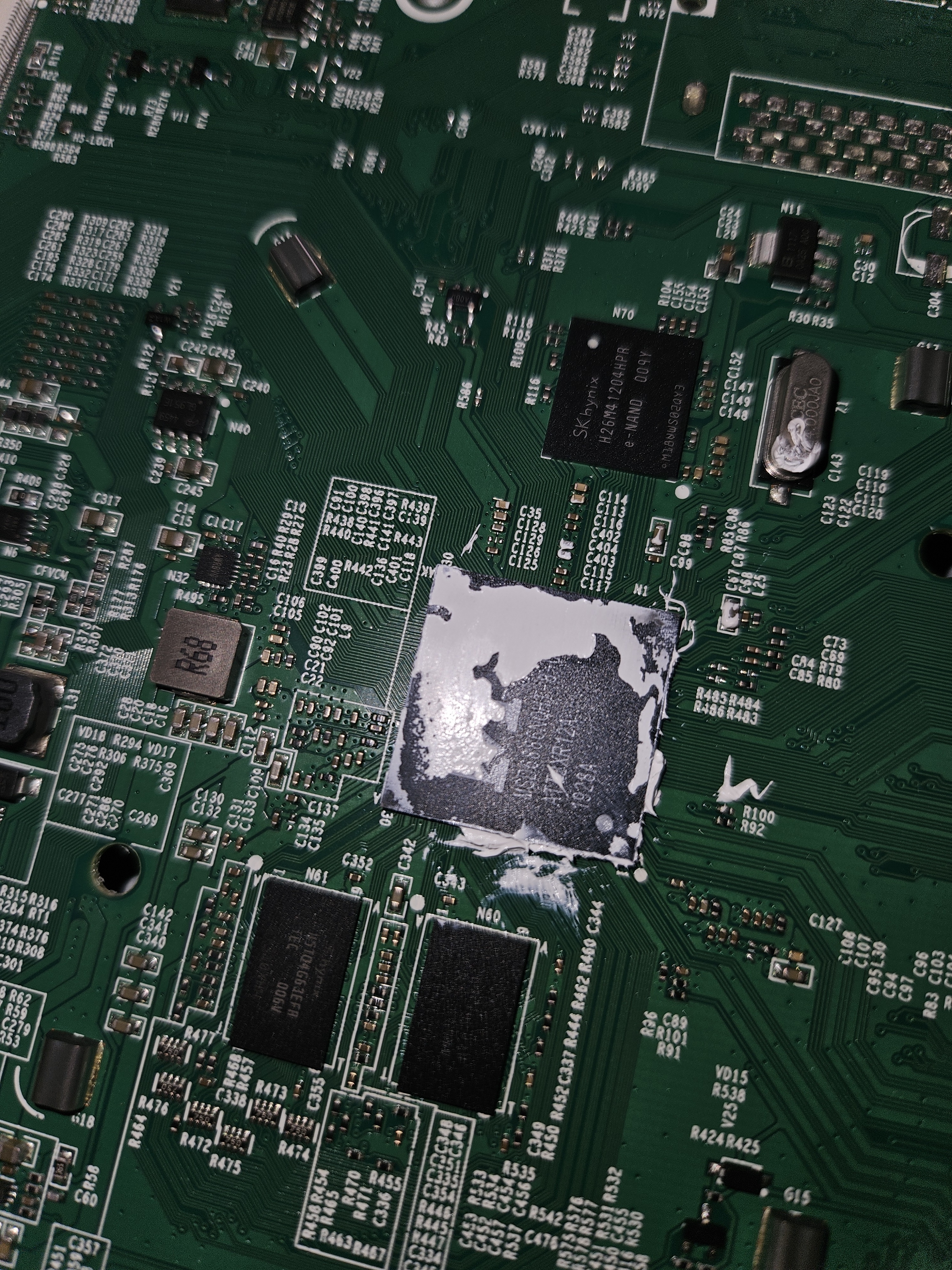

            • Reballing the processor - I don't have equipment to reball the processor but I popped off the heatsink and took a look. The only inductor I could find that was ~1V from ground was L3. (The 8 pin IC next to it is labelled MSH6103A which I think is the 1V regulator?). I tried holding a 470uF 100v electrolytic cap (labeled low esr but it is from aliexpress) parallel to C42/C43/C44 but didn't seem to do anything.
ID:	3490356 Click image for larger version

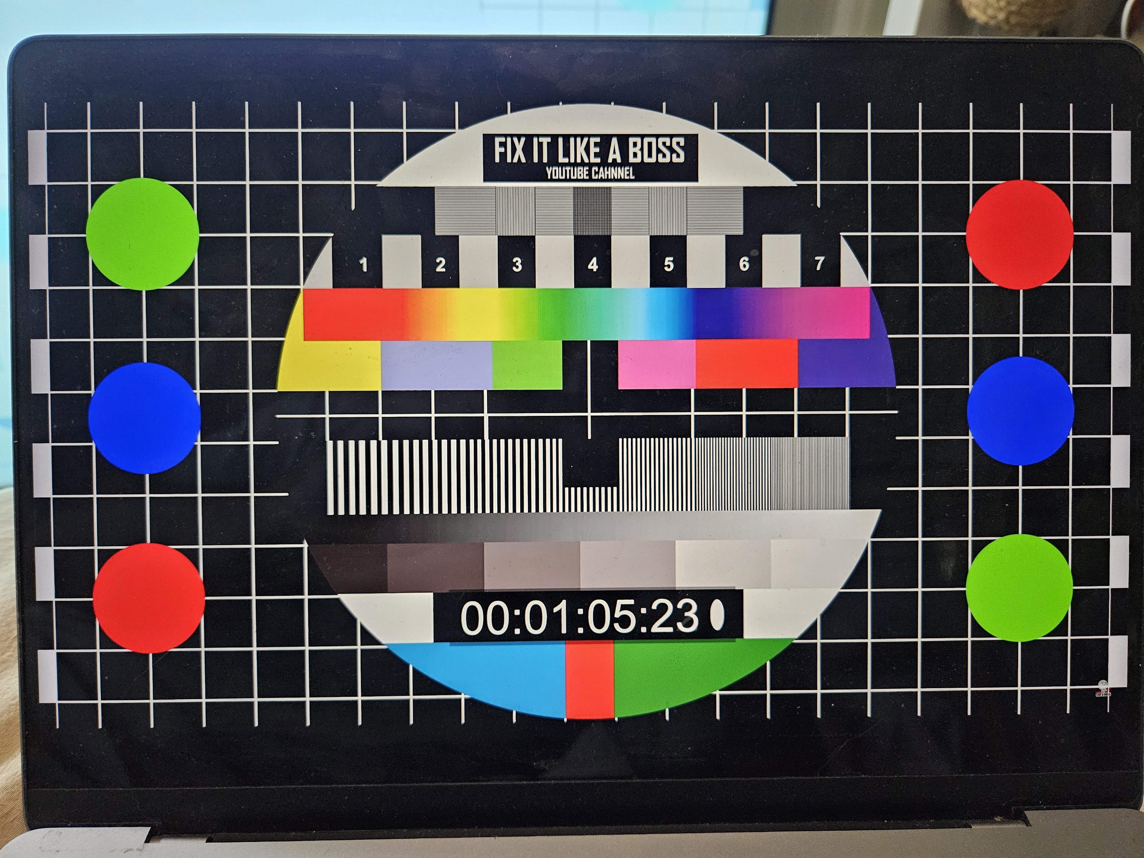

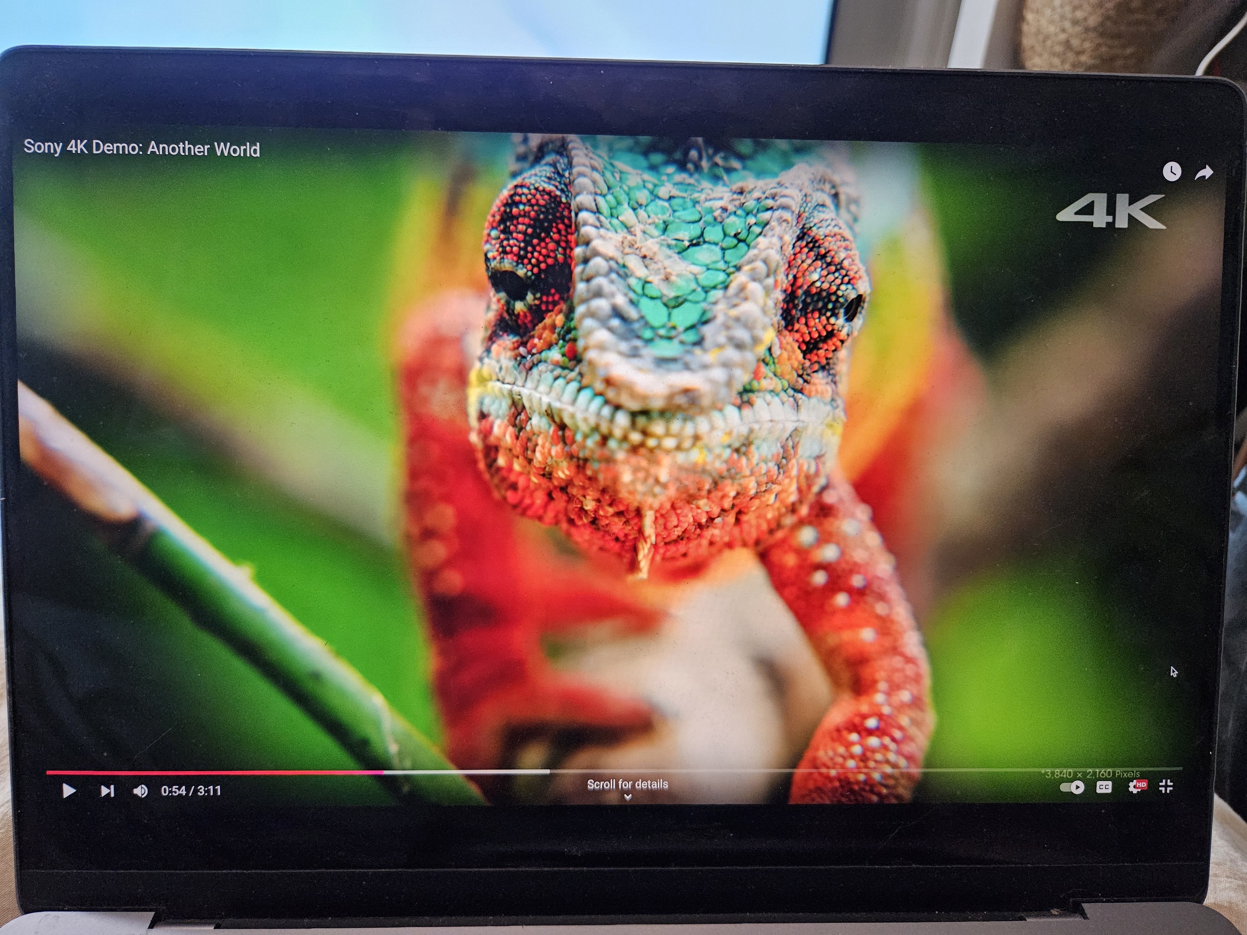

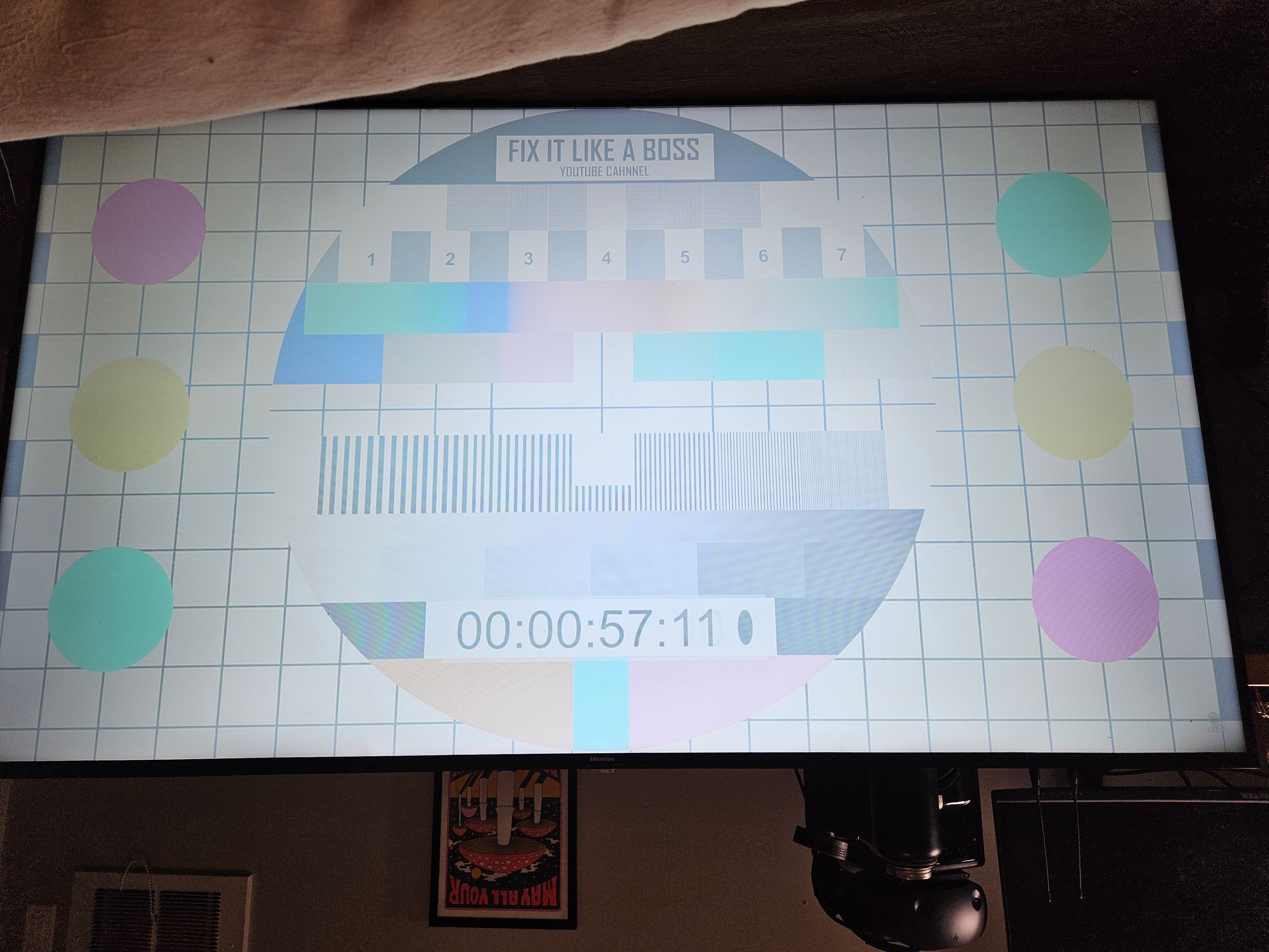

            • Here are some test images -- there aren't any areas of dead or degraded pixels. Red is mapped to cyan, green is mapped to magenta, blue is mapped to yellow and vice versa (ie opposite sides on RGB/CMYK color wheel)
ID:	3490361 Click image for larger version
ID:	3490358 Click image for larger version
ID:	3490360 Click image for larger version

              what do you have under factory mode ---- option ?

                I downloaded for the first time the main board pic , and noticed only now there is an integrated tcon to the main board, but the chip that controls it, it is outside the main processor, i noticed the Chot chip that is a panels brand, so the capacitor where you put the cap it is not the right one, there have to be another around the Chot chip, maybe 1,2v, maybe 2-3v, that powers the chip itself, that is the correct one..

                    The problem seemingly fixed itself for a few weeks (~10 hours of watch time) and has now appeared again. Disconnecting the left most quarter of the screen DOES NOT fix the issue anymore. I can't find any permutation of disconnecting ribbon cables that fixes the problem and even when a section of the panel is disconnect that portion is still washed out white.
                    • I tried "Reset Gamma" and "Clear Unprotectly" in the service menu. There wasn't any change in the problem after doing either of these.
                    • I measured all the inductors around the csot cs602 chip
                    • color inverted color correct
                      L6 1.53 1.54
                      L18 12.03 12.03
                      L21 12.03 12.03
                      L28 7.56 7.59
                      L27 ~0.27mV ~0.27mV
                      L20 3.3 3.33
                      L31 1.87 1.87

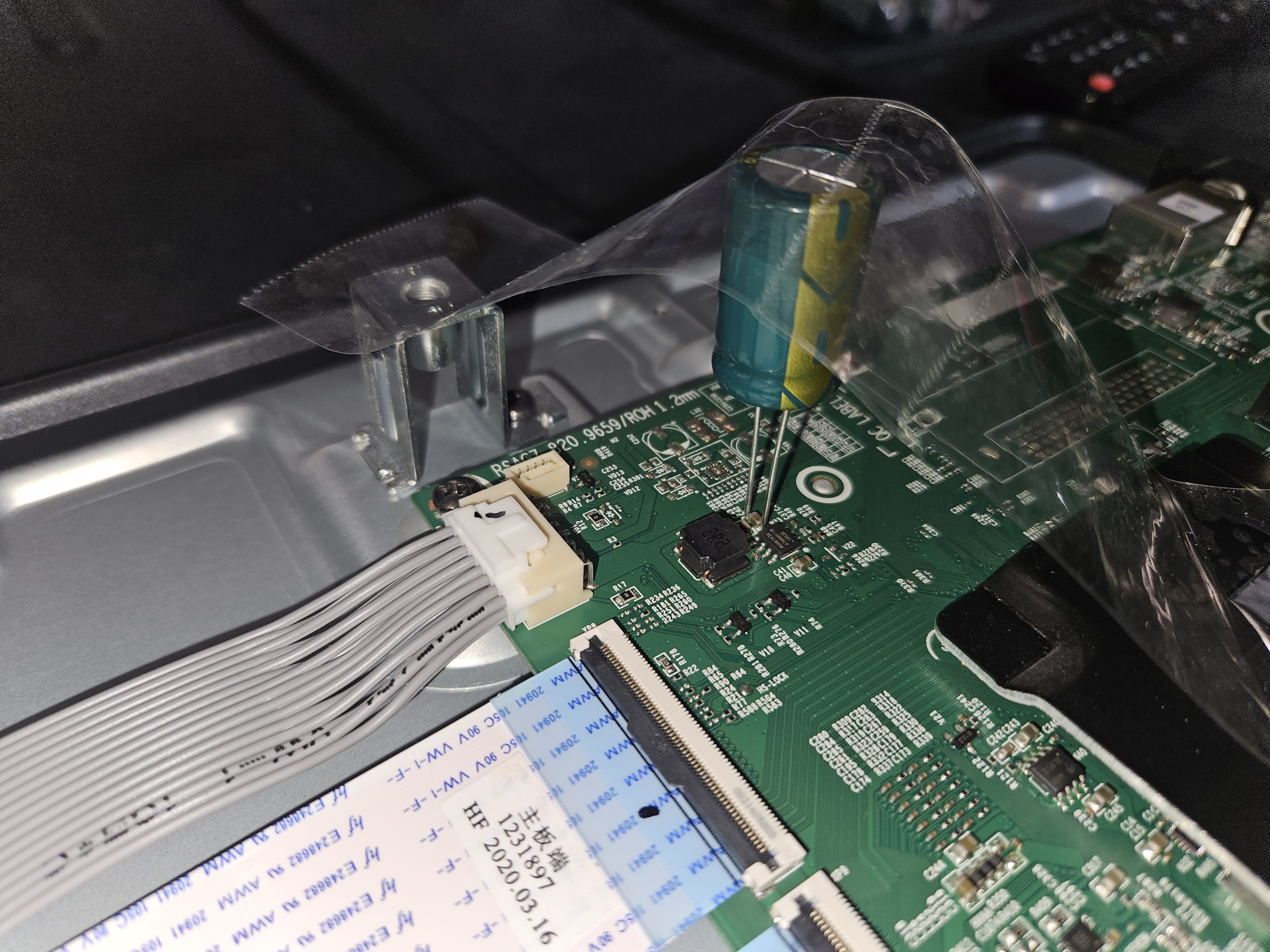

                    • The first inductor I tried was L28 7.5V with a 470uF capacitor across C315 and this fixed the problem for next boot (may just be coincidence?). The colors stayed correct across power cycling at the wall socket even though the capacitor is removed (ie capacitor only applied for the first boot)
                    • I can't trigger the problem reliably so I will have to wait until it appears again to do more experiments.
                    • I'm not sure if the fix with the cap across C315 is just a coincidence. I will keep using the tv until the problem appears again and see if I can reproduce this fix.

                        The problem surfaced again and capacitor trick did not work again on any of the voltages.
                        I don't have any freeze spray or compressed air on hand but I will obtain some. What is the purpose of freezing the chip? Should I expect to see a hotspot where there is a bad solder connection?

                          stop, here the things changes.. a lot.. so now i'm suspecting other components, but which one??
                          You can blow hot air with air dryer first on the two ddr ram, coverinng the cpu and.the emmc before with aluminum foil, then turn on and see what's going on, if nothing then use same method heating cpu or.emmc...
