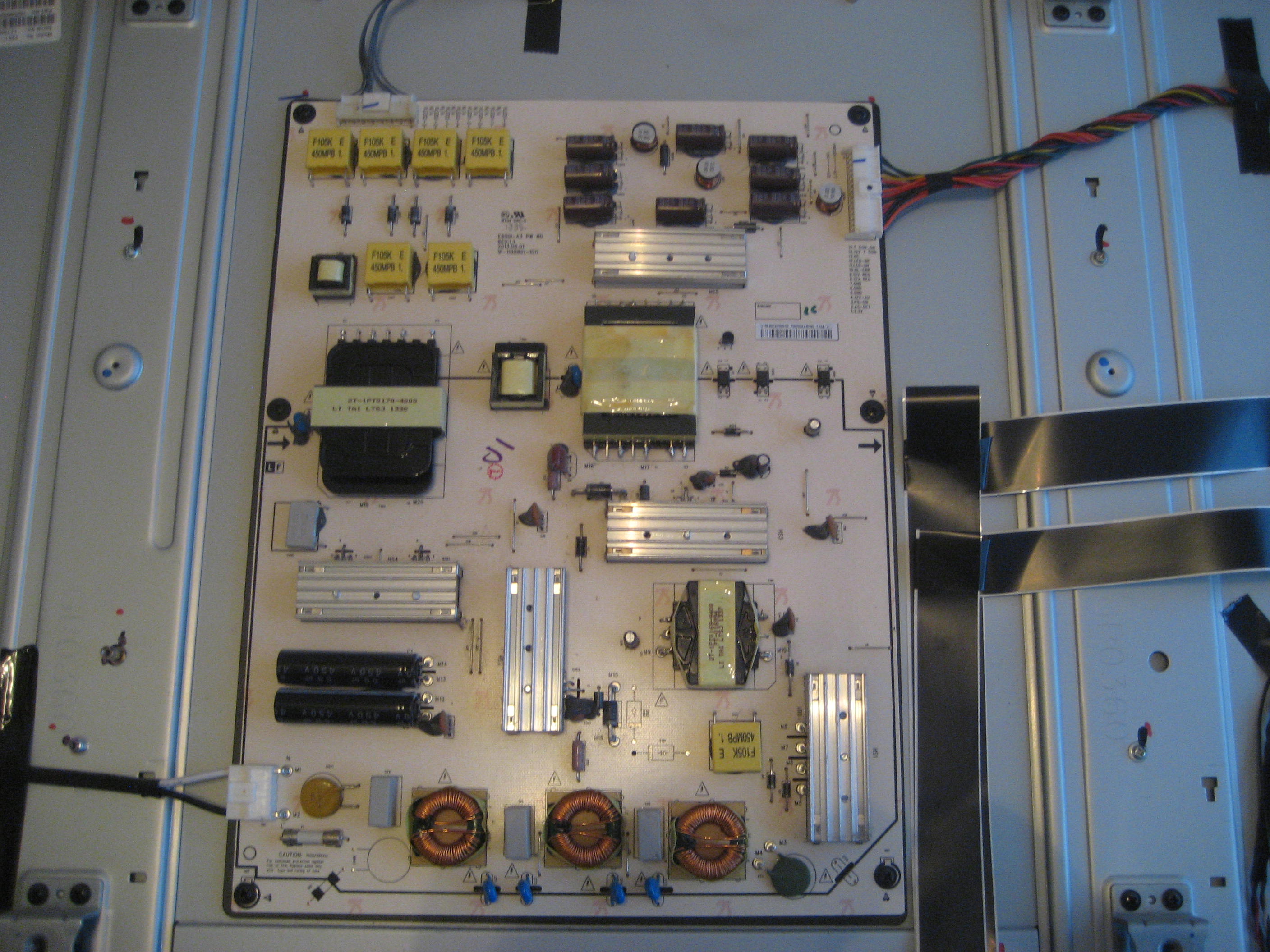

    E701i-A3 issue(s)
    This belongs to a coworker that thought I might be able to do it some good. He bought it new, and a while back they had a lightning strike that took out some of their electronics. Killed his router, his gaming system, and the HDMI ports on this tv. Insurance replaced everything, and they still used the tv, but recently things changed. When powered on the backlights come on for a few seconds, then start going off and on. There's no menu viewable, and the remote doesn't seem to change or alter anything. I'm no tech, but folks here have helped me through repairs on a few other sets in the last few years. Was hoping to get some insight on this one.
    Thoughts?

    Can we see some high resolution, straight shot pictures of all your boards and one of the back side of the TV? What kind of troubleshooting tools do you have available?
    The history of this TV is a bit vague, can you explain that a bit better? Was the TV fixed with a new main board after the lightning strike or did they just keep running the TV without fixing it?
    Question is: Is the main board working and you don't see anything because the Tcon is bad
    or : I there a main board problem and maybe even an LED issue?

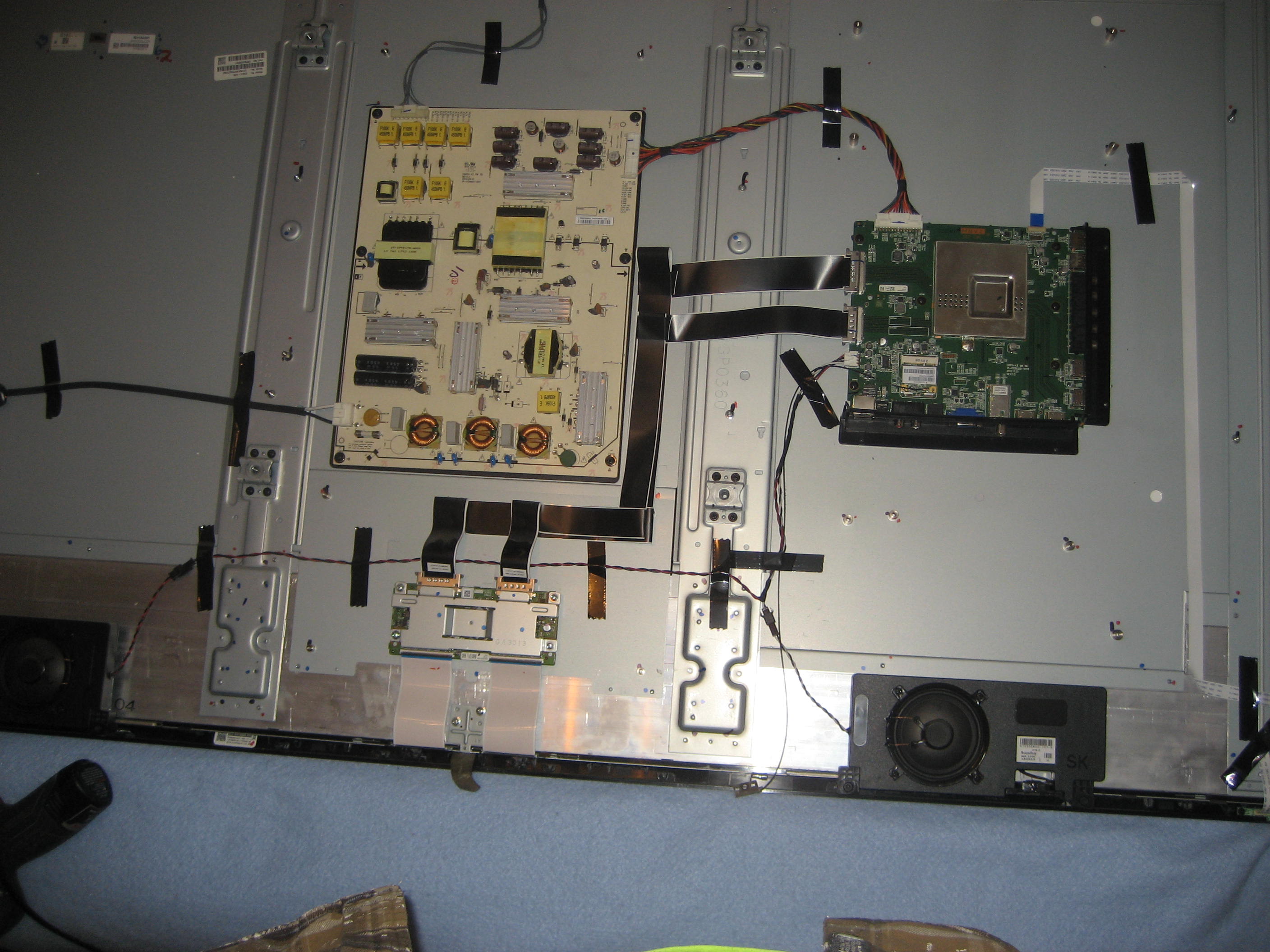

      I just took a few pics, not sure they'll show what you're needing. I've got a few multimeters, that's about it. I've changed caps on a few tv's, and a handful of boards, but that's the extent of my "experience.
      The lightning strike must've hit the coax line for the internet. It fried his modem/router, his gaming system, and the HDMI ports on the tv wouldn't work after that. The gaming system was connected with an HDMI cable. Nothing has been done to it, other than them still occasionally watching tv on it.
      The screen , amidst the flickering backlights, shows dark. Maybe a blue/gray, slightly illuminated screen, but no picture, no menu, no static. The tv turns on as soon as it's plugged in, and neither the remote or the buttons on the tv make any changes, and will not turn the tv off.

        The fact that the hdmi is no longer working is likely inidcation that the main board is in trouble since the inputs travel thru that board.
        There are usually printed labels on the boards that indicate some of the voltages that need to be present for the system to work to some degree. You could ttry verifying that those exist. A lightning strike in / near a house in usually not a good thing for most electronics.
        You are saying they continued to use the set via some other non-hmdi inputs until this latest failure. That was probably just "lucky" if you think lightning strikes are a sign of luck. :-).
        You can try disconnecting the tcon to panel cables, one at a time to see if anything changes.. JUST in case some other failure more related to the panel happened. IF nothing happens, you should probably focus on the main card.
        As another suggestion, check the fuse on the tcon card.

          I've pulled the tcon cables, together, then one at a time. No change. I'm "watching" a main board on Ebay from a broken panel tv. We'll give it a go. Thank you.
          I will check voltages too.

              hmmm.... "no change"... there should have been a "white screen" on the half that had the cable disconnected.

                Nope. Just fired it up again after reading your comment. Backlights continue to flash, that's it. New main board should be here Monday. I'm hoping there isn't some deeper issue.

                    The ones coming out of the tcon, heading to the panel. However, the "new" board got here today. Installed, fired up, got a batch of vertical lines from the left side all the way to the right side, in pattern, and the Vizio "V", off to the right of the screen a bit. Then it all goes off, then back on without the V a few times, then back to a dark screen. I've also realized this is a 60", and not a 70", but the board numbers are the same. I've seen Samsung use the same boards on a few different models, so I'm hoping that's not the issue here.

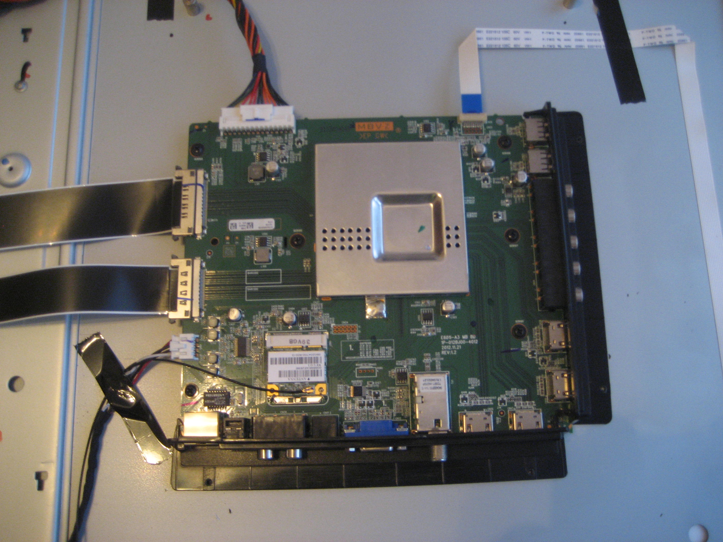

                          Which board P/N did you use? The one on the barcode or the white silkscreen printed on the board?

                              I went off the one in white letters printed on the board. The only bar code is on a sticker on the wifi card.
                              Edit, now I'm seeing another scan-able tag. The numbers are different from mine.

                                Example, notice how it says 242 can be found on a sticker, it's on the sticker right under the MBVZ. https://www.shopjimmy.com/vizio-y838...r-e701i-a3.htm

                                  So it's not just the board number, it's some sort of software ID on the sticker I need to match up?

                                    The board numbers in white silkscreen are generic board numbers, you want to match up the sticker numbers.

                                      I've found the correct board (216). The seller of this first, incorrect board has offered to take it back, providing it's undamaged. Is there a chance that me installing and powering up the tv with this "wrong" board have hurt this board?

                                        Always a chance but I'd say it's small, better chance a bad panel knocks out a good tcon replacement, if the seller has a good reputation, they should treat you fairly, I always check buyer feedback if I'm dealing with ebay.
