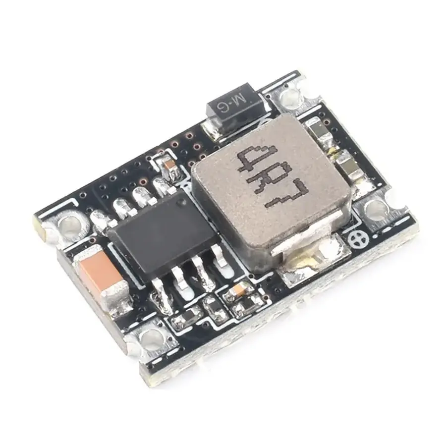

    It's gonna be a long intro, so please buckle in, as it's a problem that's been bugging me for several days now. Thanks in advance.
    So, I have 2 modems/routers, whatever the proper nomenclature is, one from ISP and one mine. I want to power them via USB-C rather then their original mains adapters (for reasons, that are hard to explain to sane people). Both routers come with 12V/3A mains adapters.
    For this purpose I acquired USB-C charger with 250W and 5 ports, 2 of which can supply max 20V/3A. Since 12V isn't a standard PD voltage option (and to future proof, as the charger cannot supply 5V, 12V and 20V in case I add more devices to it), I decided to create my own charger (x2) consisting of 20V PD trigger + 12V buck converter, so at the output I have 12V that both routers need. Charger provides 3A, buck converter has only 2A, but I've monitored the consumption of both routers and I haven't seen usage of more than 1A (per device), so power-wise everything should be OK. Each router receives 12V/2A and only uses around 0.6A, max 0.8A.
    So what's the issue? My router works perfectly, the ISP one is giving me a headache. In any combination of USB-C port, cable, and charger, my router always powers up and runs normally. ISP typically goes into "bootloop", where it restarts constantly (half a minute after starting the first LED goes to green, then they all turn red and router restarts, constantly). Every once in a while, it will start up normally and work for a couple off days, when we have this weird dance all over again. When I connect it back to mains adapter, it will boot properly the very first time. Plug is normal, 2-pin barrel jack of 6.3mm diameter, on both routers.
    So, does anyone have any idea why the ISP router hates my guts??? What am I doing wrong here?

      I don't know what's in the USB-C charger, but the rest are cheap AliExpress components on the attached pictures. Should I buy different buck converter, something with a few more capacitors?
      This is data from AliExpress for buck converter:
      Input Voltage: 5v~30v (Must Be Higher Than The Output Voltage) Preferably Below 28v.
      Output Voltage: 12v.
      Output Current: 3a (Max) Normal 1.8a Over Plus Heat Sinking
      Conversion Efficiency: 96% (Maximum)
      Output Ripple: 30mv
      Output Accuracy: ±0.1v
      No-Load Current: 1ma
      Operating Temperature: -40℃~+85℃
      Operating Humidity: 20%~90
      Annoying part is that it *sometimes* works, but usually not.

                put some caps on the buck convertor output.
                preferably polymer or low-impedence electrolytics.
                maybe 470uf polymer or 1000uf electrolytic

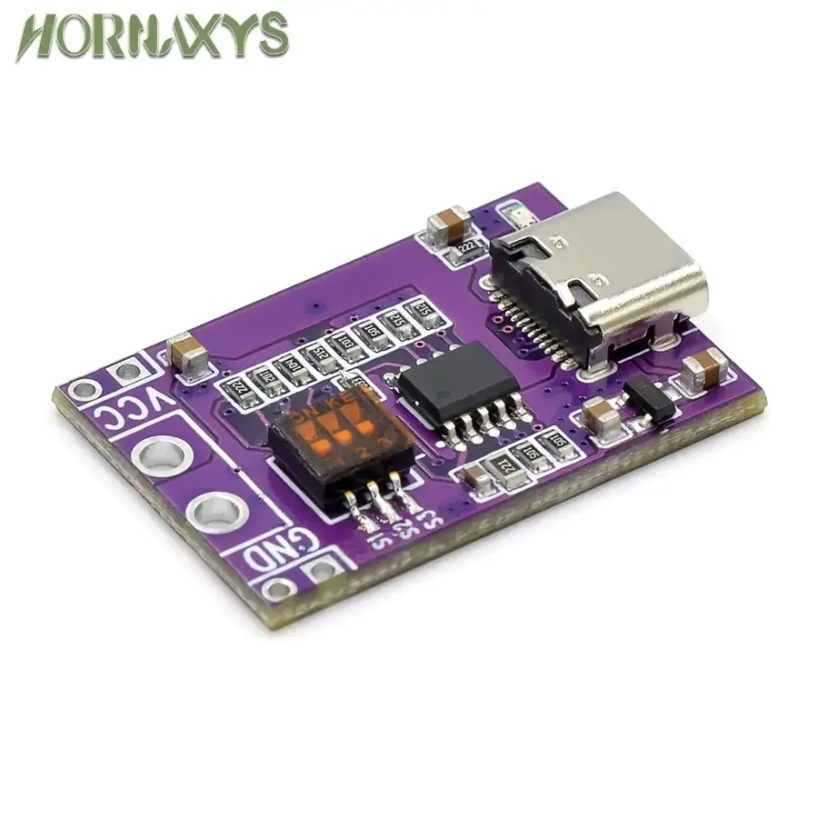

                        Look if you can fiddle with the PD charger to output 15V not 20v. Then you don’t need buck converters.
                        • double_DD
                          • Mar 2024
                          • 50
                          • Croatia
                          You don't think that both routers will mind 15V instead of 12V? Interesting...I might try that.
                          (I can get 12V on USB-C charger no problem, but the problem comes if I want to add more devices to charger, as it can't output 5V, 12V and 20V at the same time. I have a feeling it'll be exactly the same case with 15V.)

                              That was the reason why I went with this convoluted setup with using 20V PD.
                              Originally posted by sam_sam_sam
                              but you could use this device for more than one device but on the same usb power supply
                              https://www.ebay.com/itm/154199751911?var=454319125178
                              I do generally also use this, but both routers use "non-standard" 6.3mm barrel jack which I hadn't found in this ready-made type. Thanks anyway!

                                    So I did just that, I've put electrolytic 680uF/16V (all I currently have at home) on the buck output, and the router fired up on the first try! I'll of course monitor it over the next days/weeks, but this seems to be the solution (not surprisingly).
                                    Thanks again to everyone who contributed!
