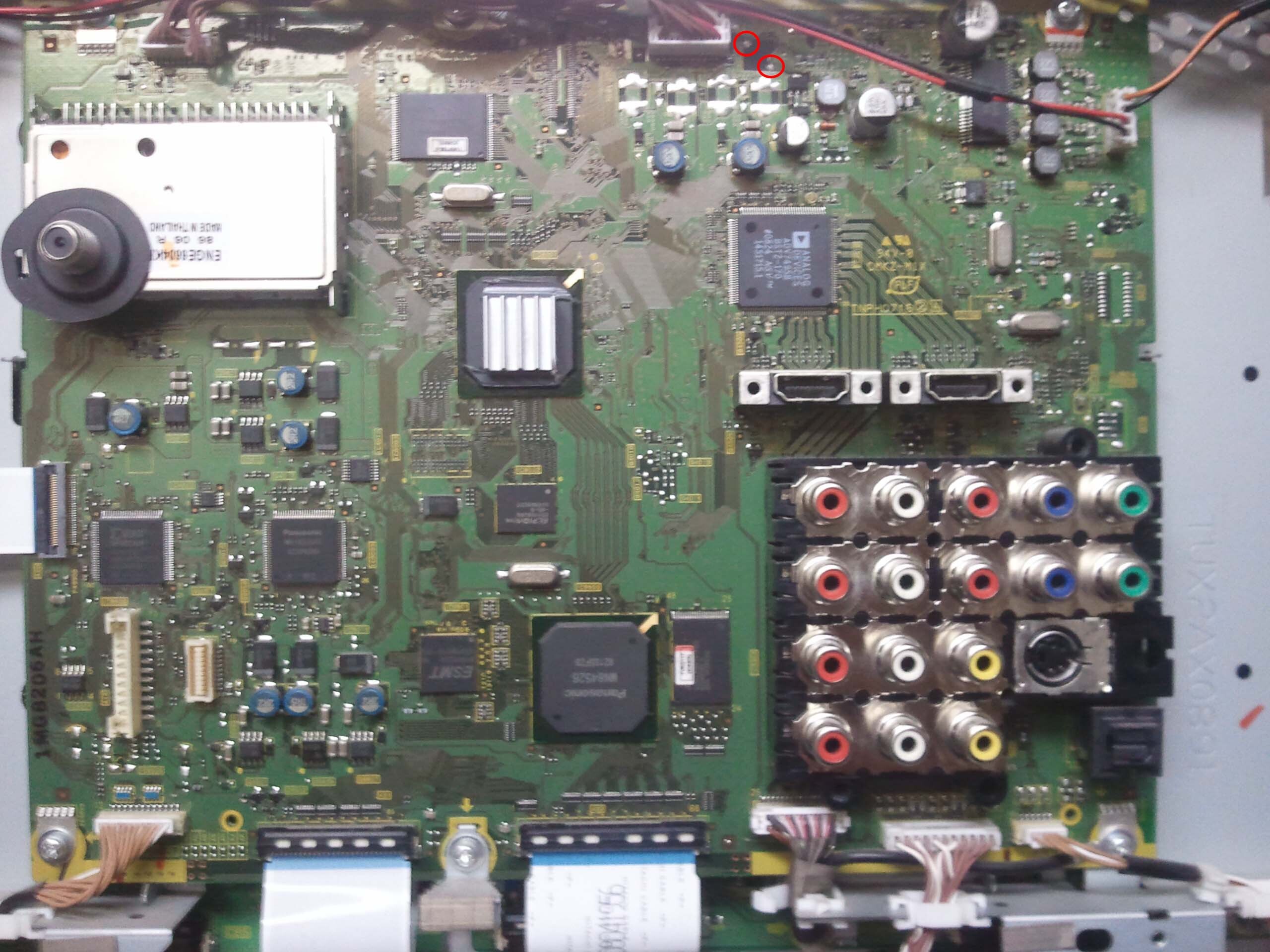

            And you touch its case (Analog Devices ADV7495B BSTZ-170), if it heats up a lot, becomes hot, then the problem is in it.

                This is a chip on the motherboard (HDMI hub).

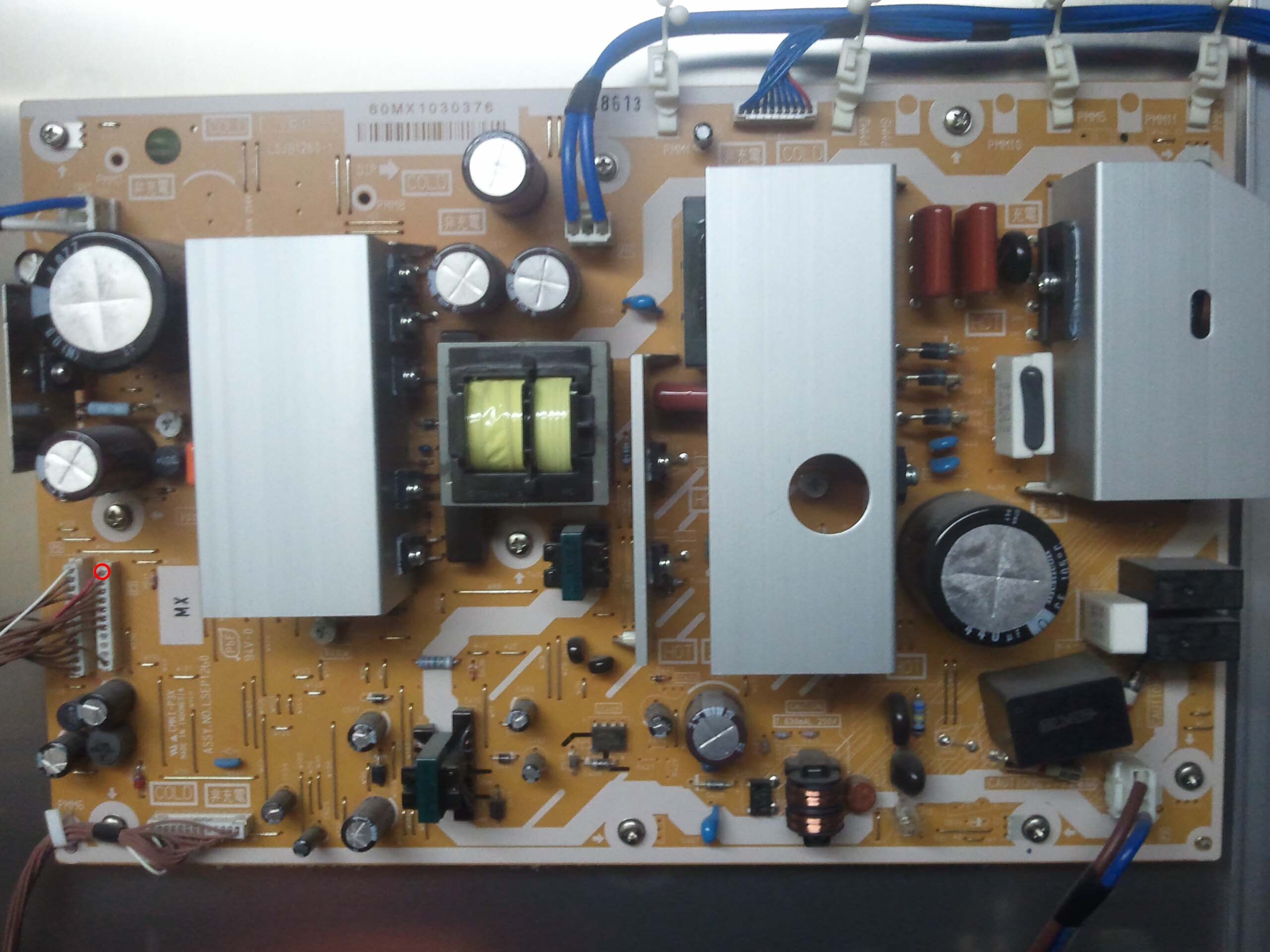

                          OK, so I found .... something
                          Turns out the 5v STB test points are on the main board, not the Power Board. There are two points by where it is marked. I tested each, and they are reading 3.5v, not 5v. See the picture of the main board with two red circles, that's where I tested.
                          I followed the wiring where I believe the Power Board is supplying voltage to the Main board, and tested the red wire on that connector. It as well is testing 3.5v. See picture of Power board to see where I tested
                          Any ideas what could cause that 5v rail to drop to 3.5v?

                                  This is the original power supply. I replaced the main board. The replacement power supply is in the mail but not here yet.
                                  I am hypothesizing that a power surge sent to much voltage thorough the power board and fried the original main board (which is why I got no functioning error messages) then the power board failed and now is not giving correct voltages to the replacement main board.
