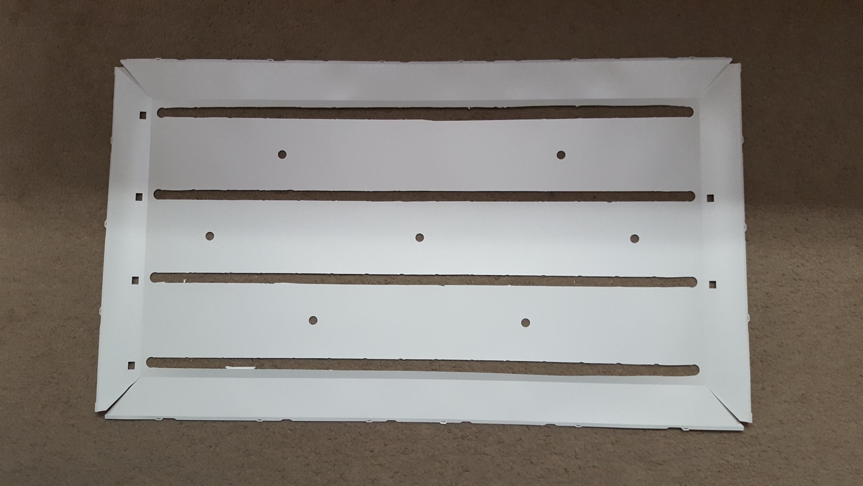

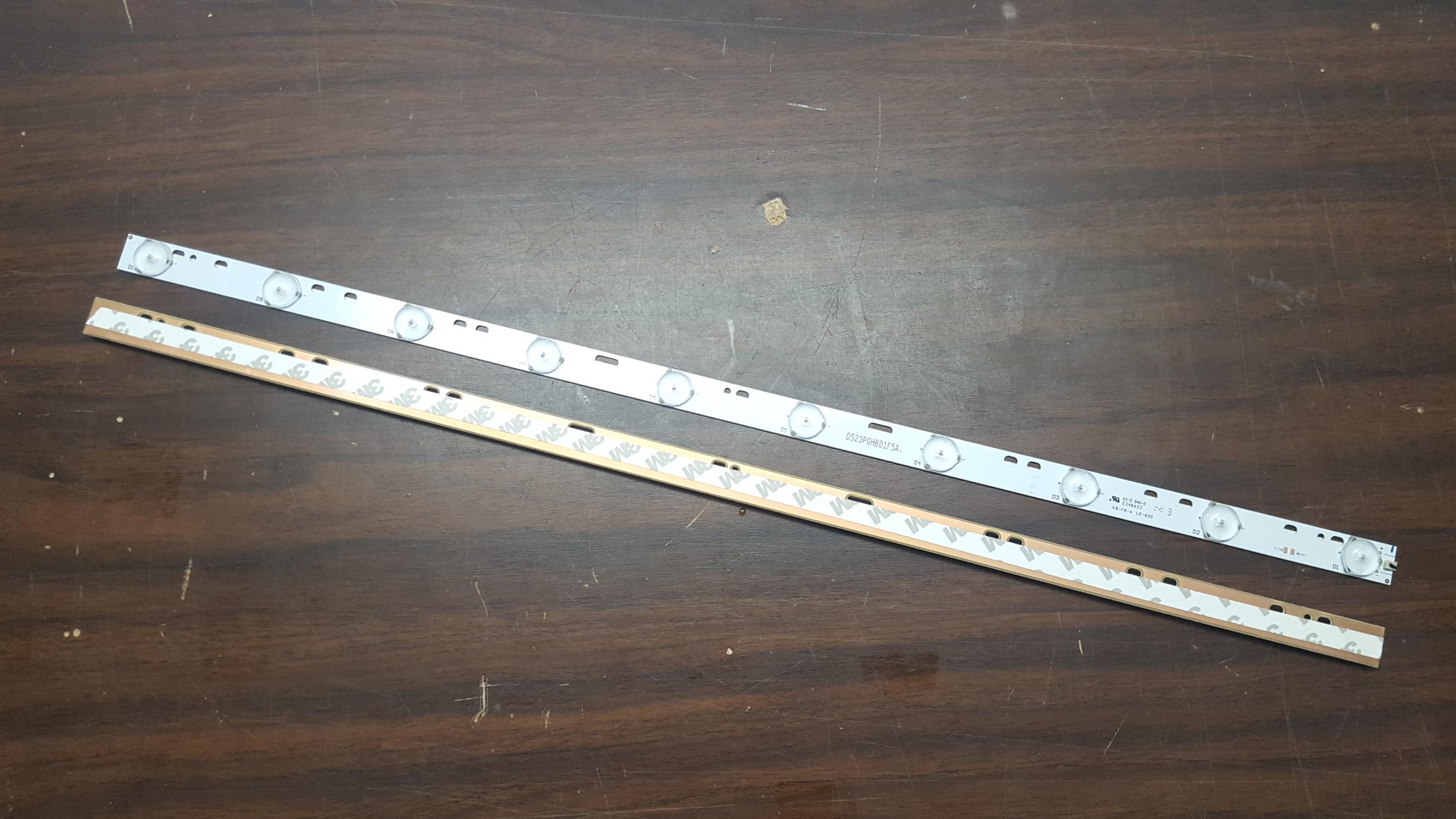

    I have Sharp LC-50UB30U on my table. The backlights (IC-A-VZAA50D552) are shot, over half LED chips are out. No one seems to have them in stock, past sales history looks almost empty and the prices are astronomical if you want to put them together one strip at a time.
    This TV runs 2 LED channels with 32x 3V LED in series so 96V per channel. Are there any alternatives I can use to get this TV operational with some other LED strips or some other method I am not aware of?
    My first thought was to use 12V LED strips from eBay (see attached) and put 8 on each channel in series for 96V total. Anyone ever tried that? I have used them before on non TV related projects, they are pretty bright.

            I have used the universal 32" LED strips from China on TVs before without event, so far. Even on 50" TVs.They have available strips with 6, 8 and 10 LEDs per strip. You may have to cut new holes in the Reflector paper to accommodate the lens. Stagger the strips i.e. the t1st row goes fully right then the next row fully left. You would also have to do some math to work out the No. of LEDs and the voltage per row. The diffuser sheet will spread the light evenly and fill the blank areas. It will; take some thought but it can be done.

              I will try that route with hesitation. I have ordered a 10 pack of these strips and I hope they are color correct. Last time I ordered "compatible" replacement strips for another TV (40" Samsung with those angled backlights) they were purple like you would not believe.

                  Re: Macgyver-ing LED backlights for Sharp LC-50UB30U

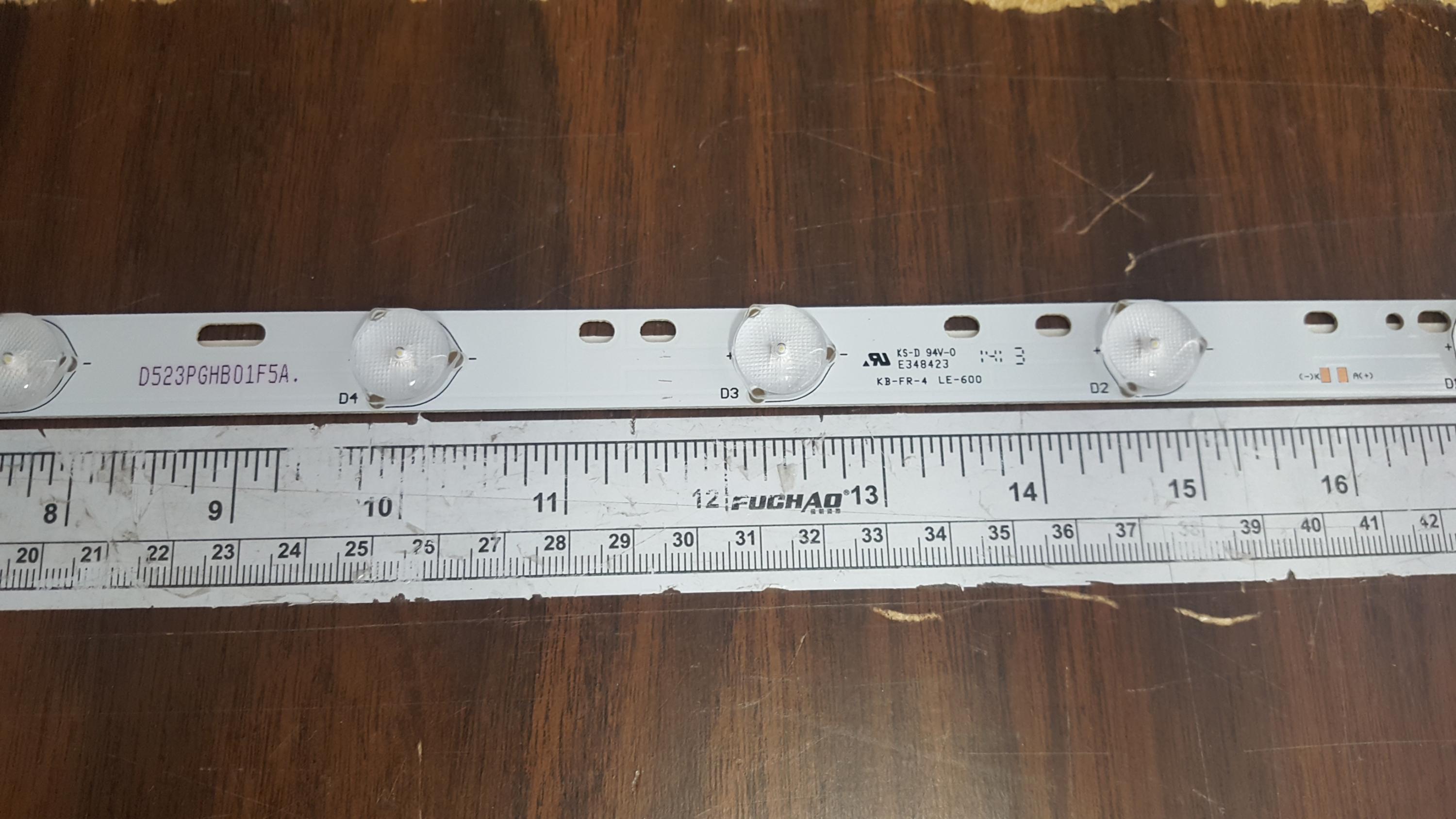

                  I actually got the 10 (I know wait) Each strip is 3" longer that the stock, so 6" overlap per row. I bought 10 per strip, and then I will cut the last two off, making the strip 8 and also shorter, so no overlap. Then its easier to "adjust" the reflector sheet as it is all in one row.
                  Maybe I will keep one strip per row with 9 LED, lowering the average voltage the LED chips and they may last longer.

                      Original is: 8 per strip, 2 strips per row, 4 rows total.
                      Based on the description the strips can be cut to shorter length. That's why I got 10 per strip to make then into 8 and shorter as well. I am worried that if I overlap, the center of the screen will be brighter than the rest. I could tape them over, but I like my solution better

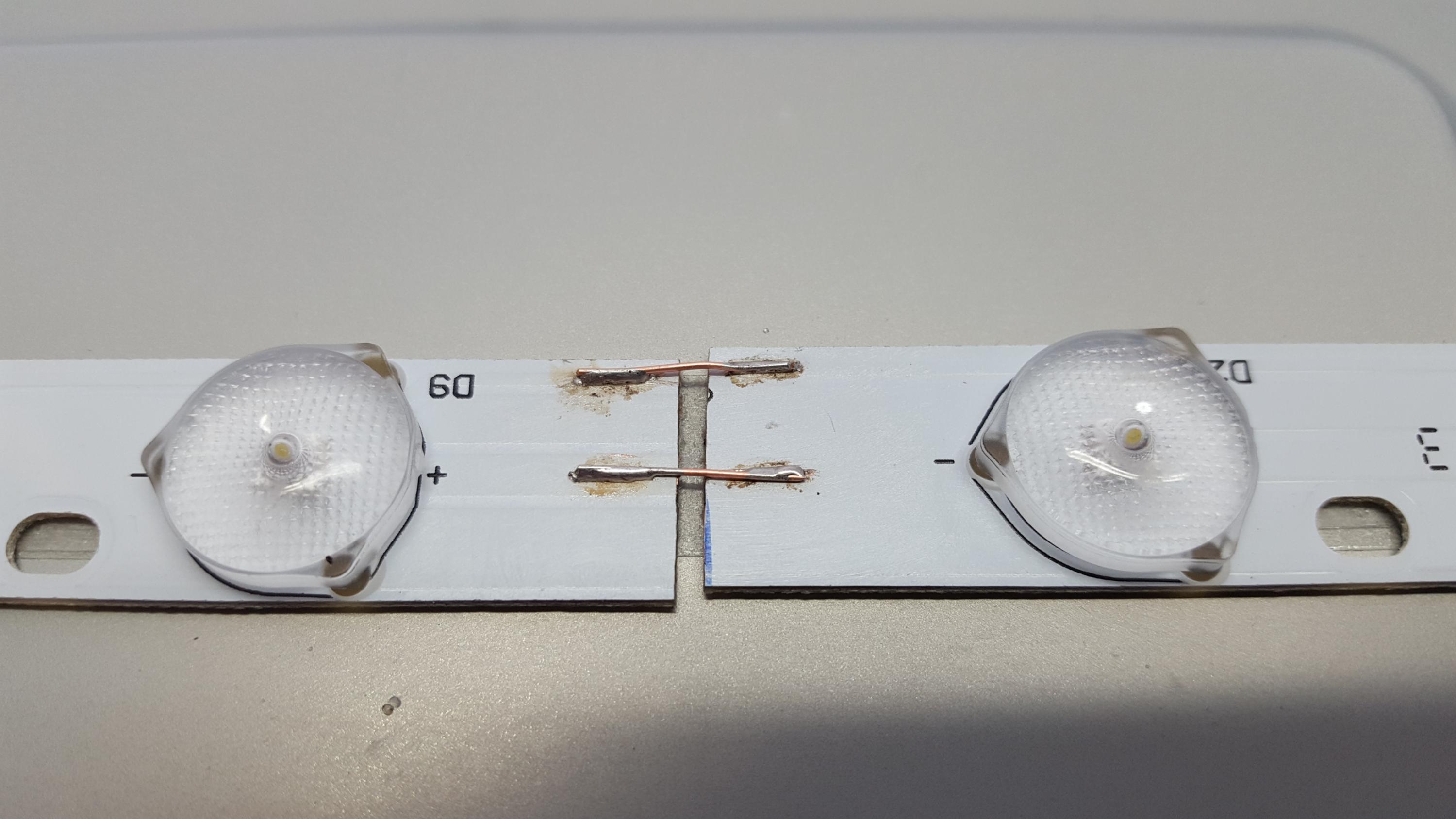

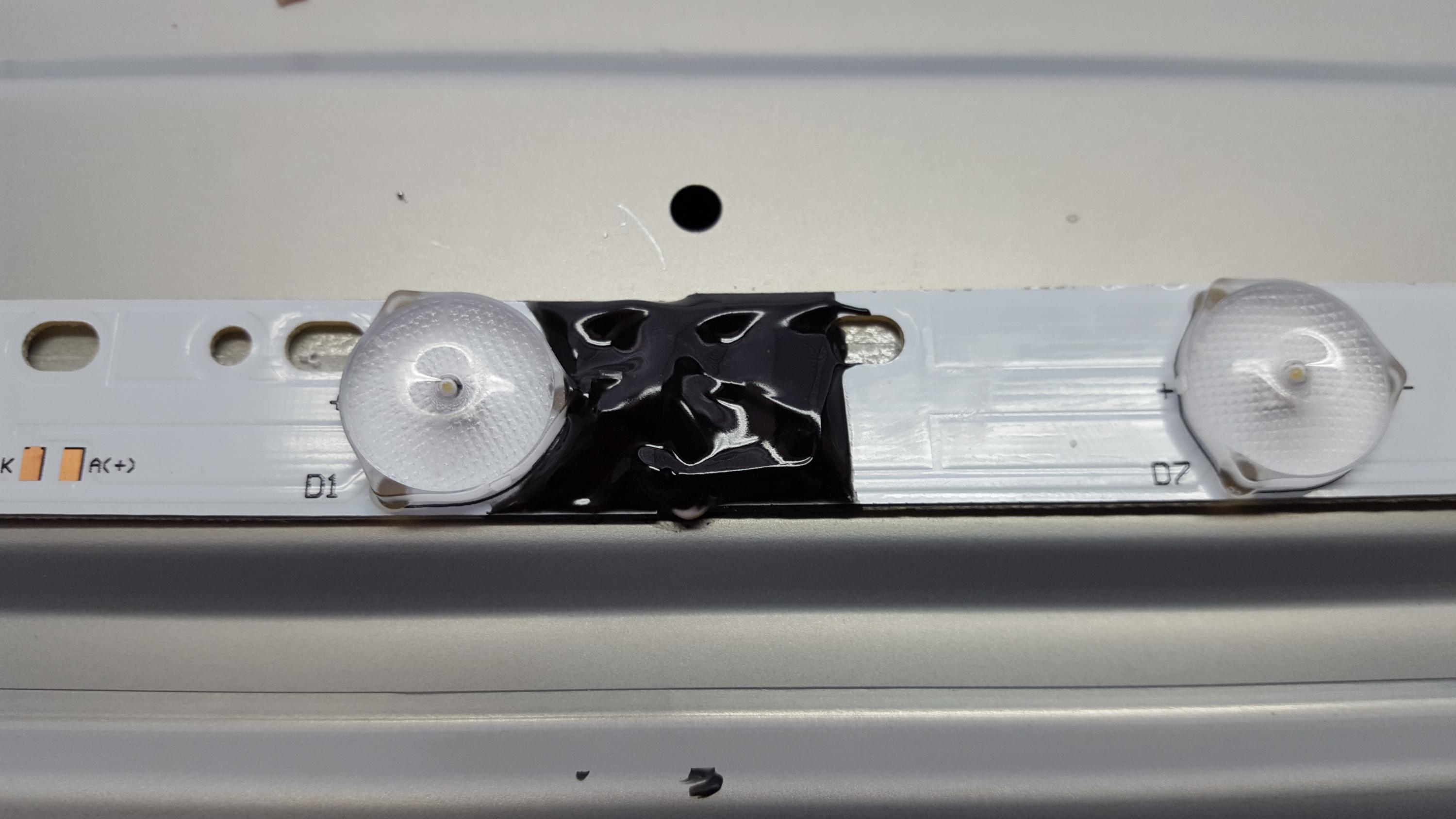

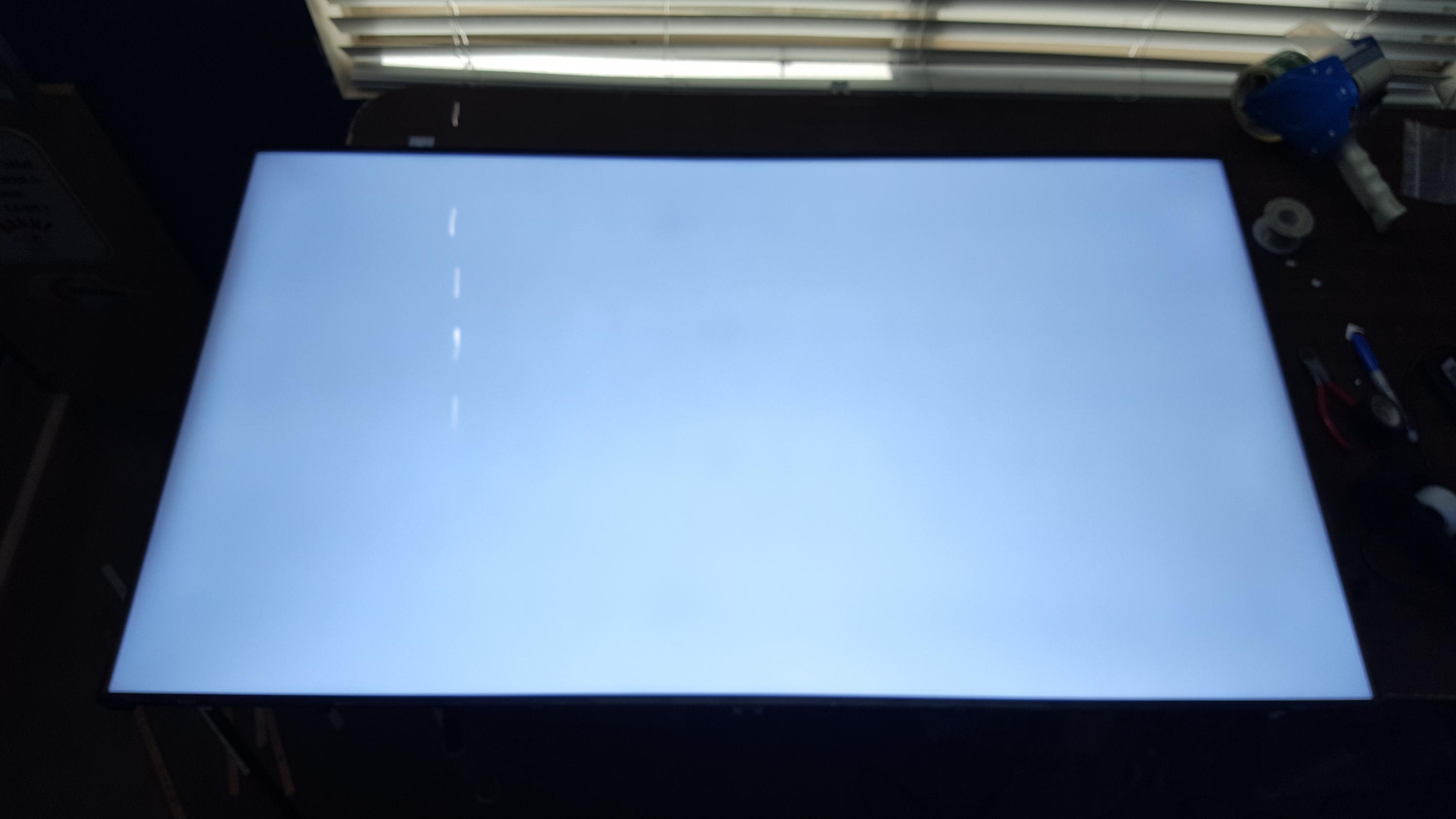

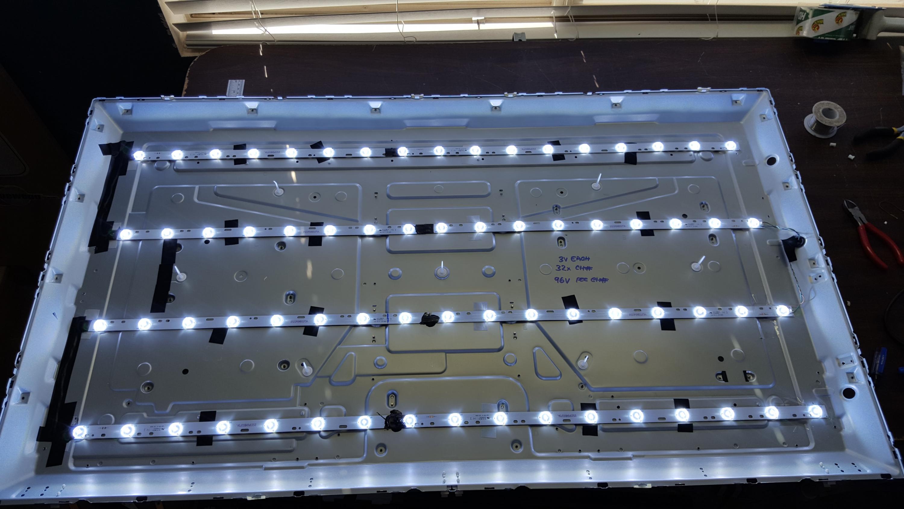

                                Update Time:

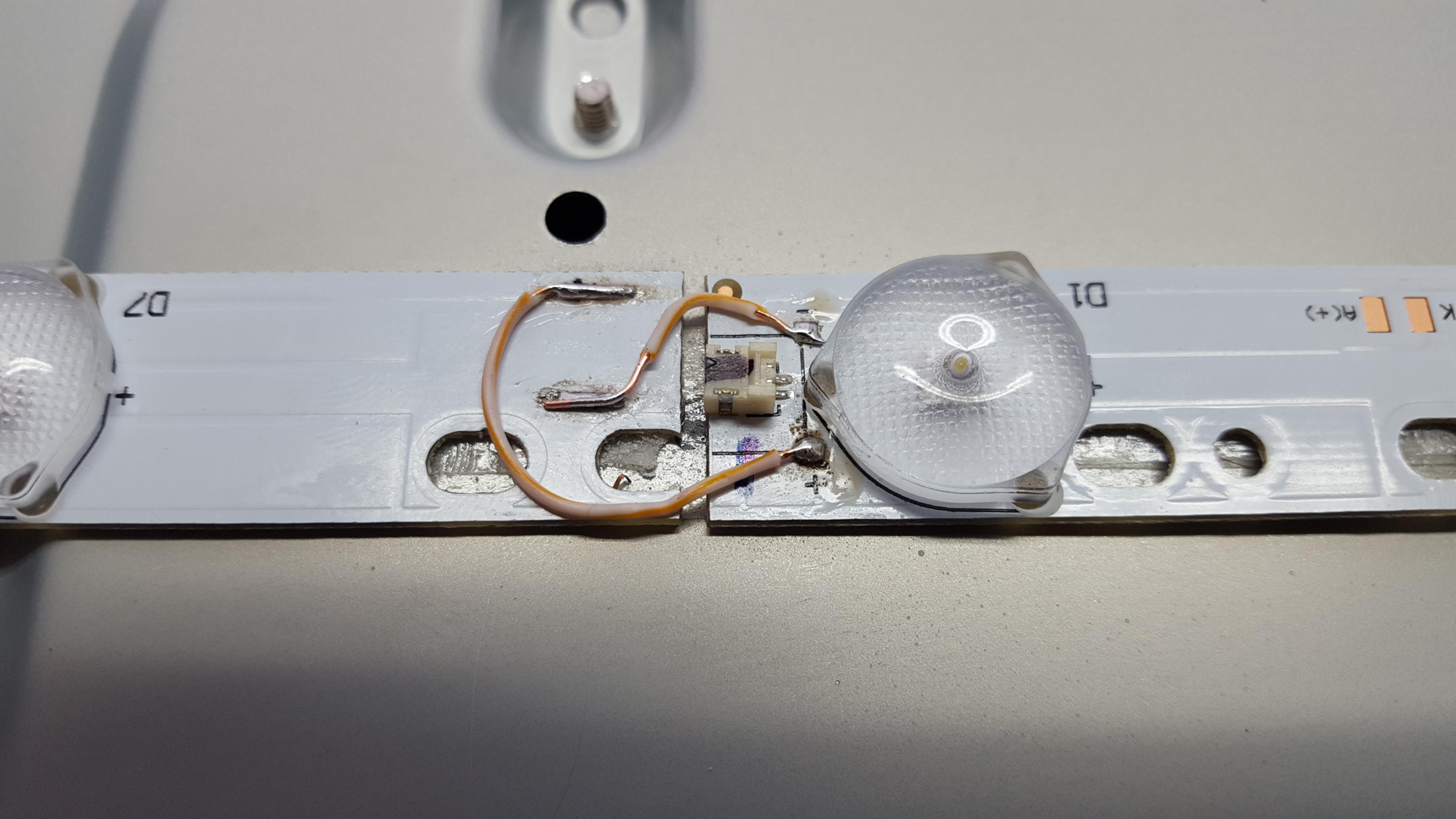

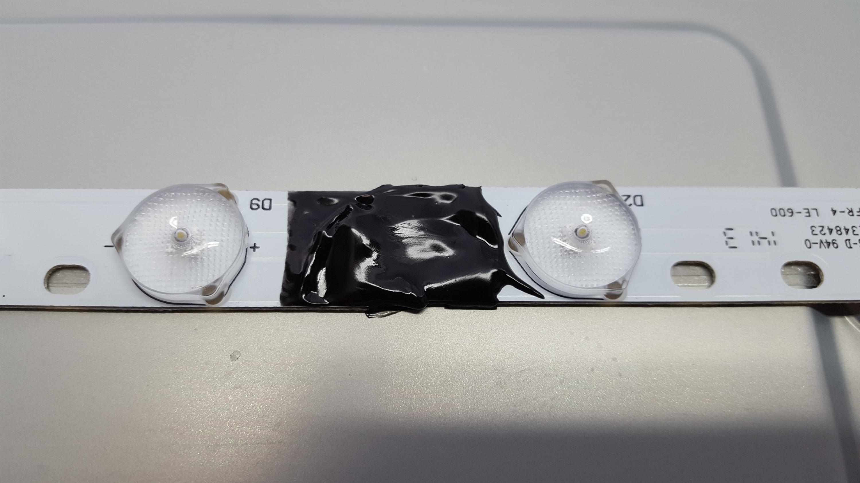

                                I got the Chinese universal strips in main yesterday, they were shipped in PVC tube and arrived A-OK. Their design reminds me of the ones you see in Insignia and Hisense TVs. The color temperature is pretty spot on, and they are very bright. So much so that I currently have TV on lowers backlight setting and its about right. They came with adhesive tape on the back, but i still used mine as I trust it more.
                                Simple design and layout, you can cut them anywhere and jump the connections between the units, followed by generous coating of liquid electric tape to make it stick. Of course the reflector did not fit, so it had to be "modified." Once put together the light is even, you can't really see there are aftermarket backlights in the TV.
                                When they were on full brightness, while the panel was still off, they were getting pretty warm to the touch. I hope they will not burn out withing a year. Only 5 screw were left after the project I still have to get a remote.
