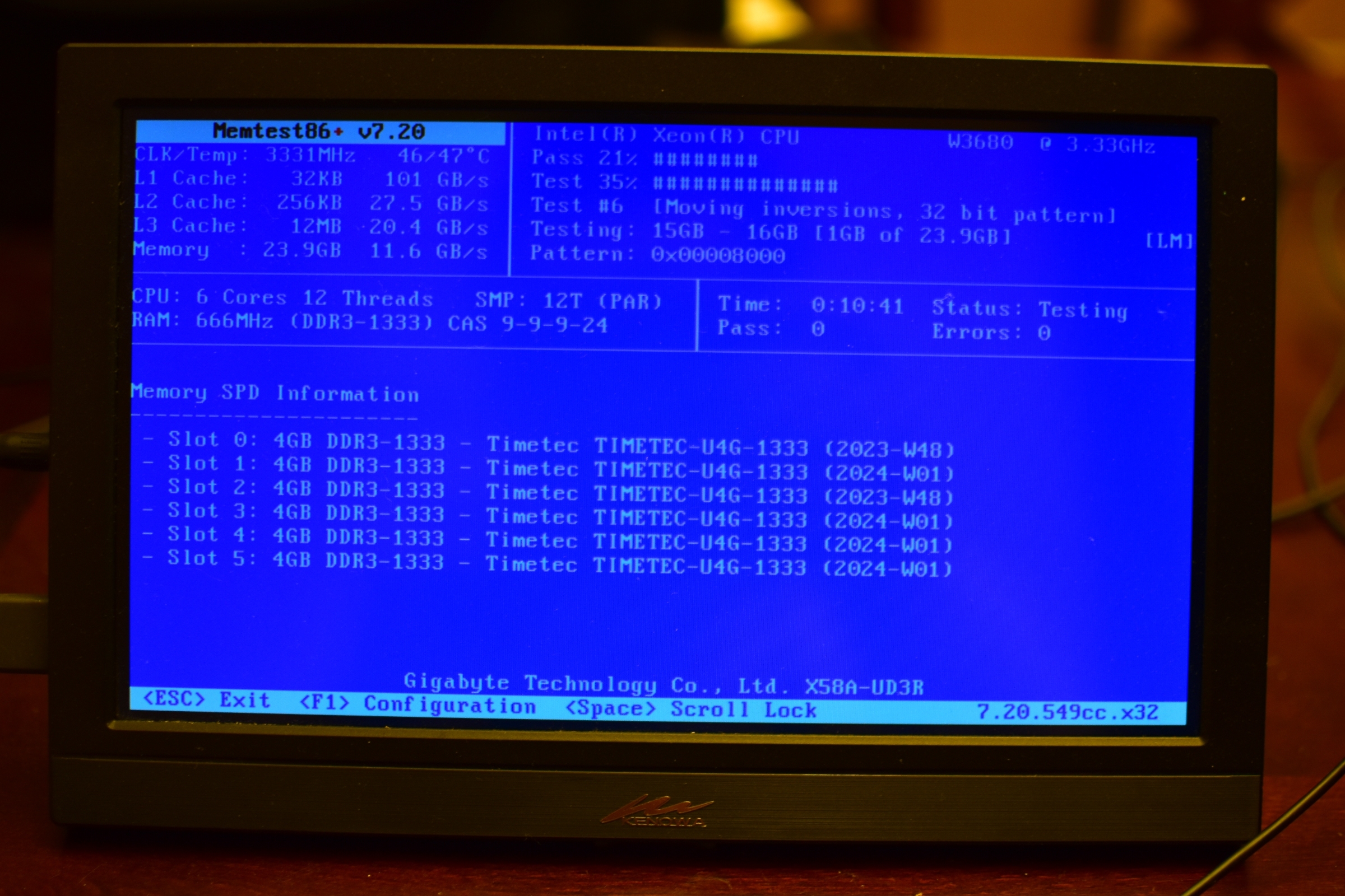

    I just dug out my x58 system and got similar results 11.6 GB/s with 6 matched 4GB sticks of Timetec (with Hynix chips) DDR3-1333.
    Specs as follows:
    Motherboard: Gigabyte GA-X58A-UD3R
    CPU: Intel Xeon W3680
    RAM: 24GB (6x4GB) Timetec DDR3-1333.
    GPU: Nvidia (EVGA) Geforce GTX1060
    SSD: Samsung 870 Evo 250 GB

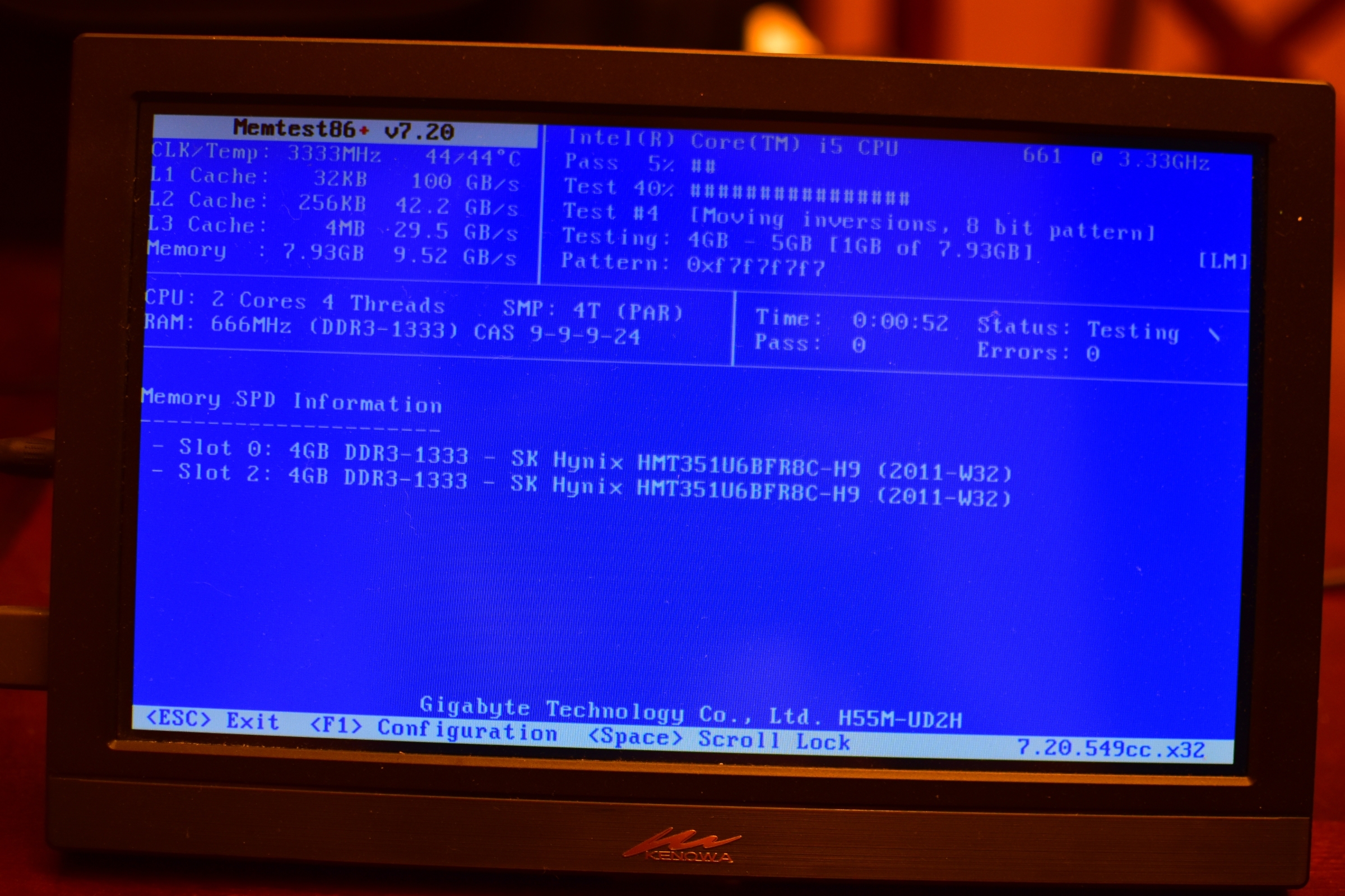

    I also have a P55 system (so same era, but dual-channel) and it does even lower at 9.52 GB/s with 2 4GB sticks of Hynix DDR3-1333.

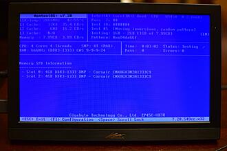

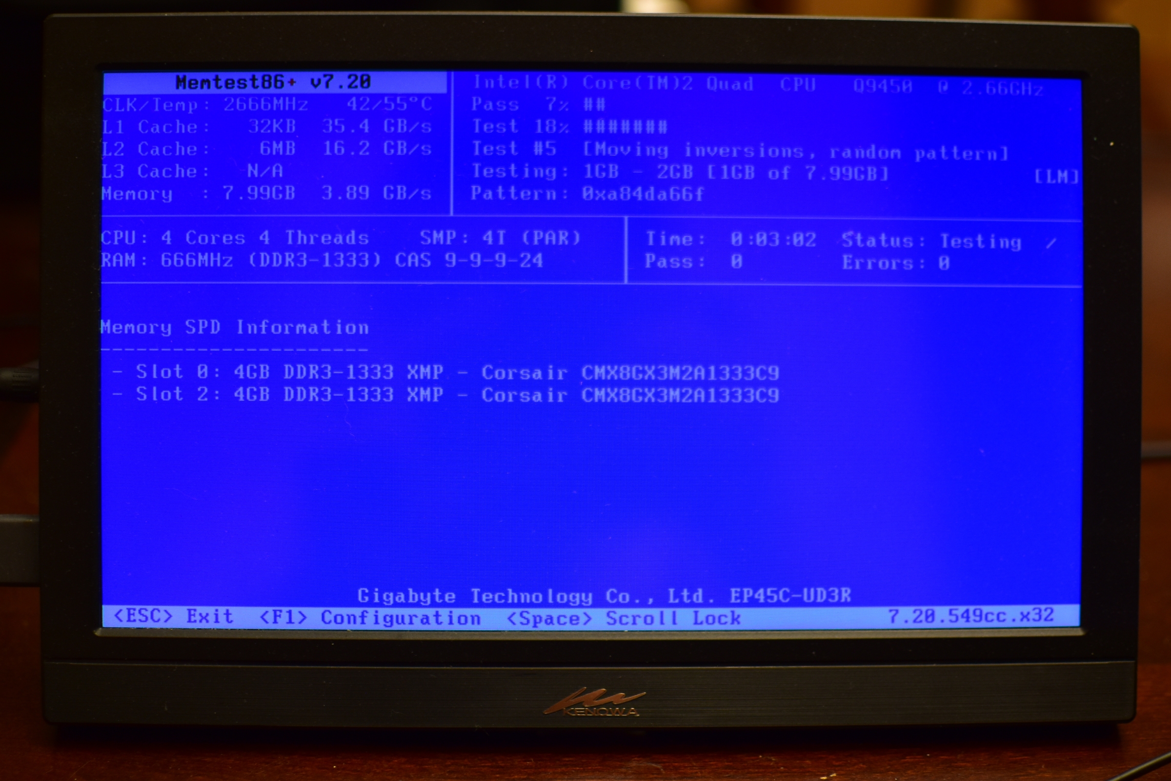

    As well as a P45 board (so a generation older) that uses DDR3 and it only gets 3.89 GB/s with 2 4GB sticks of Corsair DDR3-1333
    Specs as follows:
    Motherboard: Gigabyte EP45C-UD3R
    CPU: Intel Core2Quad Q9450
    RAM: 8GB (2X4GB) Corsair DDR3-1333
    GPU: AMD (Sapphire) Radeon R9-380
    SSD: Samsung PM871 256GB

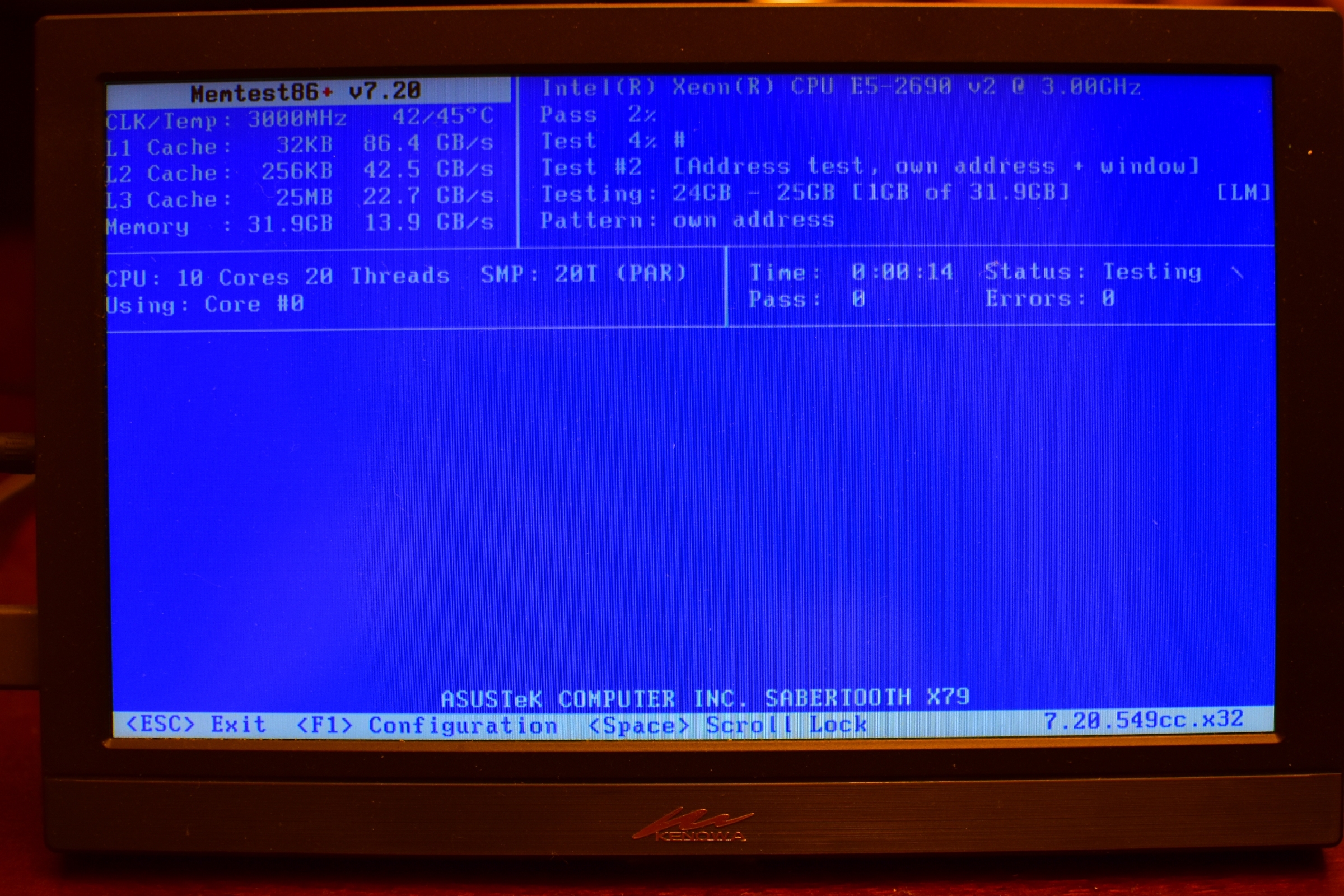

    For some newer DDR3 systems here's a quad channel X79 system getting 13.9 GB/s with 4 8GB sticks of Corsair DDR3-1600
    Specs as follows:
    Motherboard: Asus X79 Sabertooth
    CPU: Intel Xeon E5-2690 V2
    RAM: 32 GB (4X8GB)Corsair DDR3-1600
    GPU: AMD (Gigabyte) Radeon RX470
    SSD: Imation X-Pro 256 GB

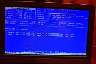

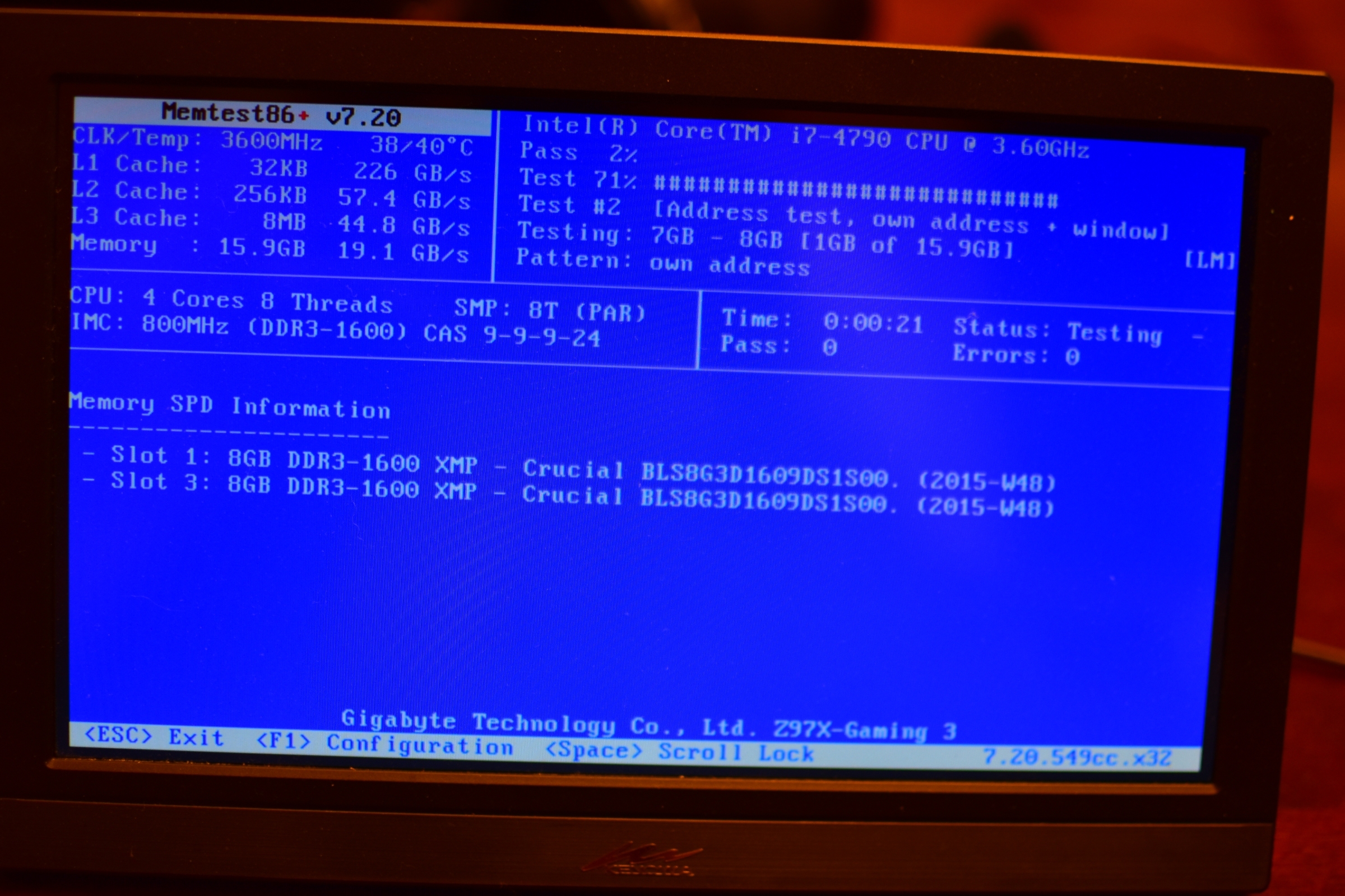

    And a dual-channel Z97 system getting 19.1 GB/s with 2 8GB sticks of Crucial DDR3-1600
    Specs as follows:
    Motherboard: Gigabyte Z97X-Gaming 3
    CPU: Intel I7-4790
    RAM: 16GB (2X 8GB)
    GPU: Nvidia (Gigabyte) Geforce GTX-1080
    SSD: Western Digital Blue SN570 1TB
    So I believe your results were probably typical for an X58 board, and it looks like on these older boards the CPU/Chipset were probably more of a limitation than the memory itself.

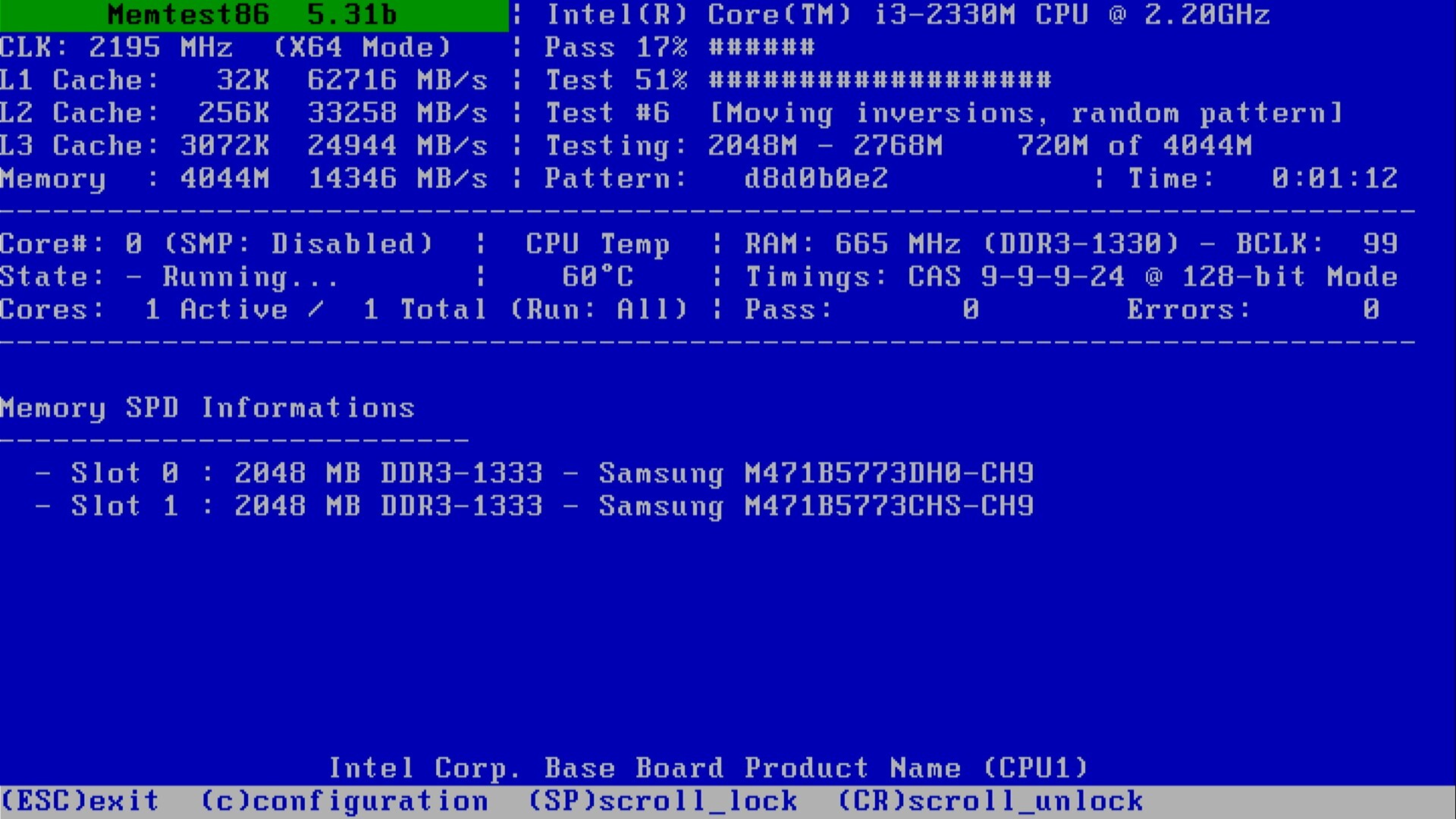

        An old i3-2330M is a little faster, but this might not be an accurate comparison since Lubuntu came with a different Memtest86+ version.
        Click image for larger version  Name:	WIN_20250629_10_25_52_Pro.jpg Views:	3 Size:	296.6 KB ID:	3670863
        I'm a little surprised that I got HDMI capture working, but Windows forgot how to open .jpg files.

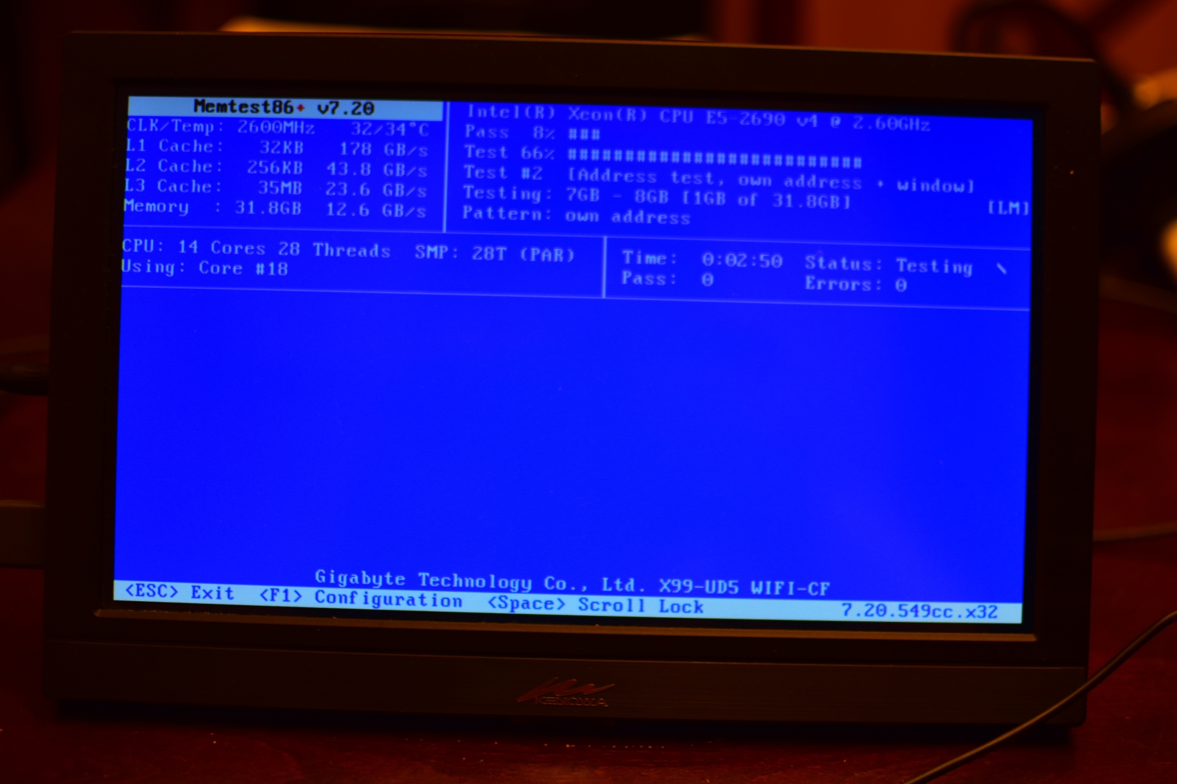

            For curiosity sake I spun up Memtest 86+ on some DDR4 systems (where you'd expect the speeds to be much higher than DDR3) and the results are definitely a bit "screwy".

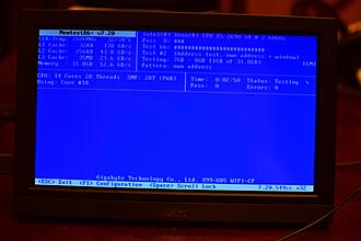

            First a quad-channel X99 system with 4 8GB sticks of Adata (Hynix chips) DDR4-2400 is showing 12.6 GB/s
            Click image for larger version  Name:	DSC_1585.jpg Views:	0 Size:	1.46 MB ID:	3671052
            Specs as follows:
            Motherboard: Gigabyte GA-X99-UD5 WIFI
            CPU: Intel Xeon E5-2690 V4
            RAM: 32GB (4X 8GB)Adata DDR4-2400
            GPU: Nvidia Geforce GTX-1070
            SSD: Hynix BC901 256 GB

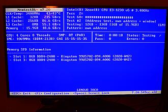

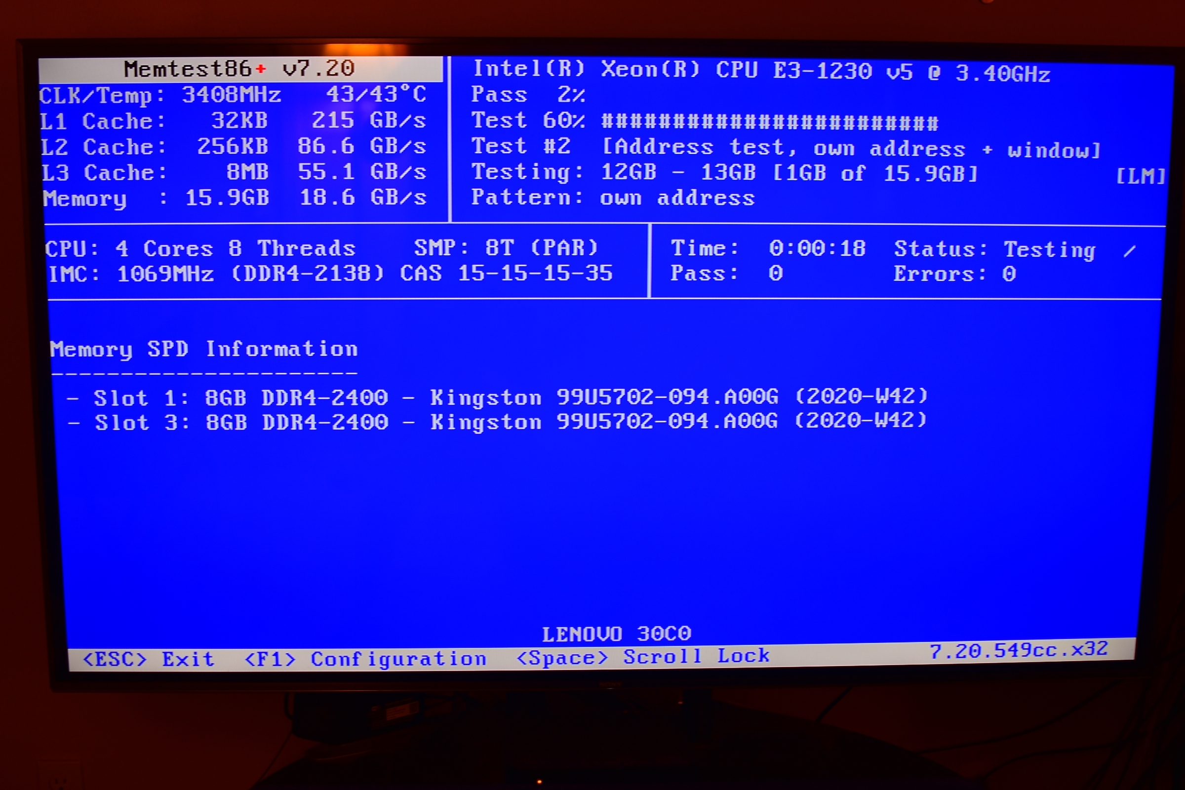

            A dual-channel 6th gen (skylake) Intel system with 2 8GB sticks of Kingston DDR4-2400 showing 18.6 GB/s
            Click image for larger version  Name:	DSC_1586.jpg Views:	0 Size:	1.56 MB ID:	3671053
            Motherboard: Lenovo ThinkStation P310
            CPU: Intel Xeon E3-1230 V5
            RAM: 16GB (2X 8GB) Kingston DDR4-2667
            GPU: Nvidia (PNY) Geforce GT-1030
            SSD: Hynix PC711 256 GB

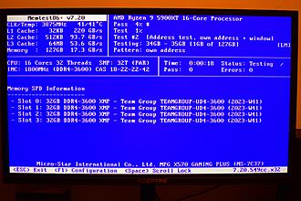

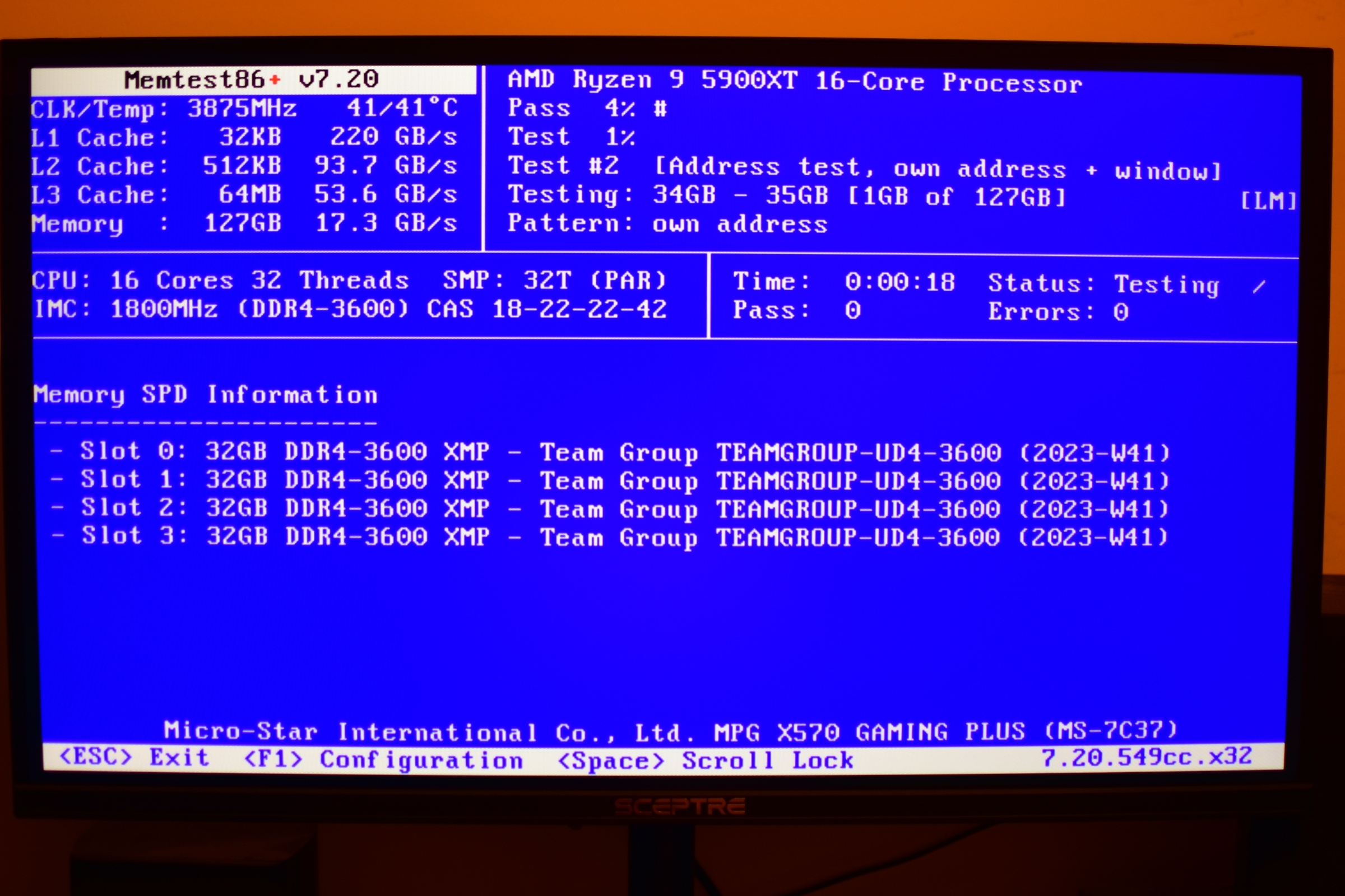

            And my most powerful system (which should be absolutely wiping the floor with everything else) a dual-channel AMD X570 system with 4 32GB sticks of Team-Group DDR4-3600 showing 17.3 GB/s
            Click image for larger version  Name:	DSC_1587.jpg Views:	0 Size:	1.56 MB ID:	3671054
            Motherboard: MSI X570 Gaming Plus
            CPU: AMD Ryzen 9 5900XT
            RAM: 128GB (4X 32GB) Team Group DDR4-3600
            GPU: Nvidia (PNY) Geforce RTX-4070 Ti
            SSD: Western Digital SN850 2 TB

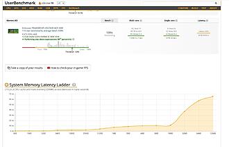

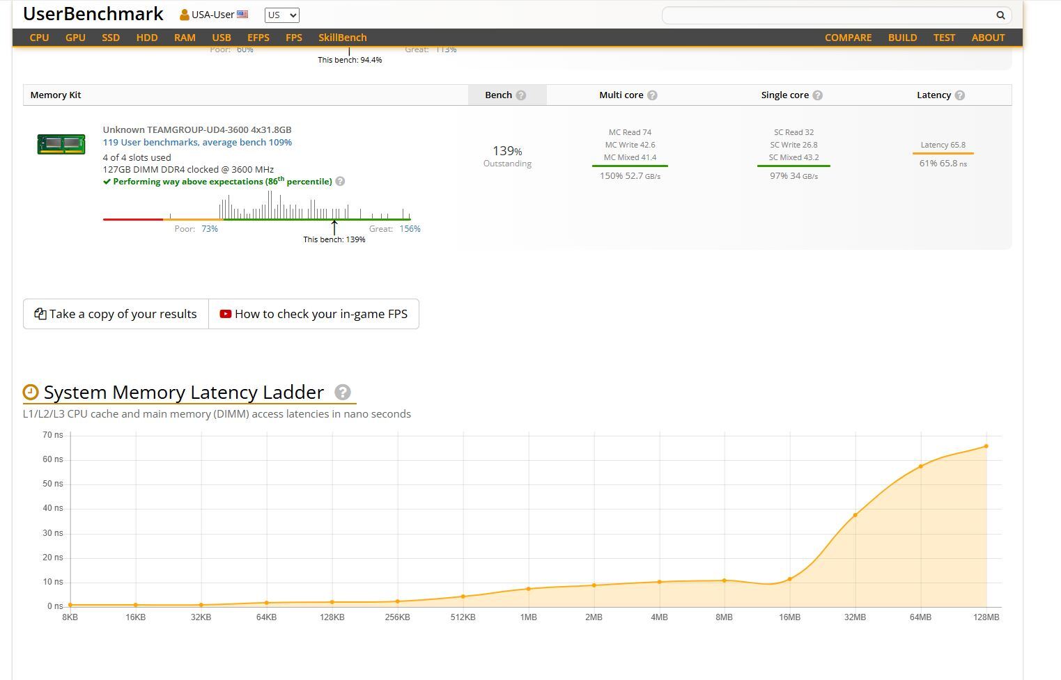

            And User Benchmark is showing 52.7 GB/s on this same system:
            Click image for larger version  Name:	User Benchmark 3 (Mem) 20250621.jpg Views:	0 Size:	99.5 KB ID:	3671055
            So something seems verry "off" with how Memtest 86+ is determining memory speed.

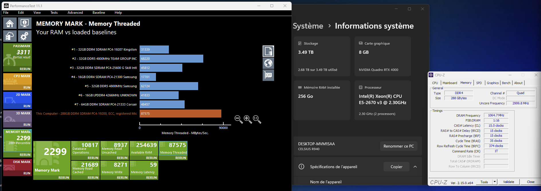

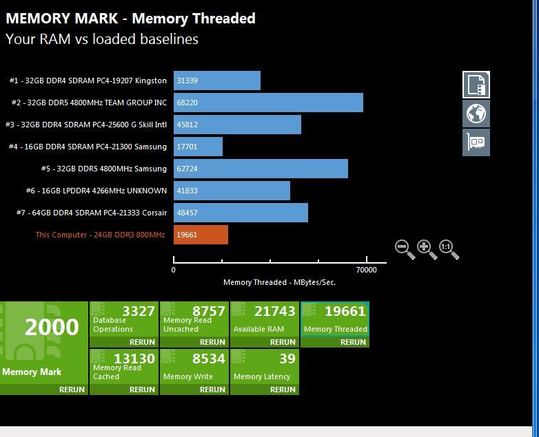

                Here's what passmark (running windows 7 on this system, so my options are limited on compatible "recent" benchmarking tools) has to say about that X58 system for camparison:
                It is showing 19.6 GB/s threaded, 13.1 GB/s cached read, 8.8 Gb/s uncached read, and 8.5 GB/s write. (though it is showing the memory speed as 800 Mhz, but the BIOS shows it as 1333 Mhz 🤔)
Name:	X58 MemoryMark.jpg

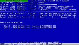

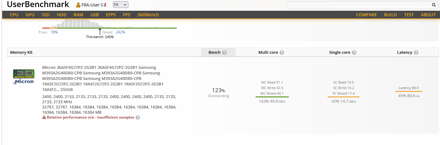

                    I looked at your posts and was interested in doing some tests too.
                    Well, I have a slot that's no longer working; I threw a bit of random RAM into it.
                    After enabling NUMA in the BIOS, performance doubled.
                    ​​There's dual and single rank. I'll try to find a complete identical batch to retest.

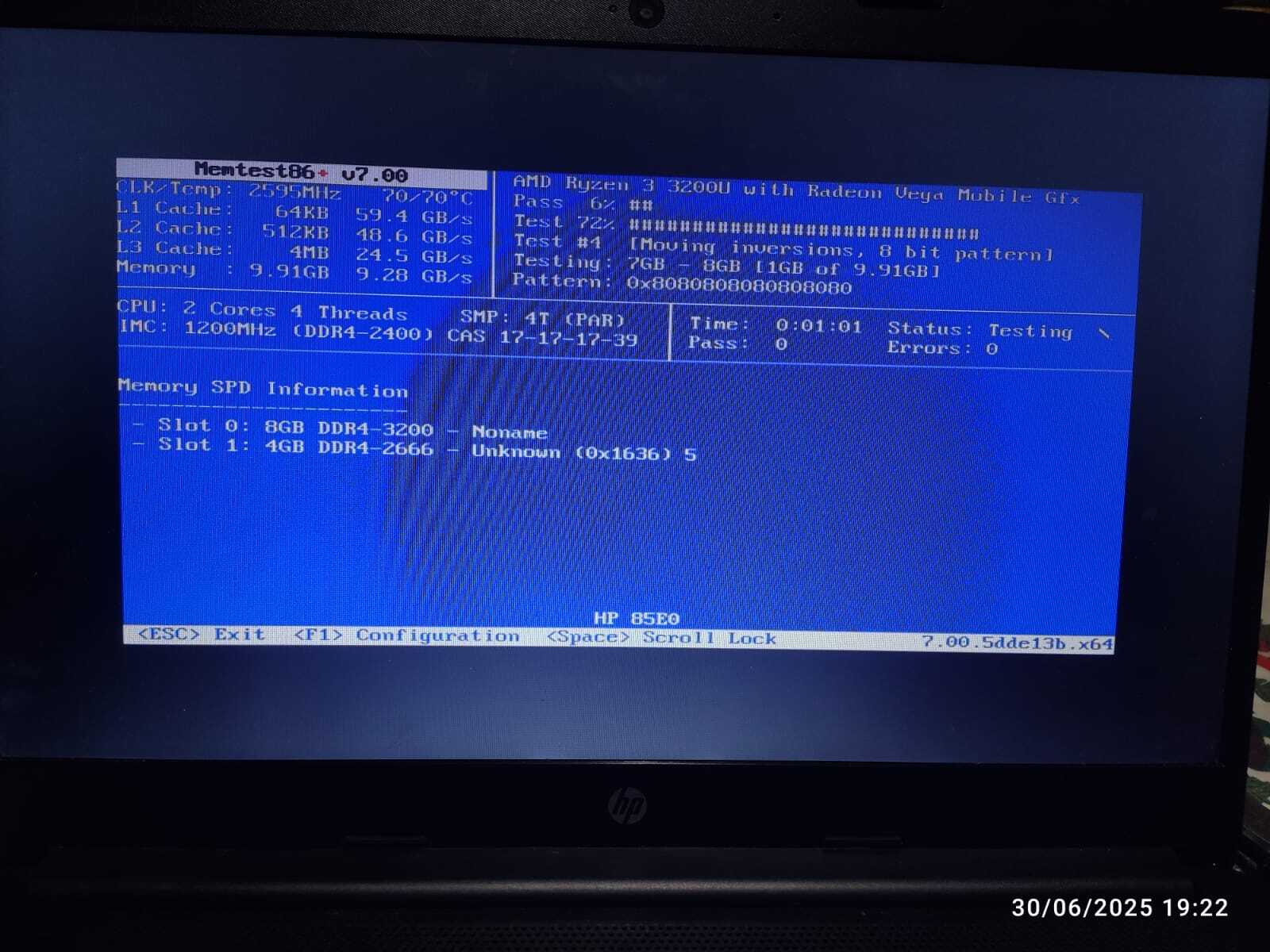

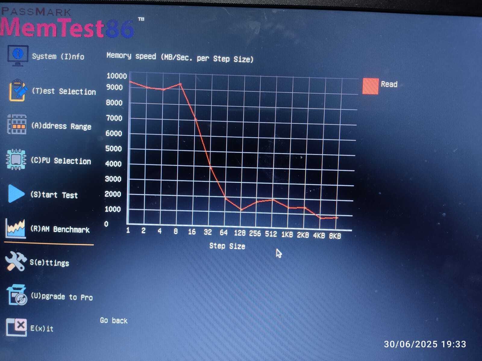

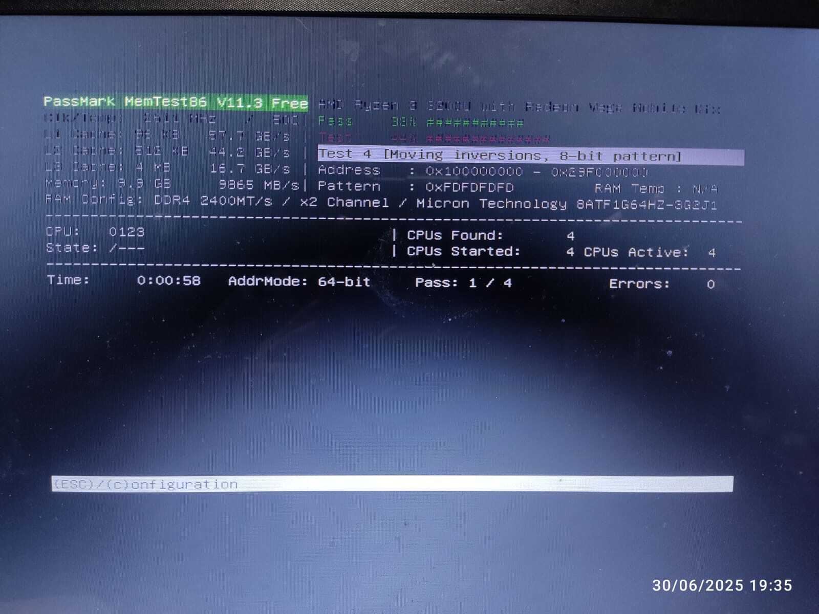

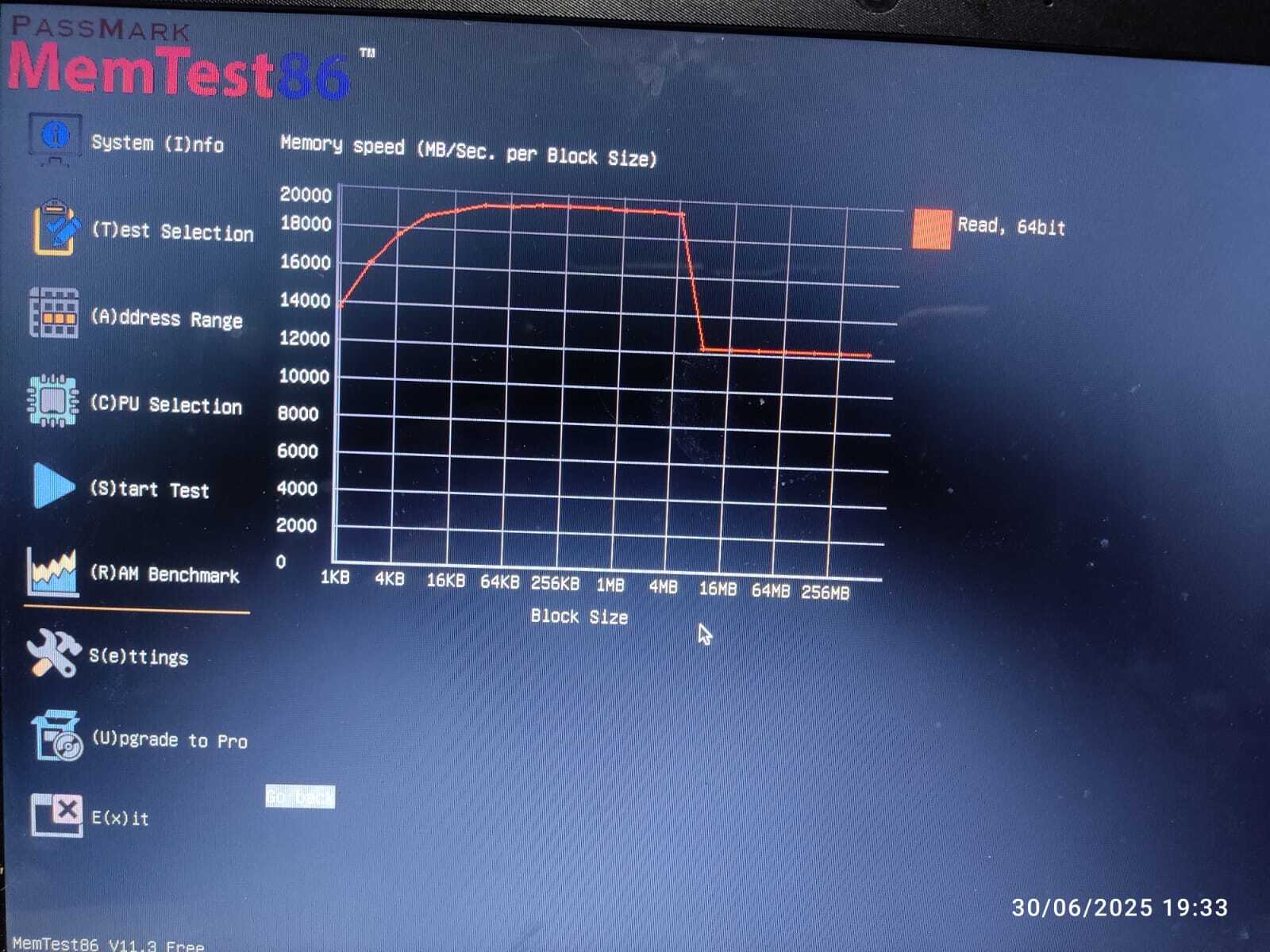

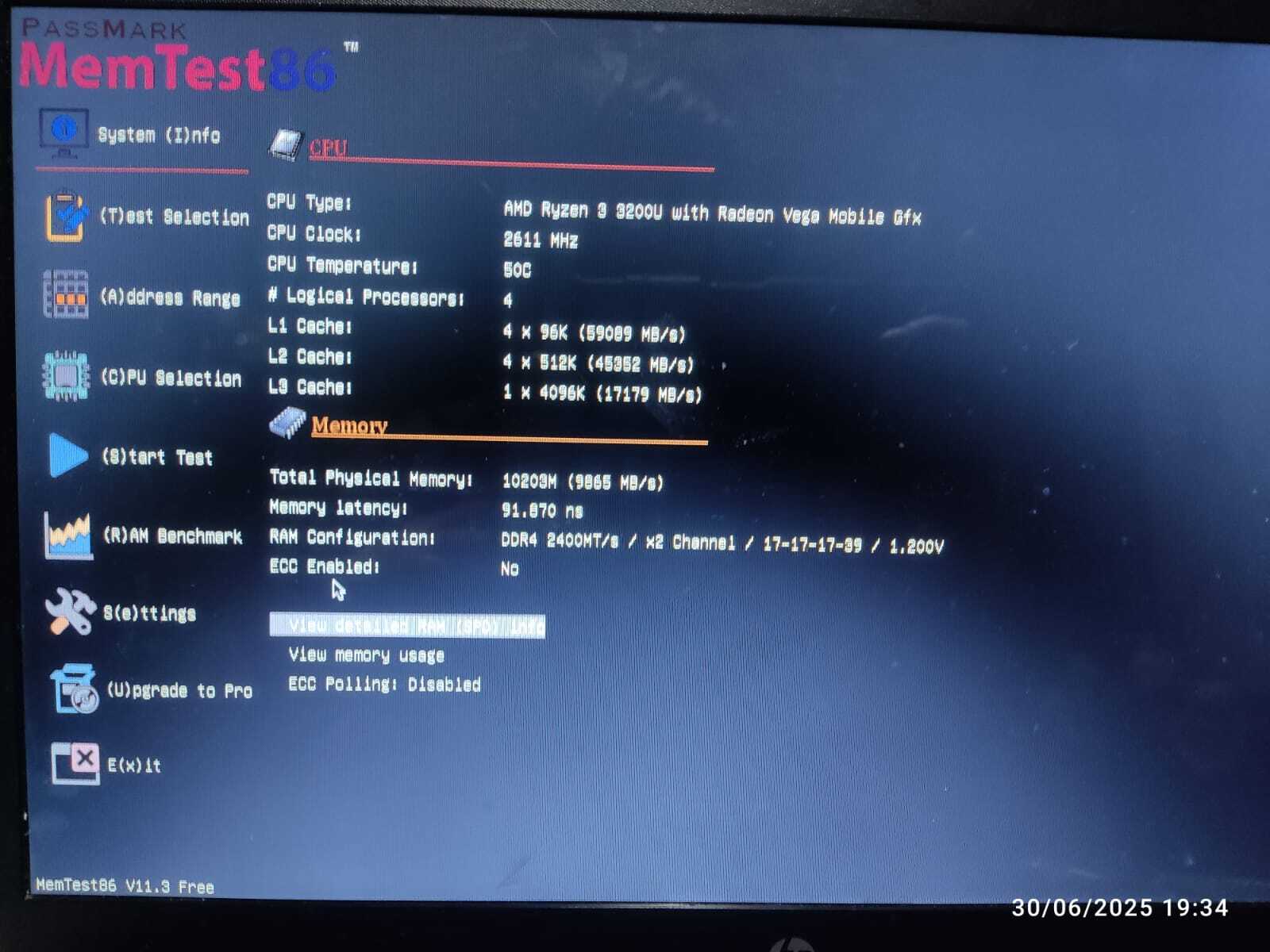

                      Here's mine, this is a laptop with AMD Ryzen 3 3200U CPU, 8+4GB DDR4 running at 2400MT/s, substract 2GB eaten by the integrated GPU (Vega 3)
                      Passmark Memtest86 11.3 (UEFI), it gives me 9865MB/s, I also ran both benchmarks there
Name:	passmark memtest86.jpg
ID:	3671969 Click image for larger version
Name:	passmark memtest86 1.jpg
ID:	3671970 Click image for larger version
Name:	passmark memtest86 2.jpg
ID:	3671971 Click image for larger version
Name:	passmark memtest86 3.jpg
                      Memtest86+ found in systemrescue 11.00 from last year, slightly lower at 9.28GB/s

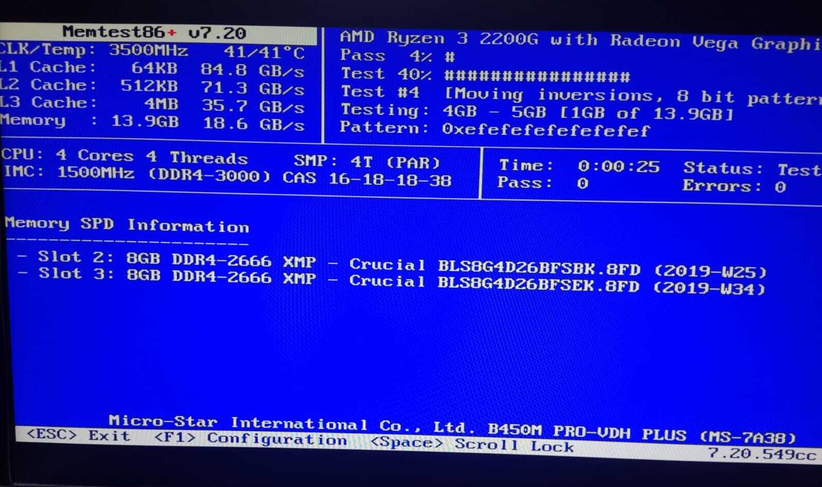

                          Tested memtest86+ on another 2 desktop PCs
                          1. Ryzen 3 2200G, 2x8GB DDR4-2666 OC'd at 3000MT/s, 2GB eaten by the integrated GPU
                          Click image for larger version  Name:	r32200g.jpg Views:	0 Size:	129.6 KB ID:	3672017
                          18.6GB/s, running in dual channel

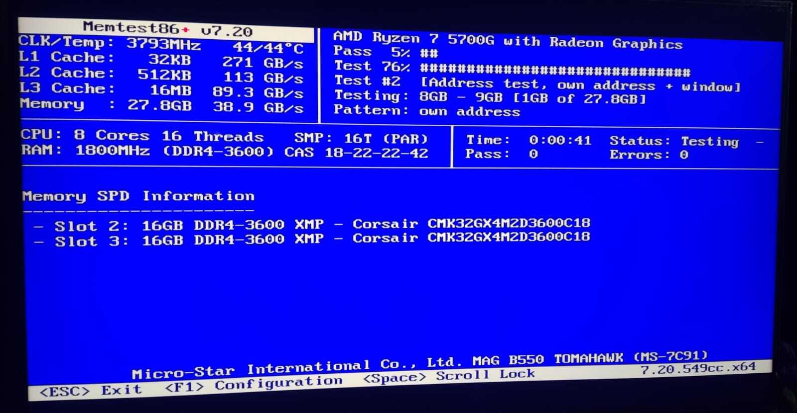

                          2. Ryzen 7 5700G, 2x16GB DDR4-3600, 4GB eaten by integrated GPU (forgot to disable it, I have a dedicated GPU on this PC)
                          Click image for larger version  Name:	r75700g.jpg Views:	0 Size:	103.3 KB ID:	3672018
                          38.9GB/s, more than double , I expected maybe 20% more just by the RAM speed difference
                          The amount of RAM/CPU cores seems to have an effect ... Yet I beat dmill89 on memtest86+ with only a quarter of RAM (32GB) and half the cores/threads (8C/16T) Ryzen CPU
