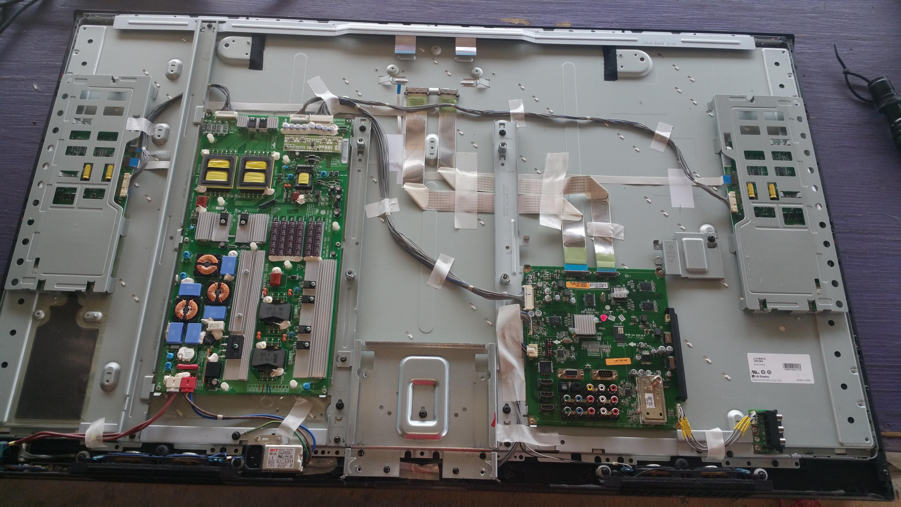

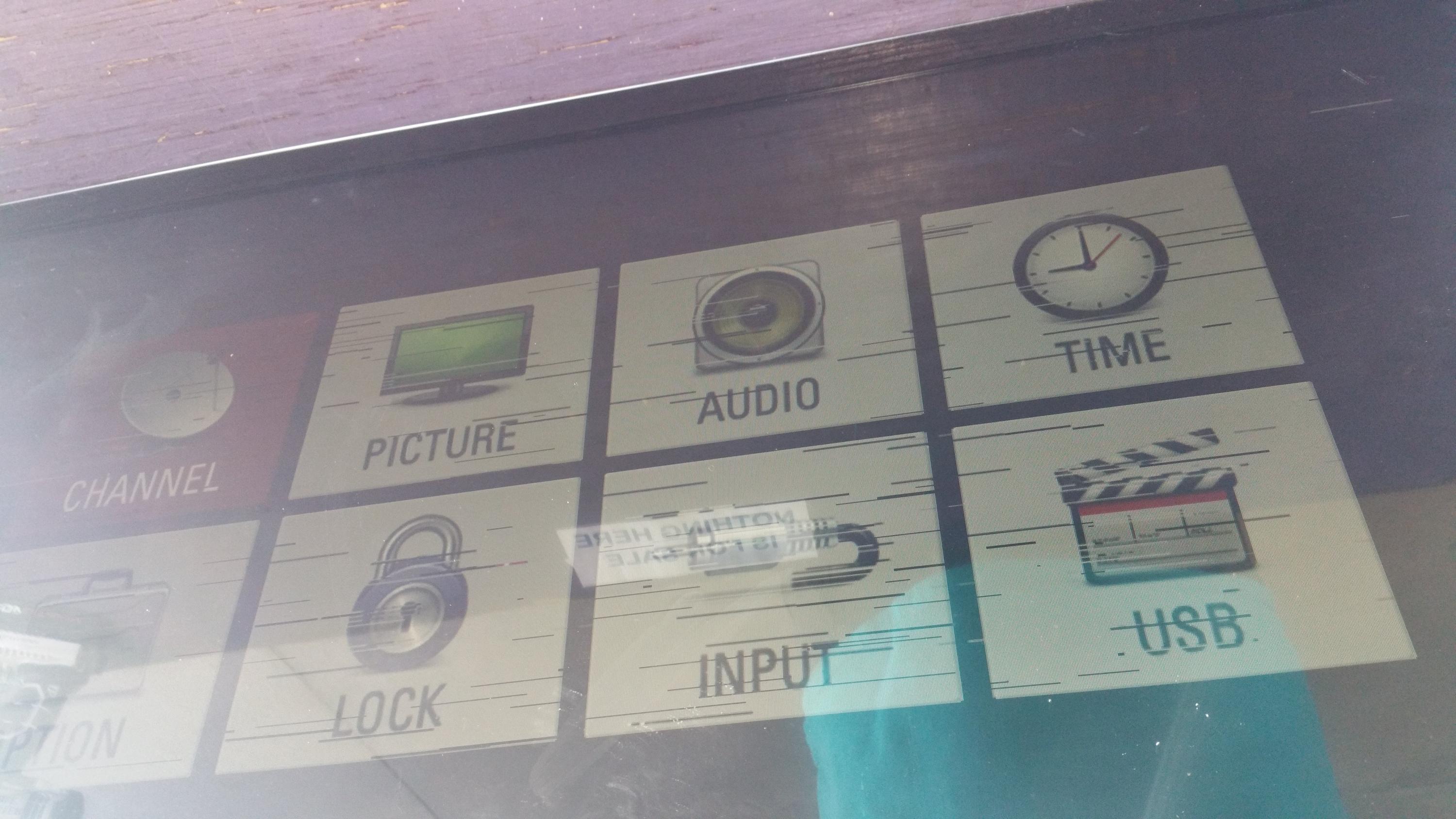

    Try cleaning and reseating the LVDS cable at both ends and the FFC on the T-CON Bd. to the Source/Panel Bds. Looking again at your 2nd pic, is the image showing whitish on the screen?

      Nope.. That's just the glare...

        Are they flashing or are they stationary? Actually I've never encountered anything like this before.

          They seem to be moving all over the screen...
          I'll get a better pic when I get to the shop...

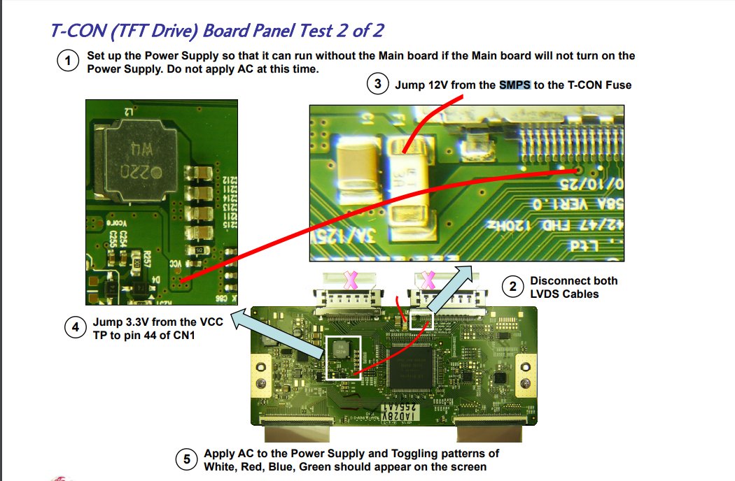

            Re: LG 47SL80 Horizontal "Dashes"......

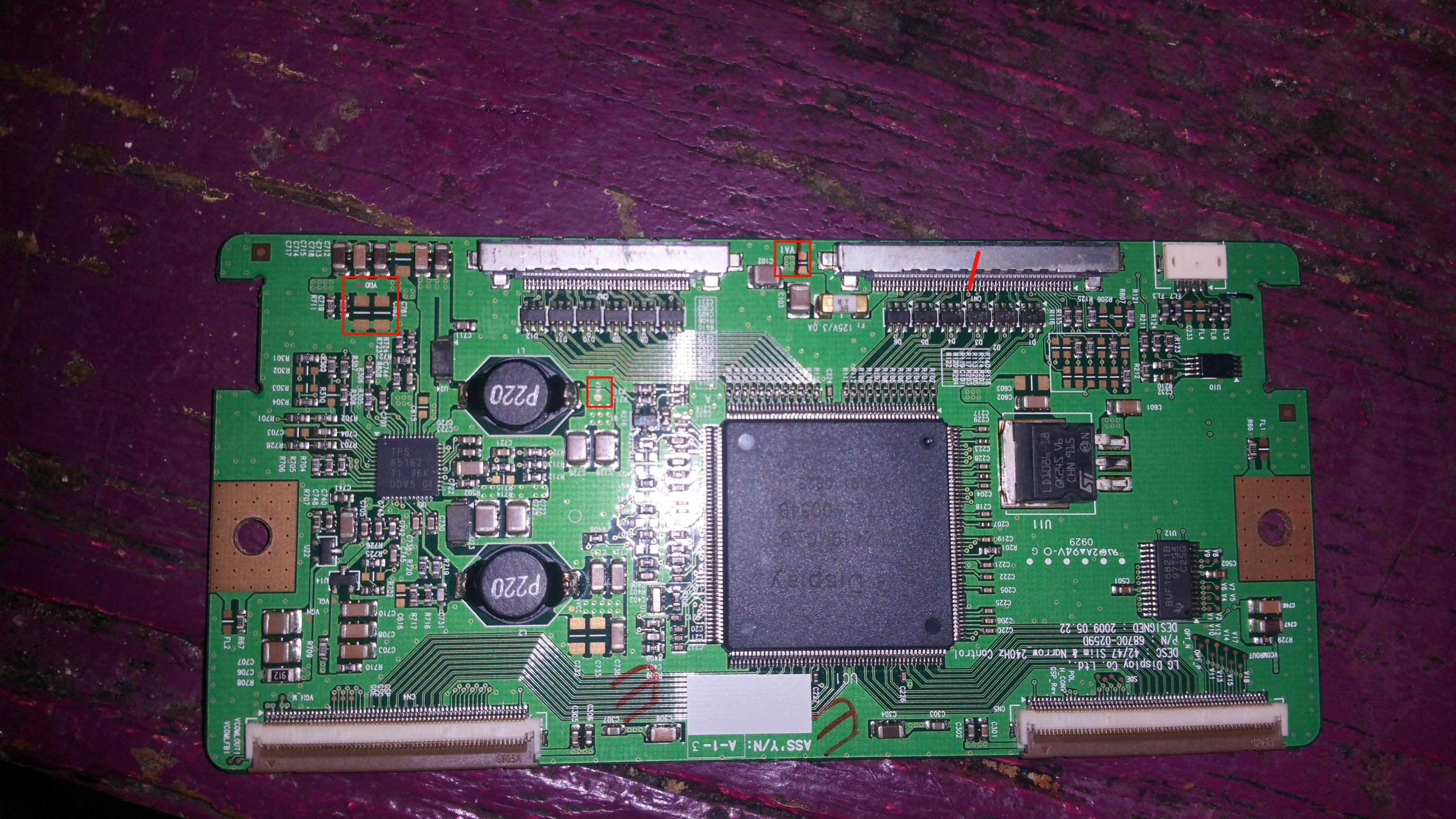

            Have you tried just running the test pattern as shown in the attachment. It would eliminate the panel and Tcon as the fault.
              Thanx for that.. I'll give it a shot..
              Everything looks clear except jumpering the 12v from the fuse to the SMPS board??
              What's the SMPS Board??
                SMPS: Switched Mode Power Supply.
                So that would be your PSU or Power Bd.
                    If you have an external power supply you can use that to power the Tcon

                      close check the LVDS cable between the main board and tcon... both in terms of the cable itself (ie. any bends, etc) and the connectors / pins. Those look like "transmission errors".
                        OK My TCON is a bit different than the one in the picture..
                        I have found corresponding connections for the LVDS connection, but I can't find any 3.3v VCC...
                        I have found a VIN, a VDO and a VA1....

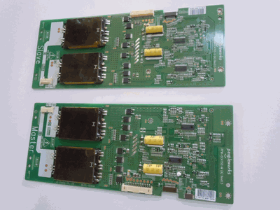

                          That sure looks like high voltage arcing causing the lines, does this tv use an inverter and ccfl lamps? If it does I would check the high voltage inverter connections (or capacitors) or it could be a cracked ccfl.
                          You should be able to here it, like a sizziling sound.
                          Post a picture of the rear of the tv and if it does have inverters there are likely two, master and slave post pictures of them also
                          They could look like these

                            Yea, it does use the CCFL lamps. It's got an inverter on either side..

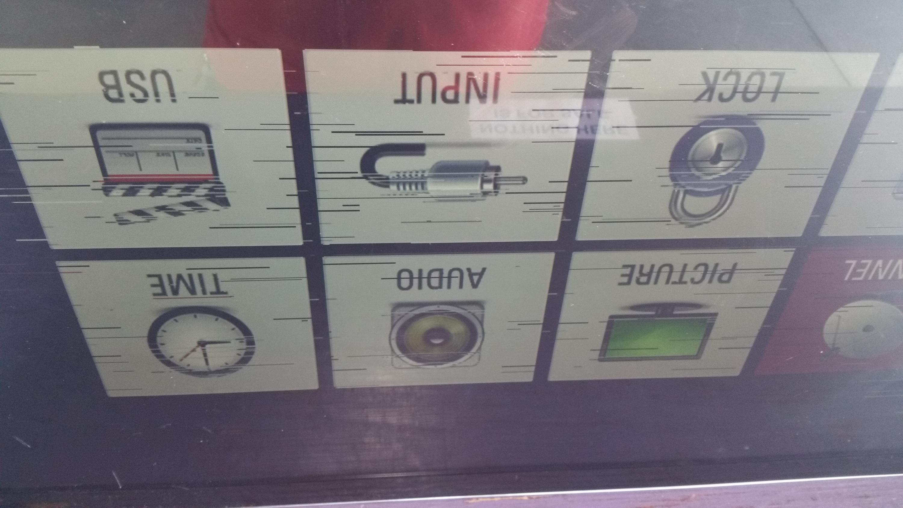

                            In answer to a previous question.. Some of the horizontal lines are stationary and some are flashing up and down..

                              Yep, that's exactly what they have...
                              I don't hear any sizzling or arc'ing when the TV is on..

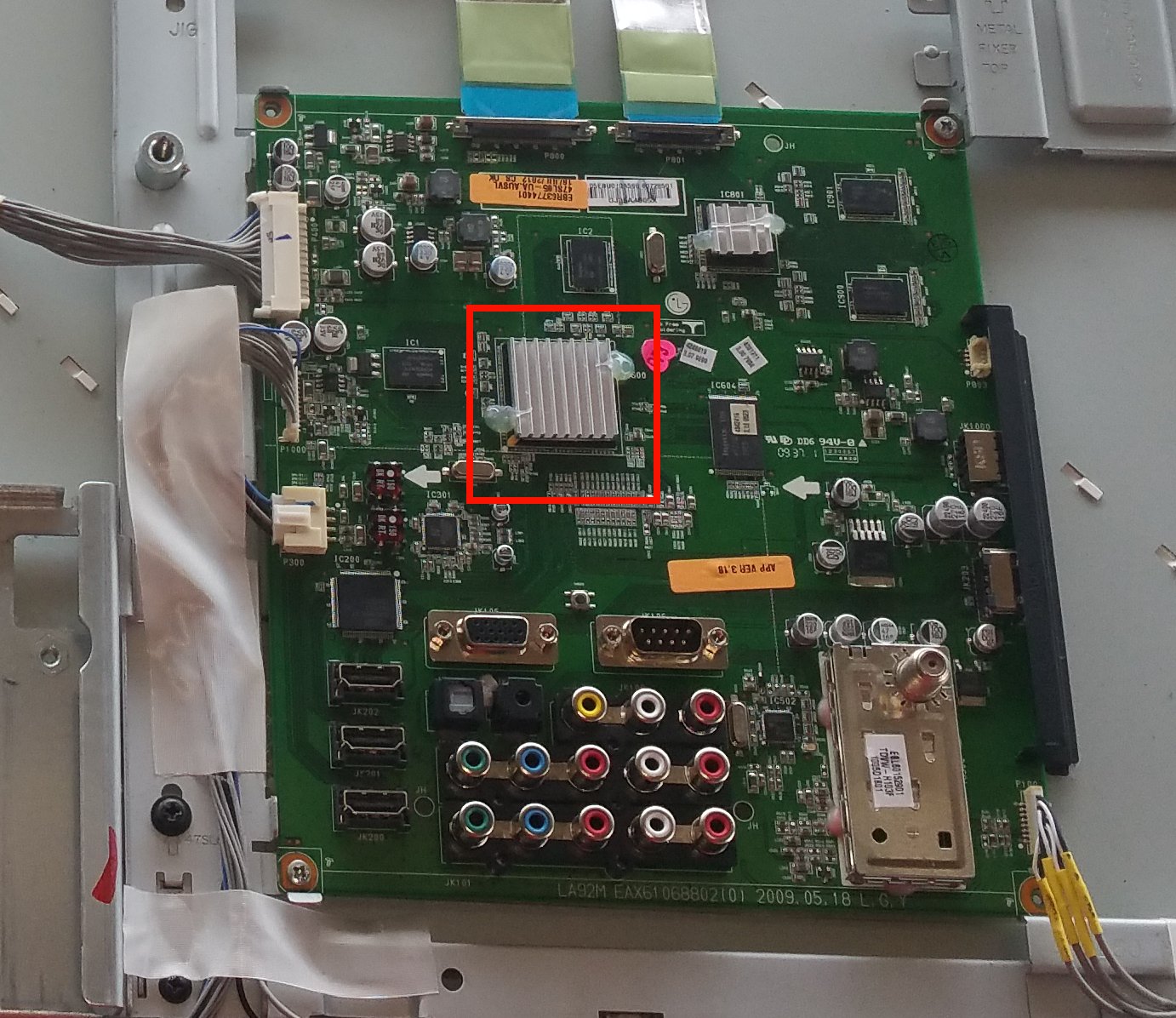

                                Looks like it could be a BGA issue, any change to the lines of you heat the main IC on the mainboard ?

                                  You can try disconnecting the power going to the inverter,(try one then the other) the backlight will not stay on but you may be able to use a flashlight to see if the lines are still in the image

                                    Lines are still present with the inverters unplugged...

                                      I did do a rudementary reflow, not concentrating on the BGA, which I assume is the chip outlined in the pic??

                                        well that eliminates that idea. By chance do you have a scope? I might suspect a noisy ldo/bad cap like the ones near the power supply plug above ic1 in the picture
