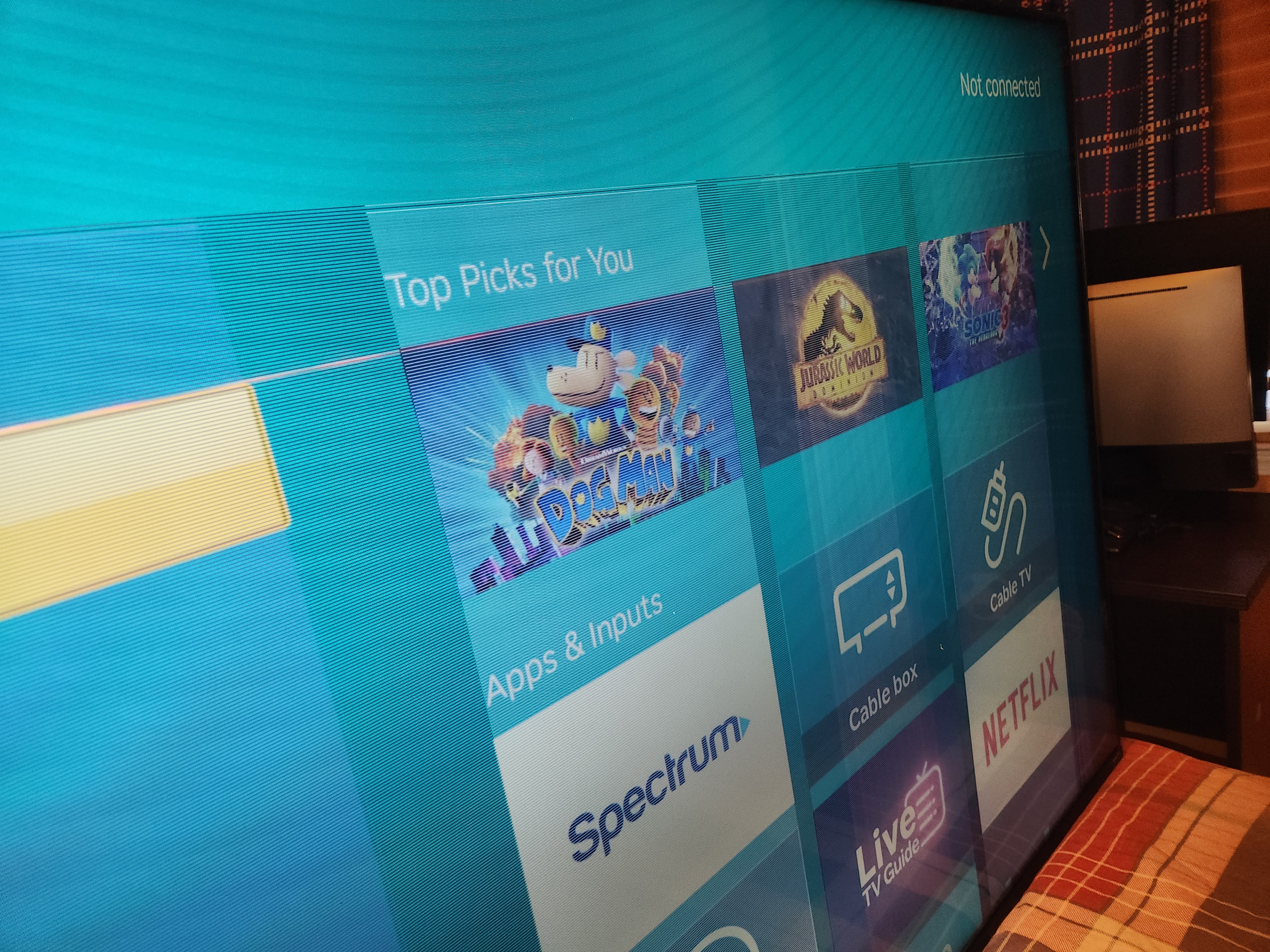

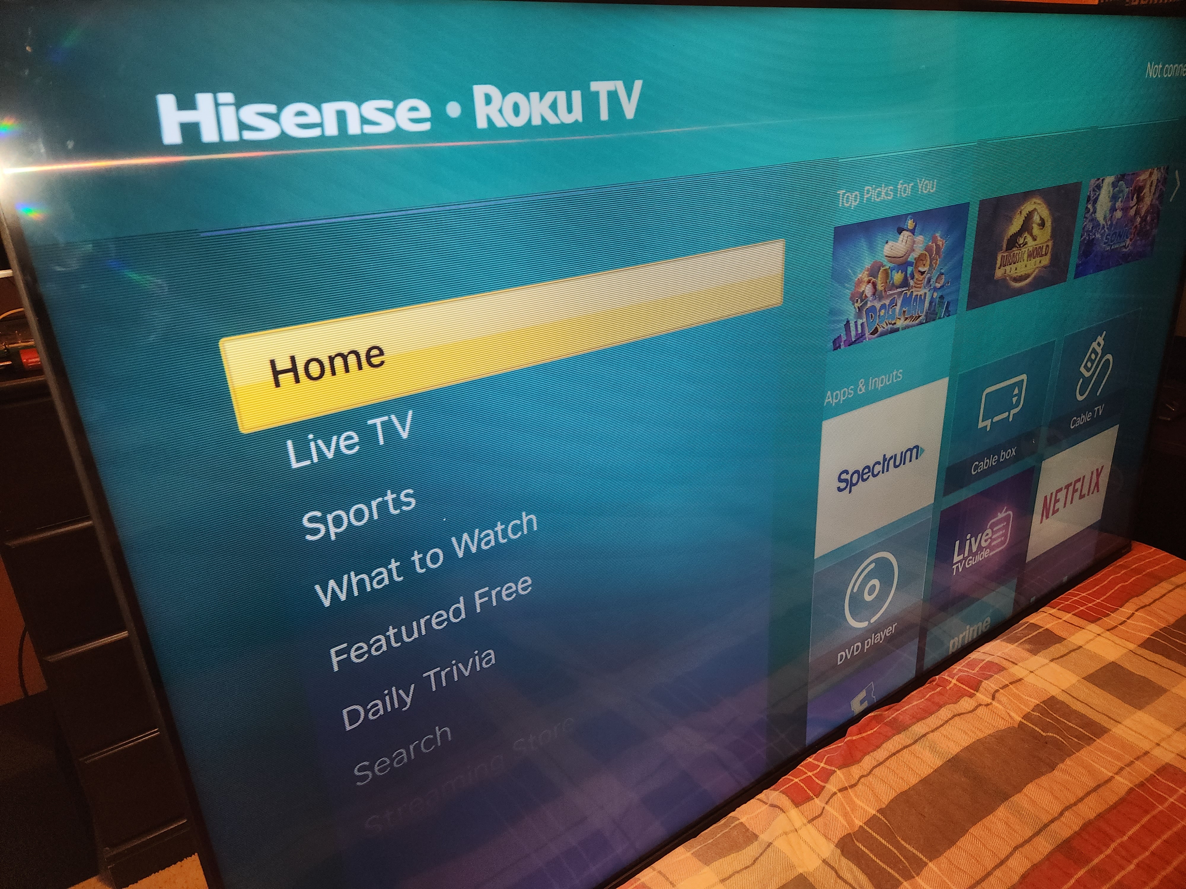

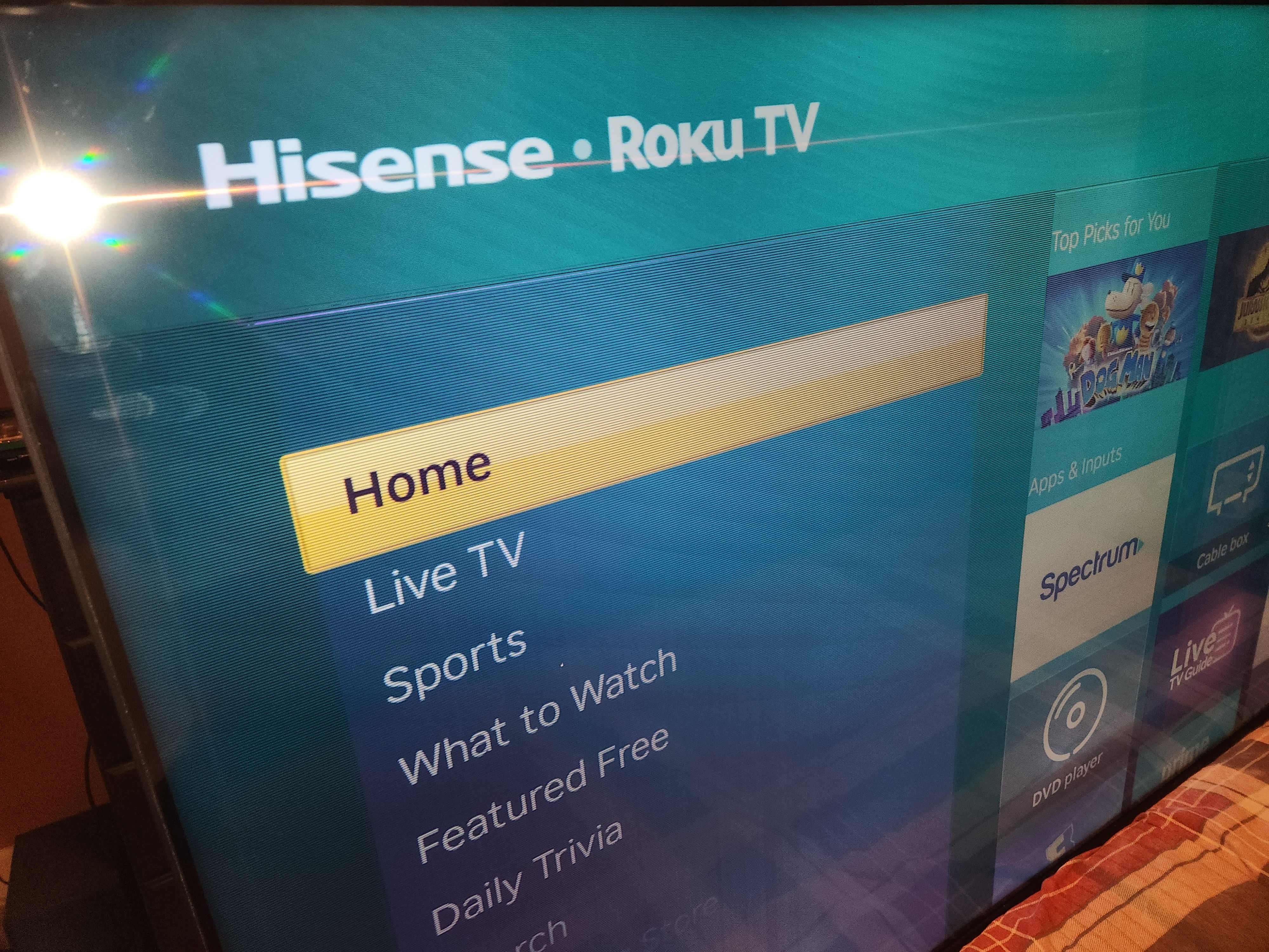

    Hello all. 3 years back, with your help, I replaced the LEDs on this TV. It's been working great. Yesterday, I turned it on (garage TV), and it has blurred horiz / vert lines as you see in photos. Definitely no physical hit or damage. Top 1/6th of the screen is perfect. Could it be main / TCON board? No tabs to cut on this model. Thank you

      Could be loose tab bonds, maybe check youtube for diy tab bond "fix" or similar words, lots of results: Vertical or horizontal lines appearing on a TV screen can often be attributed to loose or faulty connections, including a common issue known as "tab bond failure". Tab bonds are the thin, flexible ribbon cables that connect the control board to the LCD panel, carrying the signals that create the picture. When these bonds become loose or lose contact, either due to physical damage, manufacturing defects, or the gradual effects of thermal expansion, the signal flow is disrupted, resulting in lines on the display.

        Have had those exact lines a few times and it was a loose tab bond, was usually one on the top corner.

          Thank you.. this TV has the electronics on the bottom. No side tabs. It has connecting ribbon tabs (u shape tabs) - removed, cleaned and attached - no change. Maybe I'm misunderstanding - do you mean how the electronics board attach to the panel?

            The tab bonds are where the buffer/adress boards attach to the screen, they can become loose, I use to shim the old ones that had a nice full frame where it wasn't too hard to get something to stay in there. Some good tape might get the job done too, example there: https://www.youtube.com/watch?v=purk_SyiT44

              Thank you.. I'm unable to find any tab that makes any change when pushed - seems, maybe, this is something else?

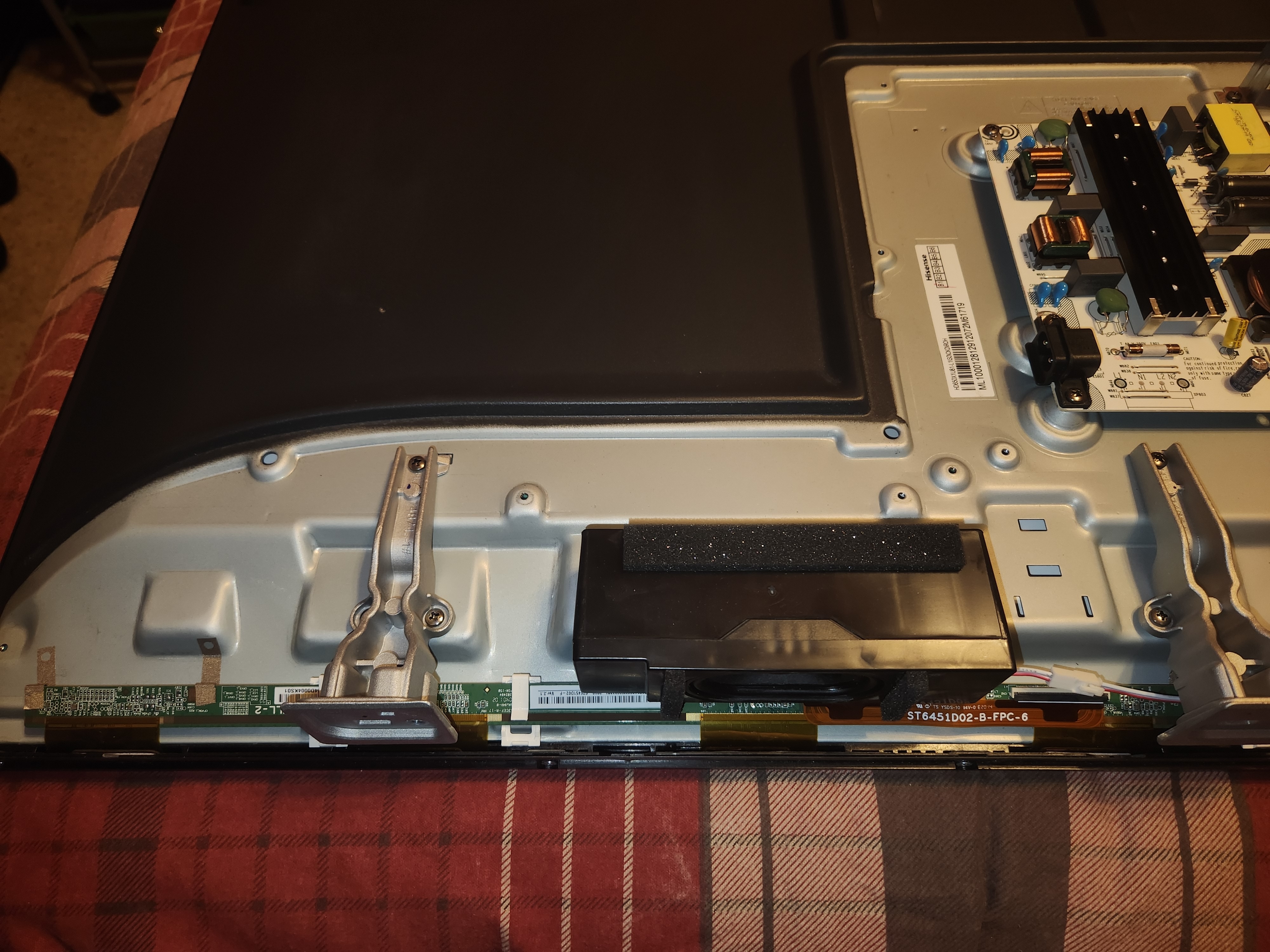

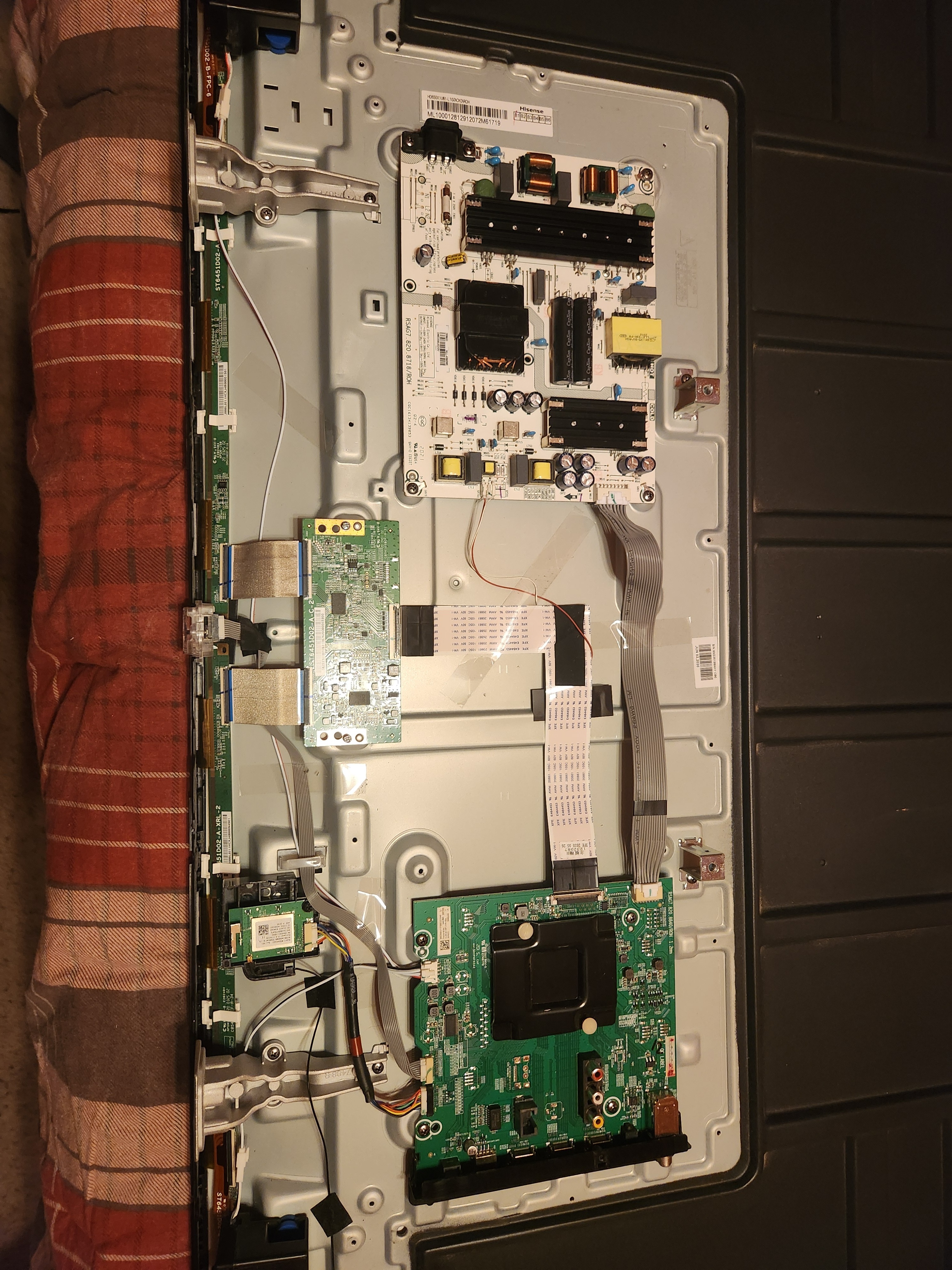

                Can you post the usual pictures of the insides.

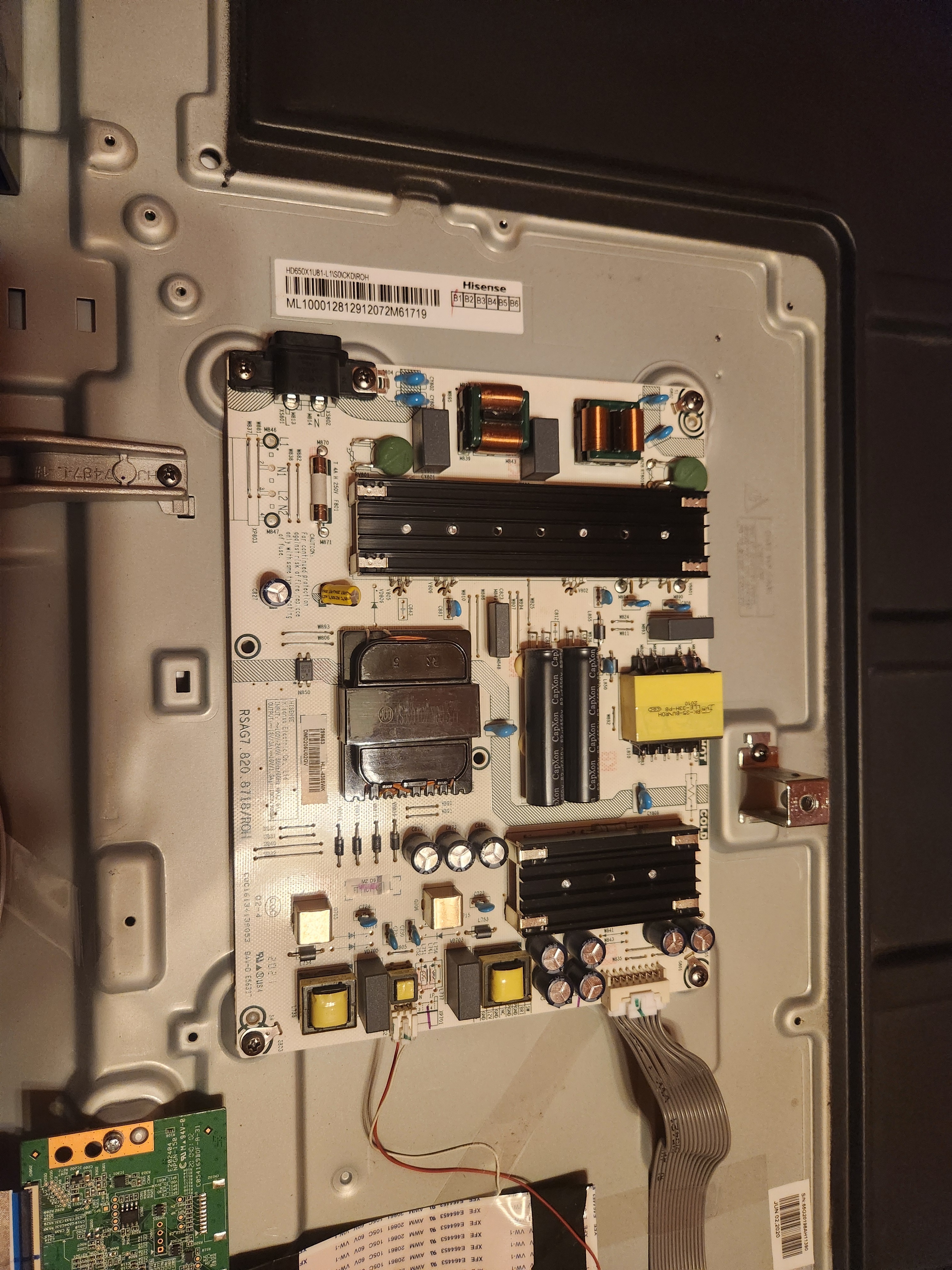

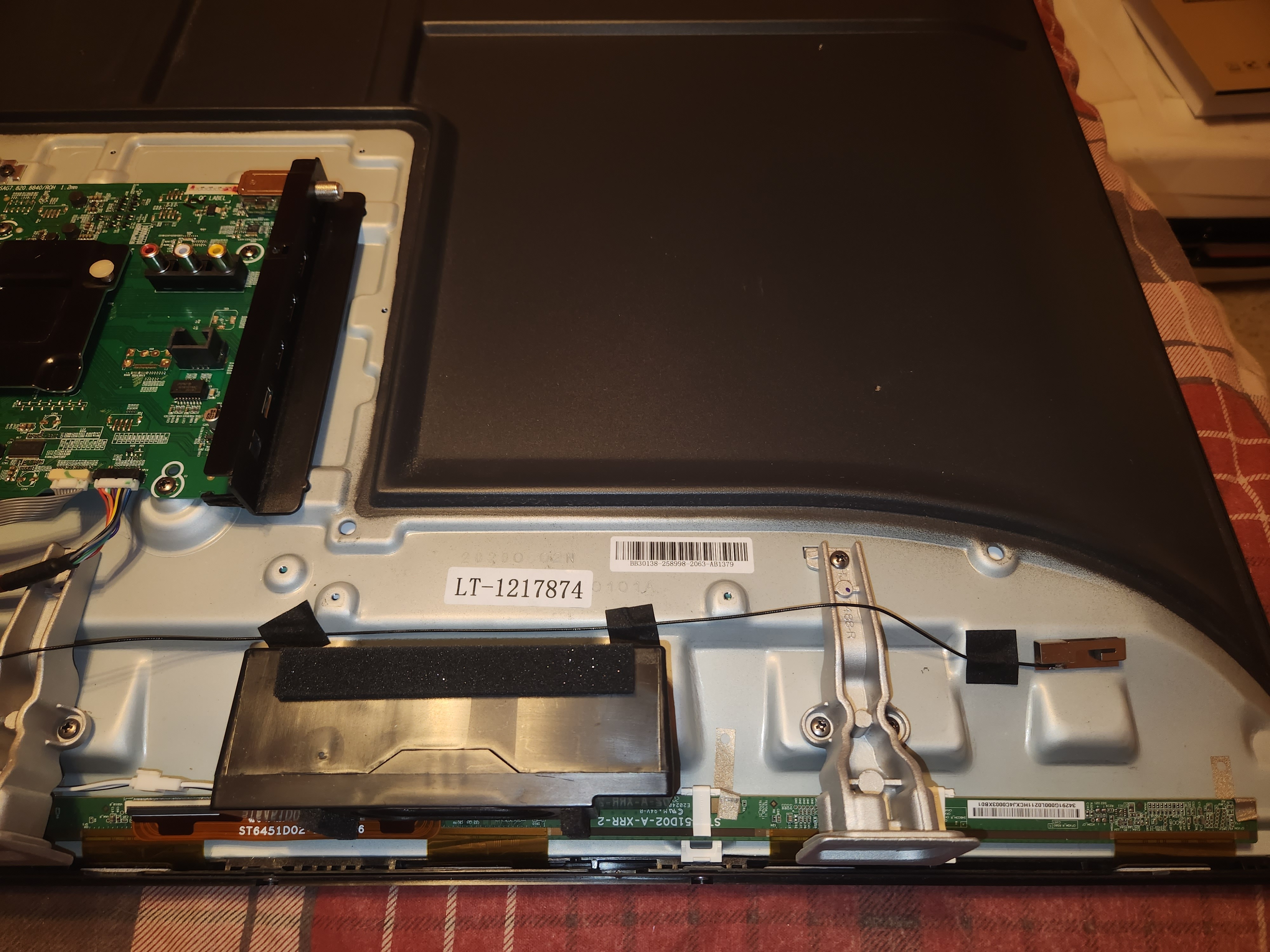

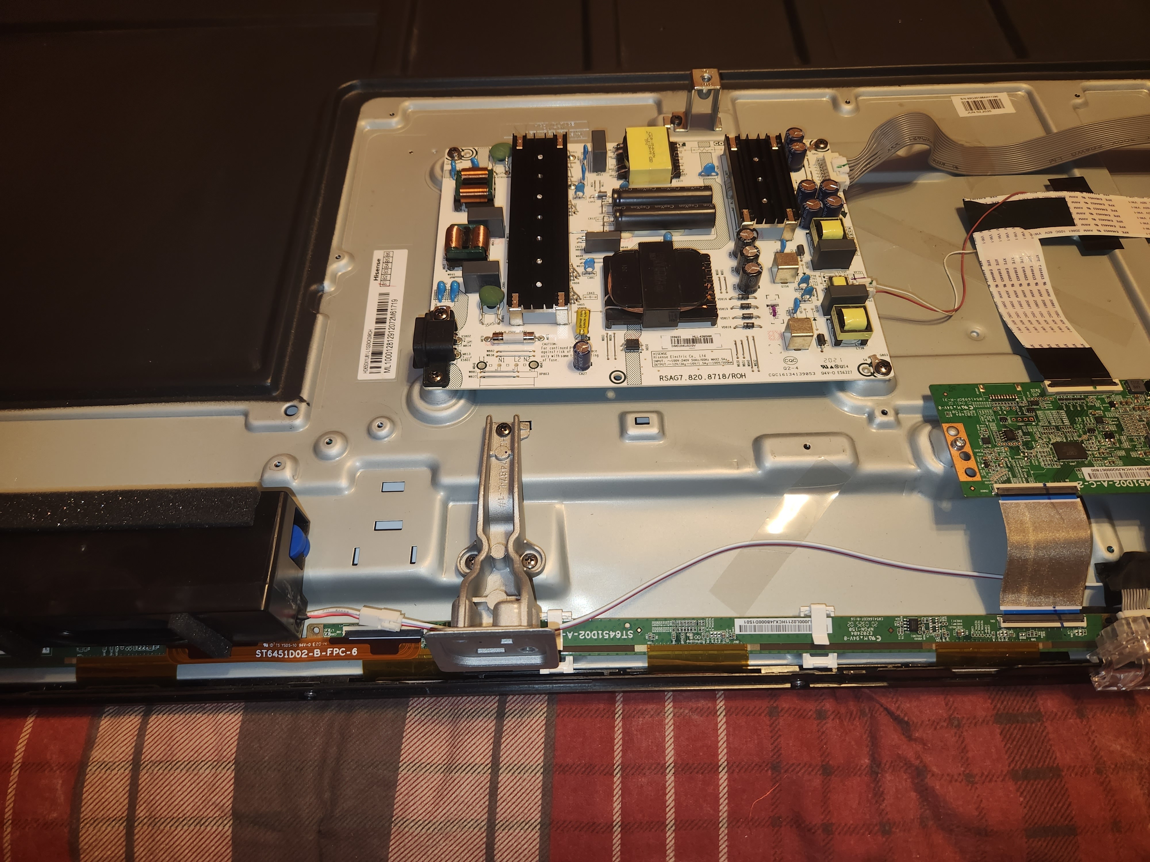

                    • jason123
                      • Oct 2015
                      • 1083

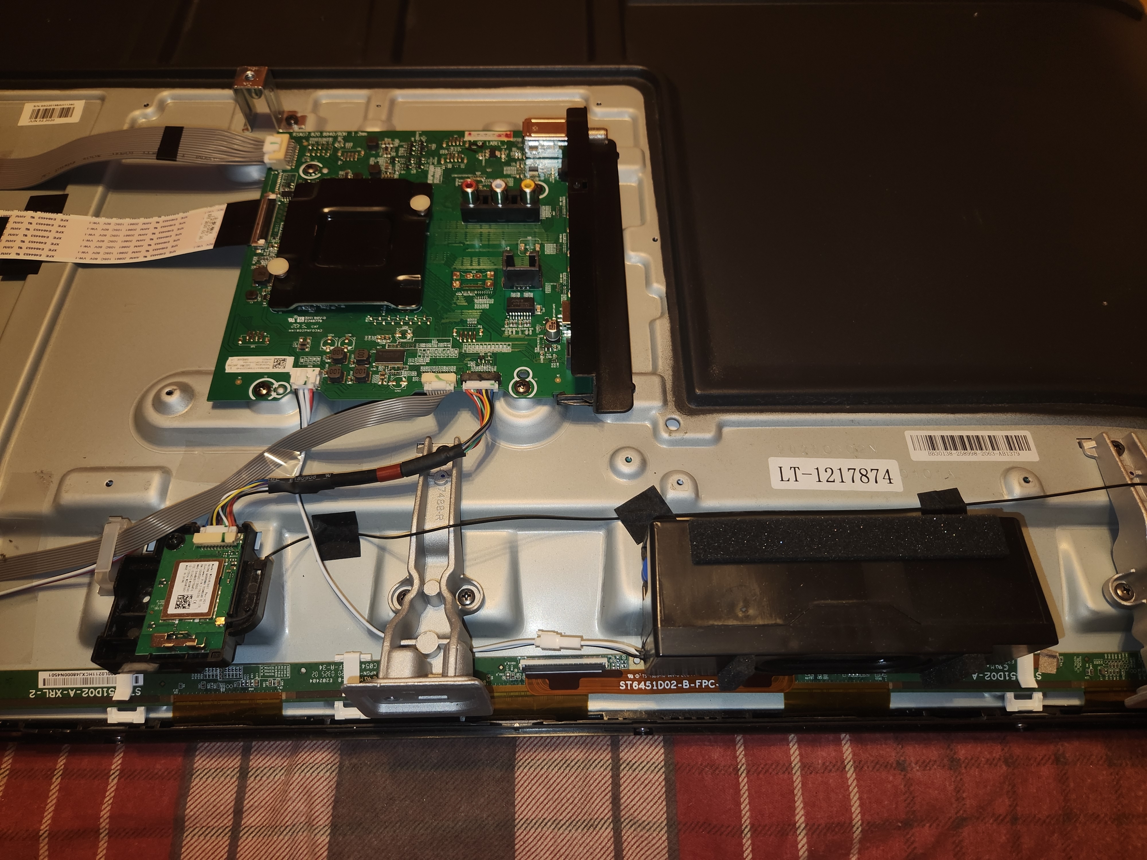

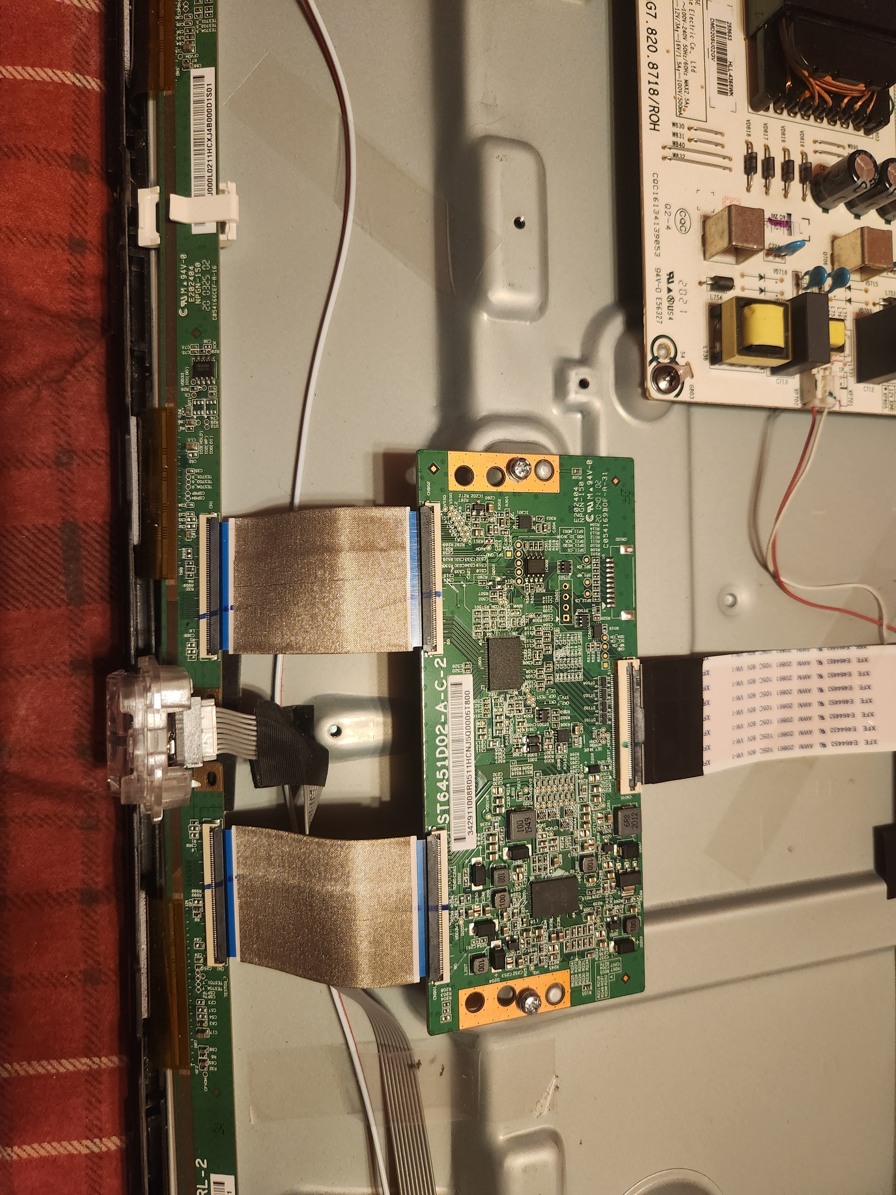

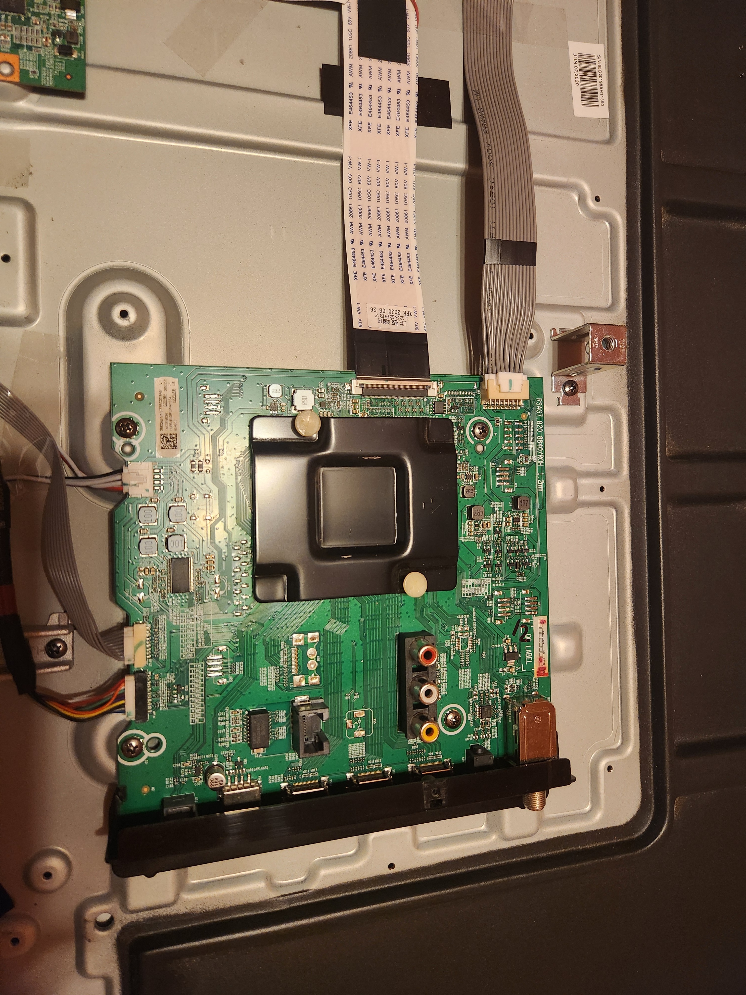

                      Here you go

                            I would try a replacement tcon, maybe check for the usual tcon voltages, can look at youtube for tcon checking. Make sure your tcon connections are good and the flat cable and ends are clean set correctly in socket and not damaged.

                                Same as photos in Post # 1, Diah. Slightly less prominent on the left hand side of the TV (As you're looking at it) when only that half is connected. Right hand (as you're facing the TV) is just as bad as in #1
