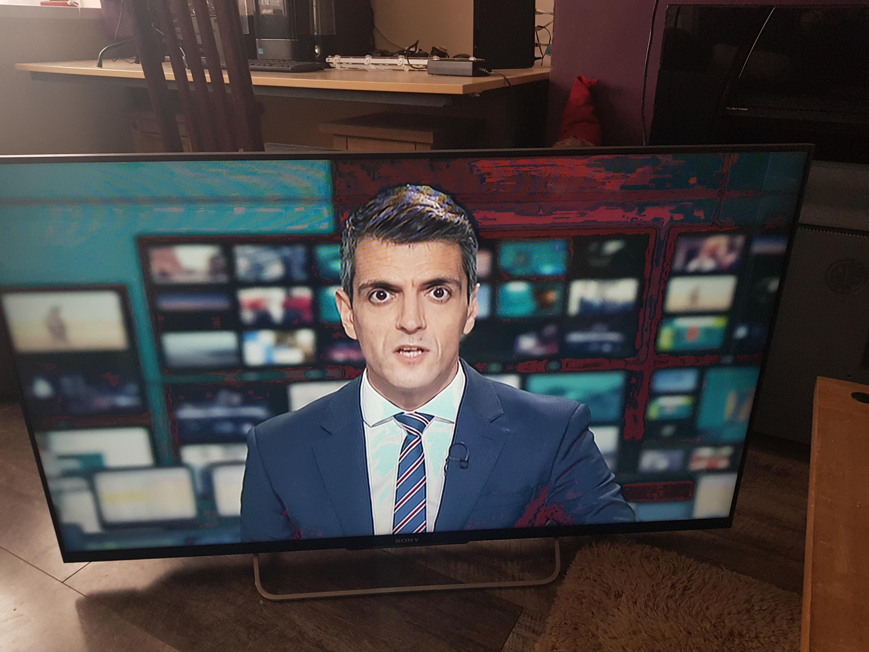

    The set belonged to a work colleague he said it had been stored in his bedroom for a few months now as he bought a replacement set when this went faulty, He said he turned it off one night and the next day when he switched it on all he got was this black screen i asked had any one looked at it he said no he said after a few phone calls to Sony and it being out of warranty the cost for repair was to much.
    So he bought a new tv.
    Here are a couple of pictures along the bottom of the set from the front you can clearly see the tabs are behind the screen.

      Did you have a look at the pictures ?
      As you can see the lcd panel would need to be removed to inspect the tabs on panel side, but saying that as the tabs are fixed on the back of the panel hopefully would mean less chance of water damage due to screen being cleaned ? do you agree.

        its hard to see clearly the bonding area near the panel edge. The problem that you show in previous pictures with vertical lines near the far side is potentially caused by issues with the tabs at the very end of the panel.
        I guess I have exhausted my experience with this model.
        Another thing with respect to the pictures of the display with one side disconnected... the side that is disconnected should be uniformly white. In your picture, it shows a vertical band which is not white.... that potentially is an area (tab) that has a problem.
        Pictures of the display are somewhat washed out... can't tell if that is the photography or the display. If its the display, that could mean an issue with the tcon since a "good tcon" with one side disconnect should produce a picture on the remaining side that is "perfect" in terms of color and brightness.

                            I also have tested all the chip resisters and caps and the two transistors on the lcd tab boards and all seem to check fine.
                            Now the only thing would be left to try would be a genuine new t-con board as i have now tried two second hand t-cons with no results can't really trust second hand.
                            But i expect that would be pricy for a new replacement t-con board!! It's a pity they haven't developed a tester that you could connect different t-con boards to and display if they are good or bad ?
                            Like Vince said if not the t-con then it looks like a bad panel.
                            I have come across a few of these Sony smart TV's just recently ranging from 40" to 55" and all seem to suffer from lcd panel failure and all below 5yrs old it seems to me that Sony must be aware of this issue but failing to post any remedies or help for their products. (very poor practice ) This will surely come back and bite them.
                            Sorry i can't offer any more help but i am still in the same state as your self accept mine is now failing to display any picture what so ever with or with out ribbons connected.
                            I am now resolved to panel failure if you have any progress please keep me posted.

                              My difference is that I can get half of the display to work perfectly with just the right side connected (as you view the screen). I don't think its worth me pursuing it any further. I might order a cheap TCON board from asia as a last ditch attempt but it is probably futile.
                              I am curious whether I could get a longer tcon cable to see whether one side of the tcon could drive the opposite side but I guess that might be a design issue anyway and cause even more issues.

                                      Just got one of these sets for repair
                                      Symptons black screen with no picture
                                      Backlight is ok no gamma voltages showing until I unplug the left tcon ribbon where one side of the screen is good but the other side has a washed out white image
                                      Ended up taping up a certain amount of the tcon ribbon and now the picture works but with gamma issues
