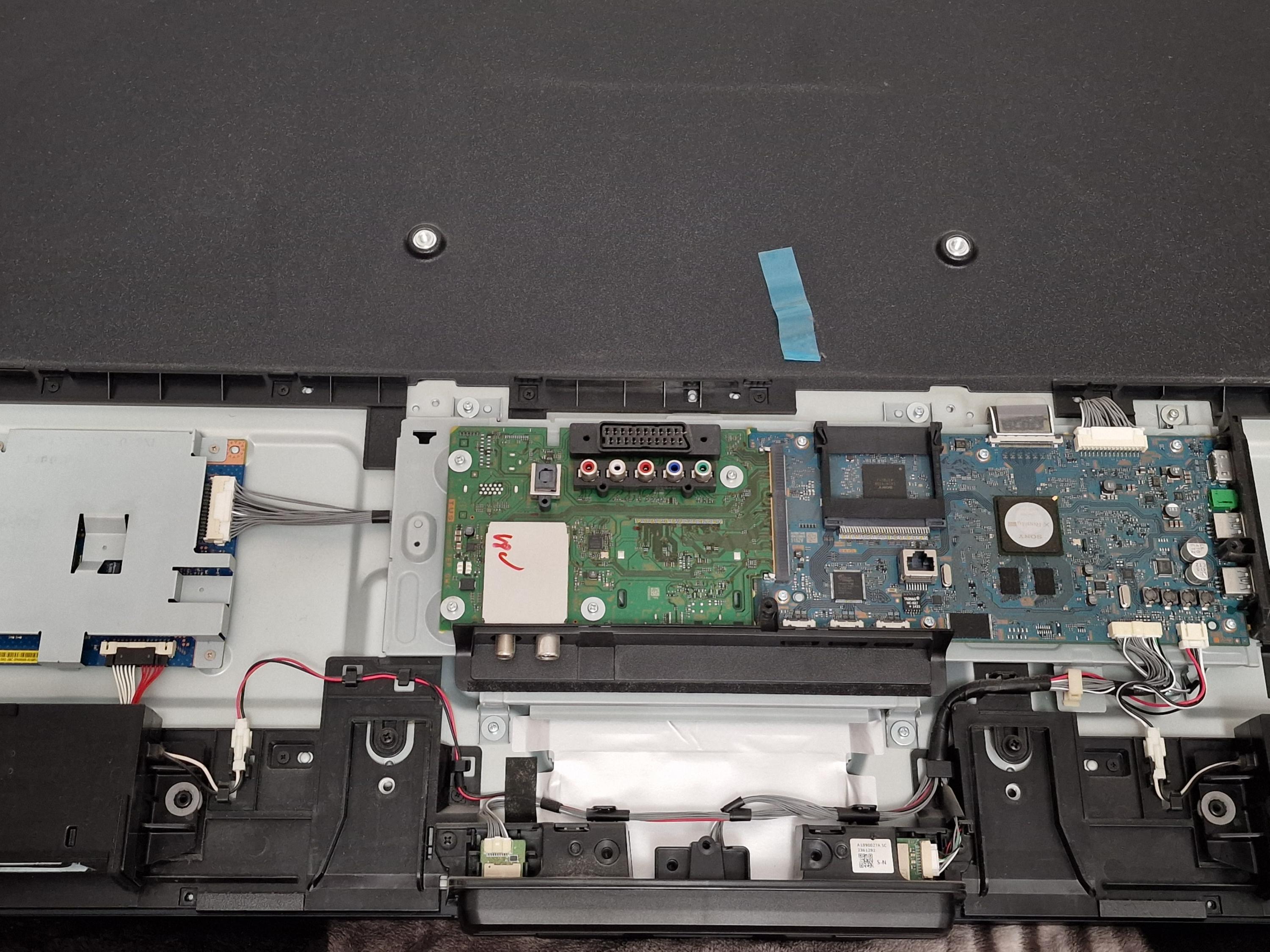

    Maybe check the mlcc caps on driver board for shorts or very low ohms.

      Re: Sony KDL-50w829b
      I'll look again but it's been on for 2 hours now and the picture is now perfect
        Ok, so gamma issue cleared up then?
          Yes correct perfect picture now
            If I want to do that, just to check the ribbons, do I need some grounding or similar or is it ok to open the tv without that?
              Where are those ribbons? Are they under the green and blue board?
                No worries , there are under the silver tape ��
                  Picture is back now, tape helped, thank you for the video ��
