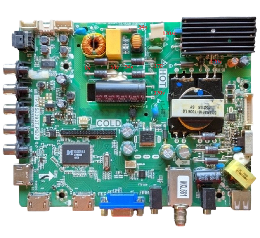

      Only getting voltage there, only millivolts or 0 volts everywhere else, no voltage on cold side no voltage on any coil or cap except filter cap no voltage on UL1, UL2 or eeprom, maybe problem with transformer?:

        oops I lied, there is 170 volts on 2 pins of the transformer on hot side.

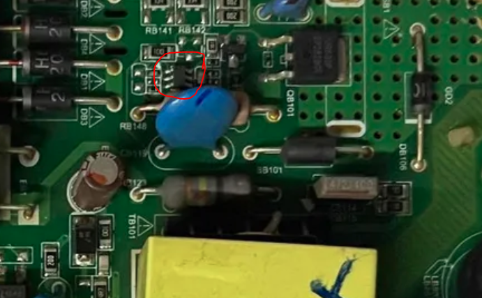

            For the primary smps ic to operate it first needs vcc voltage, what do you measure on the vcc pin of the ic?

              Re: Sanyo FW42D25T
              not sure, is that ic on the primary/hot side? I don't see any ic on the hot side.

                Re: Sanyo FW42D25T
                It is on the primary side. There will be a small driver ic, likely a smd 6 pin, this ic drives a power mosfet that switches the primary of the main transformer to produce the secondary voltages.

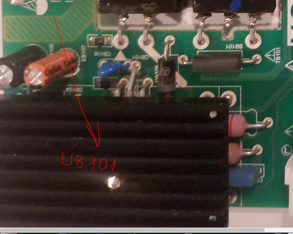

                  Re: Sanyo FW42D25T
                  Remove the heatsink and you will see UB101 PWM (6pin.).

                    Re: Sanyo FW42D25T
                    Thanks gentlemen, any way to verify UB101 is not working, like testing QB101 or DB106? QB101 has 170 v on middle pin, 0 v on the other two, DB106 tests good in diode mode, has 170 v on each end.

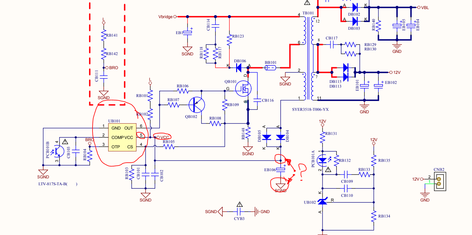

                      Re: Sanyo FW42D25T
                      What is the top marking on the ic? what is the vcc voltage?
