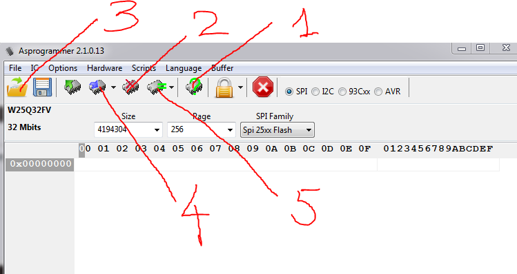

      I'm like a chimp trying to do calculus lol, how do I put that file you posted in As programmer?
      • lotas
        • Jan 2016
        • 4840
        • Russia
        #63
        Re: Sanyo FW42D25T
        I don't know what program you use for ch341a.
        • nomoresonys
          • Jan 2013
          • 12328
          • U.S.
          #64
          Re: Sanyo FW42D25T
          I used As programmer.
          • nomoresonys
            • Jan 2013
            • 12328
            • U.S.
            #65
            Re: Sanyo FW42D25T
            I guess I should have asked if As programmer can deal with the rar file or do I have to open the file first then add it?
            • lotas
              • Jan 2016
              • 4840
              • Russia
              #66
              Re: Sanyo FW42D25T
              You must first unzip the zip, and then write down this file with the “bin” extension.

                                  Re: Sanyo FW42D25T
                                  Lol, ok, I need to wait for a 25 adapter, it's too hard to get a solid connection with the clip.
                                  • nomoresonys
                                    • Jan 2013
                                    • 12328
                                    • U.S.
                                    #77
                                    Re: Sanyo FW42D25T
                                    Plus I need to learn this As programmer, is it the easiest one to use for windows?

                                      have a new chip that was pre-programmed, can you check it against the other one? trying to learn how to do it but will take me a while:
                                      • lotas
                                        • Jan 2016
                                        • 4840
                                        • Russia
                                        #79
                                        Re: Sanyo FW42D25T
                                        This dump is VERY badly damaged (the TV won't even turn on with it!).
                                        • nomoresonys
                                          • Jan 2013
                                          • 12328
                                          • U.S.
                                          #80
                                          Re: Sanyo FW42D25T
                                          Thanks a lot Lotus, you saved me lots of trouble, I almost just put it on without checking but one thing I have learned is that you must check new parts. They must have sent me a garbage chip, I used esd safety and never touched the chip with a hand, I got the chip from this place: https://www.ebay.com/sch/i.html?_ssn...86.m3561.l2562
