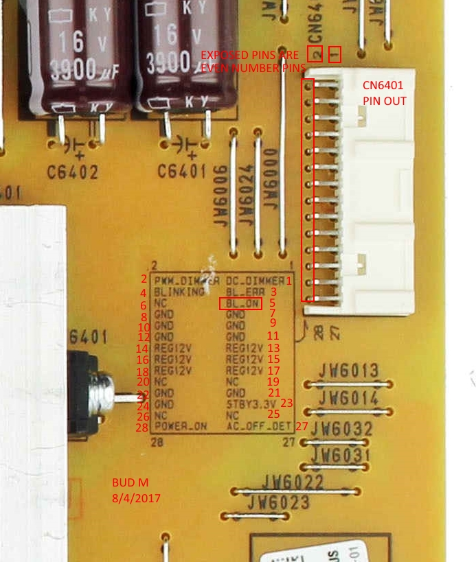

                  #68
                  Re: KDL-60W600B won't open just Red Blinks 6 times
                  Originally posted by Ali101
                  Dear budm, with CN6401 which pin# i need to check since i already check CN6401 all pins each by each with tv turn on,
                  Like i did with each by each pin to leave the meter connected to that pin and then turn the TV on & results below
                  CN6401: on PSU
                  Pin 1 = 3.5 V after turn on tv it goes 0.00 V
                  Pin 2 to 5 = 0.00 V
                  Pin 6 to 8 = 12.7 V after turn on tv it goes 0.00 V
                  Pin 9 to 14 = 0.00 V
                  do i need to check some other way? your advise will be highly appreciated,
                  Thanks.
                  It looks like you count the pins wrong, it has Even and Odd column. We need to know the DCV of BL-ON pin (no BL-ON = no Boosted Voltage, BL-ON is one of the required signals/Voltage for the booster to work) which you cannot get to it from the top, you have to use skinny probe on the back side of the connector (all connectors must be in place) or from the bottom side of the board, see pin out picture attached.
                    #69

                      #70
                      @budm, OMG how stupid i am, thank you so much for make me on correct path, before i was keep thinking which pins you are asking, sorry my bad,
                      @tom bro, indeed your suggestions help me to not let make board more short, thanks alot,
                      Below are results,
                      CN6401 BL_ERROR pin 3= 1.6V after tv turn on it goes 0.00v very fast within one or two seconds,
                      BL-ON pin 5= 0.00v after tv turn on it goes 3.29V for one to two seconds and again goes to 0.00v
                      Thanks again @budm @tom

                          #72
                          So bl-on was present for seconds and you do see the 90V at the output of the LED connector and then the BL-ON drops down so the 90V drops down also, the drops down is probably due to protection kicks in due to the backlights did not come on.
                          At this point it looks like the power supply/LED needs to be replace, or you will have to go deeper into troubleshooting the backlights driver circuit, it may be the LED driver IC that is bad.
                          May be look up the IC6801 spec sheet and we can start checking the Voltages on the pins.
